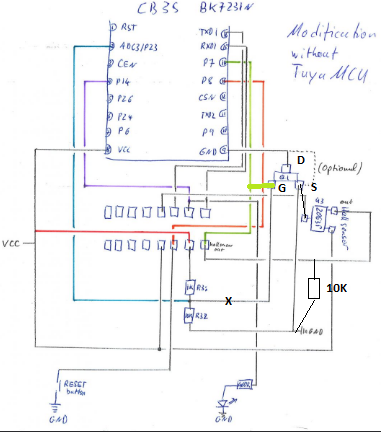

    #31 21354464
    spin55
    Posts: 209
    Help: 17
    Rate: 42
    If you try to control Q1 from P26 it will never work, because if you set P26 to Low Q1 will interrupt GND and will never wake up until you remove and reinsert the batteries. Please note that the firmware is now on this CB3S module and needs to be permanently powered. That is why the PinDeepSleep command is used, which is already integrated into the autoexec drivers. It is this command that lowers consumption to the minimum in Sleep state.
    To be able to control GND with Q1 you could do it whit Gate is connected to the output of U3 (Hall effect transistor). This way you could send the alert via MQTT to Home Assistant, but when you close the door again you could not send the information because Q1 would cut off GND.
    And if you open the door and close it again quickly you wouldn't even have time to send the notification to HA.
    Electronic schematic showing connections between CB3S module, BK7231N chip, MOSFET transistor, and resistor.
  • P26 must stay high to keep Q1 grounded

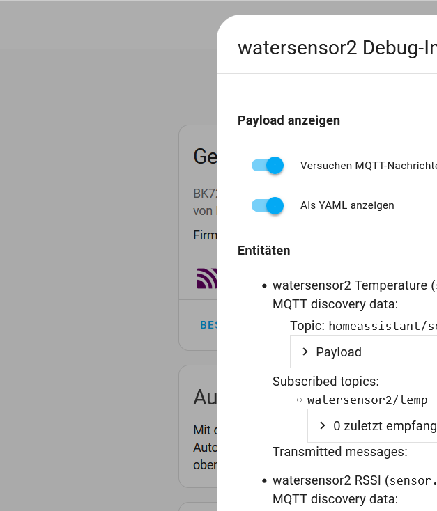

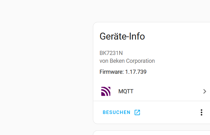

    #33 21357822
    ghanatracking
    Hi,
    I'm relativly new to openbeken, so might be my question is answered somewhere.
    I have this sensor (ok, the water sensor version), flashed to openbeken. Set it up to connect to my mqtt & Homeassistant. It's working so far, but I don't get any sensors, so I don't get the information about open / close.
    Screenshot of an interface showing device information for BK7231N from Beken Corporation with firmware 1.17.739 and an MQTT icon.
    I have another door sensor, and another water sensor, where it's working as expected.
  • Home Assistant MQTT binary sensor configuration for OpenBK
    #34 21358109
    daherbst85
    Level 4  
    Posts: 8
    Have you configured mqtt in your HA configuration.yaml?
    This is what I use for the window/door sensor:
    mqtt:
      - binary_sensor:
        # Window and Door Sensors using OpenBK
        - unique_id: "BK7231N_01_binary_sensor_1"
          state_topic: "BKwindoors/BK7231N_01/1/get"
          qos: 1
          icon: "mdi:door"
          payload_on: "1"
          payload_off: "0"
          device_class: door
    I assume that in your case HA runs a regular mqtt broker (I am running a broker on a separate server, outside of HA).
    Of course you need to configure a user, password, and permissions for HA to access the topic.
    After adding this to your configuration.yaml, you have to reload the yaml. Then you should be able to find the sensor (binary_sensor.bk7231n_01_windoor).
    In the OpenBK web interface, you want to set the retain flag.

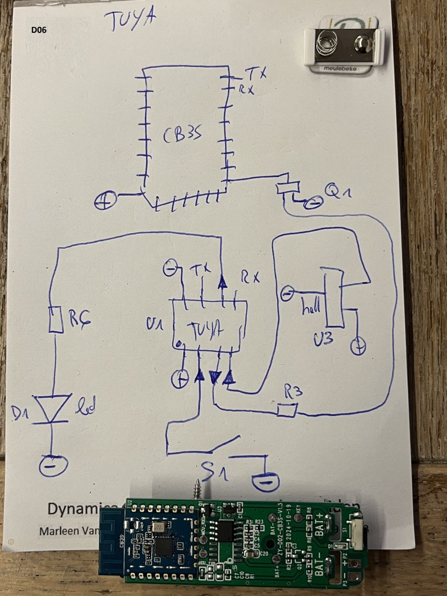

  • #35 21361558
    plekke
    Level 4  
    Posts: 7
    Hand-drawn electronic circuit diagram with a module on a piece of paper.
    my 2 cent , i made this schematic , and the i dicovered this topic ( incl schematics already made )
    nevertheless , maye i can be added and also be usefull
  • #36 21365781
    ghanatracking
    >>21358109
    I have homeassistant with embedded mosquitto.
    View of water sensor temperature details in Home Assistant.
    I have never used config.yaml to edit devices. Do you have therefore an idea how to edit the already existing device? Would "watersensor2" be the unique id, when this is one othe the topics "sensor.watersensor2_temperature"?

    #39 21392216
    ssllaawweekk
    Level 20  
    Posts: 393
    Help: 30
    Rate: 87
    ssllaawweekk wrote:
    I would like to replace the hall sensor in the sensor with the original software with a simple NO button/switch. Is there a ready solution for this? What signals does the hall sensor communicate with the MCU? I read that the sensor output is of the push-pull type.
    I have broken the connection between the Hall sensor and the MCU. By now connecting the sensor input on the MCU to +3V or 0V via a 5kohm resistor I get the ability to set open/closed states.
    If this is not the best solution - please comment.

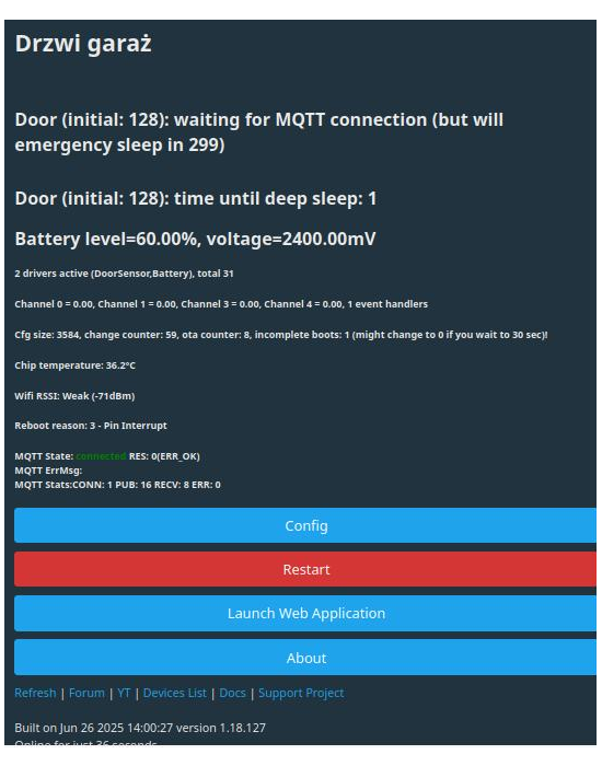

    #46 21591965
    GAAD
    Posts: 289
    Rate: 19
    Hi.
    I removed the MCU from my sensor and made the connections as described. The sensor works very nice but HA does not detect it like all OBK devices in MQTT.
    On the sensor page this info:
    Door Sensor D06 (BK7231N/CB3S) with TuyaMCU (DeepSleep) .
    Flags enabled:
    Flag 2 - [MQTT] Broadcast self state every N (def: 60) seconds (delay configurable by 'mqtt_broadcastInterval' and 'mqtt_broadcastItemsPerSec' commands)
    Flag 10 - [MQTT] Broadcast self state on MQTT connect
    Flag 27 - [HASS] Invoke HomeAssistant discovery on change to ip address, configuration
    Flag 37 - [WiFi] Quick connect to WiFi on reboot (TODO: check if it works for you and report on github)
    Flag 51 - [WiFi] (RTL/BK) Enhanced fast connect by saving AP data to flash (preferable with Flag 37 & static ip). Quick reset 3 times to connect normally
    As I wrote earlier the sensor connects very fast, goes into deepsleep, when you move the magnet it wakes up the LED blinks once - the page refreshes there is a message that it has connected but you can't see it in the MQTT devices. Am I forgetting something? So far, always after clicking "Start Home Assistant Discovery" the device appeared in HA.
  • #47 21591992
    Posts: 14754
    Rate: 12875
    So the HA is not receiving Discovery? Maybe the sensor falls asleep before it has time to send it.
  • MQTT logs show battery and voltage publishing
    #48 21592390
    GAAD
    Posts: 289
    Rate: 19
    The logs show that it is sending:
    Info:MQTT:Channel has changed! Publishing 1 to channel 1
    Info:MQTT:Publishing val 1 to obk535A5B2C/1/get retain=0
    Info:MQTT:MQTT client in mqtt_incoming_publish_cb topic obk535A5B2C/1/get
    Info:MQTT:Queued topic=obk535A5B2C/1/get, 1 items in queue
    Info:MQTT:Publishing val 2400 to obk535A5B2C/voltage/get retain=0
    Info:MQTT:Publishing val 60 to obk535A5B2C/battery/get retain=0
    Info:MQTT:MQTT client in mqtt_incoming_publish_cb topic obk535A5B2C/voltage/get
    Info:MQTT:MQTT client in mqtt_incoming_publish_cb topic obk535A5B2C/battery/get
    :MQTT:MQTT_RegisterCallback called for bT bekens_n/ subT bekens_n/+/set
    Info:MQTT:MQTT_RegisterCallback called for bT cmnd/obk535A5B2C/ subT cmnd/obk535A5B2C/+
    Info:MQTT:MQTT_RegisterCallback called for bT cmnd/bekens_n/ subT cmnd/bekens_n/+
    Info:MQTT:MQTT_RegisterCallback called for bT obk535A5B2C/ subT obk535A5B2C/+/get
    Info:CMD:CMD_StartScript: started @startup at the beginning
    Info:CMD:Battery Setup : Min 1500.000000 Max 3000.000000 Vref 2400.000000 adcbits 4096.000000 vdivider 1.000000
    Info:CMD:Battery Cycle : Measurement will run every 4 seconds
    Info:EVENT:CMD_AddEventHandler: added OnHold with cmd DSTime 2400
    Info:MAIN:Main_OnWiFiStatusChange - WIFI_STA_DISCONNECTED - 2
    Info:MQTT:mqtt_userName mqtt
    mqtt_pass ********
    mqtt_clientID obk535A5B2C
    mqtt_host 192.168.1.253:1883
    Info:MAIN:Time 1, idle 196684/s, free 73040, MQTT 0(1), bWifi 1, secondsWithNoPing -1, socks 2/38
    Info:MAIN:HA discovery is scheduled, but MQTT connection is not present yet
    Info:MQTT:mqtt_subscribed to obk535A5B2C/+/set
    Info:MQTT:mqtt_subscribed to bekens_n/+/set
    Info:MQTT:mqtt_subscribed to cmnd/obk535A5B2C/+
    Info:MQTT:mqtt_subscribed to cmnd/bekens_n/+
    Info:MQTT:mqtt_subscribed to obk535A5B2C/+/get
    Info:MQTT:MQTT client in mqtt_incoming_publish_cb topic obk535A5B2C/4/get
    Info:MQTT:Publishing val Drzwi_garaż to obk535A5B2C/host retain=0
    Info:MQTT:Publishing val 0 to obk535A5B2C/1/get retain=0
    Info:DRV:DRV_BATTERY : Measure Battery volt en perc
    Info:DRV:DRV_BATTERY : battery voltage : 2400.000000 and percentage 60.000003%
    Info:MAIN:Time 2, idle 175933/s, free 72976, MQTT 1(1), bWifi 1, secondsWithNoPing -1, socks 2/38
    Info:MAIN:Will do request HA discovery now.
    Info:HTTP:HASS counts: 0 rels, 0 pwms, 1 inps, 0 excluded
    I
    Info:MAIN:Time 3, idle 155163/s, free 57872, MQTT 1(1), bWifi 1, secondsWithNoPing -1, socks 2/38
    Info:MQTT:Publishing val c0:f8:53:5a:5b:2c to obk535A5B2C/mac retain=0
    Info:MQTT:Publishing val (340 bytes) to homeassistant/sensor/Drzwi_garaż_temp/config retain=1
    Info:MQTT:Publishing val (337 bytes) to homeassistant/sensor/Drzwi_garaż_rssi/config retain=1
    Info:MQTT:Publishing val (339 bytes) to homeassistant/sensor/Drzwi_garaż_uptime/config retain=1
    Info:MAIN:Time 4, idle 176475/s, free 59152, MQTT 1(1), bWifi 1, secondsWithNoPing -1, socks 2/38
    Info:MQTT:Publishing val (266 bytes) to homeassistant/sensor/Drzwi_garaż_build/config retain=1
    Info:MQTT:Publishing val (297 bytes) to homeassistant/sensor/Drzwi_garaż_ssid/config retain=1
    Info:MQTT:Publishing val (281 bytes) to homeassistant/sensor/Drzwi_garaż_ip/config retain=1
    Info:MAIN:Time 5, idle 177865/s, free 50016, MQTT 1(1), bWifi 1, secondsWithNoPing -1, socks 3/38
    Info:MAIN:Time 2, idle 177884/s, free 72744, MQTT 1(1), bWifi 1, secondsWithNoPing -1, socks 3/38
    Info:MQTT:Queued topic=homeassistant/sensor/Drzwi_garaż_battery_0/config, 1 items in queue
    Info:MQTT:Queued topic=homeassistant/sensor/Drzwi_garaż_voltage_0/config, 2 items in queue
    Info:MQTT:Queued topic=homeassistant/binary_sensor/Drzwi_garaż_binary_sensor_1/config, 3 items in queue
    Info:MQTT:Queued topic=homeassistant/sensor/Drzwi_garaż_temp/config, 4 items in queue
    Info:MQTT:Queued topic=homeassistant/sensor/Drzwi_garaż_rssi/config, 5 items in queue
    Info:MQTT:Queued topic=homeassistant/sensor/Drzwi_garaż_uptime/config, 6 items in queue
    Info:MQTT:Queued topic=homeassistant/sensor/Drzwi_garaż_build/config, 7 items in queue
    Info:MQTT:Queued topic=homeassistant/sensor/Drzwi_garaż_ssid/config, 8 items in queue
    Info:MQTT:Queued topic=homeassistant/sensor/Drzwi_garaż_ip/config, 9 items in queue
    Info:MQTT:Publishing val OpenBK7231N 1.18.127 Jun 26 2025 14:00:27 to obk535A5B2C/build retain=0
    Info:MQTT:Publishing val (311 bytes) to homeassistant/sensor/Drzwi_garaż_battery_0/config retain=1
    Info:MQTT:Publishing val (312 bytes) to homeassistant/sensor/Drzwi_garaż_voltage_0/config retain=1
    Info:MQTT:Publishing val (266 bytes) to homeassistant/binary_sensor/Drzwi_garaż_binary_sensor_1/config retain=1
    Info:MAIN:Time 3, idle 155986/s, free 57872, MQTT 1(1), bWifi 1, secondsWithNoPing -1, socks 2/38
    Info:MAIN:Time 4, idle 180085/s, free 57776, MQTT 1(1), bWifi 1, secondsWithNoPing -1, socks 2/38
    Maybe it is an HA poblem.
    If you can see it because there are errors and warnings in the log.
    It connects instantly and the sensor works very fast.

    And HA can see the JSON as you give a listen in MQTT?
    This indicates that it has sent Discovery data about the sensor.

    I looked in the logs and all is clear I used Polish characters and these are not allowed in mqtt after removing the ¿ from the word garage the sensor was detected.
