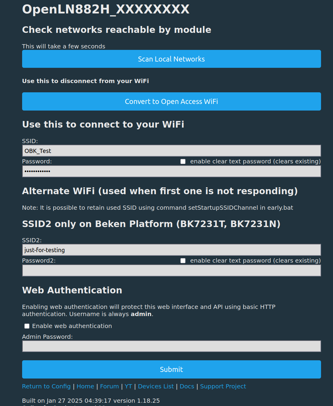

    In fact not only the wifi mode had changed, but the whole configuration was lost. FW-Version was of April 2025, if I remember right.

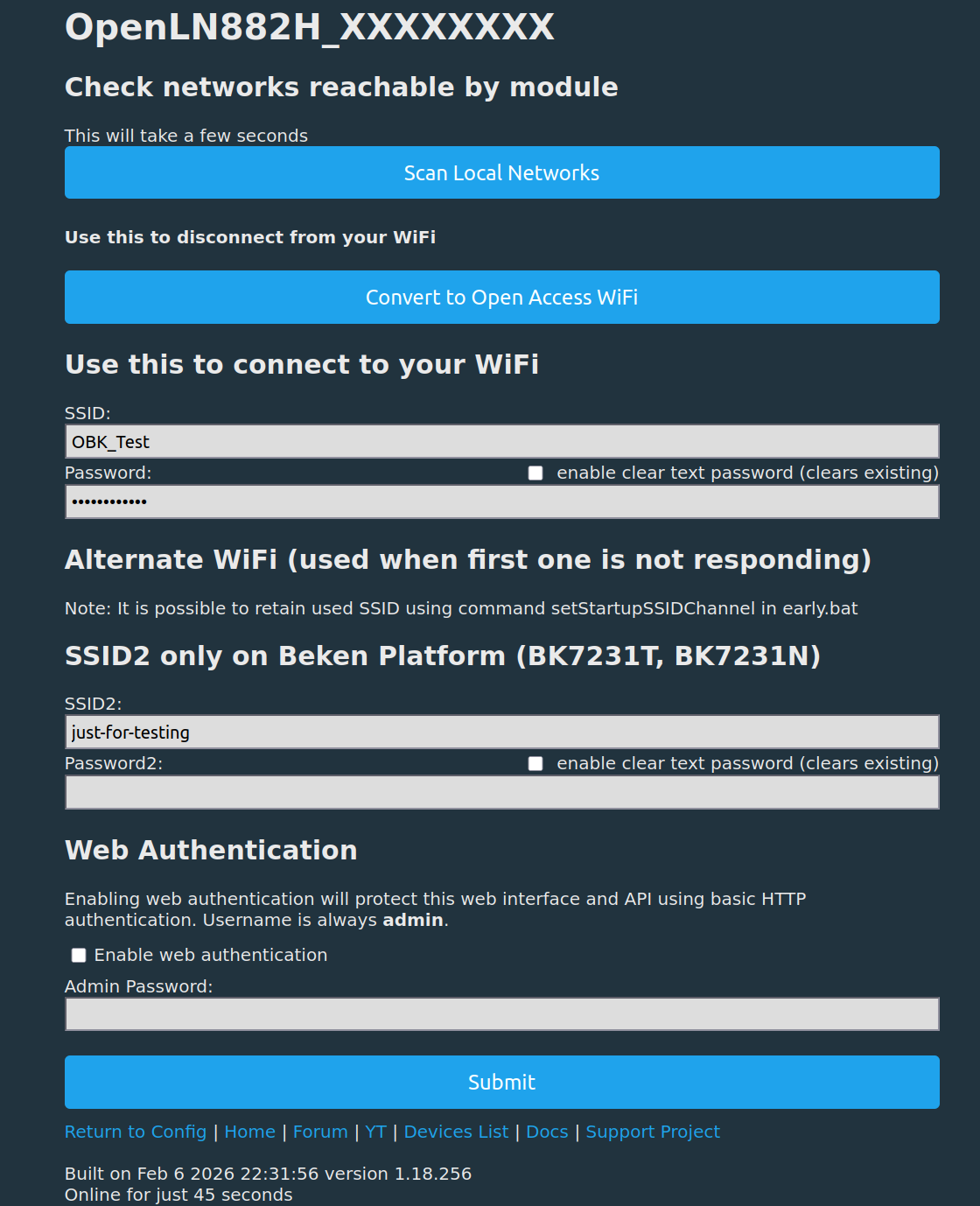

    It should be no general issue, maybe a (sad) isolated problem?
    I know it's no help for you, but hard to find if it's not a common error.
    You don't have a log from the start, maybe showing why config was erased?
    Usually the default config is loaded, if there's a CRC error for the config in flash.
    Just tried an update from 1.18.25 (January 2025) to actual 1.18.256:
    Screenshot of OpenLN882H web UI with Wi‑Fi SSID/password fields, SSID2, and web authentication settingsScreenshot of OpenLN882H web panel showing Wi‑Fi settings, SSID fields, and a “Submit” button
    Pin configuration also was present after the update

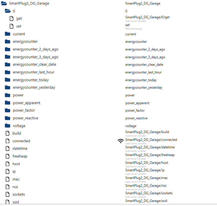

    New strange effect. Device is regularly sending to MQTTChannel 138. I don't have that channel, only channel 0, where there are the "get" and "set" commands.
    I always get the following message in ioBroker-Log now:
    "mqtt.0 2026-06-24 15:43:24.953 warn State "mqtt.0.SmartPlug2_DG_Garage.138.get" has no existing object, this might lead to an error in future versions"
    Can anyone explain, why that happens and where channel 138 does get from?

    >>21927137 While still searching for the above mentioned 138 Phenomenon, I tried to "Read OBK configuration" using the Webpage -> Flash page. But I found that besides a header these 2kB are empty (ff). Is that normal? Where is the configuration stored on LN882H devices?

    Finally I did "Return device to factory settings..." on the Web Application -> Tools. But it is still sending MQTT data to mqtt.138.SmartPlug2_DG_Garage.0.get
    No idea, what else I could try. Help!

    >>21937426 Ah, silly me. I see. No, I'm on 1.18.279 (but of course will try latest version now)
    Hinzugefügt nach 13 [Minuten]:
    >>21937427 Tried it (Version is now 1.18.298). No MQTT-Messages to 138 at the moment. Sometimes solutions are easy :-))
    Side effect: Voltage reading of the plug dropped from 230 to 116V. Will have to re-calibrate.
  • #40 21937440
    Posts: 5220
    Help: 449
    Rate: 918
    ah very good. thanks to @DeDaMrAz for that fix.
    probably this fix which meant LN882H BL0937 readings were double what they should have been https://github.com/openshwprojects/OpenBK7231T_App/pull/2135
    https://github.com/openshwprojects/OpenBK7231T_App/issues/2129
