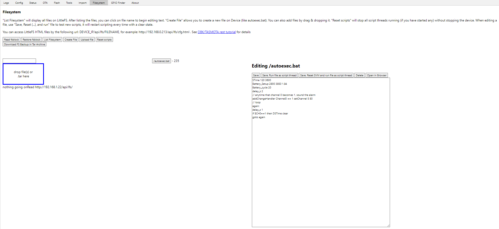

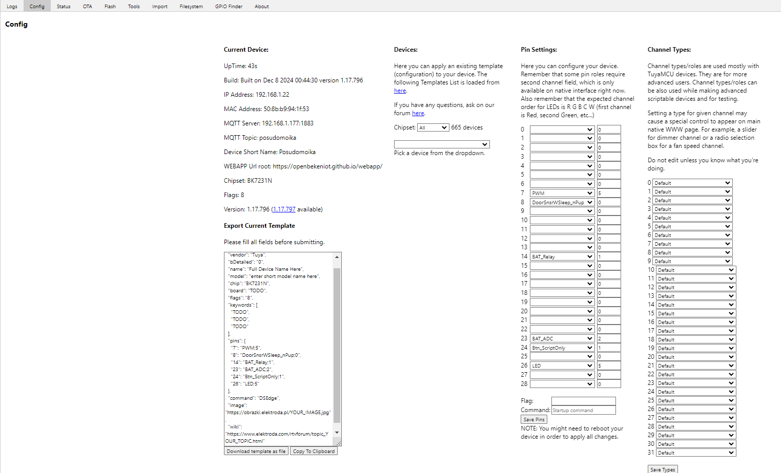

    Config is unchanged:
     "pins": {
        "7": "PWM;5",
        "8": "DoorSnsrWSleep_nPup;0",
        "14": "BAT_Relay;1",
        "23": "BAT_ADC;1",
        "24": "Btn;1",
        "26": "LED;5"
      "command": "DSEdge 0",
    autoexec.bat
    Battery_Setup 2500 3700 1.85 2400 4096
    Battery_cycle 20
    delay_s 2
    // if detected
    if $CH0==1 then setChannel 5 80
    // loop
    again:
    delay_s 1
    if $CH0==1 then DSTime clear
    goto again
    You mean, I should change it to something like
    "24": "Btn;2",
    right?

    The behaviour you've described indicates that the LED driver tries to do some things.
    Please change the Btn role to Btn_ScriptOnly, then save pins, reboot and retry. Let me know if behaviour has changed.
    Script only button will still wake device but will not have automatic interactions.

    You are the king - it's working ok now:

  • #74 21094924
    io2345
    Posts: 273
    Rate: 7
    Alright, let's try different channels.
    Currently these three are on channel 1
    "23": "BAT_ADC;1",
    "24": "Btn_ScriptOnly;1",
    other channels in use are 0 (for the sensor) and 5 (for LED and Buzzer).
    What should I try? Different channels for all of the above three - like this?:
    "23": "BAT_ADC;2",
    "24": "Btn_ScriptOnly;3",
  • Hardware button triggers alarm via Btn_ScriptOnly pin
    #76 21095369
    io2345
    Posts: 273
    Rate: 7
    OK. Let me check it at least a day or two with these settings just to be sure.
    One thing that I still don't understand: If I press the hardware button, the alarm starts. Why? The button shouldn't have anything to do with the sensor, right?
    Currently the settings are:
    "vendor": "Tuya",
    "bDetailed": "0",
    "name": "Floor sitting Water Leak Flood Sensor Alarm",
    "model": "DY-SQ400B",
    "chip": "BK7231N",
    "board": "CB3S",
    "flags": "8",
    "keywords": [
    "CR123A",
    "battery",
    "buzzer",
    "detector"
    "pins": {
    "7": "PWM;5",
    "23": "BAT_ADC;2",
    "26": "LED;5"
    "image": "https://obrazki.elektroda.pl/6240569600_1714757661.jpg",
    "wiki": "https://www.elektroda.com/rtvforum/topic4052199.html"
    and the autoexec.bat
    DSTime 60 50000
    Battery_Setup 2900 3700 1.94
    Battery_cycle 20
    setChannel 5 80
    delay_s 2
    // if detected
    // loop
    again:
    delay_s 1
    goto again
  • #77 21095429

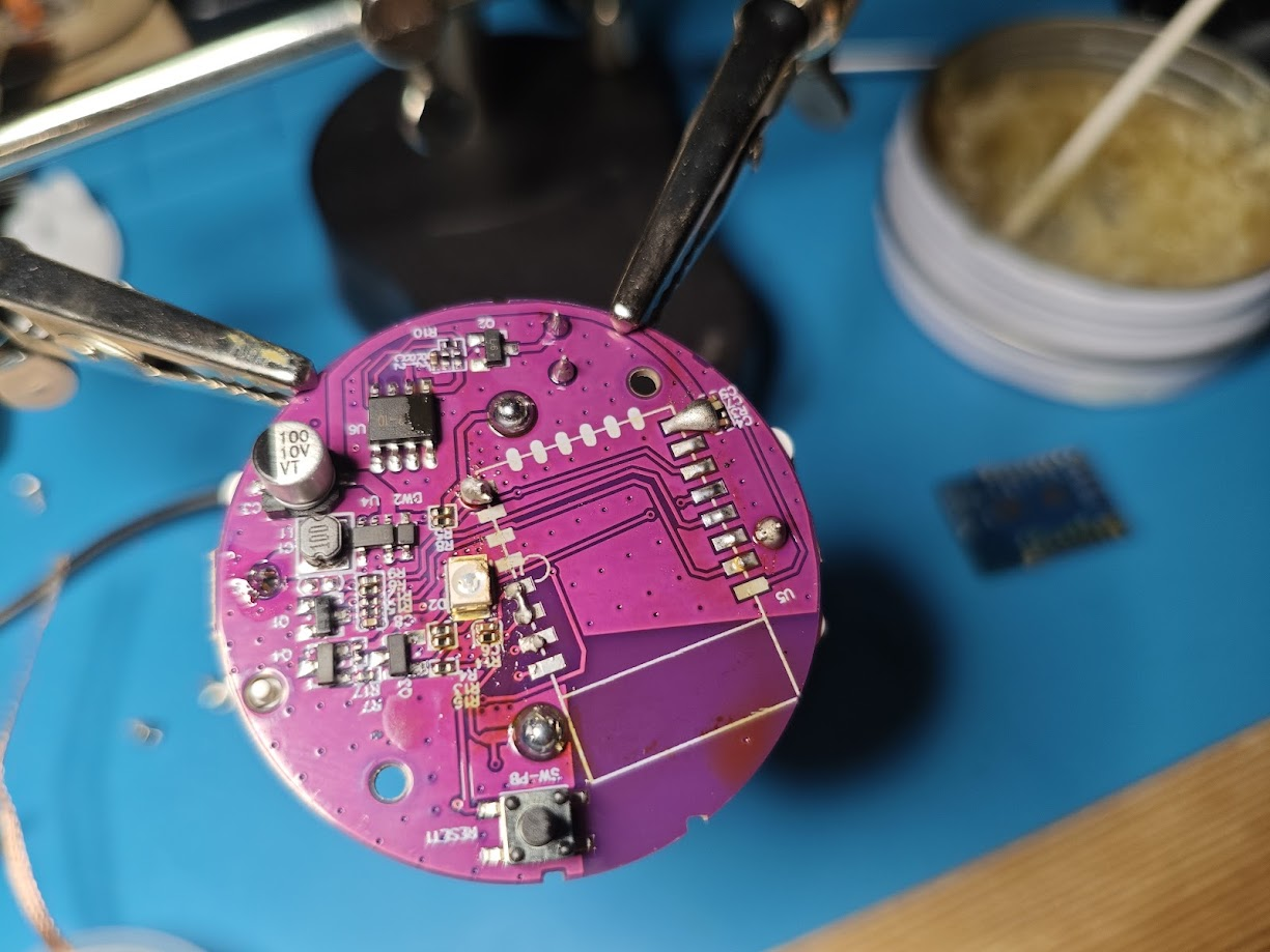

    I bought one to harvest its brain.
    Printed circuit board held in a clamp against a blue workbench background. Chip held in a holder against a blue workbench background.
    Here's factory backup for the forum
    • readResult_BK7231N_QIO_2024-13-6-22-36-50.bin (2 MB) You must be logged in to download this attachment.

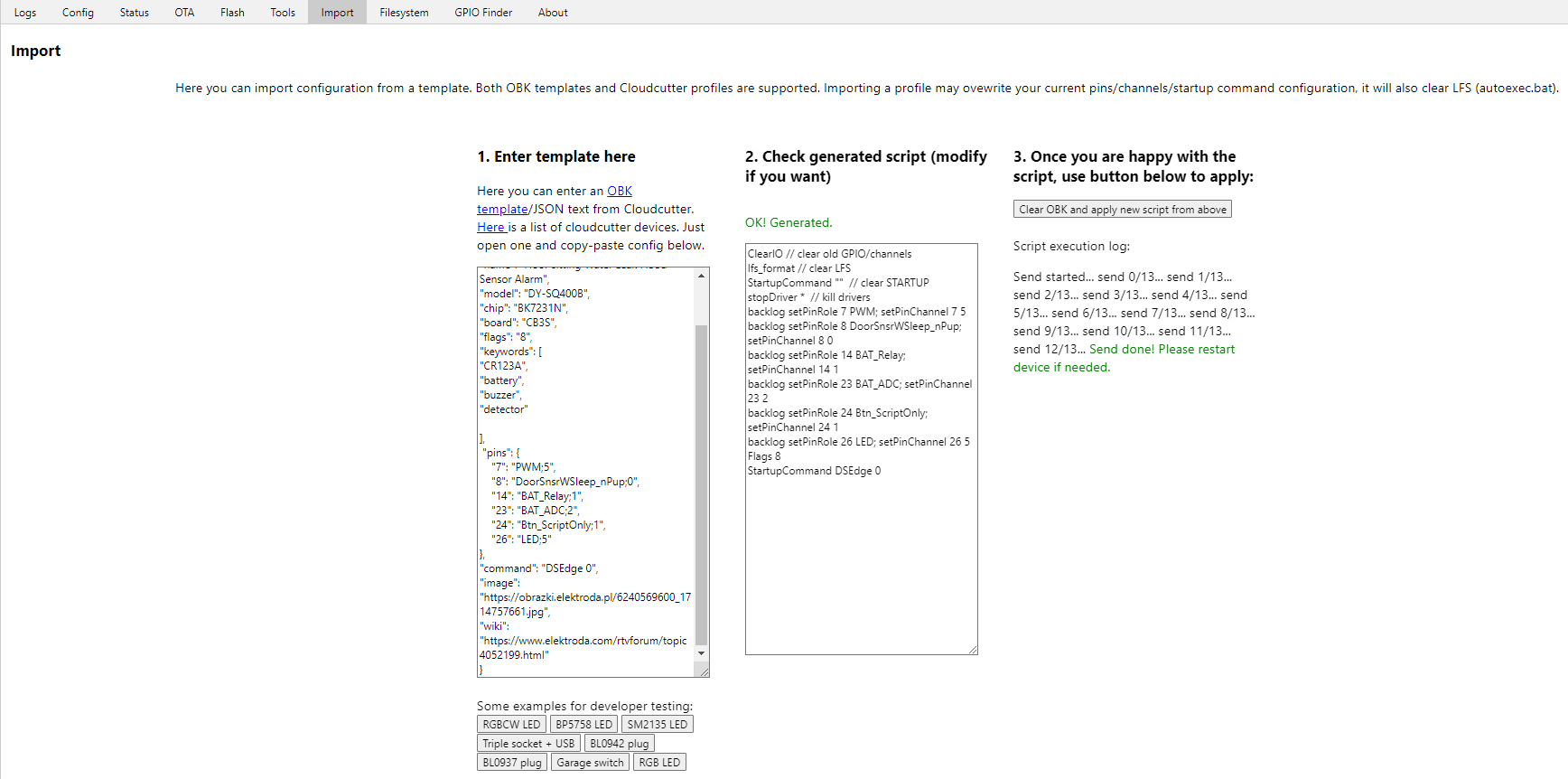

    #85 21339745
    io2345
    Posts: 273
    Rate: 7
    >>21337597 samoswall, the config code has to be inserted on the webpage -> Import -> Enter template here.
    For the autoexec.bat: Go the Filesystem -> List Filesystem. Does it show a file with the name "autoexec.bat"? If not, go to "Create File" and create a file of that name. Now you can fill the File editor on the right side of the same page.
    The webpage itself can be reached from the device's main-page where it says "Launch Web Application".

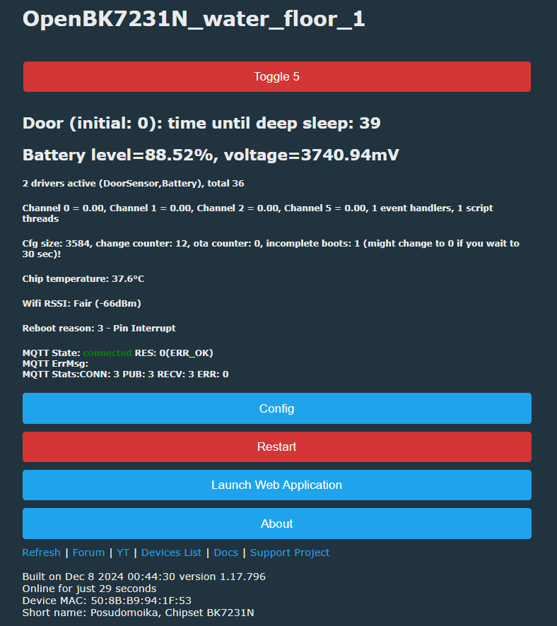

    #86 21340354
    samoswall
    Posts: 9
    >>21339745
    Thanks for the answer!
    With a template and autoexec.bat figured it out, but I still can't get it to work properly:
    It does not respond to the closure of flood contacts;
    installed in autoexec.bat connection time is 3600 seconds - does not wake up.
    I don't understand what I'm doing wrong?
    OpenBK7231N user interface with door sensor and battery status information. Screen for importing configuration from an OBK template. Screenshot of an IoT device configuration interface displaying device information. Screenshot of the autoexec.bat file editor in the LittleFS filesystem on Tasmota.
  • #88 21344443
    Posts: 14805
    Rate: 12972
    DSEdge is indeed required on some devices, you can figure out the correct setting by experimenting. Just make sure to also configure one of the pins as Button first, so it can be used as alternate wakeup method if the door contact (or water sensor, etc) wakeup fails.
  • Autoexec.bat fixes leak sensor operation, but sleep wakeup fails
    #89 21380770
    samoswall
    Posts: 9
    I managed to get this water leak sensor to work properly with this autoexec.bat
    DSEdge 0
    Battery_Setup 2900 3850 1.94
    Battery_cycle 20
    delay_s 2
    STime 60 600
    again:
    delay_s 1
    goto again
