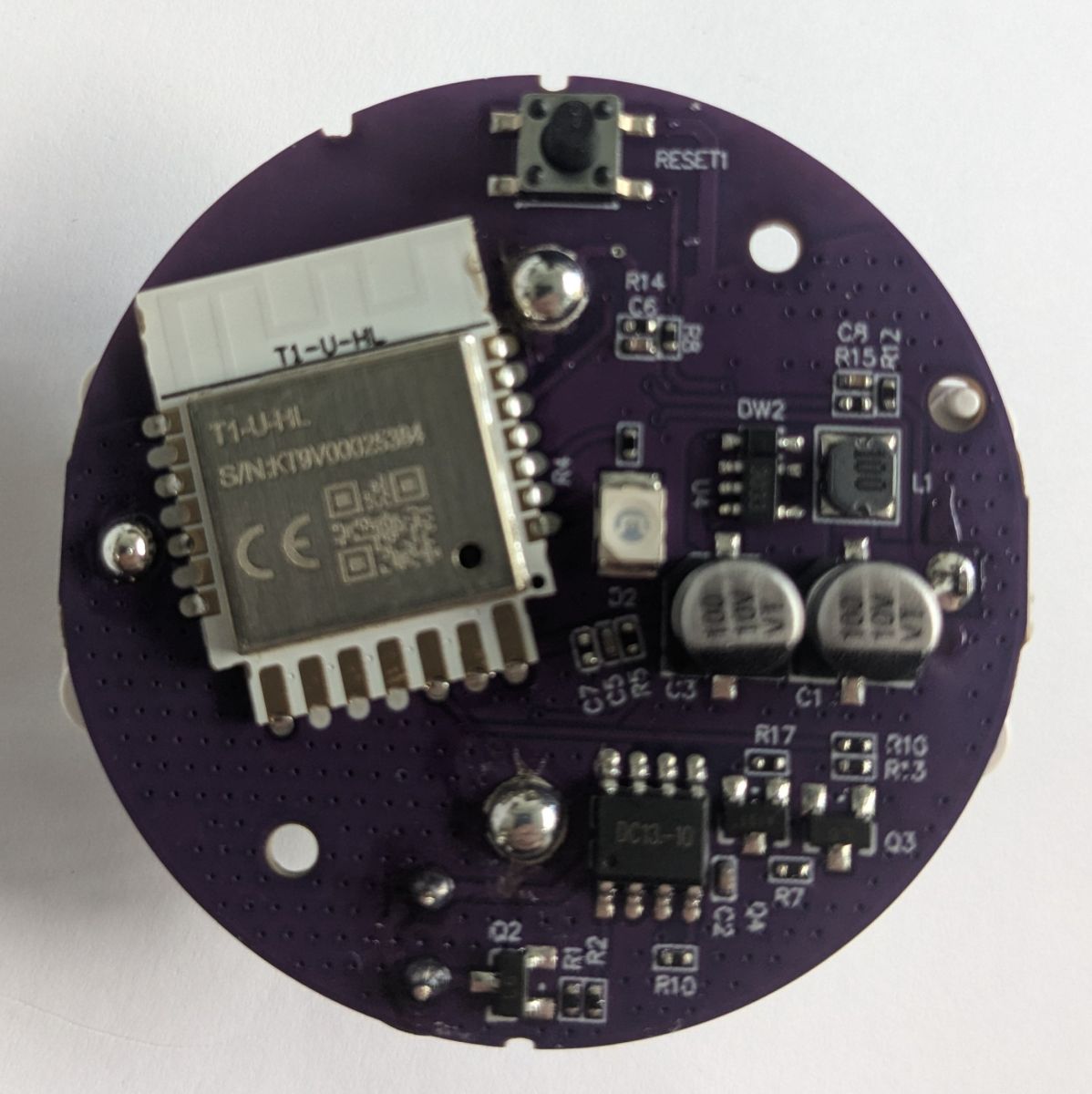

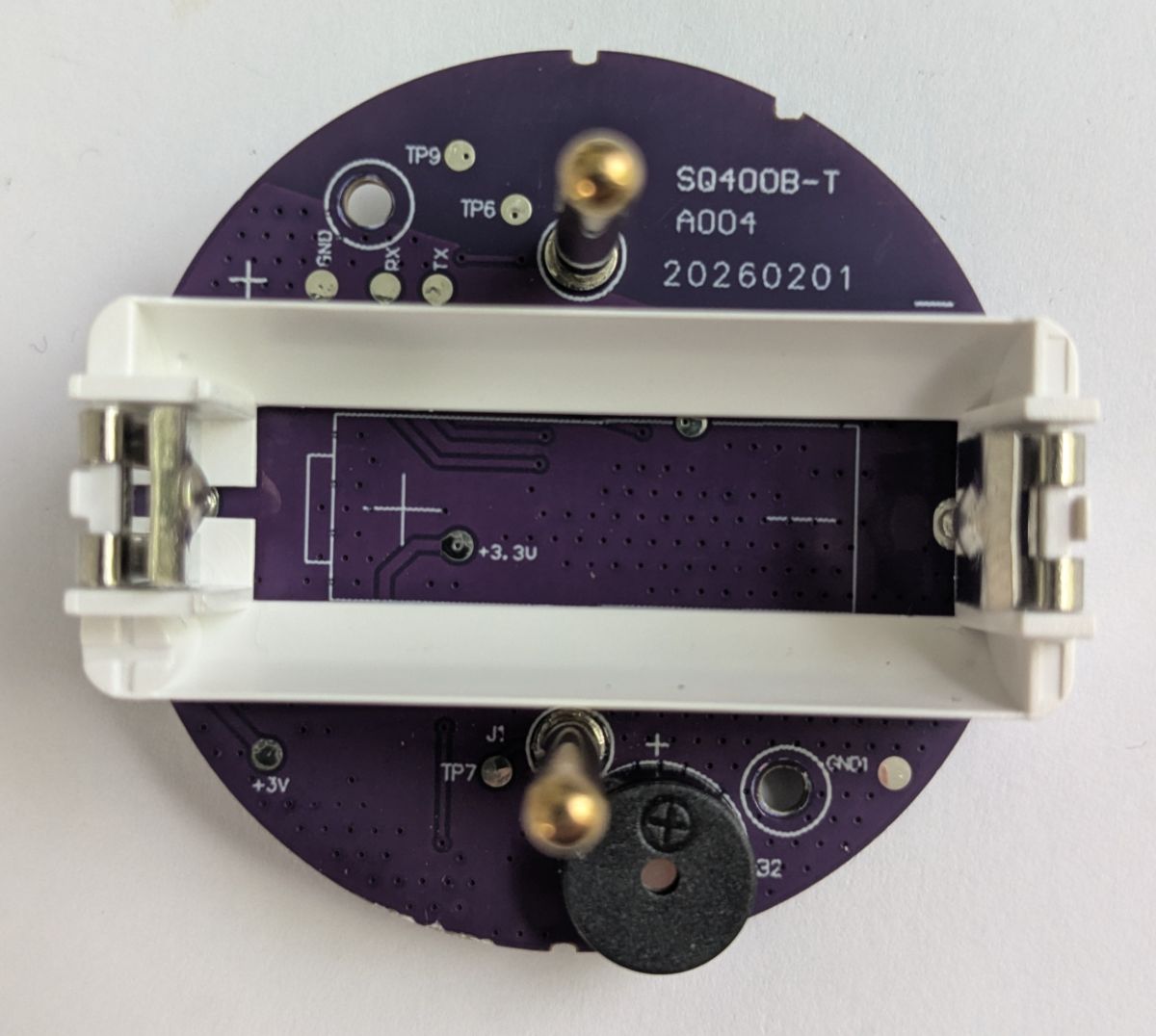

  • #115 21915335
    gerben
    I recently ordered from the AliExpress link.
    It seems they have a new model: SQ400B-T A004 (previously SQ400B-W A003).
    Date: 20260201 (previously 20231207)
    This one uses a T1-U-HL (previously CB3S)
    I didn't flash mine yet.
    Tuya Water Sensor WiFi DY-SQ400B Flashing, Configuration for OBK Esphome/Tasmota style firmware
    Tuya Water Sensor WiFi DY-SQ400B Flashing, Configuration for OBK Esphome/Tasmota style firmware.
  • #116 21915347
    Posts: 14632
    Help: 655
    Rate: 12647
    20260201, well, that's a really fresh device! Luckily OBK runs fine on T1, so everything boils down to configuration. It seems it's still a non-TuyaMCU device, so DoorSensor is the way...
