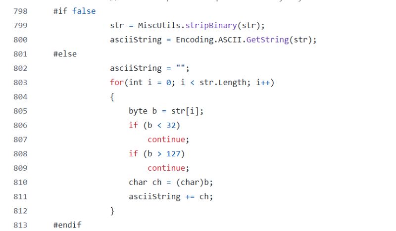

    https://github.com/openshwprojects/BK7231GUIFlashTool/blob/main/BK7231Flasher/TuyaConfig.cs
    Code: C / C++
    This is hacky as hell and could be improved with some Tuya code analysis:
    A fragment of C# code with a conditional block and a loop that filters bytes to ASCII characters.

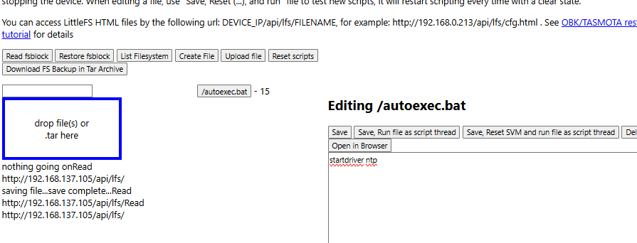

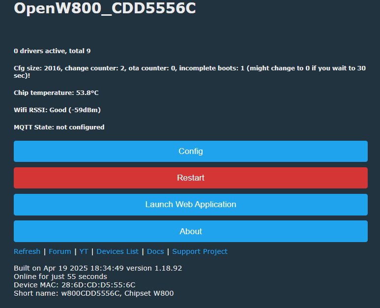

    New sdk build: https://github.com/NonPIayerCharacter/OpenBK7231T_App/actions/runs/14580099010
    Increased stack size to 100k, free heap is about 88k. This leaves about 40-50k for libc heap. Freertos version is now V10.4.1 instead of V7.0.2 (came with new sdk), and using heap_5.
    LFS is now available, 0x1B000 length, replaces tuya config section. Easyflash is used for flashvars with possibility of using it for config.
    Powersave implemented (currently if it is done in autoexec/init, it won't work, will upload fix later).
    Berry enabled by default.
    Now for the sad parts.
    Worse signal reception, at least for me. I can connect to wifi with release version, but can't with this one. Rssi reports as -70. But it connects to a second, closer ap just fine.
    Ota is much slower, and if not done after reboot, there is a high possibility that it will fail (will quickly eat all available heap, which will force a reboot).

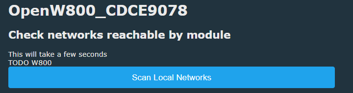

    what is this?
    I recognise from recent XR806 adventures https://www.elektroda.com/rtvforum/find.php?q...reated+HTTP+SV+thread+with+%28stack%3D2048%29
    Screenshot of an interface with a Scan Local Networks button and the name OpenW800_CDCE9078.

    Screenshot of OpenW800 device management panel with action buttons and technical information.
    Screenshot of a console with messages and a command input field, featuring a Berry language command. Screenshot showing a division by zero error in the Berry interpreter after trying to execute print(Hello + str(5+0/0)).
    Computer screen showing messages about formatting and mounting a file system, with a command input field. Screenshot of LittleFS file editor with the autoexec.bat file open.

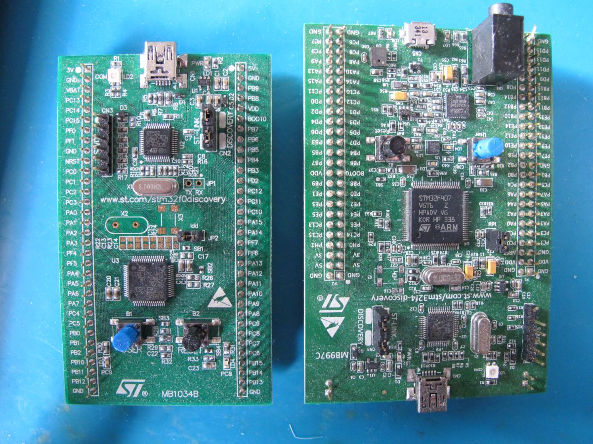

    I do recall now reading about using some CK-Link elf file uploaded to an STM32 so you can make a cheap CK-Link debugger. I don't know if debugging mode = flash access though. There are a few articles around about it. eg https://en.eeworld.com.cn/bbs/thread-1190847-1-1.html https://hackaday.io/page/12671-how-to-debug-w806-and-w801-mcus
    Also maybe this is some clone thing already setup https://fr.aliexpress.com/item/1005007641192505.html
    Added after 10 [minutes]:
    I found these at the recycling centre once so maybe I can already try. Not explored them
    Two STM32 development boards with microcontrollers and connectors on a blue background.

    #47 21527691
    Posts: 5208
    Help: 446
    Rate: 914
    HLK-W801-KIT-V1.1
    Screenshot of the OpenW800 device control panel displaying technical information and configuration buttons. OpenW800 control panel with device status information and configuration buttons.
    HLK-W800-KIT-V1.0
    OpenW800 device control panel with configuration, restart, and web application launch options. OpenW800 control panel with configuration, restart, and web application buttons.
    new SDK on this one alternates between EXCELLENT/GOOD and the old SDK alternates between GOOD/FAIR.
    so, wow, maybe just HLK-W801 is rubbish

  • CK-Link ELF can turn STM32 into cheap debugger
    #52 21529784
    Posts: 5208
    Help: 446
    Rate: 914
    worth a shot maybe

  • New SDK worsens RSSI and raises temperature readings
    #53 21530706
    max4elektroda
    Posts: 758
    Help: 49
    Rate: 189
    max4elektroda wrote:
    divadiow wrote:
    I wonder if @max4elektroda has the same experience
    Will try when at home again on the weekend.
    My HKL-W801-KIT-V1.1 also generally has "weak" WiFi connections, .
    RSSI changes between -71 and -89
    With new SDKs version RSSI is often, but not always worse (usually -84 to -89) and connection is bad. E.g. OTA was not working over this connection.
    And with new SDK the internal temperature shown is approx 10° higher (release: 45-51 / new SDK 58 to 62) !
