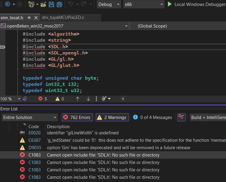

  • Missing Visual Studio C++ components and OpenGL bits
    #105 21264263
    steelincable
    Posts: 11
    Receiving the error below in vs2022 when attempting to build the solution with defaults. A quick google pointed me in this direction, does this look like the right approach to setting up the IDE? https://stackoverflow.com/questions/41695251/c-microsoft-cpp-default-props-was-not-found
    1>------ Build started: Project: openBeken_win32_mvsc2017, Configuration: Debug|Win32 ------
    1>C:\Users\steelincable\Source\Repos\OpenBK7231T_App\openBeken_win32_mvsc2017.vcxproj(18,3): error MSB4019: The imported project "C:\Program Files\Microsoft Visual Studio\2022\Community\MSBuild\Microsoft\VC\v170\Microsoft.Cpp.Default.props" was not found. Confirm that the expression in the Import declaration "C:\Program Files\Microsoft Visual Studio\2022\Community\MSBuild\Microsoft\VC\v170\\Microsoft.Cpp.Default.props" is correct, and that the file exists on disk.
    ========== Build: 0 succeeded, 1 failed, 0 up-to-date, 0 skipped ==========
    Build failed.
    Added after 8 [hours] 5 [minutes]:
    OK, I was missing some components in vs and have them added now. Looks like I need to grab some OpenGL bits.
    Screenshot of errors in Visual Studio 2022 during project compilation.

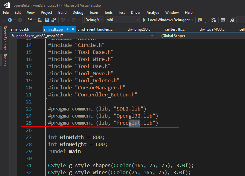

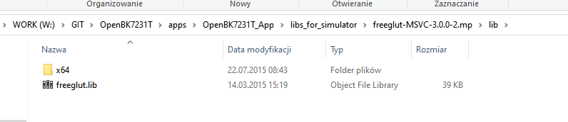

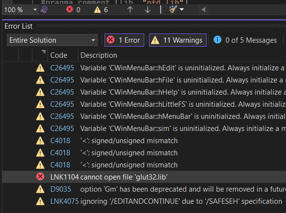

  • #109 21265358
    steelincable
    Posts: 11
    Thanks, I got a bit further! Looks like I'm missing glut32.lib. I'm not seeing that anywhere in the simulator files.
    A screenshot displaying a list of errors and warnings in a development environment. The main error is LNK1104 cannot open file 'glut32.lib'.
  • #110 21265391
    Posts: 14782
    Rate: 12920
    Where exactly is glut32.lib included for you? As far as I remember, there is no glut32.lib dependency, we're using freeglut.lib:
    Screenshot of source code in Microsoft Visual Studio, highlighting a line of code using freeglut.lib.
    Screenshot showing a Windows folder with files including a folder named x64 and a file freeglut.lib.
    Show me what requires glut32.lib and I'll recheck.

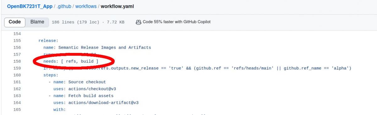

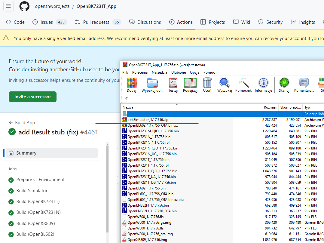

  • Release assets missing from some OpenBeken builds
    #111 21274794
    Posts: 14782
    Rate: 12920
    max4elektroda wrote:
    Did you find the issue or was it solved by magic? Release 733 is whith simulator zip again...
    The issue still persists.
    This has simulator file:
    https://github.com/openshwprojects/OpenBK7231T_App/releases/tag/1.17.755
    And here it's missing:
    https://github.com/openshwprojects/OpenBK7231T_App/releases/tag/1.17.756
    Also sometimes XR809 build is missing as well? What's wrong?
    The number of released assets varies per release. https://github.com/openshwprojects/OpenBK7231T_App/releases
    It seems like we have a problem to solve, @divadiow, @max4elektroda ...
  • #112 21274912
    Posts: 5223
    Help: 449
    Rate: 918
    can the logging be more verbose for the next few runs?
  • #113 21274940
    Posts: 14782
    Rate: 12920
    For now, I've only checked related commit, and it seems that 756 simulator zip is in the artifacts package, so the problem must be on the futher stages, maybe in the code that copies it for release?
    Screenshot of GitHub and file explorer window with an open ZIP archive.
  • #114 21275284
    max4elektroda
    Posts: 758
    Help: 49
    Rate: 189
    That would be my suspected cause, too. But I don't really understand, how this works ...
  • #115 21275584
    Posts: 14782
    Rate: 12920
    I think it's set in this file:
    https://github.com/openshwprojects/OpenBK7231T_App/blob/main/.releaserc.yaml
    but I can't imagine why it would randomly skip files, I assumed this file is run once all the previous build steps are ran? Or maybe we have a race condition?
  • Questions workflow atomicity and release artifact interference
    #116 21278908
    max4elektroda
    Posts: 758
    Help: 49
    Rate: 189
    I tried to understand the logic, but I'm not sure if I did, but this is what I think happens:
    The files used in .releaserc.yaml were put to the folders by OpenBK7231T_App/.github/workflows/workflow.yaml if I got it right.
    Usually the files are copied to output/${{ needs.refs.outputs.version }}/... and then packed as artifacts (by actions/upload-artifact@v3).
    In case of release, the artifacts built before were copied again to output/${{ needs.refs.outputs.version }}/... (by actions/download-artifact@v3) and then finally OpenBK7231T_App/.releaserc.yaml will use the files there to publish the assets.
    What I don't know is, how the actions are called and how/if you know, the one before is completed.
    And, if the workflows are, how to say, atomic?
    Or can there be another workflow running for the same release and somehow interfere?
    Sorry if I raise more questions than providing answers...
    Simulator build may need build2 in release workflow
    #117 21280901
    max4elektroda
    Posts: 758
    Help: 49
    Rate: 189
    Taking another look to the logs in
    https://github.com/openshwprojects/OpenBK7231T_App/actions/runs/11548563030/job/32140322154
    Under "Run Semantic Release" you will see:
    54 [6:33:44 AM] [semantic-release] › ℹ  Start step "publish" of plugin "@semantic-release/github"
    55 [6:33:45 AM] [semantic-release] [@semantic-release/github] › ✘  The asset output/**/obkSimulator* cannot be read, and will be ignored.
    So maybe its just a simple case of windows binary building plus all the tests is takeing too much time?
    What caught my eye was
    A snippet of workflow.yaml configuration file with the section needs: [ refs, build ] highlighted.
    Maybe it's just as simple as add "build2" (doing the simulator build and tests) here, too?
    I opened PR #1405, but I'm not sure, if/how I can test it (it builds fine, but I'm not doing a release in the PR ...)
  • #118 21280922
    Posts: 14782
    Rate: 12920
    Nice find, docs seems to confirm:
    A workflow run is made up of one or more jobs, which run in parallel by default
    I will give it a go.
  • #120 21281002
