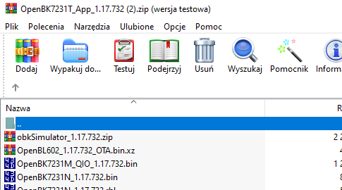

    #69 21243181
    Posts: 14782
    Rate: 12920
    Now what's wrong with simulator?
    [6:23:38 PM] [semantic-release] › ✔  Completed step "prepare" of plugin "@semantic-release/git"
    [6:23:39 PM] [semantic-release] › ✔  Created tag 1.17.732
    [6:23:39 PM] [semantic-release] › ℹ  Start step "publish" of plugin "@semantic-release/github"
    [6:23:40 PM] [semantic-release] [@semantic-release/github] › ✘  The asset output/**/obkSimulator* cannot be read, and will be ignored.
    [6:23:41 PM] [semantic-release] [@semantic-release/github] › ℹ  Published file https://github.com/openshwprojects/OpenBK7231T_App/releases/download/untagged-5d706f8097c98cd37f03/OpenLN882H_1.17.732_OTA.bin
    [6:23:42 PM] [semantic-release] [@semantic-release/github] › ℹ  Published file https://github.com/openshwprojects/OpenBK7231T_App/releases/download/untagged-5d706f8097c98cd37f03/OpenW600_1.17.732_gz.img
    [6:23:43 PM] [semantic-release] [@semantic-release/github] › ℹ  Published file https://github.com/openshwprojects/OpenBK7231T_App/releases/download/untagged-
    https://github.com/openshwprojects/OpenBK7231T_App/actions/runs/11086028096/job/30803181019
    It's in zip, so why can't it be read:
    Screenshot of an archive program window showing the obkSimulator file.

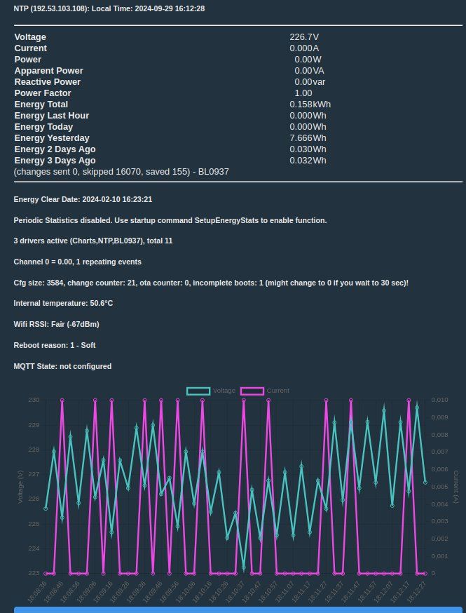

    Added after 23 [minutes]:
    LN882H with running BL0937 printing the values to charts
    The screen shows data on voltage and current with a graph for a device connected to a BL0937 driver.
    backlog startDriver charts; startDriver NTP; waitFor NTPState 1; chart_create 48 2 2; chart_setVar 0 "Voltage" "axv"; chart_setVar 1 "Current" "axc"; chart_setAxis 0 "axv" 0 "Voltage (V)"; chart_setAxis 1 "axc" 1 "Current (A)"; addRepeatingEvent 5 -1 chart_addNow $voltage $current

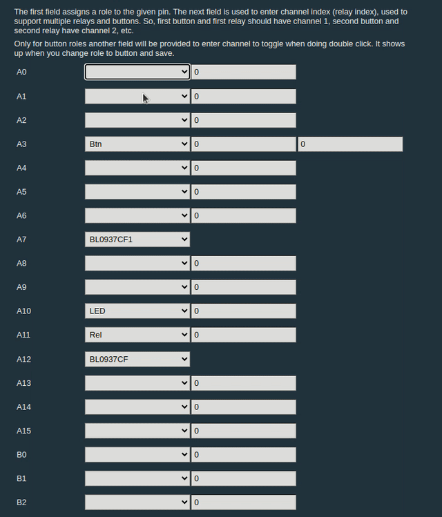

    #76 21243961
    max4elektroda
    Posts: 758
    Help: 49
    Rate: 189
    Some pin roles requires like two channel fields so I hope this change respects that
    Yes, that should work exactly as before:
    Therefore the sorted driver selection is still using the original values which are set by the enum in C code. The number of channels is linked to the original list.
    BTW: There is one entry I was wondering about: BL0937SEL_n is actually showing 1 channel, while BL0937SEL is configured with 0 channels.
    And we could even fix and shorten the text on the page:
    Only for button roles another field will be provided to enter channel to toggle when doing double click. It shows up when you change role to button and save.
    The last part ("It shows up when you change role to button and save.") is not true any more, number of needed channels now is changing together with the selected role:
    Configuration form assigning roles to pins with dropdown lists and channel fields.
  • #77 21244009
    Posts: 14782
    Rate: 12920
    SEL roles should not have any channels, please do fix it if you can.

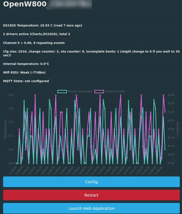

    The change worked as expected for W800:
    Drivers are usable now, DS1820 and charts are working.
    Screenshot of temperature and humidity charts for OpenW800.
    The change didn't break BL0937, at least for my LN882H smart plug.
