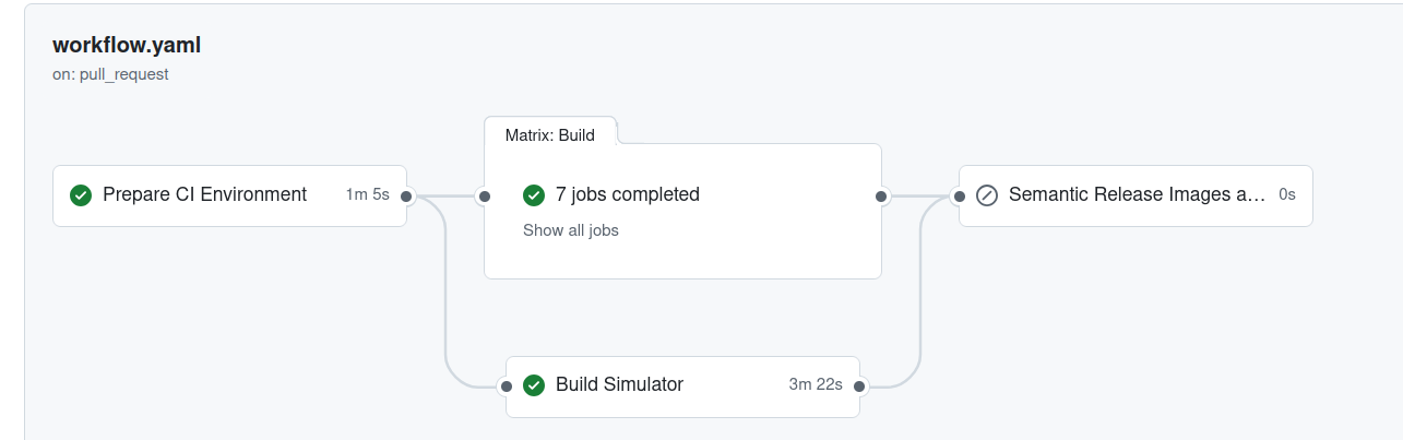

    While at it, I tried to get rid of the warnings about deprecated workflow elements.
    https://github.com/openshwprojects/OpenBK7231T_App/pull/1406
    Changing the upload/download to v4 needs to change the upload a bit:
    The artifacts name need to be unique (even if it's only a folder containing different files during upload as in this case).
    This has the (nice?) side effect, that all artifacts are build per platform:
    View of build results on GitHub Actions with warnings about deprecated elements.
    If we need one single file again, we would probably need first to do the builds and later do the upload in one step for all files.
    It seems to work for a release, too (see my tests here https://github.com/Max4OBK/OpenBK7231T_App/releases) but is not heavily tested...
    Added after 17 [minutes]:

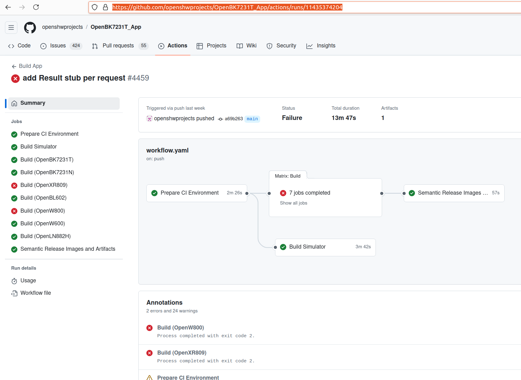

    But one thing still confuses me - if the problem was caused by "build2" finishing too late, then why sometimes also other assets were not present?
    I'm not sure, if my "fix" really is a fix, it was just an educated guess ;-)
    At least for e.g. 1.17.755 this is quite understandable, the firmware images were simply not build for W800 and XR809
    https://github.com/openshwprojects/OpenBK7231T_App/actions/runs/11435374204
    Screenshot of the GitHub Actions workflow for the OpenBK7231T_App project.
    Added after 7 [minutes]:
    ... but if you simply compare the workflow "pictures" before and after this commit, it looks better now:
    A workflow diagram showing the build process with tasks: prepare CI environment, build simulator, and semantic release.
    Now "semantic release" also is a "successor" to the simulator build, in the picture above, this build was a leaf

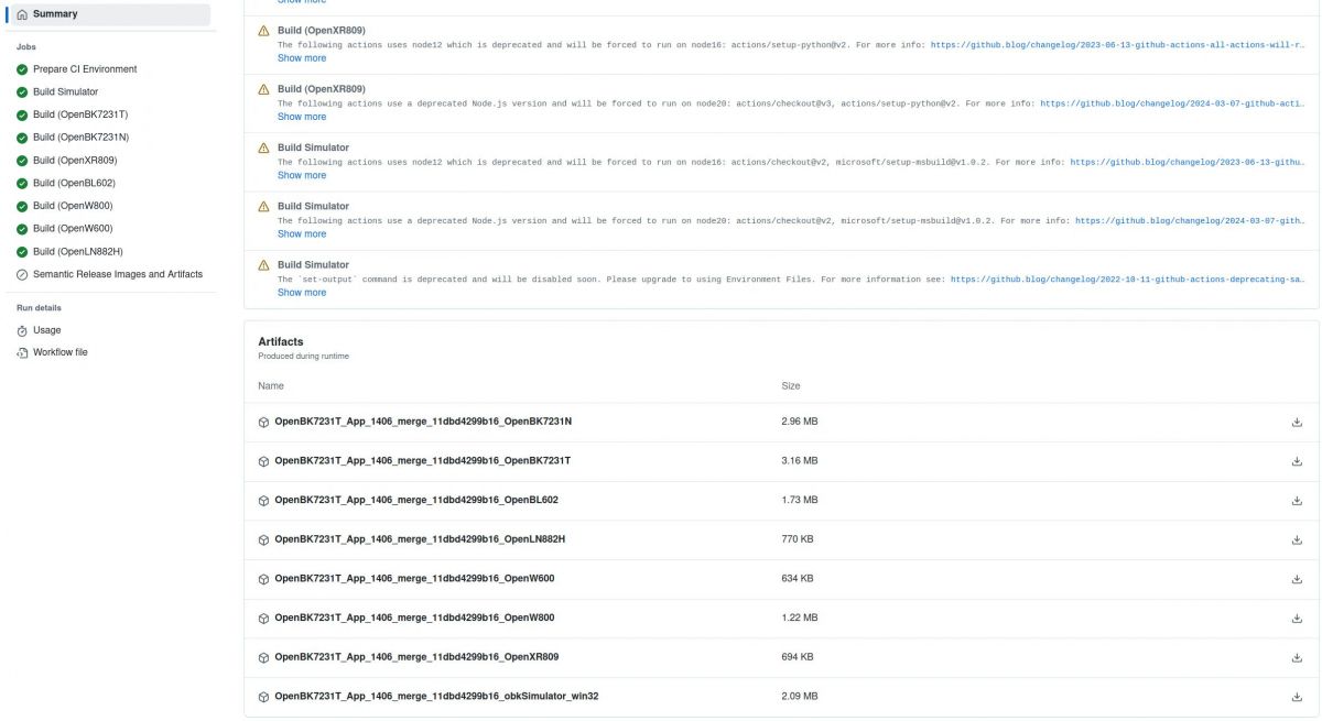

    I see a second version of fix evolved here:
    https://github.com/openshwprojects/OpenBK7231T_App/pull/1407
    With an extra merge step:
      merge:
          runs-on: ubuntu-20.04
          needs: [refs, build, build2]
          steps:
              - name: Merge Artifacts
                uses: actions/upload-artifact/merge@v4
                with:
                  name: ${{ env.APP_NAME }}_${{ needs.refs.outputs.version }}
                  delete-merged: true
    I think I will merge that one, but can you first double-check it?

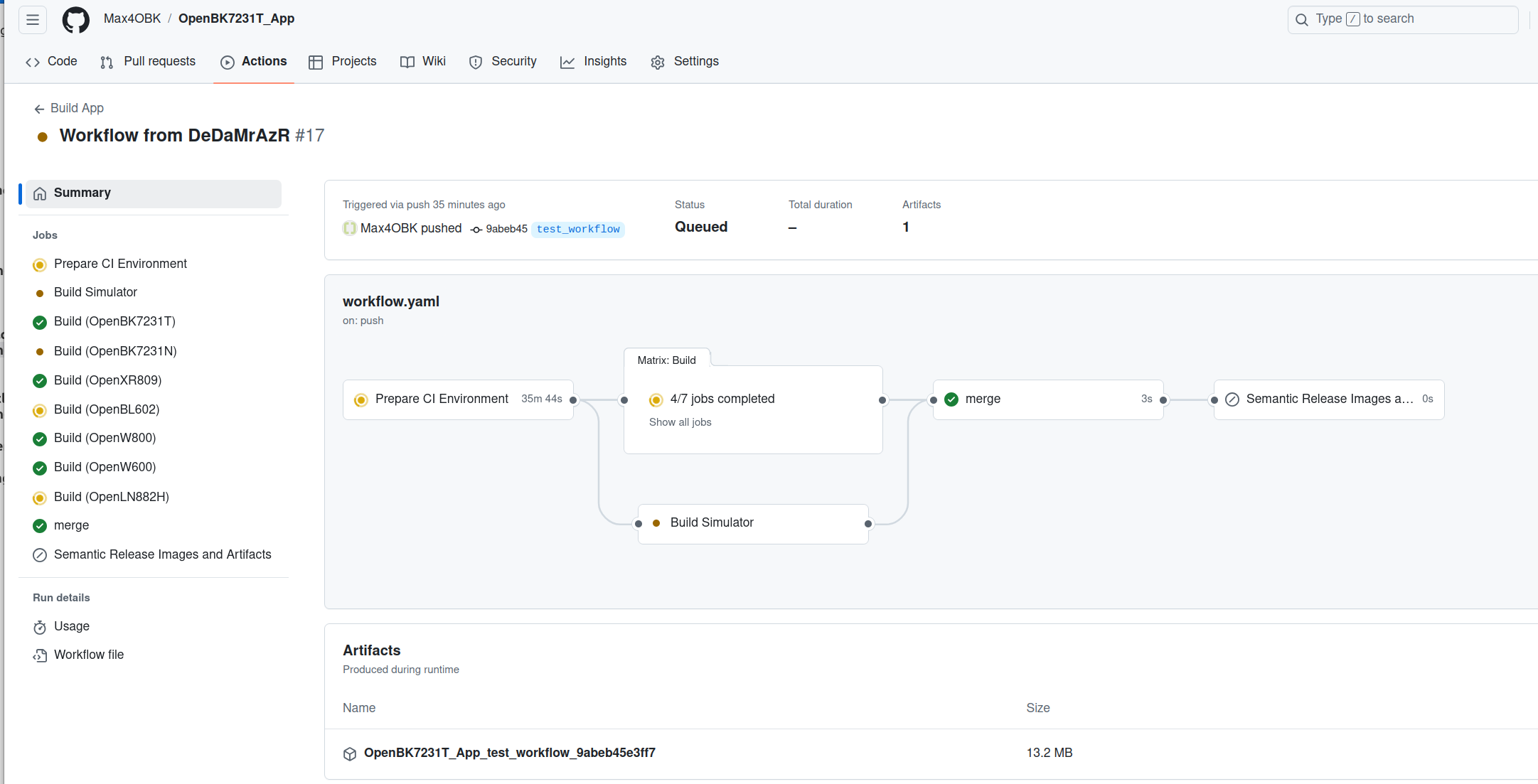

    I saw that one and it fixes all warnings as far as I can see. I just try to run it in my repository, but there is something strange with gh atm:
    workflow is running since more than 30 minutes now, can't be cancelled ...
    Will report back later if it's working again.
    The actual state is, that even after I tried to cancel, it runs further???
    And this is strange, too: it claims "merge" was run, even though the steps before are not complete ?!?
    Window displaying the progress of a CI workflow on the GitHub platform.
    But I'm quite sure, there is something strange on GH. "Update": Just now, the workflow finished - after 46 minutes!

    Thanks again, it works as expected!
    "My request" would be a simple "keep merged files" - see my comment in GH, too.
    This way we keep the possibility to download all artifacts as before and have the "plus" of selective download.

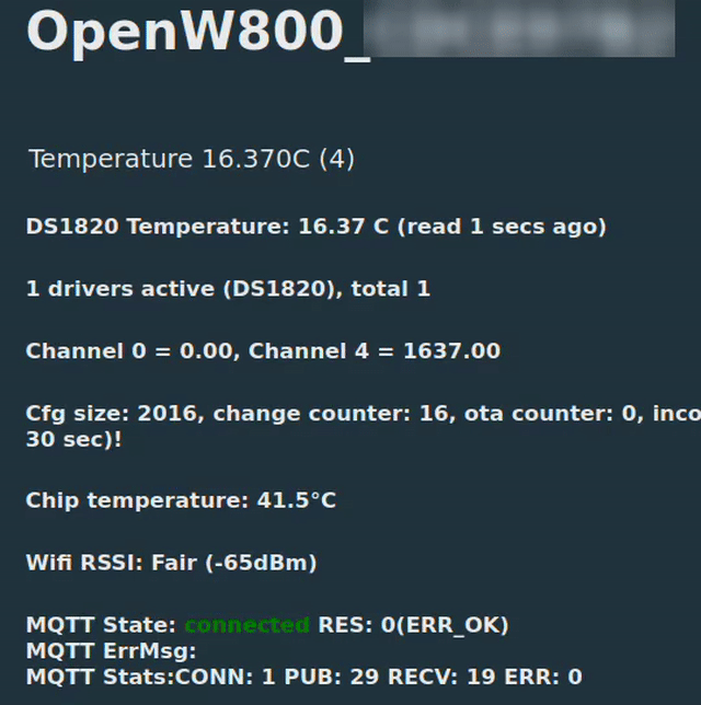

    I included (for testing) a 30 seconds invalidation of the temperature in PR #1416.
    Will be set to "-127.00 °C" as invalid/undef temperature. Mainpage will show "-" then (but the channel will show -12700.00).
    Screenshot of the OpenW800 interface displaying a temperature of 16.37°C and details about DS1820 status, channels, and MQTT connection.
    And how can we change the MQTT behaviour? It will now report the "invalid" temperature -127° in case there was no valid temperature read, but it should report "nothing" or "invalid" or whatever is a "standard" in this case. Maybe @p.kaczmarek2 has an idea? How are the other temperature sensors handling this case?

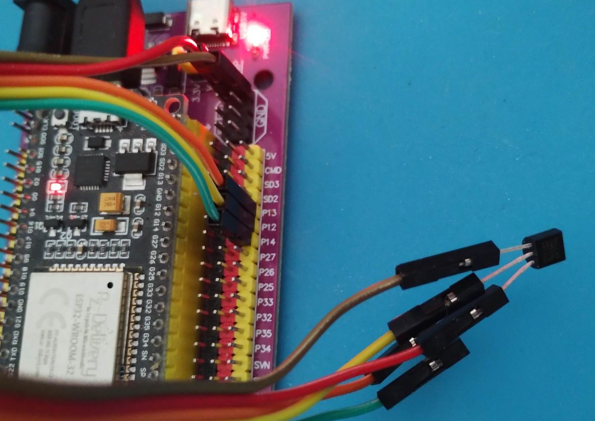

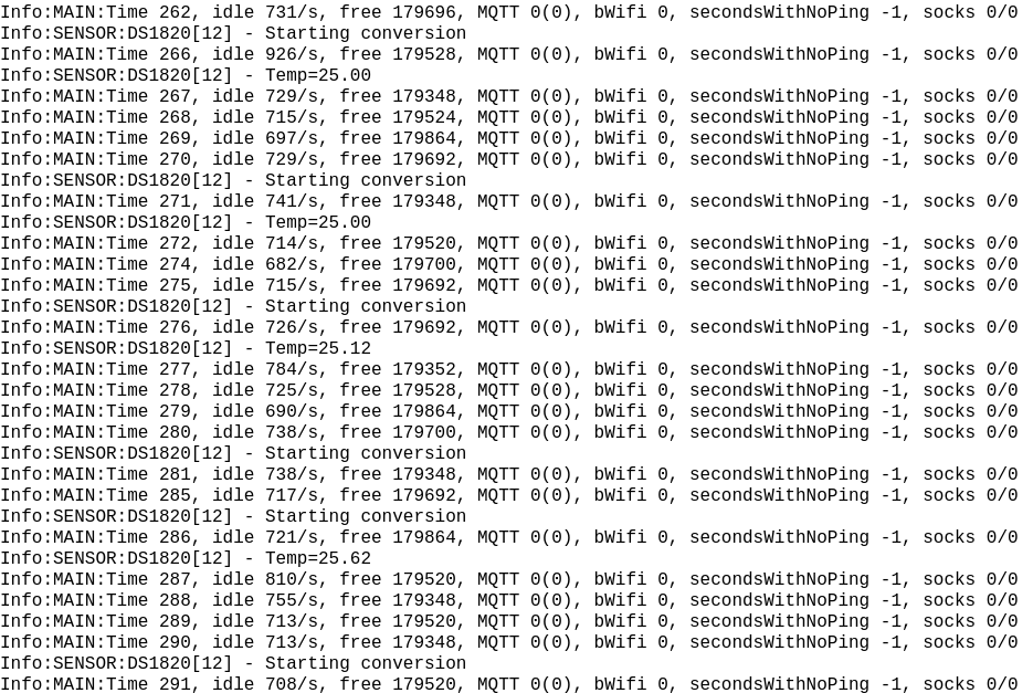

    Is it possible to poll DS1820 driver? Or is there any other way to make it work without pull up resistor like it is possible using Tasmota?
    The idea would be driving data pin up before making request for data. This way the sensor does get enough power to do the job using 1-wire connection.
  • #145 21932626
    max4elektroda
    Posts: 758
    Help: 49
    Rate: 189
    Just connect it We use a pulled-up input, it should work usually without pull-up (at least for one sensor)
    ESP32 board with jumper wires on a pin-labeled carrier, plus a TO-92 sensor on three leads
    Screenshot of system logs showing DS1820 readings and MQTT and Wi‑Fi status lines.
  • Removing the S2 capacitor enables 1-wire use

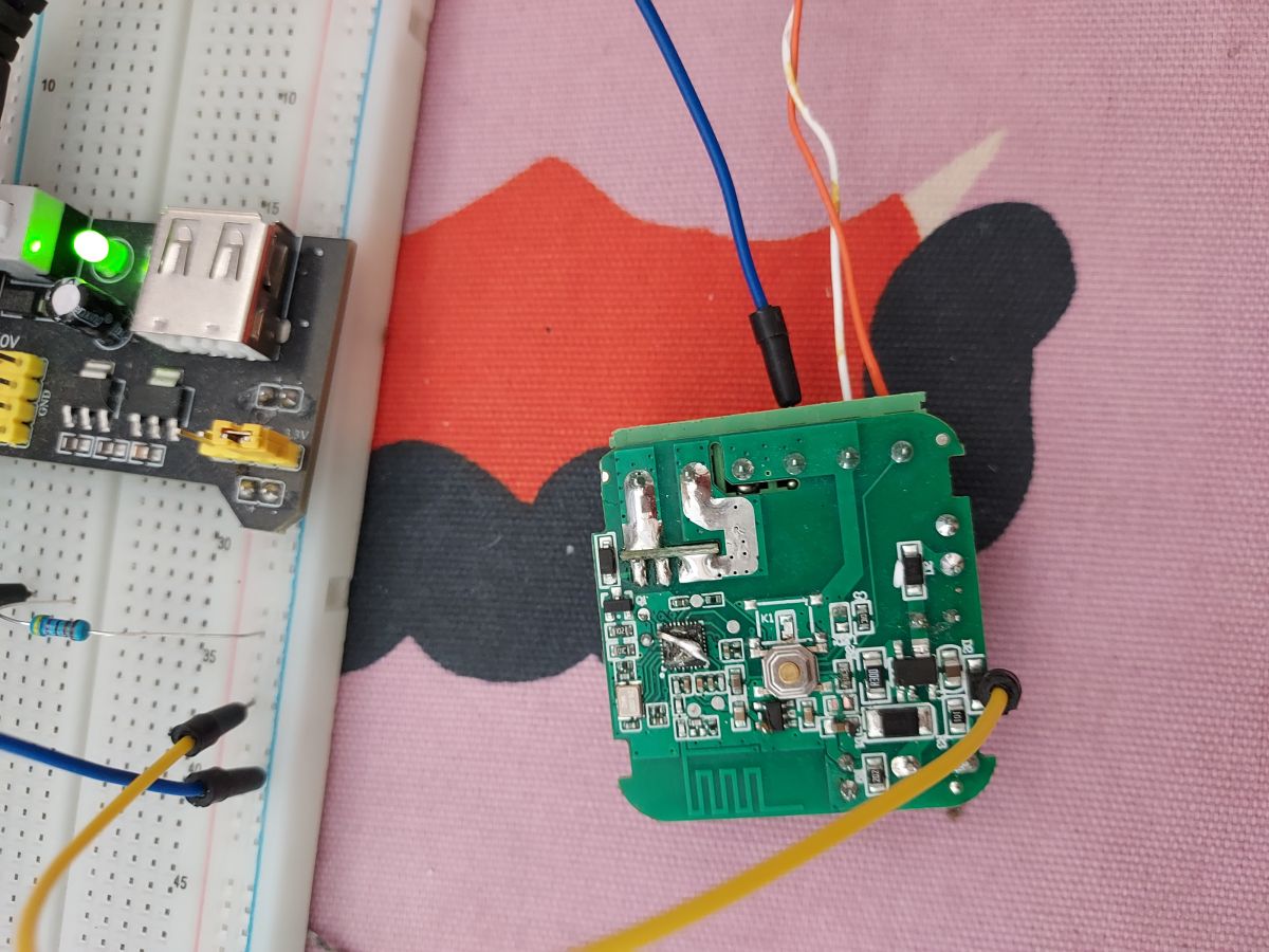

    Tilator
    Posts: 139
    Rate: 13
    >>21932626 >>21932626
    OK. So it is there already.
    How to create a custom driver for OpenBeken with online builds (no toolchain required)
    I actually took an old WiFi mini switch and removed one capacitor related to the S2 connector. In this picture there is a black resistor east from the push button right next to it and an empty space south from this resistor. That's where it used to be. Between S2 line and ground.
    Now it works just fine as an 1-wire connection. The orange wire is for signal (S2) and white is ground.
    It makes it easy to use use this kind of a mini switch with 1-wire connection at least what concerns DS1820 sensor. No extra resistors or jump wires. Just one capacitor removed and sensor connected using S1 and S2.
  • Using S1 and S2 for 1-wire DS1820 connection
    #147 21932653
    max4elektroda
    Posts: 758
    Help: 49
    Rate: 189
    But you must be aware that one these lines will probably be connected to the life wires, if used (as designed) in a high voltage environment!!
    You must ensure the lines are protected against being touched!!!
