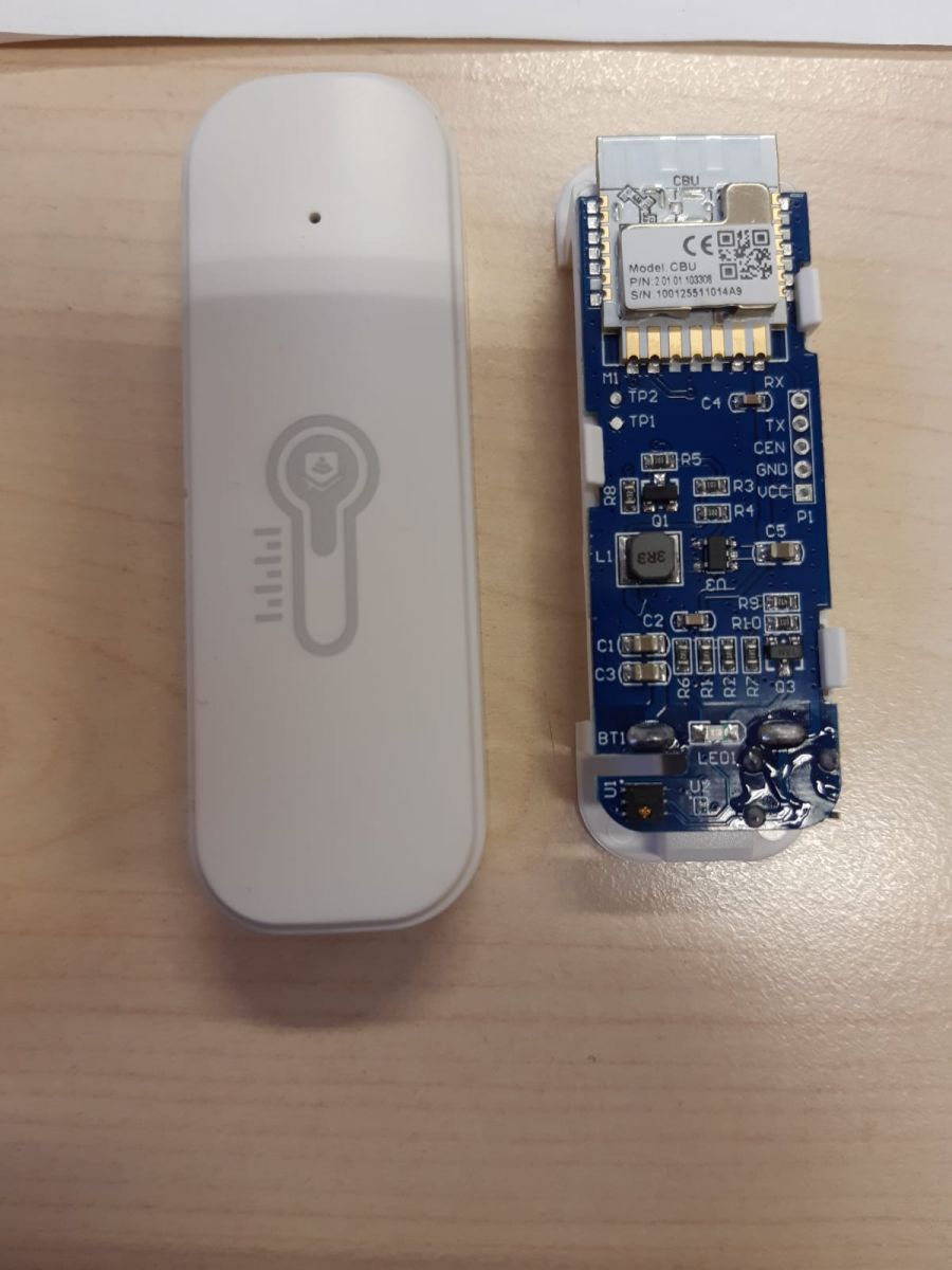

    Posts: 8

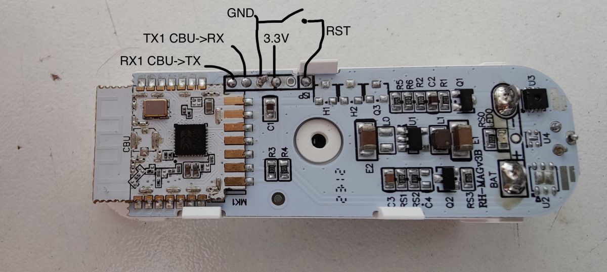

    Your RX and TX is connected correctly. Your orange connected to 18 it is a reset pin ... ok but you will need male connector.
    Next you need to connect 13 GND and 14 VCC and connect to USB dongle for powering.
    Here is a simple picture
    Close-up of a circuit board with markings for TX1, RX1, GND, 3.3V, and RST connections.

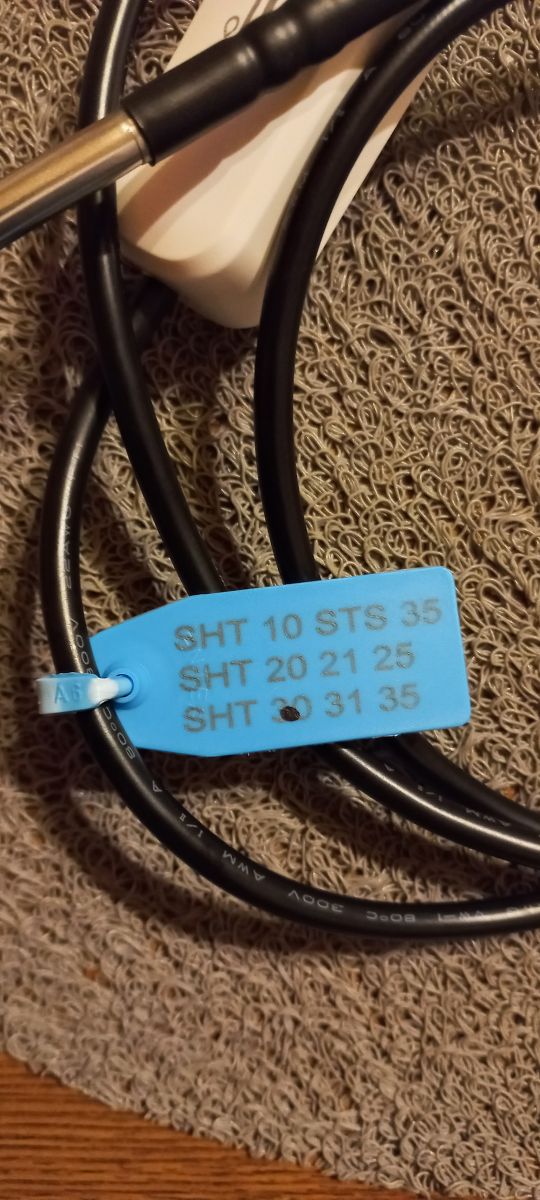

    Hello Gentlemen I need to swap the sensor so that it has an external probe, does it only fit sth30 or will another one come up without flashing the prock later. ??
  • #225 20777183
    Posts: 14767
    Rate: 12907
    Without changing the firmware, you will not connect another sensor.
  • #226 20777201
    Rafael22
    Level 21  
    Posts: 383
    Help: 42
    Rate: 172
    That is, I have to search by sth30 cable

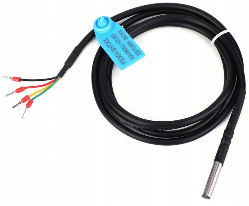

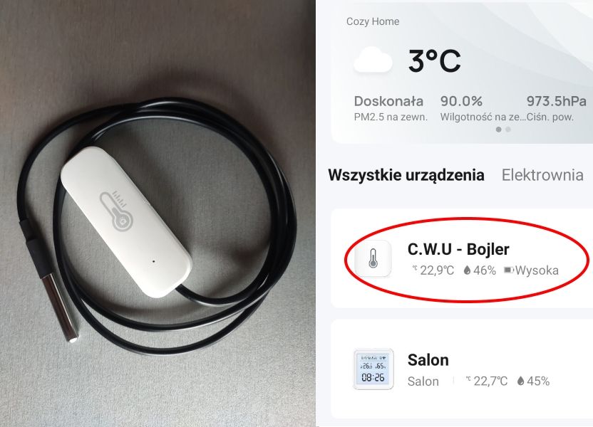

    This is my understanding. Yesterday on FB in the Tuya group someone presented that he swapped to an external probe and it works, but he does not want to provide a link or the name of the probe.
    I found on allegro Soil Temperature and Humidity Sensor FS304-SHT30 (shipping from china)
    Digital output, I2C interface
    FS304-SHT3x soil temperature and humidity sensor with cable.
    and in those temp sensors TH01 or whatever it is called there are different sensors not only SHT30 ?
    photo from Facebook of this guy
    The image shows a white temperature sensor with a cable and an app screen displaying temperature and humidity data. .

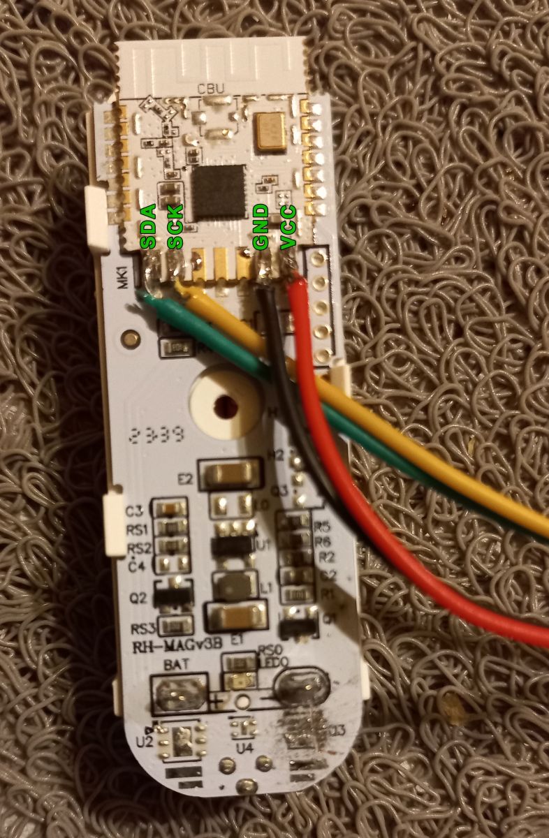

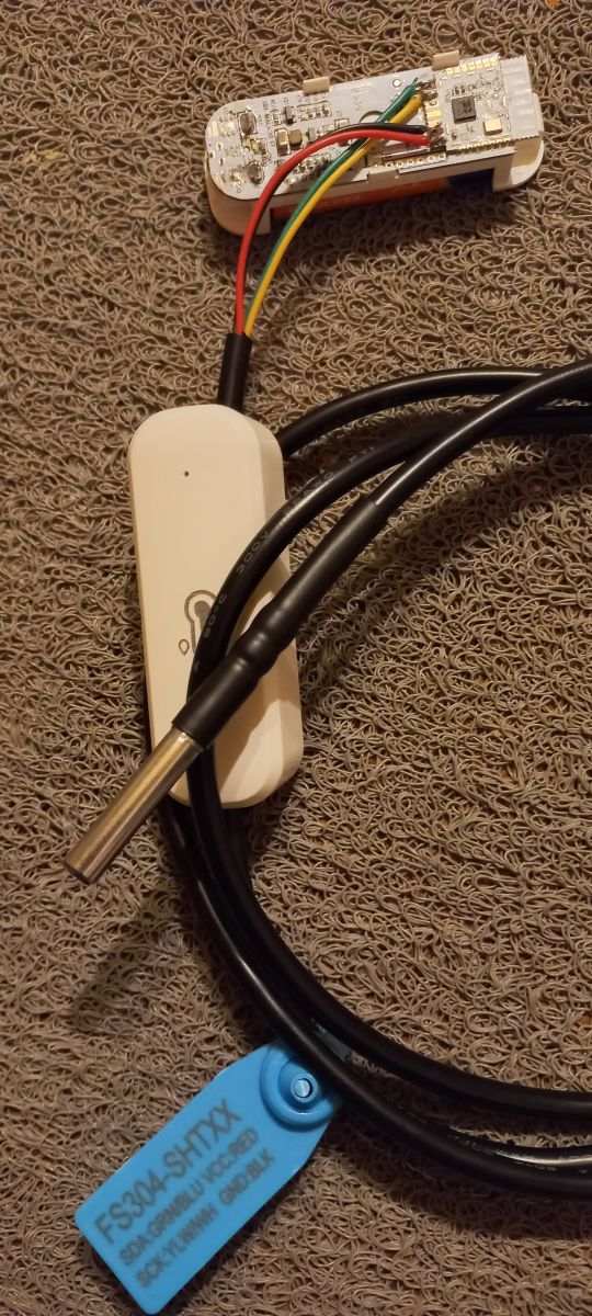

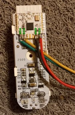

    Hello. The SHT30 transplant was successful, although I have a slight problem.
    I desoldered the original SHT30 using a plastic welder.
    Attempts to solder the probe cables to the PCB pins in place of the original sensor ended in failure for me, the pads were too small for me.
    I soldered the wires in other places according to the photo.
    The probe reads the temperature, a slight correction would be useful, but that's not the problem.
    The problem is that it doesn't refresh the temperature. I waited over 45 minutes and no change, the change occurs when I press Reset.
    I don't know if I did something wrong or what.
    Close-up view of a PCB with probe wires soldered to different points. SHT30 probe connected to a PCB with soldered wires. Sensor with SHT wires and a label.
    Edition
    The temperature updated after an hour. It's strange because it seemed to me that this sensor updates every 15-20 minutes

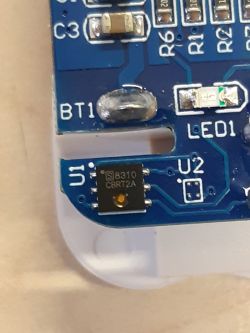

    kuba4321234
    Hello, can you help me identify this sensor? I don't think it is STH30
    Image of a circuit board section with a component labeled 8310 CBRT2A. Electronic sensor disassembled into parts, showing PCB and casing. .
