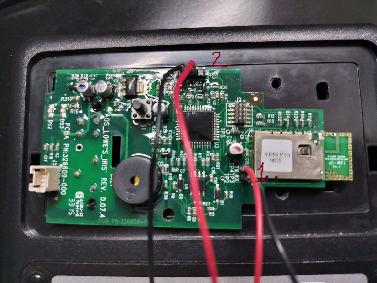

    So, I got an IRIS dongle and opened it immediately. It has an IC to decode the CEA protocol and an ISM43362 Wi-Fi module from Inventeksys to send the data away. Right next to the Wi-Fi module, there are two holes for the RX and TX pins (the usual 0.1" header, marked with 1) and the 3.3V / GND pins on the 5-pin header, which is 2mm, marked with 2 (pin3 - 3.3V, pin 4 - GND, pins 1,2 show 3.3V as well, but they are not connected to the VCC pin of the wifi module - use at your own risk).
    Close-up of an opened IRIS hardware key with visible electronic components and wiring.
    I hooked up a UART adapter (I used ESP32) to take a peek at what was going on. The config for ESP32 is below.

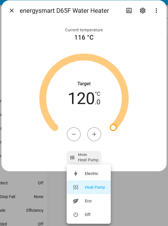

    The EnergySmartBridge service sends a couple of MQTT messages reporting the status of the heater controller. Nice, but very limited. This guy (https://github.com/starsoccer/energysmartbridge) extended the bridge and unified it with a reverse proxy. I couldn't get his reverse proxy to work, so I took his source code for the bridge only (https://github.com/starsoccer/energysmartbridge/tree/master/energysmartbridge/src) and copied it to EnergySmartBridge/EnergySmartBridge, which was created following the steps here https://github.com/excaliburpartners/EnergySmartBridge . Stop all the containers created by EnergySmartBridge, delete their images, repeat the build and start procedures (don't forget to update EnergySmartBridge.ini). Now, watch the UART logs. Once it connects, you should see new topics in the MQTT explorer, particularly the "homeassistant/water_heater/C47F5101D65F/config", where you can set the configuration. Primary it defines the "mode_command_topic": "energysmart/C47F5101D65F/mode_command", and the "modes": ["eco", "heat_pump", "electric", "off"]. You can either send things directly to this topic via mosquito, or you can create a climate entry in Home Assistant: (120C is actually 120F; when I set the heater to C, it behaves strangely - I will explore more)
    EnergySmart D65F water heater control interface displaying temperature and mode selection options.
    Now you can change the mode! Note that the dongle connects to the bridge only once every 5 minutes. So, if you change the mode in Home Assistant, don't rush to the heater to confirm; wait until the UART logs show another successful connection. Now plug it into an automation, and you're awesome! Now, you can disconnect the UART monitor.
