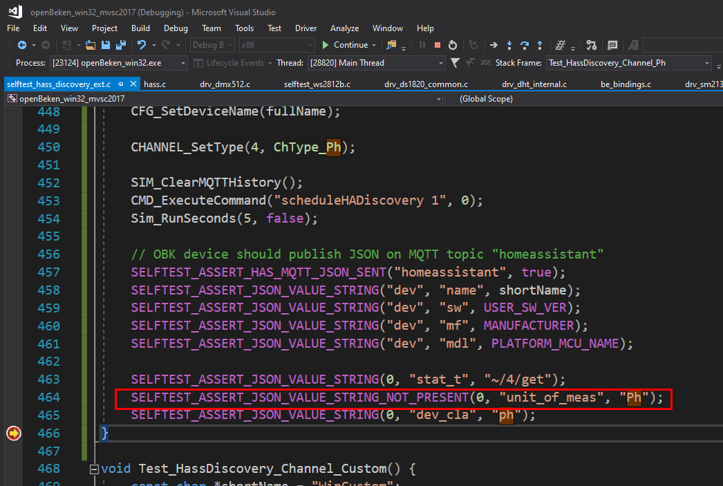

    After removing the attribute using the MQTT Explorer, it worked again for a few days. It seems as if the firmware resets the unit_of_meas attribute after a few days. But not with every update.

    Ok, I've tested, and I am confident that unit_of_meas is NOT published for Ph channel type in the current release version.
    This self test is passing:
    Screenshot from Visual Studio showing unit test omitting unit_of_meas for ChType_Ph
    This is what is send:
    Are you really sure that unit_of_meas gets added for ChType_Ph channel type, specifically?

    Perhaps HA discovery was not re-run and HA picks previous discovery config?

    I am not sure right now, but the safest bet would be to remove device entirely and repair via HA Discovery.

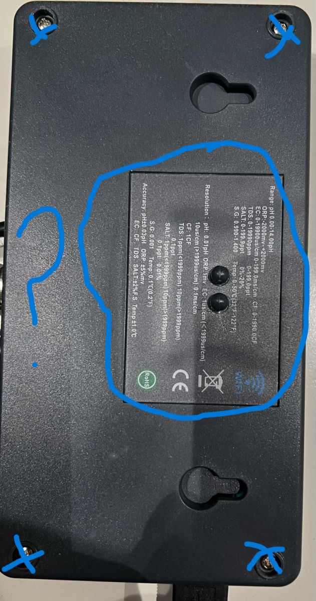

    Wojmik82
    >>21131505
    Hello, I would like to know how you managed to get inside? Are there any hidden fixings on the inside? I have unscrewed the 4 main screws, but there is still something holding it in place. Could you please give me a hint? I would like to check what chip is in my version.
    Thanks in advance for your help, Maciek
    Back of black electronic device with marked label panel and mounting screws.
