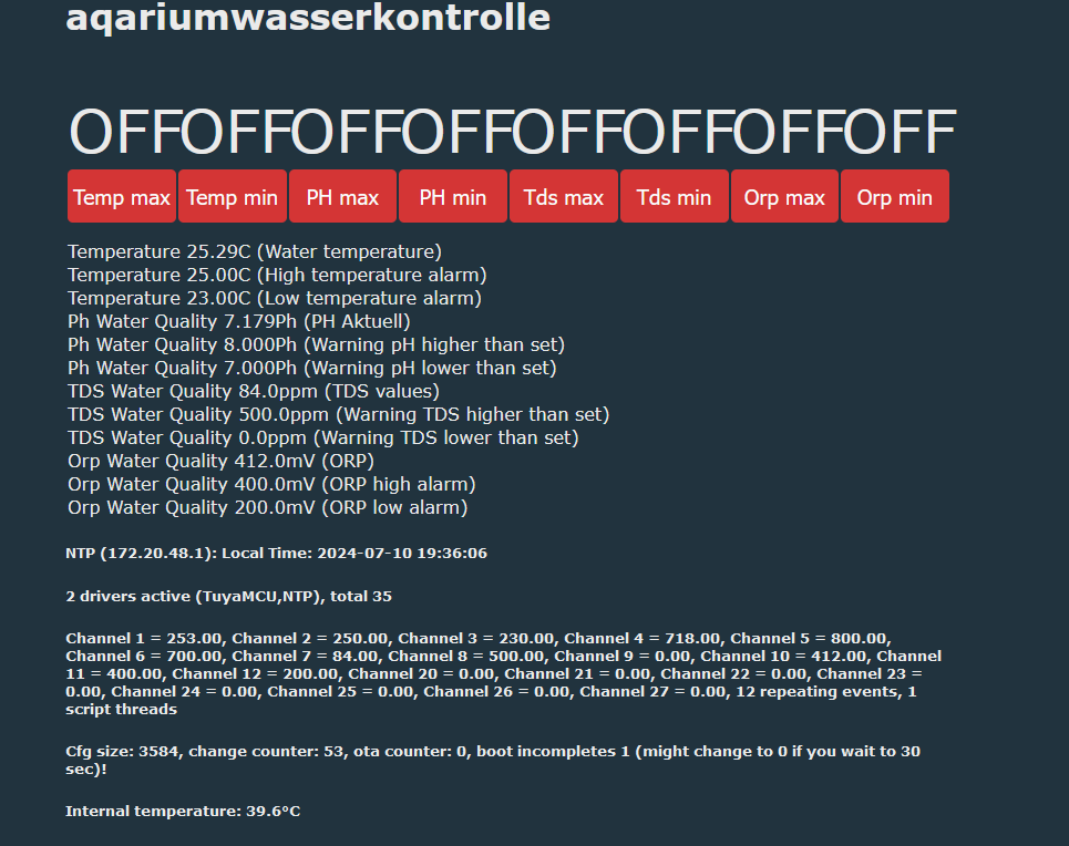

    product_information_valid=0 so aussehen  product_information_valid=1

    The device display shows all data
    But in web and MQTT everything stays at zero
    I can set hosts manually with fakeTuyaPacket but they are not updated

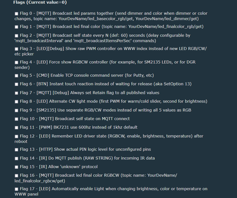

    Which flags should be set can you export them and post them here

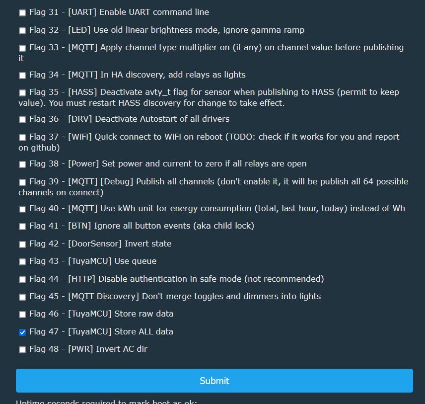

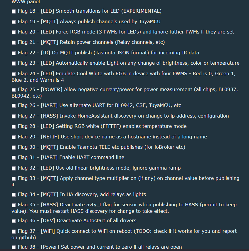

    Nordlicht77 wrote:
    it shows a host but unfortunately this host is not updated
    What do you mean?
    Are you sure you have it deselected?

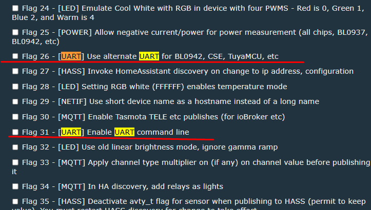

    Screenshot of a user interface displaying checked and unchecked options related to UART configuration flags.
  • #46 21144347
    Nordlicht77
    Posts: 67
    once with and once without
    List of configuration flags for LED parameters with settings related to MQTT, LED, PWM, and others. WWW settings panel with a list of configuration options and flags. Settings list with TuyaMCU Store ALL data checked.
  • #47 21144446

    Nordlicht77 wrote:
    I did a reset and re-flashed which flags should be on
    I think you don't have physical connection on RX/TX lines between WiFi module and the MCU.
  • #50 21144988
    Nordlicht77
    Posts: 67
    Info:TuyaMCU:ProcessIncoming[v=0]: cmd 0 (Hearbeat) len 7
    Info:CMD:[WebApp Cmd 'fakeTuyaPacket 55aa00000000ff' Result] OK
    Info:MAIN:Time 11472, idle 204160/s, free 68152, MQTT 1(1), bWifi 1, secondsWithNoPing 1, socks 2/38
  • #51 21145018
    Posts: 14771
    Rate: 12914
    No, you can't do that.
    You can't use fakeTuyaPacket . It fakes a packet from TuyaMCU to WiFi module. This is useless in your case. You need to get a true heartbeat from physical MCU.
    Are you really sure that you have no shorts (or missing connection) on RX1/TX1? Can you show a photo?

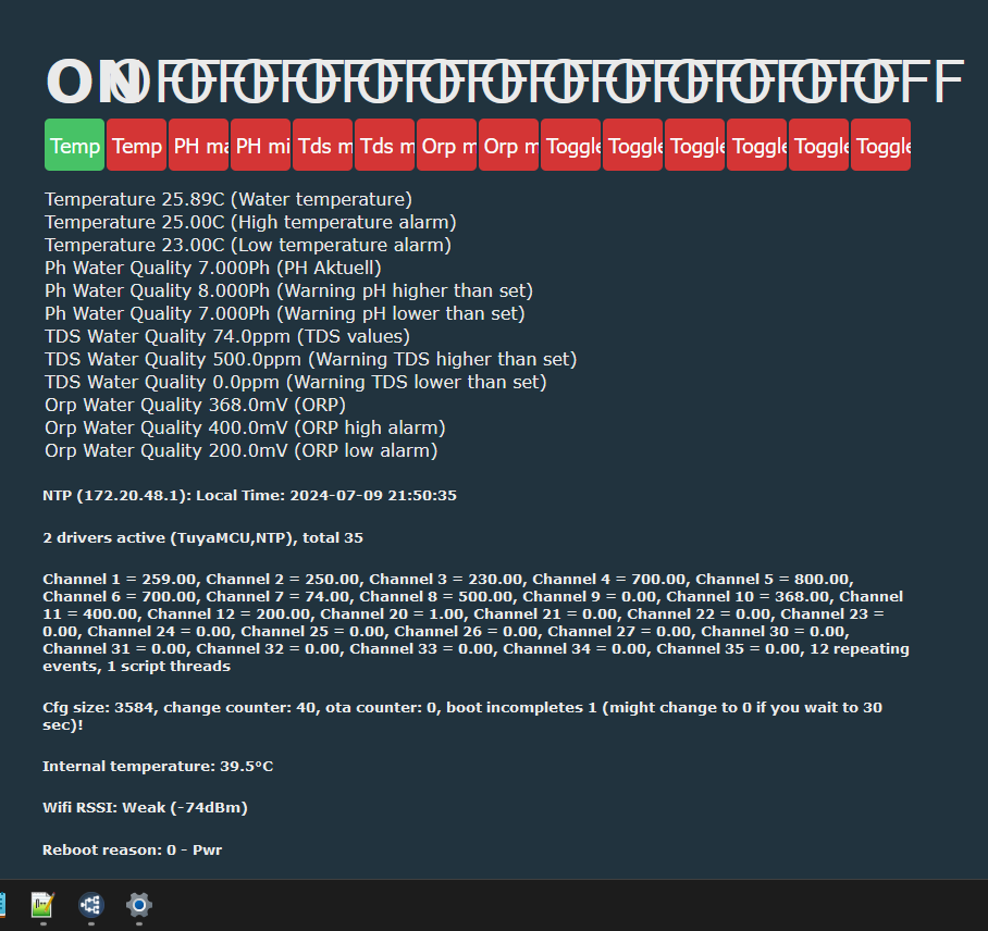

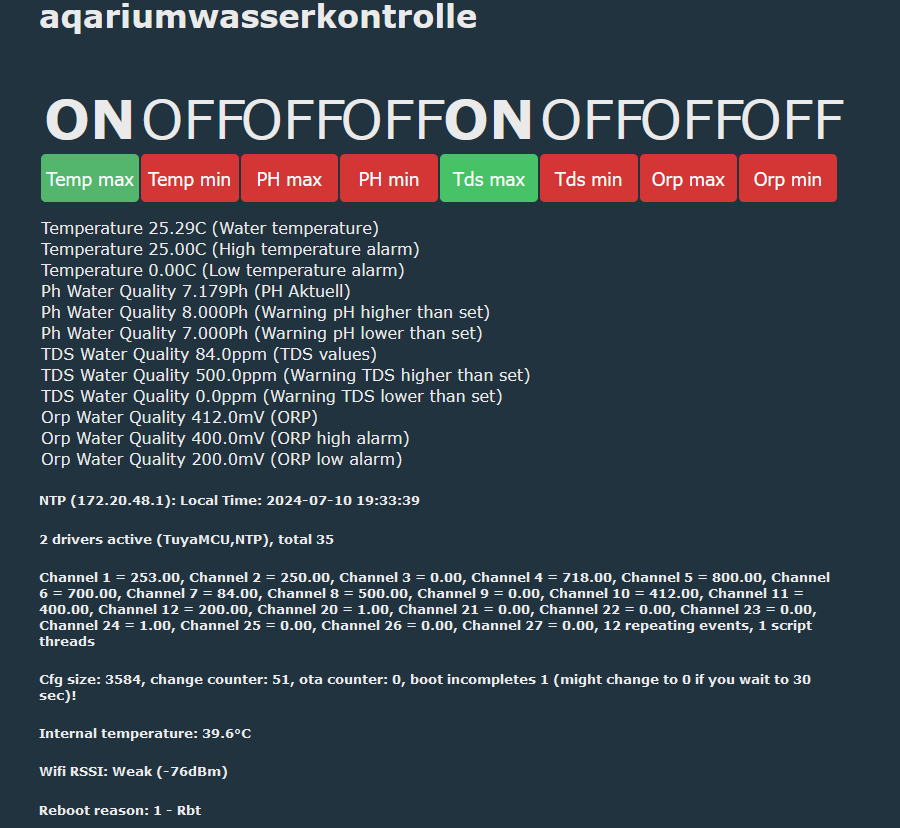

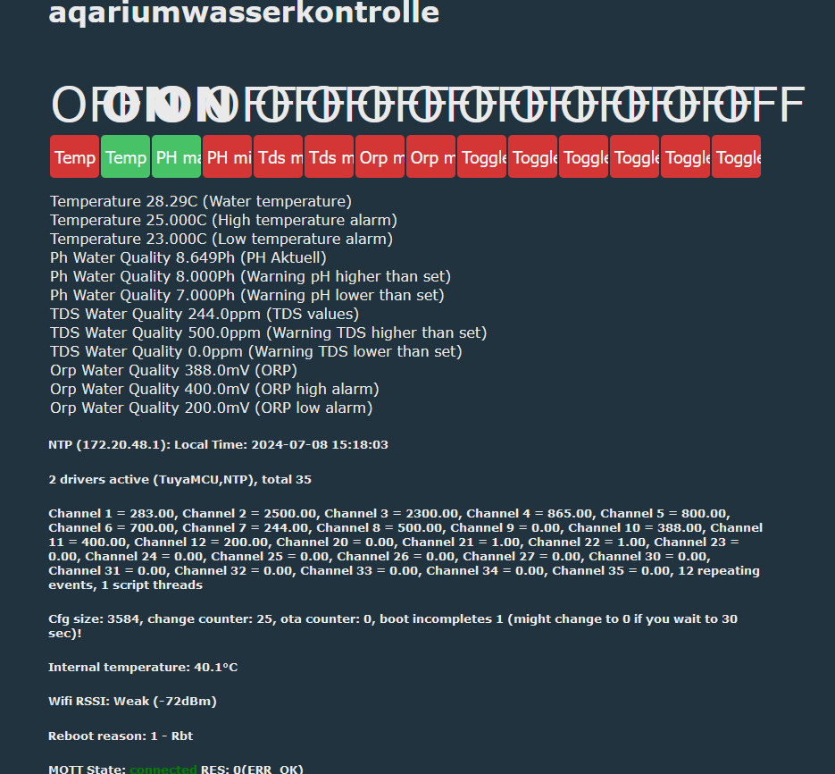

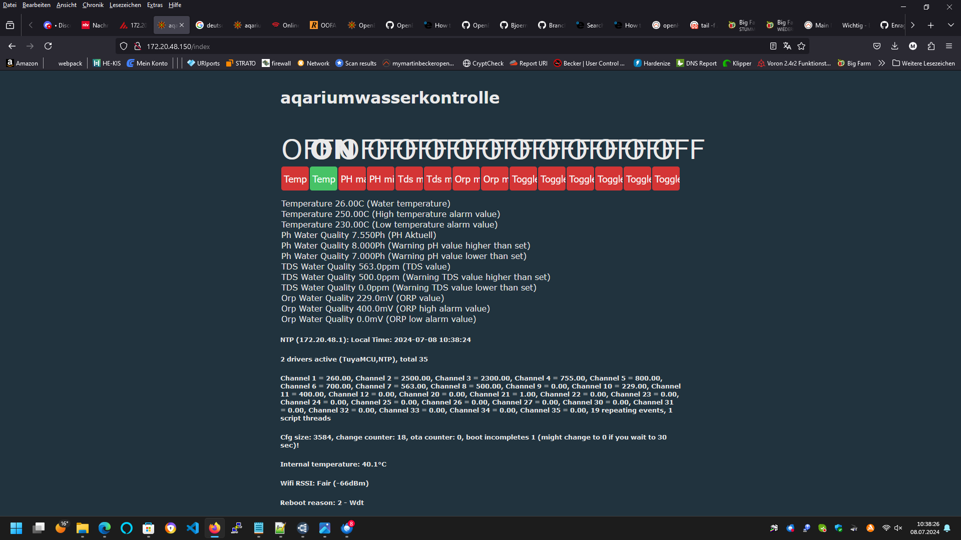

    #52 21146858
    Nordlicht77
    Posts: 67
    I got further, it was really a small hairline crack because I could only see with a magnifying glass
    I cut off the tip with a jumper wire and bridged this point with soldering
    Now I still have the following problem
    Can you remove the word Toogle from Buttom name?
    There is a limit because of the button, see picture
      Aquarium water quality control app screen displaying temperature, pH, TDS, and ORP values with Toggle buttons.
    My code looks like this so far

    I am happy to hear that you've solved the RX/TX trace problem. As I said, I suspect that is the issue.
    I can try to organise it better.

  • Initial state sync and temperature formatting issues
    #54 21147000
    Nordlicht77
    Posts: 67
    have changed it
    Now I only have the problem that not everything is set at the first start
    have it with me
    Tried addRepeatingEvent doesn't work either
    and at temperature I have another formatting problem
    see image
    Screenshot of an aquarium water control interface displaying various parameters such as temperature, pH, TDS, and ORP with status buttons.
    Code: Arduino

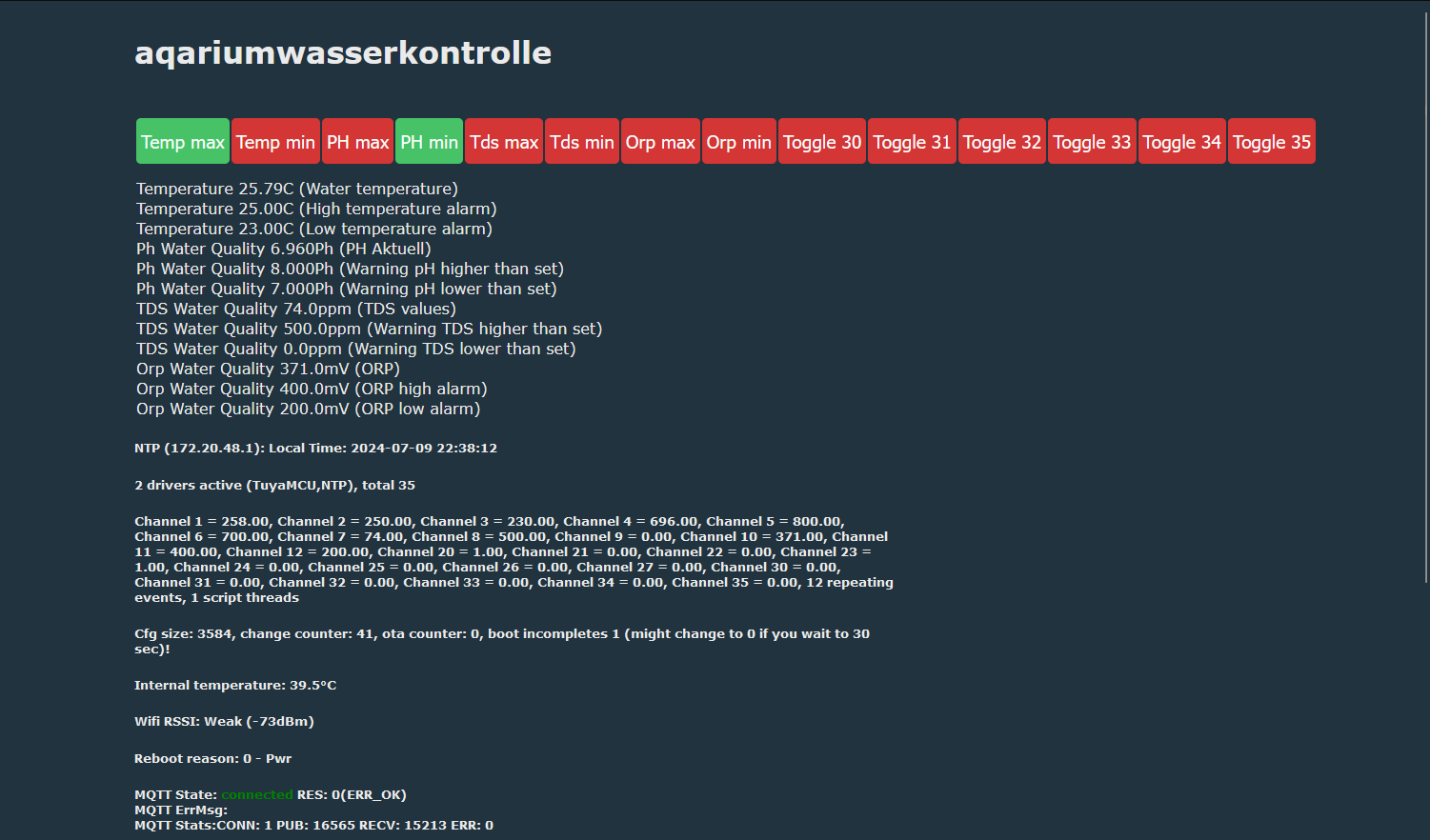

    delay_s 15 go so that the values ​​are all loaded otherwise two or three were always missing
    Now the format problem is still like in the picture Temp Max and Temp min must look like temperature
  • #57 21147300
    Posts: 14771
    Rate: 12914
    Maybe just change temperature_div10 to temperature_div100?
  • #58 21147346
    Nordlicht77
    Posts: 67
    Now the point is correct with temperature div 100 but now there are three digits and not two
    with fakeTuyaPacket it was correct
    Aquarium water parameters control interface with buttons and measurement data.

    #59 21148556
    Nordlicht77
    Posts: 67
    tuyaMcu_sendState doesn't run reliably for me;
    it always doesn't set some values ​​after a restart
    but not always the same
    I even went with Deley S 25
    If there is a temperature format error, I'll go back to the two on fakeTuyaPacket
    because otherwise the if loops won't work

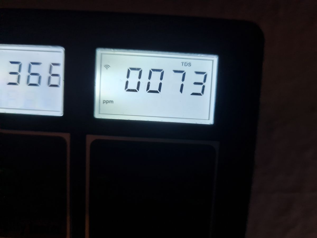

    Hi
    For me the output of TDS not correct
    See photo
    How to Change Firmware on PH-W218 WiFi 8-in-1 Water Quality Tester with CB3S Chip?
    I don't know what it's like @Upright6771

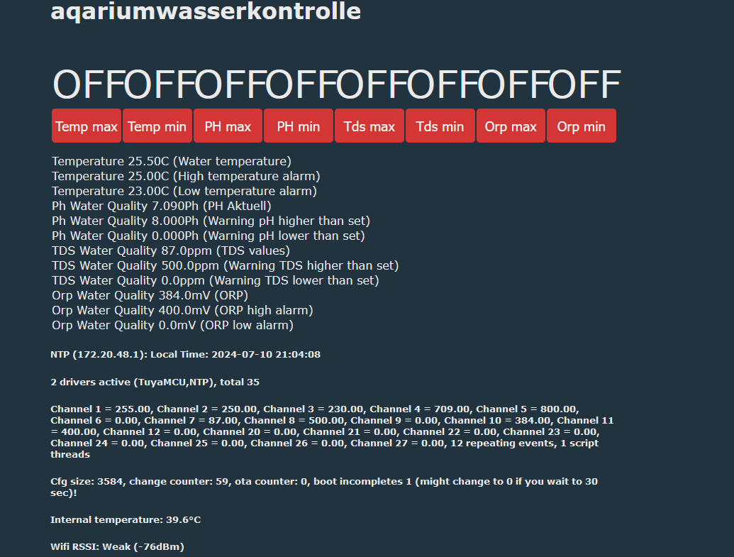

  • TDS values still mismatch the display
    #60 21150277
    Nordlicht77
    Posts: 67
    I tried again with tuyaMcu send State, unfortunately not everything was sent sporadically, see photo after various restarts
    Now have tuyaMcu_setBaudRate 9600
    Added clearIO now the Gui looks different
    Also temperature min and max after changing 2300 to 230 the host is correct
    Now it's just the TDS values ​​that don't match the display
    The status via the Bottom On / OFF would be nice if it could be deactivated using a flag
    Screenshot of an aquarium water control panel with various parameters and statuses. Screenshot of an aquarium control software panel with water metrics. Screenshot of an aquarium water parameter control interface.
