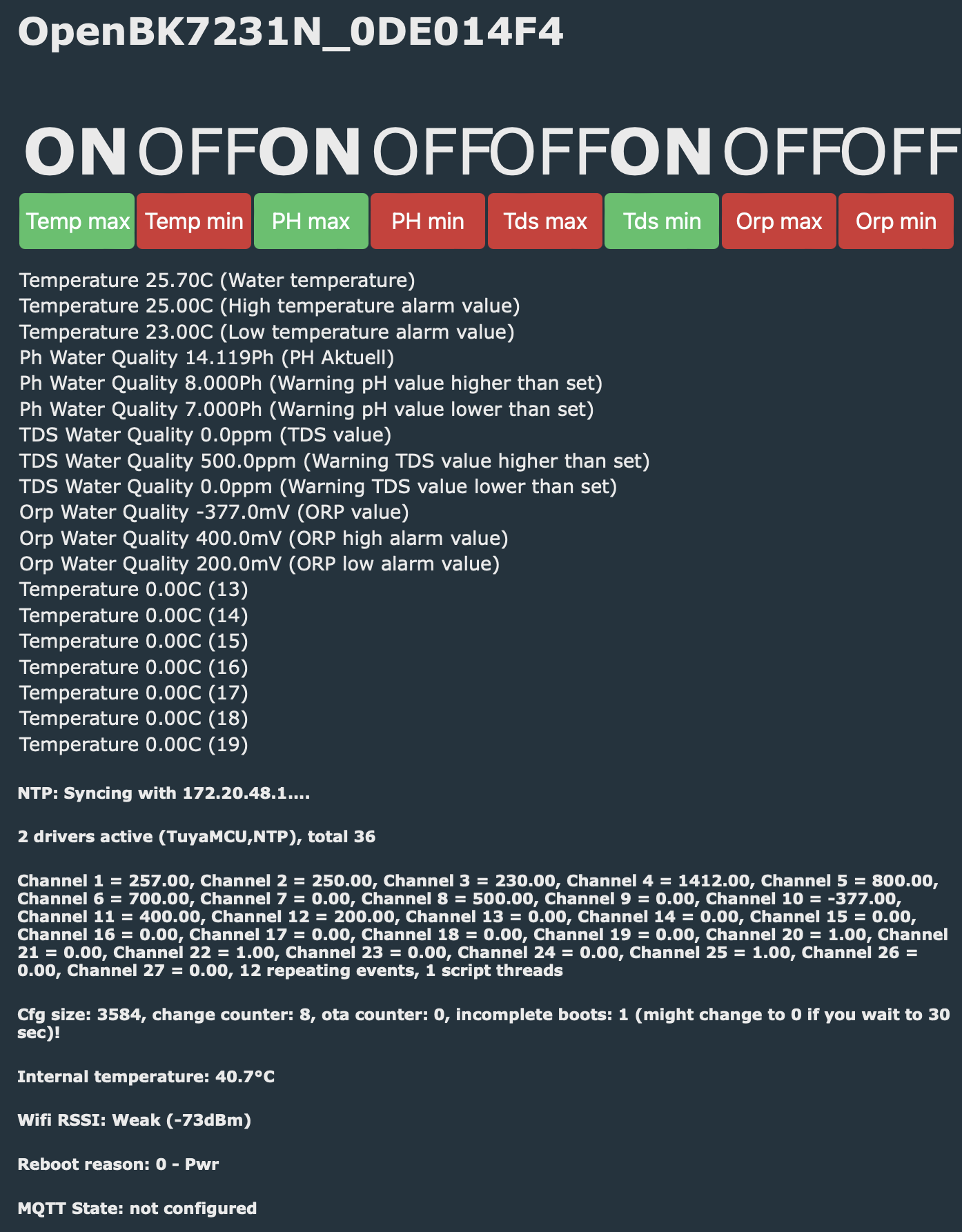

  • Flashed MCU but batch script output differs
    #64 21198642
    alfredtorch
    Posts: 6

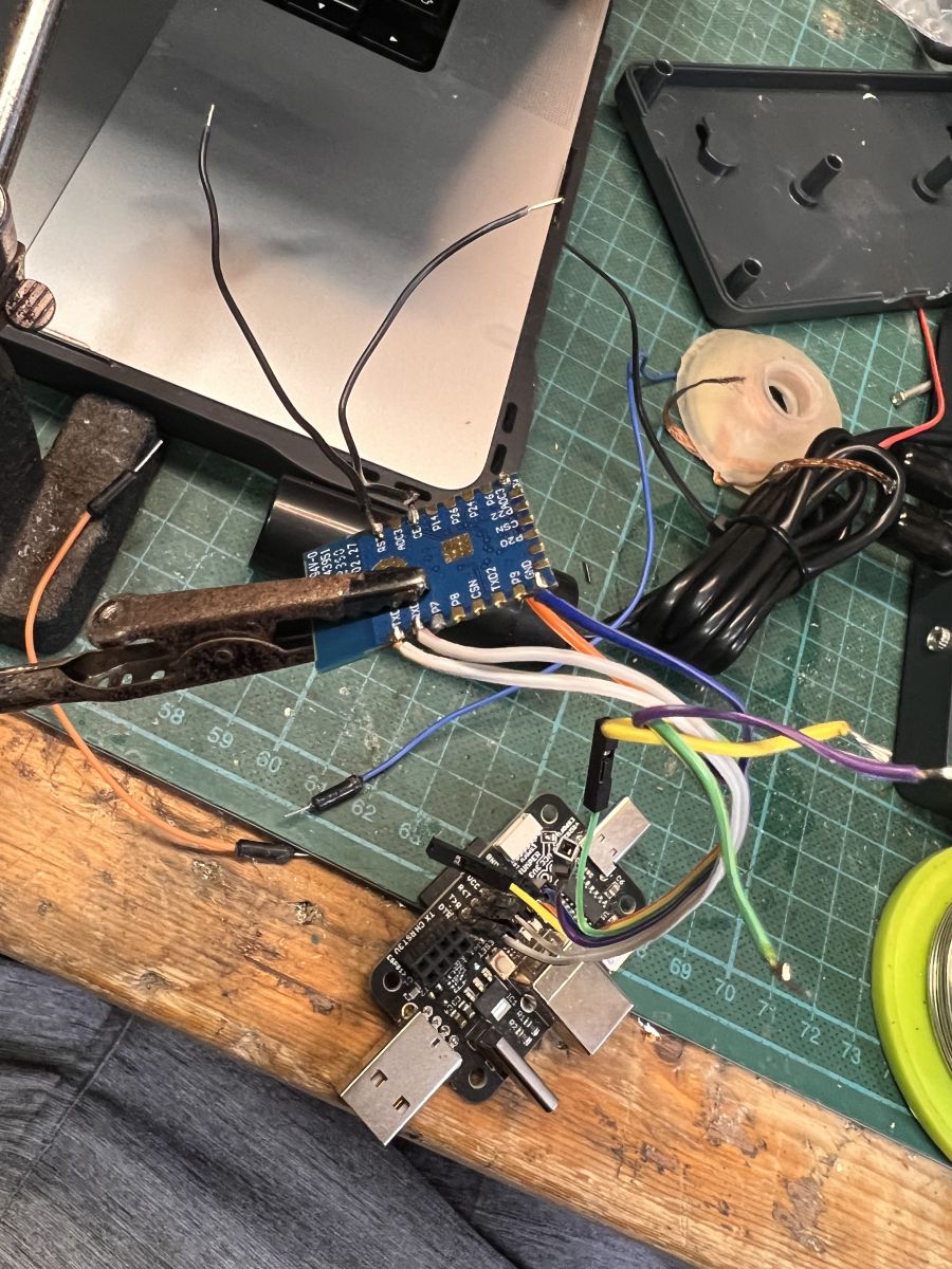

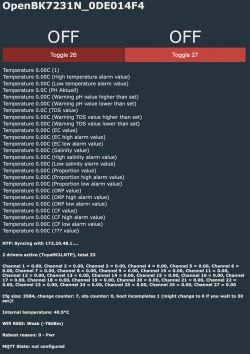

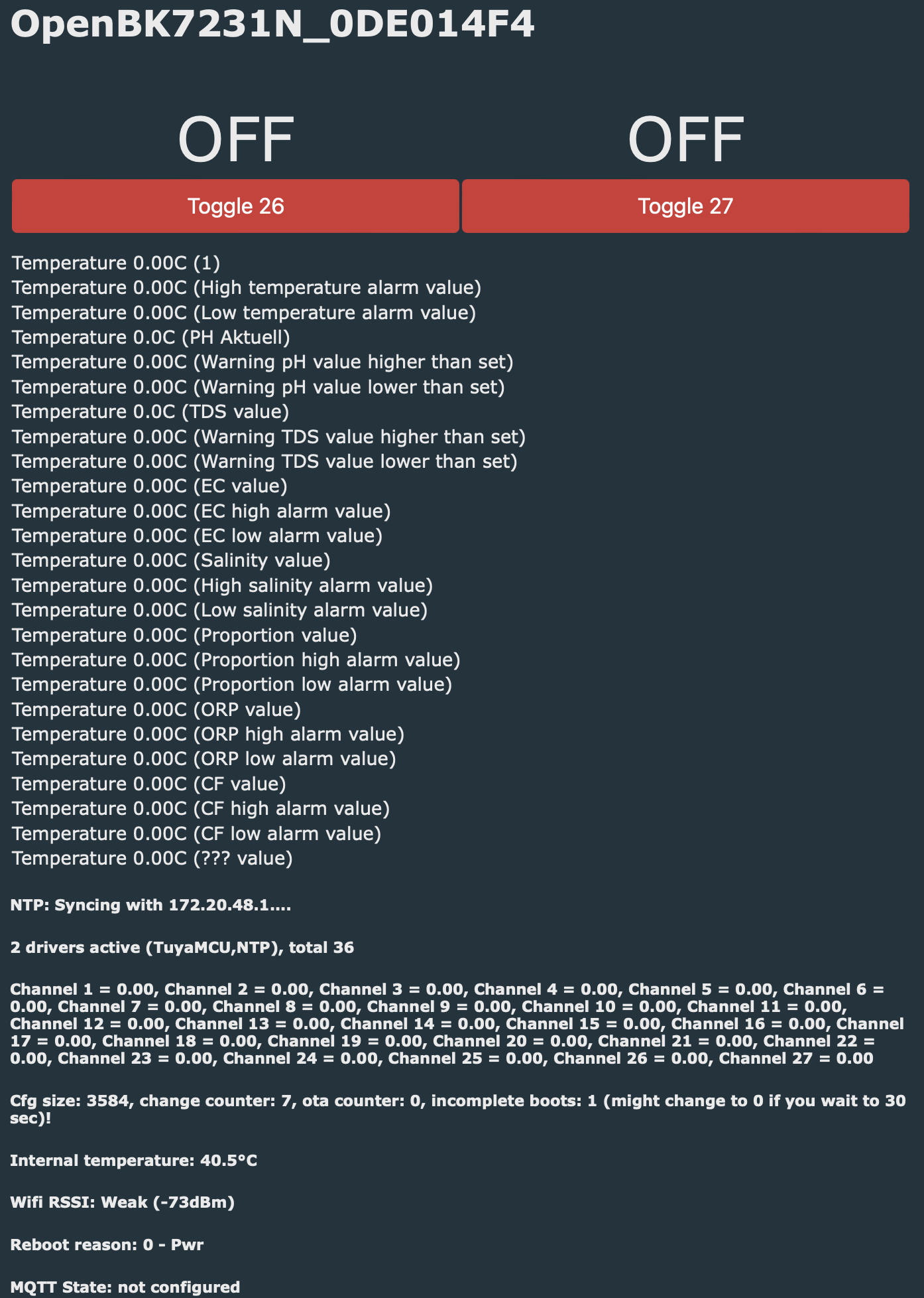

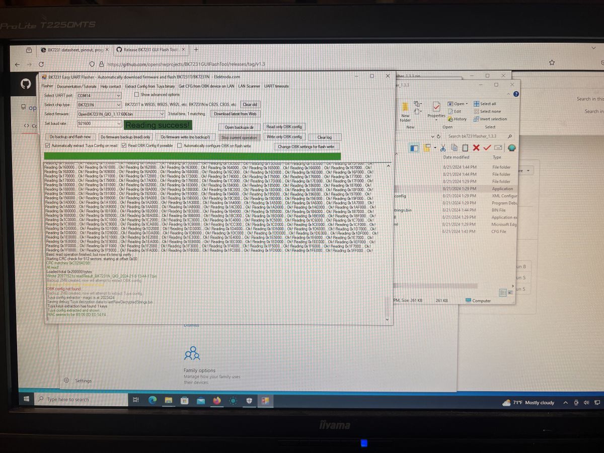

    Hi,
    Completely new to OpenBeken, I was able to desolder the MCU and flash a new firmware on it.
    However, I used the current bat script and I don't have the same output.
    What should I do?
    thank you
    Max
    Screenshot of the OpenBK7231N user interface showing sensor status and settings.
    Microcontroller on a workbench with connected wires. Computer screen displaying the BK7231 firmware flashing tool and a file explorer window.
  • #65 21199762
    Posts: 14771
    Rate: 12914
    Remove starting of tmSensor driver in autoexec.bat. Someone must have put it there by mistake.

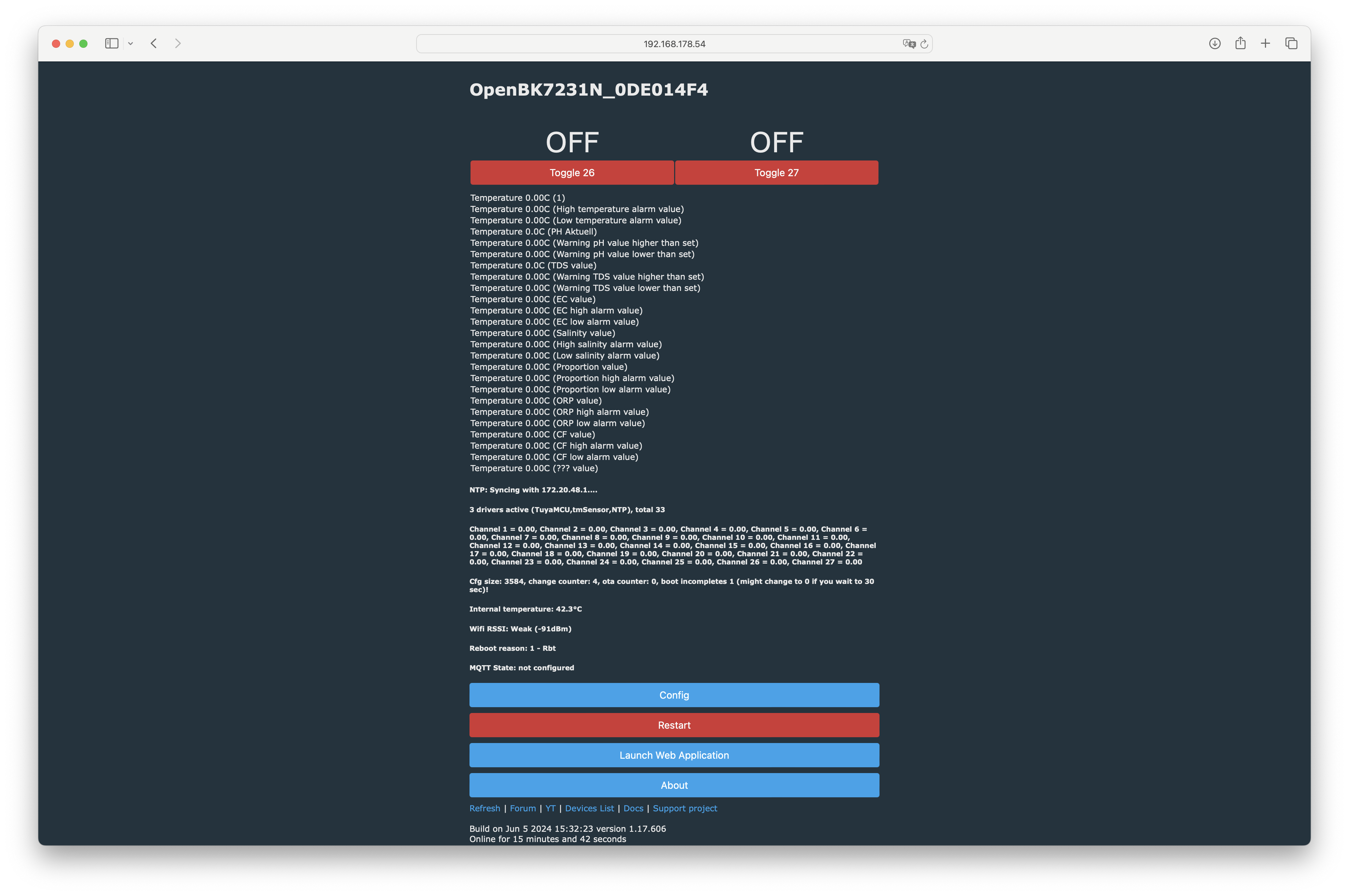

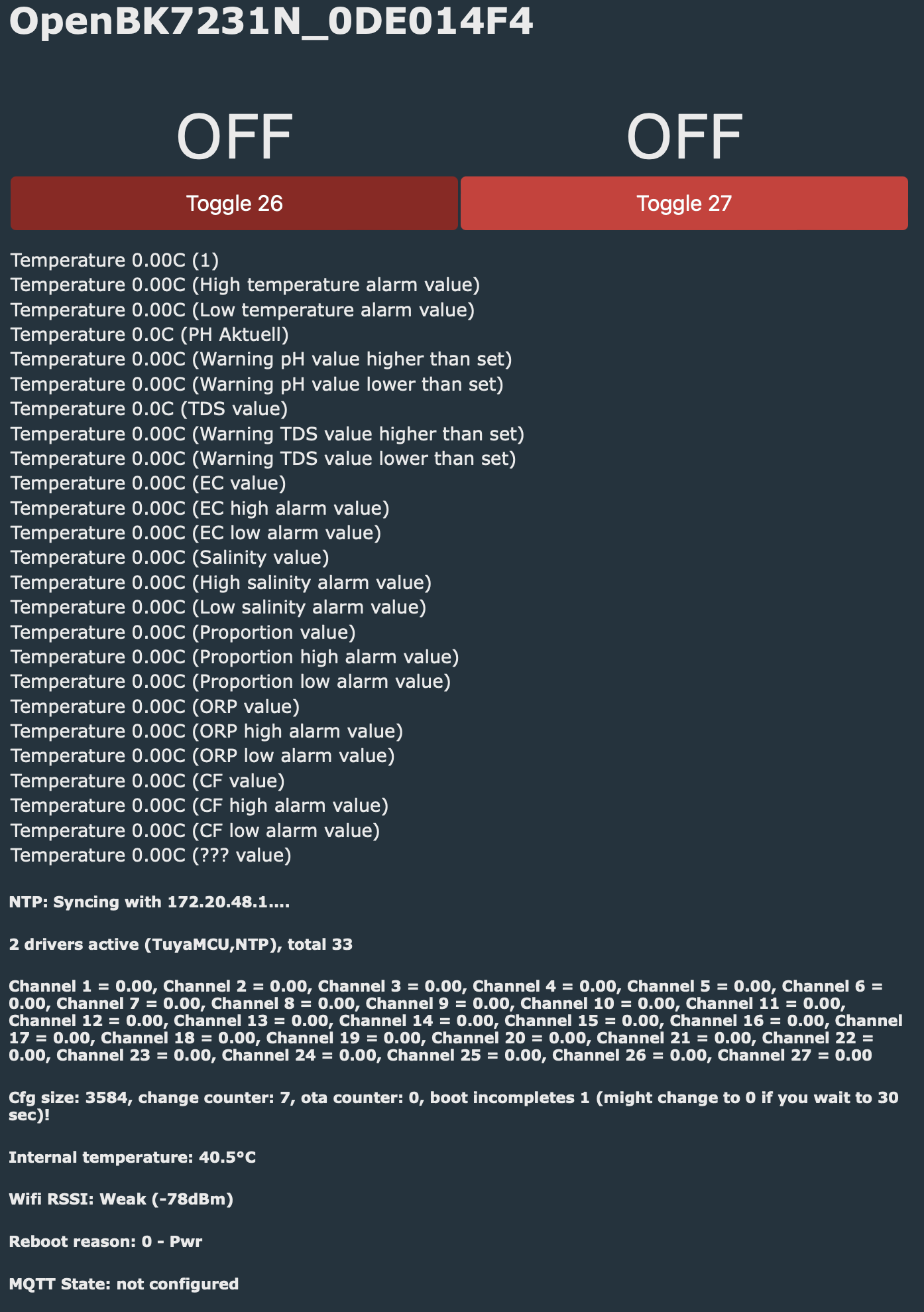

    alfredtorch
    Posts: 6
    Thank you for your feedback. I made the update in the bat file. However, it didn't solve the empty values. How can I check the communication with the Co-MCU is working?
    Maybe the issue origin is a weak solder connection. Do you think it's hardware or more software related?
    Sorry for all my questions. I'm new to OpenBeken and wondering about its ingredients.
    Have a great weekend
    OpenBK7231N user interface showing temperature readings and switch statuses.
  • #67 21201832
    Posts: 14771
    Rate: 12914
    Is the WiFI module connected physically to the MCU? Some people desolder WiFi module and forget to solder back the pads.
    What is happening in the Web App log, are there heartbeat packets from TuyaMCU?
    Maybe you need to change baud to 115200?

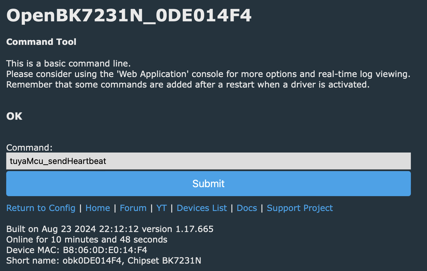

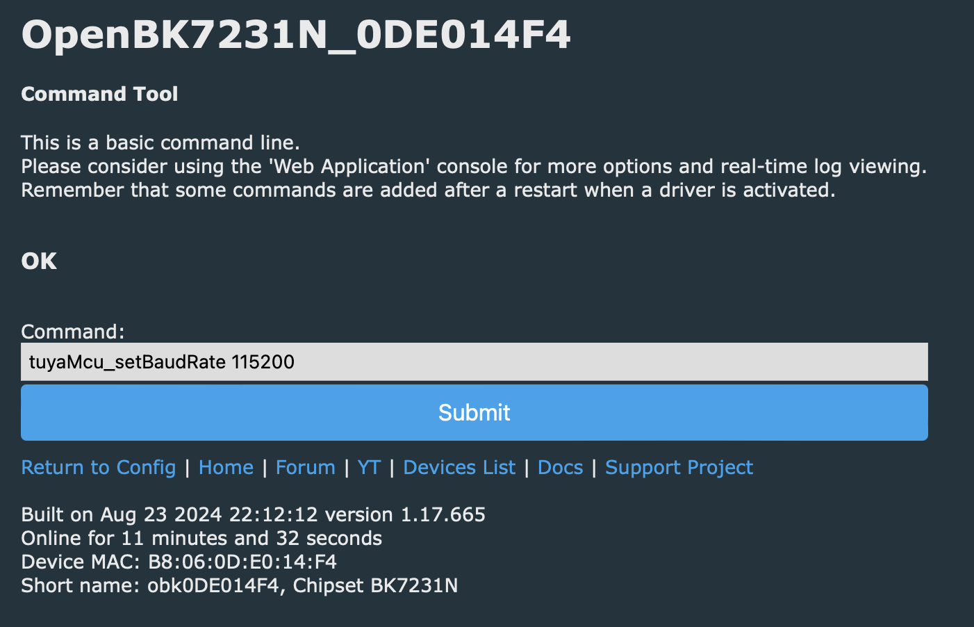

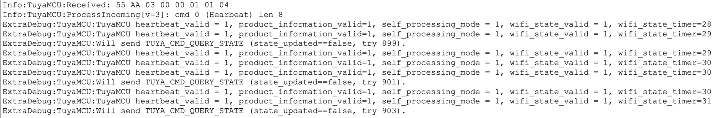

  • Questioning heartbeat response and missing firmware step
    #68 21202760
    alfredtorch
    Posts: 6
    Thank you for your fast reply.
    HeartBeat responded with an OK. Is this the expected result? Does this mean that the baud rate is correct?
    I changed it to 115200. However there is no value change in the dashboard
    The only thing I did is to upload the firmware and the autostart.bat procedure.
    Is there a crucial step missing?
    Screenshot of OpenBK7231N_0DE014F4 Command Tool showing confirmation of the tuyaMcu_sendHeartbeat command. Screenshot of the OpenBK7231N_0DE014F4 command tool interface. User interface showing the status of two switches and measurements of temperature, pH, and other values, all showing 0.00C.
  • Check TuyaMCU logs for heartbeat and baud rate
    #69 21202813
    Posts: 14771
    Rate: 12914
    OK just means that console command was sent.
    You need to open the Web App, check the log, and check the log for TuyaMCU information, like heartbeat_valid, etc. Something like:
    ExtraDebug:TuyaMCU:TuyaMCU heartbeat_valid = 0, product_information_valid=0, self_processing_mode = 1, wifi_state_valid = 0, wifi_state_timer=0
    Enable extradebug log level just to be sure.
    It should be valid for either 9600 baud or 115200...

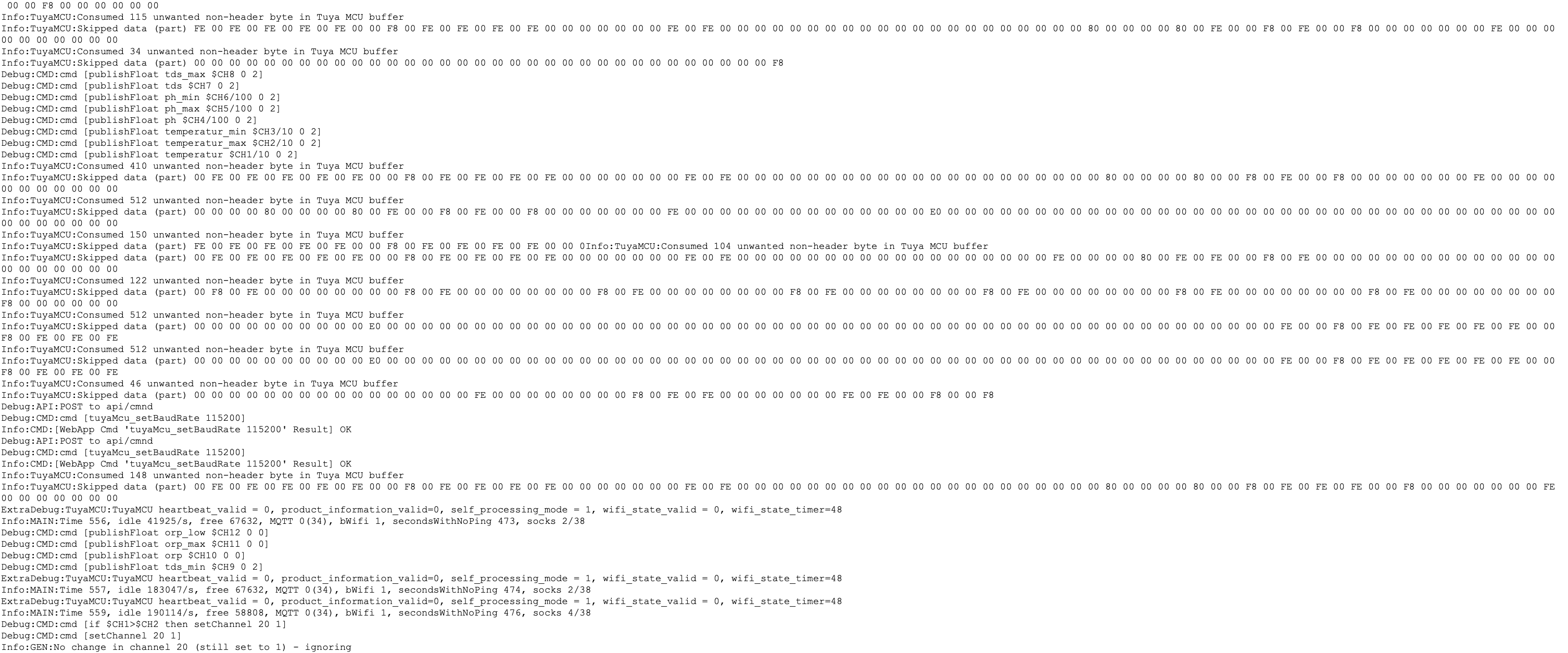

  • #70 21202951
    alfredtorch
    Posts: 6

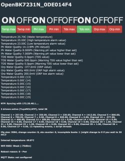

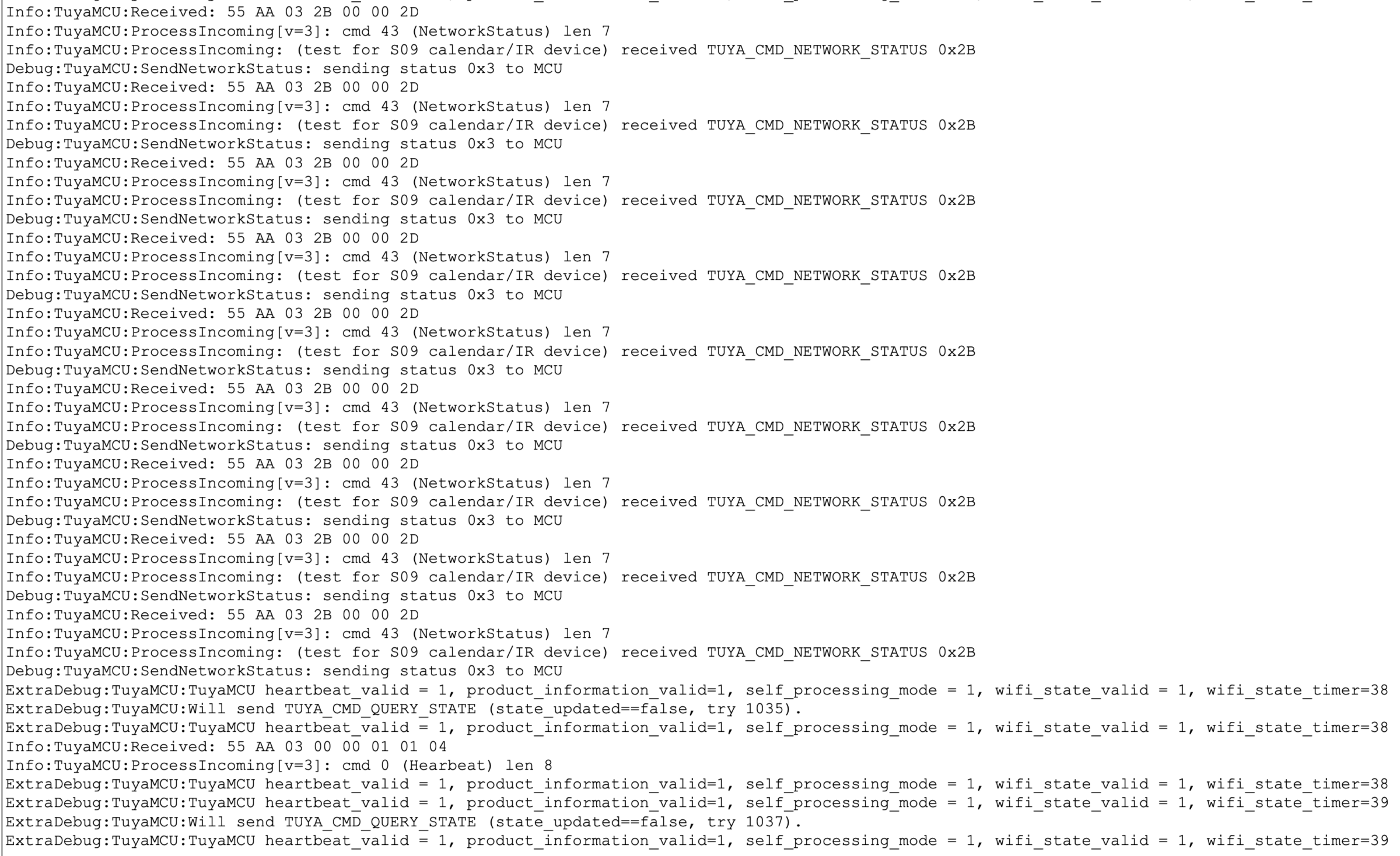

    Good morning,
    I had some feedback received from TuyaMCU. I think I'm missing some important steps in the configuration like pinout or...
    Thank you,
    Screenshot of log messages from TuyaMCU. Screenshot of TuyaMCU interface logs containing a series of debugging information about network status and heartbeat.
  • #71 21203038
    Posts: 14771
    Rate: 12914
    That's very strange, I haven't seen that path used before by the TuyaMCU. It seems it does not respect forced WiFi state yet, so I've added a patch:
    https://github.com/openshwprojects/OpenBK7231...mmit/ead3ef589be69afba614df942647785d778c14f4
    Can you do OTA, then power off and on, and retry?
    PS: so which baud turned out to be ok?

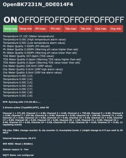

  • 115200 baud gives partial readings but many errors
    #72 21203116
    alfredtorch
    Posts: 6
    I uploaded the latest version. And changed the baud rate to 115200. It started to provide some values on the dashboard (even if they are not completely the same as on the display). However at this speed a lot of errors are also thrown. Setting it back to 9600 doesn't change at all, only the debug output is reduced.
    Screenshot of OpenBK7231N interface displaying temperature, pH, TDS, and ORP data.
    Screenshot of the dashboard OpenBK7231N_0DE014F4 displaying various data and indicators. Screenshot of debugging console showing messages related to TuyaMCU interface operation and commands changing transmission speed.
  • #73 21203123
    Posts: 14771
    Rate: 12914
    The baud setting you had in this post:
    https://www.elektroda.com/rtvforum/topic4061780-60.html#21202951
    was good. Please do NOT change it. Please revert the correct baud setting, save autoexec, and do full power off and on (disconnect device from the grid so MCU reboot) and then check.
    Then retry and report here, along with log screenshots.

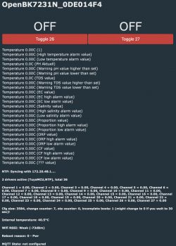

  • 9600 baud rate fixed TuyaMCU communication
    #74 21203138

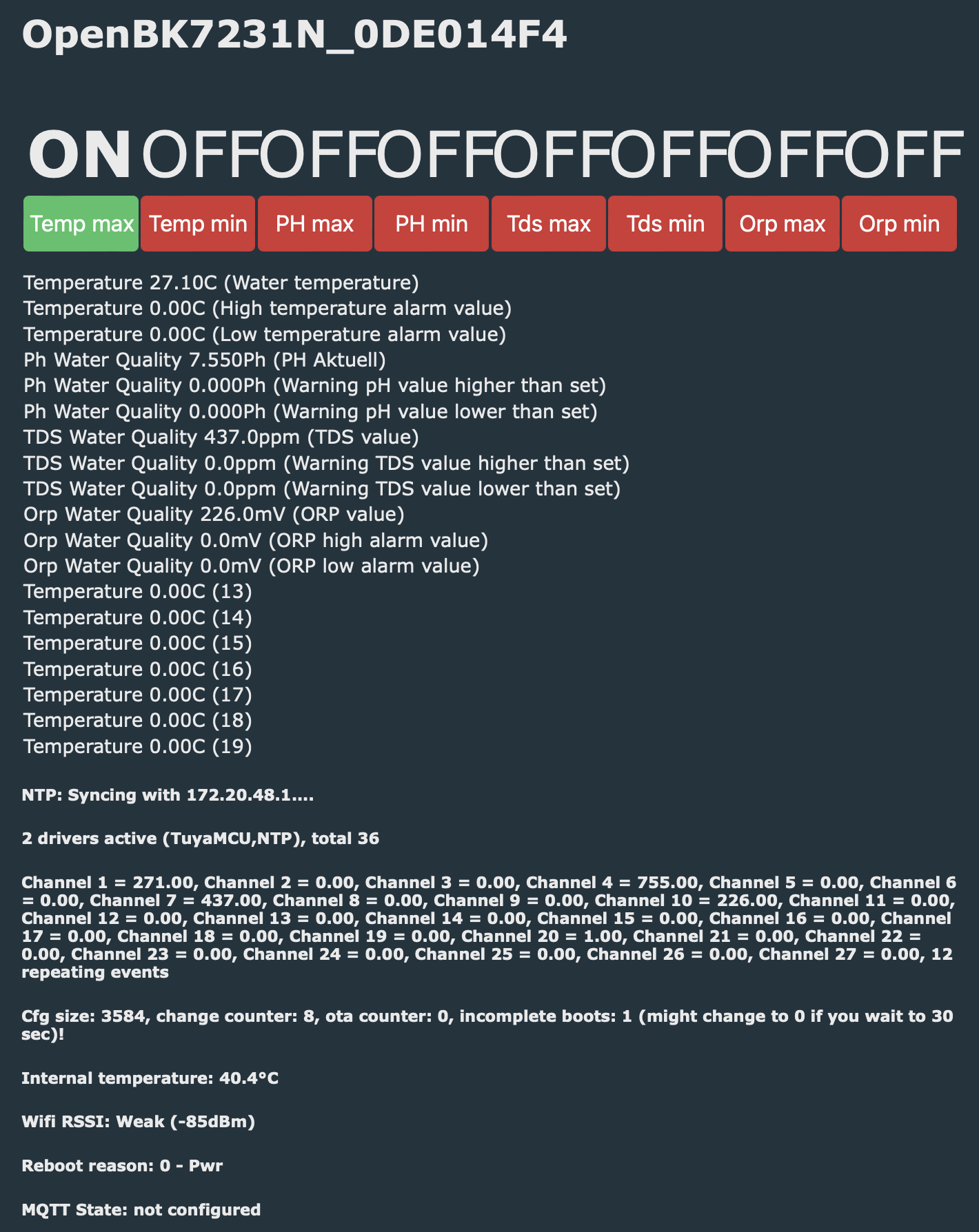

    alfredtorch
    Posts: 6
    Seems to be better working now! 9600 was the right number.
    //starte TuyaMCU
    startDriver TuyaMCU
    tuyaMcu_defWiFiState 4
    tuyaMcu_setBaudRate 9600
    //starte set ip to NTP
    startDriver NTP
    ntp_setServer 172.20.48.1
    ntp_timeZoneOfs 2
    setChannelType 1  temperature_div10
    setChannelLabel 1 "Water temperature"
    linkTuyaMCUOutputToChannel 8 val 1
    addRepeatingEvent 15 -1 publishFloat temperatur $CH1/10 0 2
    setChannelType 2 temperature_div10
    startDriver NTP
    ntp_timeZoneOfs 2
    setChannelLabel 2 "High temperature alarm value"
    linkTuyaMCUOutputToChannel 102 val 2
    addRepeatingEvent 15 -1 publishFloat temperatur_max $CH2/10 0 2
    //set value to Channel 102 TuyaMcu
    //set virtual button temp max
    setChannelLabel 20 "Temp max"
    setChannelType 20  Toggle
    setChannel 20 0
    setChannelType 3 temperature_div10
    setChannelLabel 3 "Low temperature alarm value"
    linkTuyaMCUOutputToChannel 103 val 3
    addRepeatingEvent 15 -1 publishFloat temperatur_min $CH3/10 0 2
    //set value to Channel 103 TuyaMcu
    //set virtual button temp min
    setChannelLabel 21 "Temp min"
    setChannelType 21  Toggle
    setChannelType 4  Ph
    setChannelLabel 4 "PH Aktuell"
    linkTuyaMCUOutputToChannel 106 val 4
    addRepeatingEvent 15 -1 publishFloat ph $CH4/100 0 2
    setChannelType 5  Ph
    setChannelLabel 5 "Warning pH value higher than set"
    linkTuyaMCUOutputToChannel 107 val 5
    addRepeatingEvent 15 -1 publishFloat ph_max $CH5/100 0 2
    //set value to Channel 107 TuyaMcu
    //set virtual button ph max
    setChannelLabel 22 "PH max"
    setChannelType 22  Toggle
    setChannelType 6  Ph
    setChannelLabel 6 "Warning pH value lower than set"
    linkTuyaMCUOutputToChannel 108 val 6
    addRepeatingEvent 15 -1 publishFloat ph_min $CH6/100 0 2
    //set value to Channel 108 TuyaMcu
    //set virtual button ph min
    setChannelLabel 23 "PH min"
    setChannelType 23  Toggle
    setChannelType 7  Tds
    setChannelLabel 7 "TDS value"
    linkTuyaMCUOutputToChannel 111 bool 7
    addRepeatingEvent 15 -1 publishFloat tds $CH7 0 2
    setChannelType 8  Tds
    setChannelLabel 8 "Warning TDS value higher than set"
    linkTuyaMCUOutputToChannel 112 val 8
    addRepeatingEvent 15 -1 publishFloat tds_max $CH8 0 2
    //set virtual button tds max
    setChannelLabel 24 "Tds max"
    setChannelType 24  Toggle
    setChannelType 9  Tds
    setChannelLabel 9 "Warning TDS  value lower than set"
    linkTuyaMCUOutputToChannel 113 val 9
    addRepeatingEvent 15 -1 publishFloat tds_min $CH9 0 2
    //set value to Channel 113 TuyaMcu
    fakeTuyaPacket 55AA03070008710200040000000088
    //set virtual button tds min
    setChannelLabel 25 "Tds min"
    setChannelType 25  Toggle
    setChannelType 10  Orp
    setChannelLabel 10 "ORP value"
    linkTuyaMCUOutputToChannel 131 val 10
    addRepeatingEvent 15 -1 publishFloat orp $CH10 0 0
    setChannelType 11  Orp
    setChannelLabel 11 "ORP high alarm value"
    linkTuyaMCUOutputToChannel 132 val 11
    addRepeatingEvent 15 -1 publishFloat orp_max $CH11 0 0
    //set value to Channel 132 TuyaMcu
    //set virtual button orp max
    setChannelLabel 26 "Orp max"
    setChannelType 26  Toggle
    setChannelType 12  Orp
    setChannelLabel 12 "ORP low alarm value"
    linkTuyaMCUOutputToChannel 133 val 12
    addRepeatingEvent 15 -1 publishFloat orp_low $CH12 0 0
    //set value to Channel 1133 TuyaMcu
    //set virtual button orp min
    setChannelLabel 27 "Orp min"
    setChannelType 27  Toggle
    tuyaMcu_sendQueryState
    delay_s 120 // first start wait values
    again:
    delay_s 15
    // temperature values check set  temperatur_max or  temperatur_min Buttom to on or off
    if $CH1>$CH2 then setChannel 20 1
    if $CH1<$CH2 then setChannel 20 0
    if $CH1<$CH3 then setChannel 21 1
    if $CH1>$CH3 then setChannel 21 0
    // Ph value check set  ph_max or  ph_min Butt

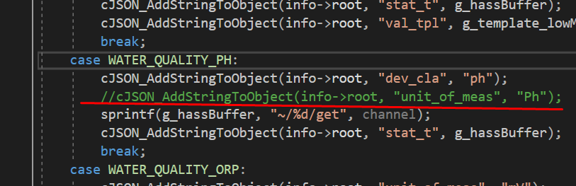

  • Home Assistant ph unit mismatch with device class
    #84 21621920
    Upright6771
    Level 4  
    Posts: 20
    Hi @p.kaczmarek2 there is an issue with ph using the latest Homeassistant mqtt version. I also have updated the openbeken Firmware to the latest one.
    My Log:
    Error 'The unit of measurement `Ph` is not valid together with device class `ph`' when processing MQTT discovery message topic: 'homeassistant/sensor/OpenBK7231N_0DE01654_sensor_4/config', message: '{'qos': 1, 'unique_id': 'OpenBK7231N_0DE01654_sensor_4', 'state_topic': 'obk0DE01654/4/get', 'value_template': "{{ '%0.2f'|format(float(value)*0.01) }}", 'name': 'PH Aktuell', 'device': {'model': 'BK7231N', 'name': 'obk0DE01654', 'configuration_url': 'http://192.168.20.5/index', 'manufacturer': 'Beken Corporation', 'identifiers': ['OpenBK7231N_0DE01654'], 'sw_version': 'Add'}, 'unit_of_measurement': 'Ph', 'state_class': 'measurement', 'device_class': 'ph'}'
    I have found an issue, that discussed the same problem: https://github.com/home-assistant/core/issues/148308
  • #85 21622013
    Posts: 14771
    Rate: 12914
    So basically you want to remove unit_of_meas?
    Here:
    https://github.com/openshwprojects/OpenBK7231T_App/pull/1744
    Check this
  • #87 21645887
    Upright6771
    Level 4  
    Posts: 20
    Hi @p.kaczmarek2 the problem still exists.
    I have installed to the latest version.
    I can solve it temporarily by using the MQTT Explorer to publish the sensor once without unit_of_meas. But after a few days the problem is back. Is there maybe another part in the code, who are submitting the unit_of_meas attribute?
  • #88 21645894
    Posts: 14771
    Rate: 12914
    Are you saying that latest release still publishes unit_of_meas for PH?
    Code line with unit_of_meas for PH is commented out in WATER_QUALITY_PH case
  • #89 21645897
    Upright6771
    Level 4  
    Posts: 20
    Yes, I have installed the Firmware: OpenBK7231N_1.18.159.rbl
  • #90 21645899
    Posts: 14771
    Rate: 12914
    Well, this is very strange, I must admit. And it still emits unit of meas for Ph, when you check in MQTT Explorer?
    Let me try in Simulator to verify...
