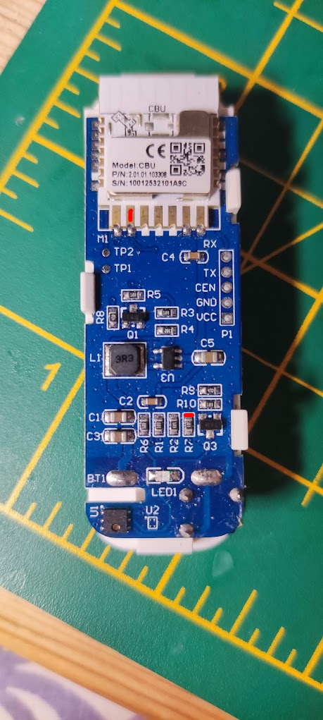

    hello again,
    i'm using tuya humidity and temp sensor cht8310, when i use DoorSnsrWSleep, it slept after 50 seconds and never go online again to send Hum and Temp data, are there any commands that i can use to make the sensor open every hour to publish data?

    Posts: 5222
    Help: 449
    Rate: 918
    a battery-powered TH01? with or without TuyaMCU?
    Do you have a pic of the PCB inside?
  • #7 21271656
    qrmonzergamal
    Posts: 15
    Electronic module with connectors on a printed circuit board.
    Same like this

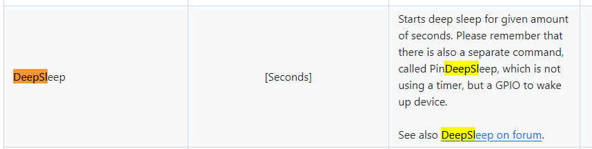

  • #10 21271939
    insmod
    Posts: 1432
    Help: 168
    Rate: 455
    >>21271703
    Try autoexec from https://www.elektroda.com/rtvforum/topic4019974-90.html#21185662
    You may also try https://github.com/openshwprojects/OpenBK7231T_App/pull/1297, if you don't plan to change any settings on your wifi router (ota file attached).

    #11 21271947
    Posts: 5222
    Help: 449
    Rate: 918
    OK. the template is only part of the story for these sorts of devices. They require autoexec.bat setup too: https://youtu.be/kXi8S12tmC8?si=3bqBoq3pLyk40u0z
    I dug my device out and the template is this (I'll update the first post in other thread to match)
    and my autoexec looks like this:
    note this configuration relies on an MQTT connected state before it'll go to sleep for 1 day, if no "connected" status it will sleep for 5 mins then try again, ad infinitum.
    ah @insmod beat me to a response
  • #12 21271974
    insmod
    Posts: 1432
    Help: 168
    Rate: 455
    >>21271947 Btw, cht_alert is now a little different. You should have 4 parameters - where second is for humidity
