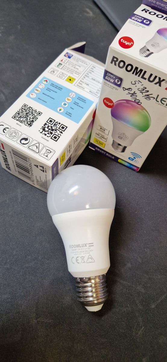

    The RoomLux B15515 A60 is another WiFi-controlled 'bulb' offering dual-mode operation - RGB (colours) and CW (shades of white). Here I'll show the inside of it, check out what controls the LEDs and convert it to free it from the Tuya app and connect it locally to Home Assistant.
    Packaging of RoomLux B15515 A60 smart LED bulb with Wi-Fi. .
    The power of the B15515 is 10W, with the manufacturer declaring it equivalent to a classic 60W incandescent bulb.
    RoomLux B15515 bulb with packaging on a table .
    The dome is plastic, easily removed:

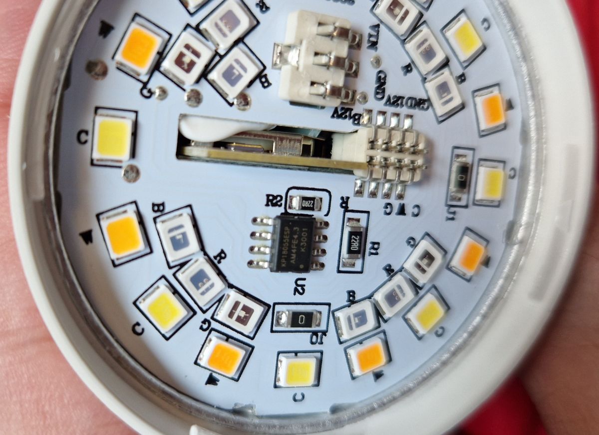

    Interior of the RoomLux B15515 A60 bulb showing LEDs and circuits. .

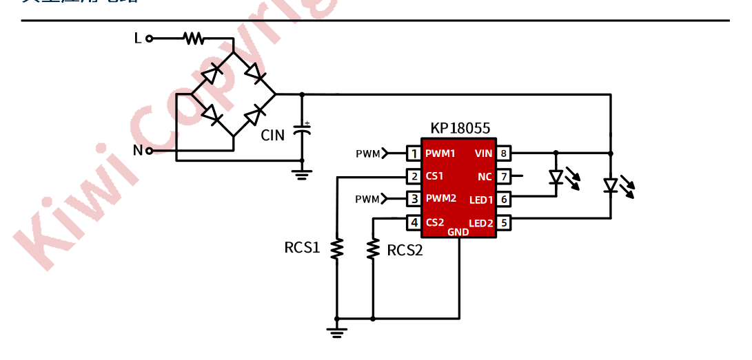

    We can already see its construction - there are five types of LEDs, R, G, B, C and W - that is red, green, blue, cold and warm white. The white is controlled by the KP18055:
    Wiring diagram of the KP18055 controller in an LED circuit. .

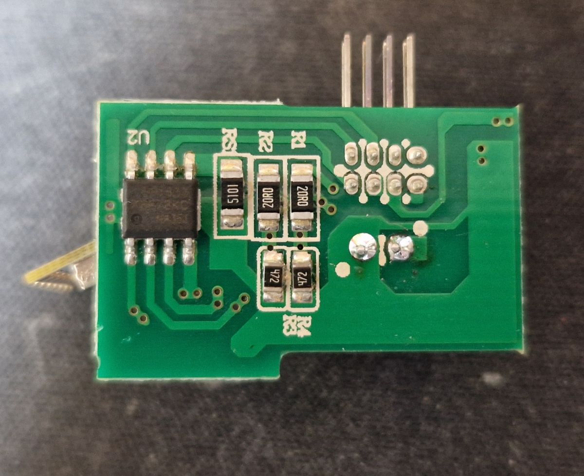

    We look further in. Inside is the WB2L WiFi module, already known from the themes:
    [BK7231T/WB2L] Lepro LE Wifi Smart LED Bulb A19 E26 Model No. 901003-U .
    [BK7231N/CB2L;BK7231T/WB2L] BPA800/RGBW/2 Feit stripping and flashing OpenBK bulbs .
    Modification of 3Stone 100W smart bulb [BP5758D + WB2L] - with BK7231T chip, compatible with Al .

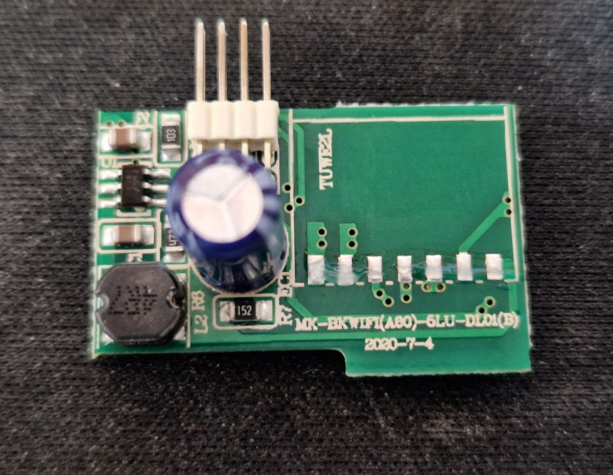

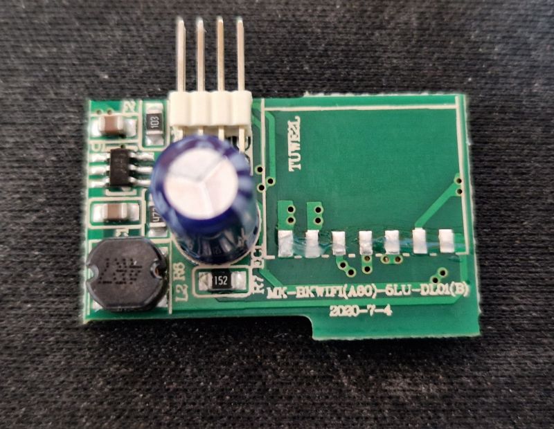

    Plate:
    Converter board with visible capacitor and pins. Electronic module with visible integrated circuits and resistors. .

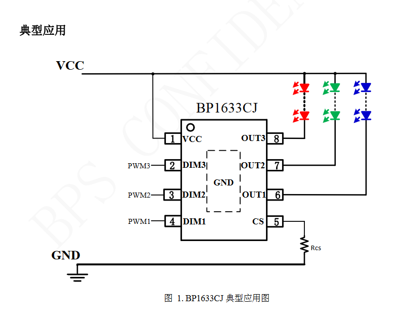

    Here you can see the step-down inverter powering the WiFi module and the second LED controller, the BP1688. He controls the R, G and B LEDs:
    Wiring diagram of BP1633CJ controller to RGB LEDs. .

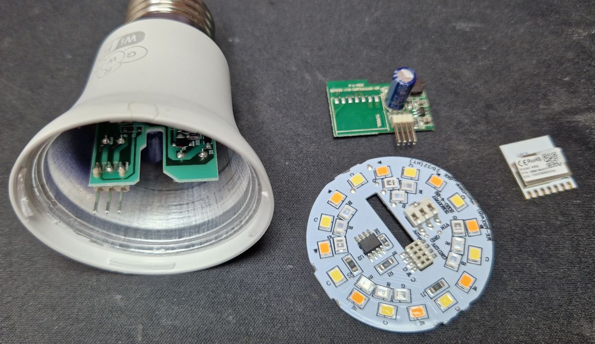

    Lamp in parts:
    Disassembled components of the RoomLux B15515 A60 bulb with visible circuit boards and WiFi module.

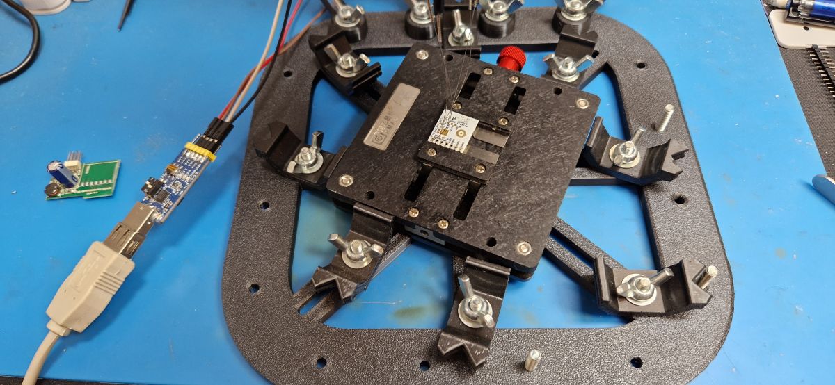

    There is a small catch. The WiFi module supports OpenBeken, but the TX/RX pads are on the bottom of it, so you have to solder it out... .
    Then only then can you flash:
    In the process of uploading on the needle stand:
    Electronic device on a soldering needle bed. .

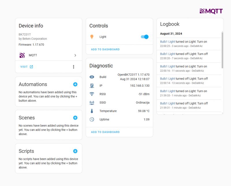

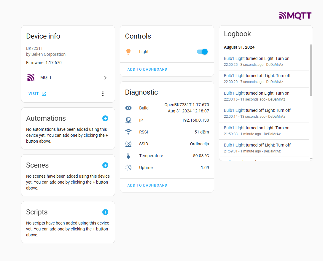

    Then the HASS Discovery can be performed:
    and our LED will then be seen by the Home Assistant:
    Home Assistant user interface for a WiFi-controlled light bulb. .
