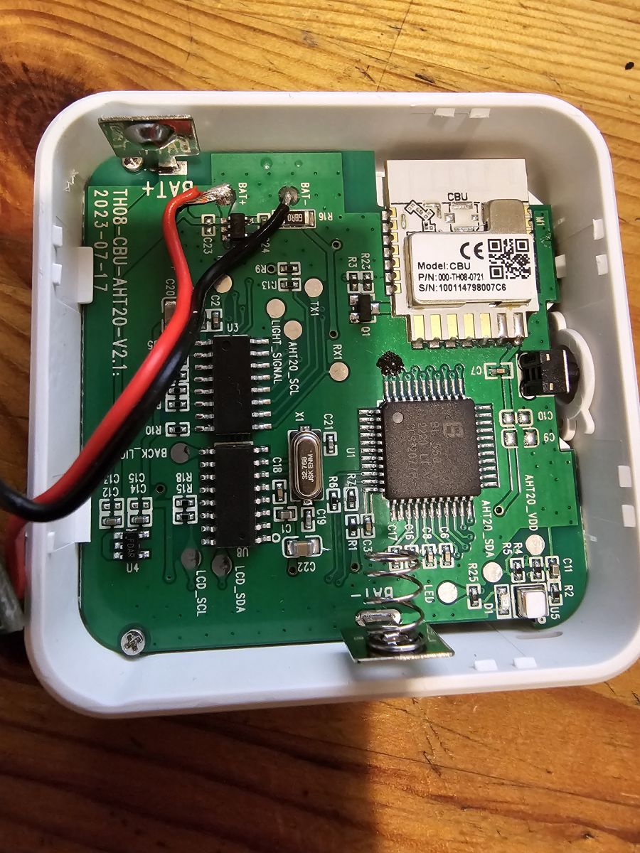

[BK7231N ] Teardown of TH08 LCD Calendar/clock/temperature/humidity, 3xAAA battery, backlight
morgan_flint 45735 255
  • TH08-CBU-ATH20-V2 is a LCD calendar/clock/temperature/humidity unit with a BK7231N CBU module, BL55070 LCD driver, and ATH20 sensor.
  • U3 appears to be the Tuya MCU, while U8 with a 32.768 kHz crystal likely handles RTC and LCD/backlight control, and Q1 switches Wi‑Fi power.
  • It runs from 3xAAA cells at 4.5V and was bought for 4.49€ as a Choice offer.
  • The Tuya app shows a 1 hour update interval, and pairing can fail because the device connects only briefly between updates.

  • Unmarked U3 and U8 chips confirmed again

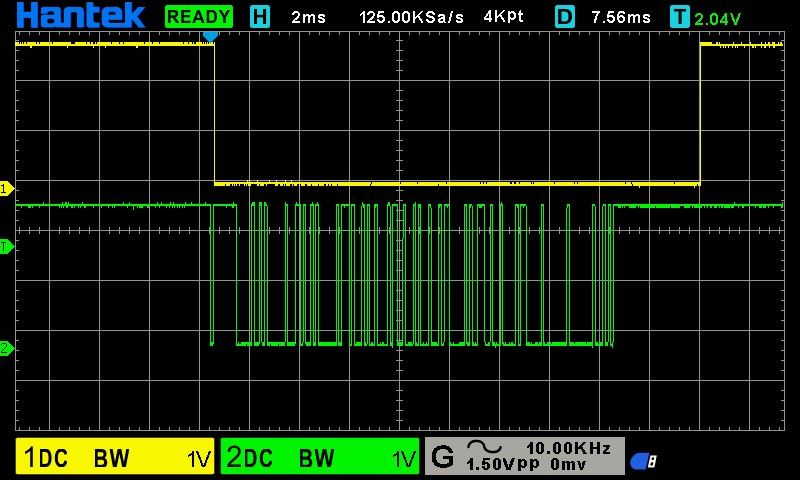

    morgan_flint wrote:

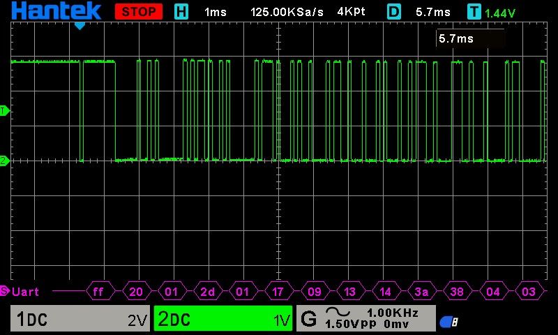

    I finally could repair my scope yesterday, so I'll take a new look at the communication between U3 and U8.
    Hello to all, after some time inactive, but I had been doing several experiments and suddenly the device stopped working... After reflashing OBK a couple of times with no success, I reflashed the original FW and all seems back to normal. I'll reflash OBK later again and see what happens.
    Regarding communication between U3 and U8, my initial guess (pins 4 and 5 of U3 connected to pins 10 and 8 of U8 respectively being serial or I2C) proved incorrect. U3_5-U8_8 apparently never changed (always high) and U3_4-U8_10 was normally high and went low for about 20 mS repeating this every 2 seconds approximately. Of course, this didn't seem enough to program the (according to my guess) RTC from the MCU, so I decided to take a look at the pad labeled "Light_Signal" and, bingo! it looked like a serial communication.
    The following images show U8 pin 10 (yellow trace) and Light_Signal (green one). As you can see, the yellow trace goes down coinciding with the first or second low to high transition of the green one (if it was first or second seemed random), and went high again a few ms after the end of activity in the green one.
    Oscilloscope graph showing yellow and green traces of electrical signals. Oscilloscope data transmission showing yellow and green signals
    I couldn't guess the utility of this signal (maybe an acknowledgment sent from U8 to U3 when it receives serial communication?) so I went on with the analysis of Light_Signal:

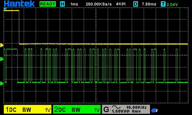

    Oscilloscope screenshot showing serial communication on a green signal.
    I wasn't very confident about the protocol decoding of the scope, so I connected Light_Signal to a serial to USB converter and got this (the hex file is also attached):
    Screenshot showing a hex data table with values and decoded text.
    As you can see, it consists of a 16-byte array. The capture was done on power on, so the bunch of 00's at the beginning seem to be related to the period while the date and time hadn't yet been received from the NTP server. After some more captures and looking simultaneously at the display, I think:
    - The 1st byte is a header (always FF)
    - 2nd byte is related to the temperature
    - 3rd is always 01 (?)
    - 4th is related to the humidity
    - 5th is always 01 (?)
    - 6th to 11th to date-time, except for the 8th one that changed for a few seconds when the button was pressed (backlight)
    - I couldn't guess the meaning of the rest of the bytes

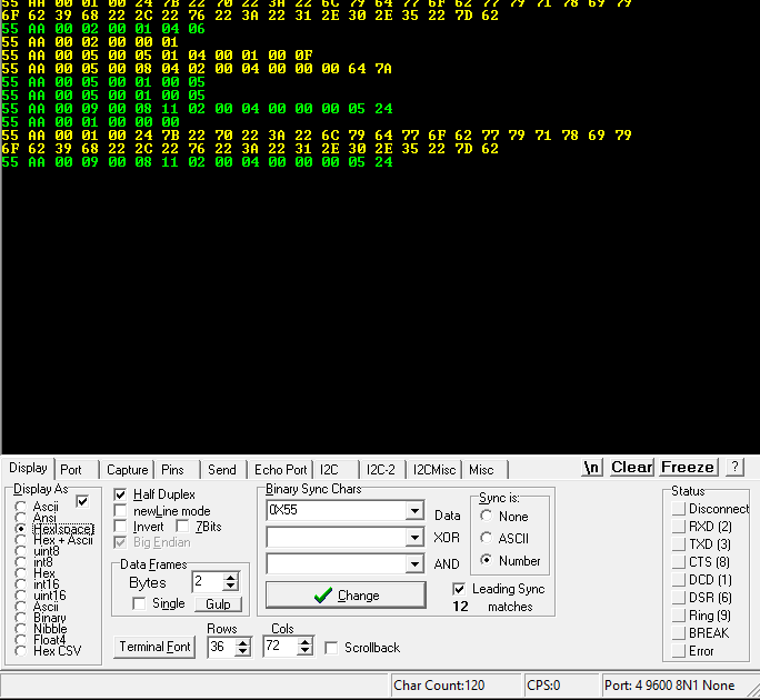

    spin55 wrote:

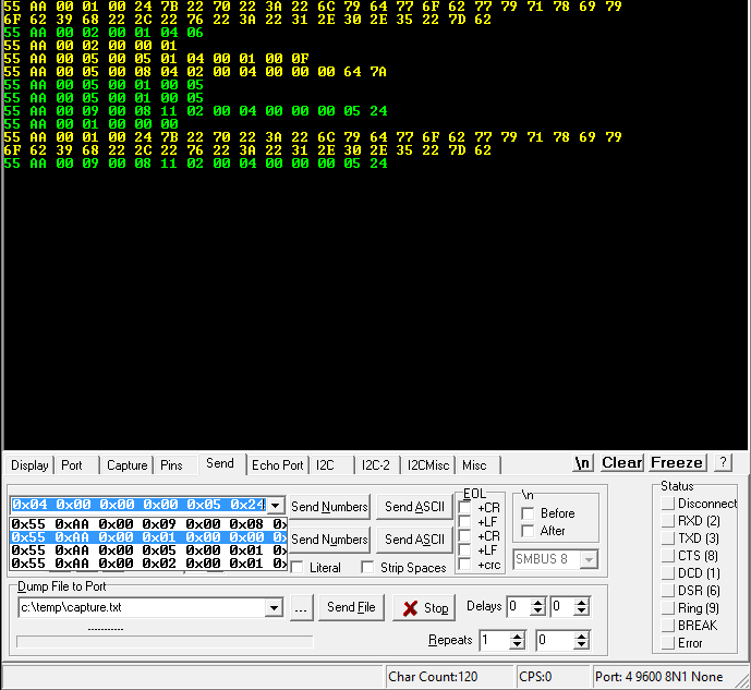

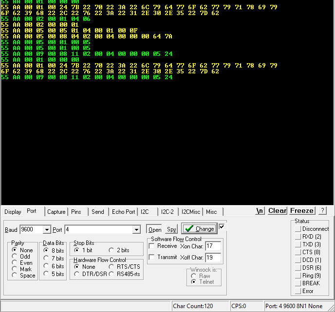

    Unless there is an error, the command to send would be: 55aa00090008110200040000000524 for a reporting interval of 5 minutes.
    And TuyaMCU should answer with: 55aa030900000b.
    Hello, Spin55
    I tried this and, after a lot of trial and error, could send that stream with a tool called ComDebug and get the response from the MCU with Realterm. I had also tried sending it with realterm, but if I pasted 55AA00090008110200040000000524 to Realterm, it would change it to 35 35 41 41 30 30 30 39 30 30 30 38 31 31 30 32 30 30 30 34 30 30 30 30, and this was what was received in another terminal with its COM port's RX connected to the first one's TX. I tried several options in realterm but couldn't find any that permitted me to receive what I wanted to send, so I had to use ComDebug to send the sequence.
    Anyway, the MCU just answered FF FF to that sequence, so I guess that DP is not implemented.

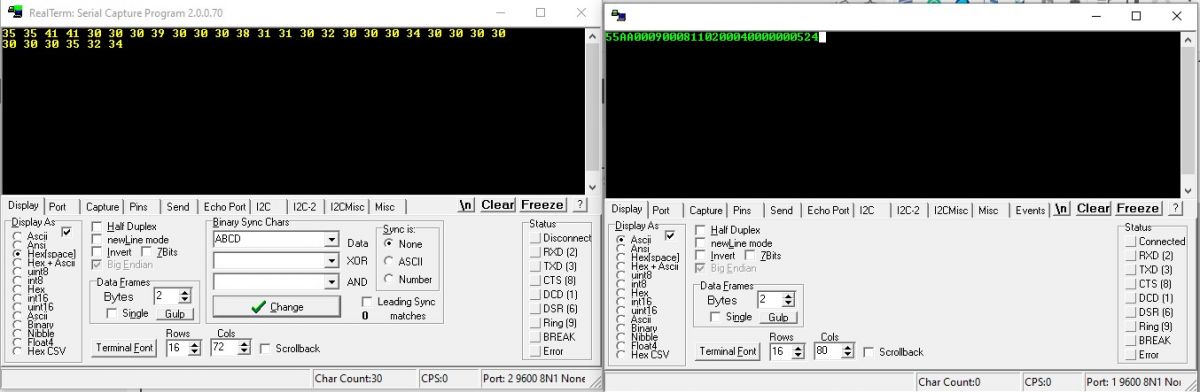

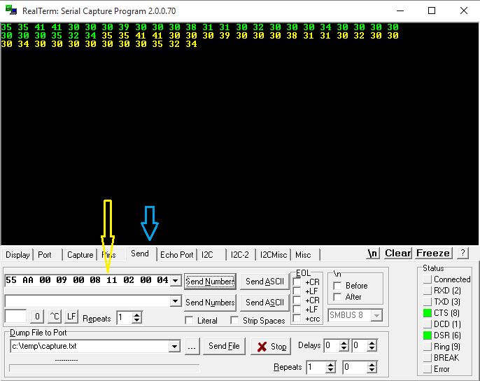

    Would you mind commenting on how you tried to send it with Realterm? If possible with Realterm images.
  • RealTerm pastes hex as ASCII by default
    #70 20747067
    morgan_flint
    Posts: 251
    Rate: 63

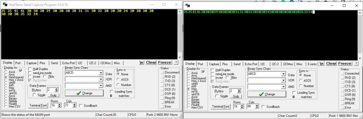

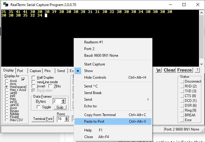

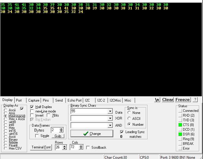

    Copied the sequence from your post (55AA00090008110200040000000524) with Ctrl+C and pasted it into the realterm screen (Ctrl+Alt+v or right click + "paste to port").
    RealTerm program window with the context menu focused on the Paste to Port option.
    The first image is selecting Hex in "Display as" and the second with Ascii. The receiving terminal (on the right) receives the same:
    Screenshot of RealTerm program showing data displayed in Hex and ASCII format.
    Two RealTerm program windows, one with Hex selected and the other with Ascii, both displaying the same data sequence.
    There must be an option to indicate that you are pasting Hex, not Ascii, but I couldn't find it
  • Send the command from the Send tab, not paste mode
    #71 20747082
    spin55
    Posts: 209
    Help: 17
    Rate: 42
    I just confirmed the doubt I had. You have sent the command by doing a Copy/Paste in Send Number and you got what you see above. It is not correct, to send it you have to enter it by typing as seen in the image.
    In any case, it is no longer important because you could have done it with the other program and there is no DP17 implemented as you suspected.
    Screenshot of a data terminal interface showing numbers at the top and configuration options below. Screenshot of RealTerm program with Capture and Send tabs open.
    You have to send it from the Send tab.

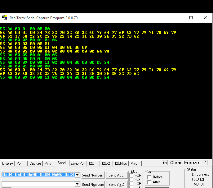

    #72 20747094
    morgan_flint
    Posts: 251
    Rate: 63
    morgan_flint wrote:

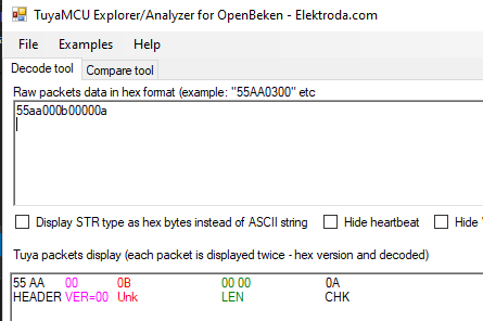

    I agree Zigbee would be more efficient, but I also think there's a problem with the terminating sequence sent by OBK to the MCU, as I said here, because with OBK the module remains connected for a long time each time it's powered on by the MCU (more than a minute) while with the original FW it goes off just after the communication with the MCU ends (about 10 seconds).
    I've updated the comparison between the captures adding the relative timestamp (time from the first message) and there's something curious: As you can see, with the original FW the module answers to the first message from the MCU within 1 second, while OBK takes 10 seconds to answer.
    I also have looked WiFi for low power protocol for the last message sent to the module (55AA000B00000A) and it's response (55AA000B000201505D). The first one is "MCU obtains the strength of the connected router" (I understand the MCU asks the module for the signal strength) and the response from the module is "Module returns current value of strength (80)". None of these seem to have any meaning in the "normal" protocol, nor could I find the meaning of the last answer (repeated three times) of the module with the OBK FW (55AA000800010008), being this one the more similar one (55 aa 00 08 00 00 07, Query DP status).
    So, probably, the MCU is waiting for the strength signal data and receives instead a query it doesn't understand, so remains a long time waiting for the answer without disconnecting the module, until it finally gives up
    • TH08_OBKvsOrigRAW_T.pdf (400.58 KB) You must be logged in to download this attachment.

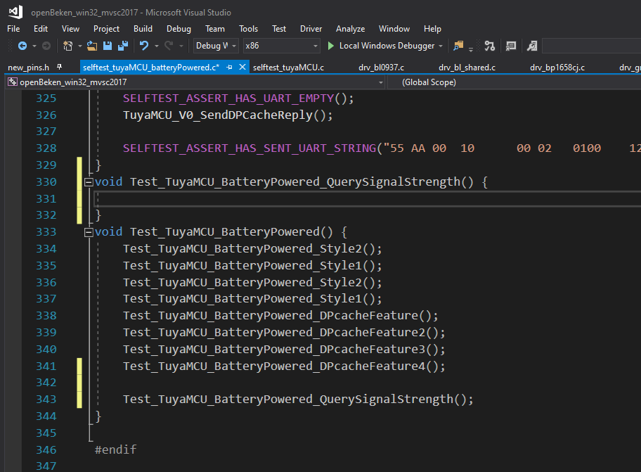

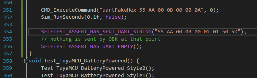

  • #75 20747161
    Posts: 14750
    Rate: 12866
    So it seems that we have to send one extra packet to get sleep earlier?

    @morgan_flint,
    First of all, I apologize because the information I provided you about using Realterm is not correct, because a few months have passed since I used the program and I answered you based on what I remembered.
    I reconnected the USB adapter to the pir motion NEO and realized the error.
    This is how you have to configure Realterm:
    Display tab:
    Screenshot of Realterm software displaying hexadecimal data.
    Port tab:
    Realterm program screen displaying interface and data in hexadecimal mode.
    Send tab:
    Screenshot of Realterm software showing data transmitted in hexadecimal format. Screenshot of RealTerm program showing commands in green and responses in yellow.
    As you can see, the data must be entered in hexadecimal format.
    You add them one at a time and press Send Number. To enter the following ones you can edit the one you just entered and so on. When you connect the device you choose them from the drop-down tab.
    On the screen you will see the commands you send in green and the responses from TuyaMCU in yellow.
    As you can see, I sent commands 01 and 02 that were answered by MCU with the identification data (01), acknowledgment that there is already a connection to the cloud (02) and the status of the variables (05). In this case the detection values ​​(00) and battery level (64) which in decimal is 100 as you already know.
    And you can also see that I sent command 09 and it hasn't responded.
    This test is done with the connections as I mentioned in a previous post and without battery or external power. Tx, Rx, GND from USB to Tx, Rx, GND from Wifi module and CEN to GND.

    Thank you for the info, @spin55
    I made the experiments again with this configuration and could effectively send the message by writing the hex numbers as 0xXX, so I made a first test sending from Realterm the first packet in the sniffed logs and obtaining the same answer from the MCU. Then tried sending the message from your post here:
    With no response from the MCU, so definitively this is not implemented.
    So now let's see if @p.kaczmarek2 can implement the correct response to the last query from the MCU to the module MCU obtains the strength of the connected router (55AA000B00000A) and see if this abbreviates the time before the MCU powers off the module (details at the end of this post).

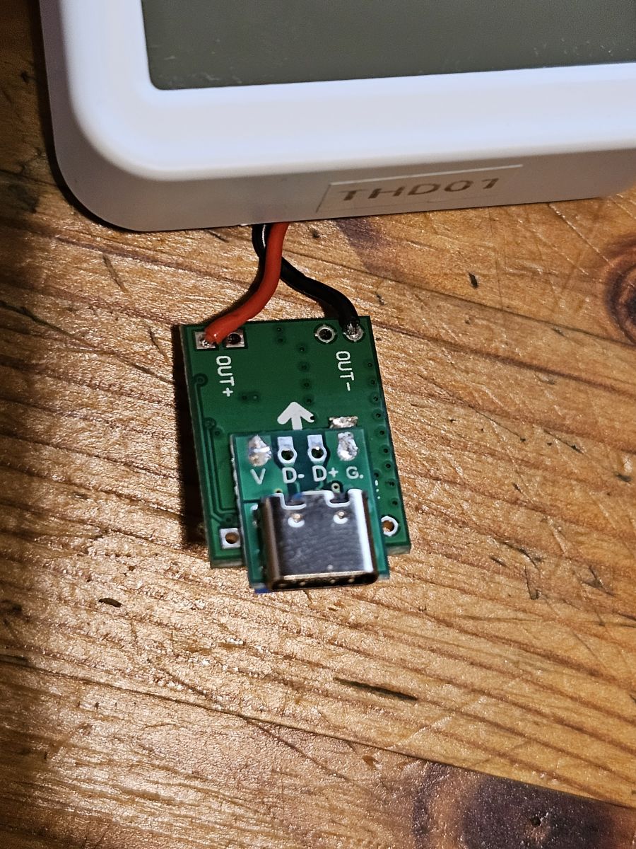

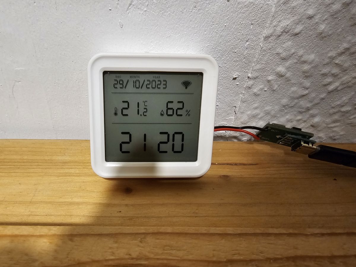

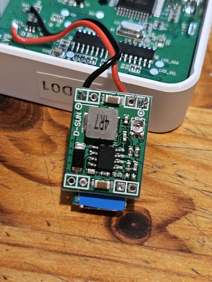

    #81 20791566
    auntlydia
    Posts: 70
    Rate: 14
    What a coincidence, I just did it today:
    Close-up of a PCB with soldered components and a wireless module in a white casing. PCB with a female USB-C connector soldered to a DC voltage regulator. PCB with USB-C port connected by soldering to wires. Thermometer with LCD display connected to power supply.
    I used a USB-C female connector PCB soldered to a step-down DC voltage regulator adjusted to 4.2V output. That one I soldered to the battery pads on the motherboard. It works without any issues.
    Another option would be a 3.7V LiPo battery with USB charging module.
    Any voltage between 3.3V and 4.5V should be safe to use, personally I wouldn't want to go higher than that. It may be fine though, but who knows for how long. I prefer to be safe on this one.
    I'll still cut the case to make it fit in nicely, so the USB can be plugged normally into it from the bottom. I'll post results when I have time to finish it.
    FYI: the device has already lasted six weeks without replacing the batteries on the ORIGINAL Tuya Firmware!!! With OpenBK, I have to swap out my rechargeables every 3 days. I wonder if this could still be improved with further development of the MCU driver.

    Ok I am looking into it, by the way I will update the analyzer
    I will also add a self test for that
    Screenshot showing Visual Studio editor with source code related to testing TuyaMCU.
    Added after 15 [minutes]:
    Ok, it passes the self test now:
    Screenshot of C code related to UART self-test.
    but I didn't test it on physical device, do anyone here wants to try?
    Currently response values are hardcoded.

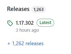

    Posts: 14750
    Rate: 12866
    I am referring to the OBK firmware, the latest version available was published 3 hours ago, it's 1.17.302:
    Screenshot showing the latest software release version 1.17.302.
  • #89 20796636

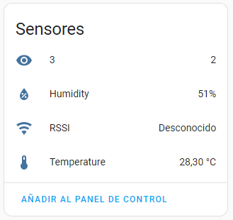

    I've seen it's available again and have flashed it. Still have to connect UART and run the analyzer.
    But I've seen a first difference in Home Assistant:
    Home Assistant sensor interface showing humidity and temperature values.
    The RSSI sensor didn't appear in the previous version I tried (I don't remember which one it was).
    I didn't change anything in the autoexec.bat
    Its a pity that id doesn't show a meaningful value; maybe I have to change something in the configuration.
