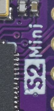

    divadiow wrote:
    dunno if mine's fake
    Looks exactly like mine - especially the printed text is very different to the original:
    Fragment of a purple circuit board with the label S2 Mini.
  • #122 21246308
    insmod
    Posts: 1432
    Help: 168
    Rate: 455
    Mine is a lot like original, except no wemos.cc on backside and a little thinner text.

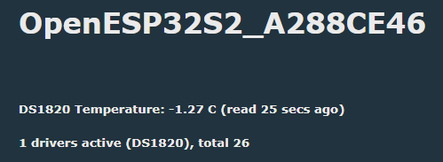

  • DS1820 no longer works on pin 18 on S2 Mini
    #123 21246473
    max4elektroda
    Posts: 758
    Help: 49
    Rate: 189
    Just a short feedback on my S2 Mini: Tried to do some "workload" and I think one of the GPIO changes maybe "broke" DS1820 so it needs some change?
    At least it seems it's no longer working on Pin 18, as it was with my old firmware from Sept 10th. Or is the pin no longer working with actual FW? I must admit I didn't follow all changes in detail ...
    Didn't find the time to have a closer look, and it's surely not the most important use case, just as a short feedback. Maybe also some stupid error on my side, will try to investigate further tomorrow.
  • #124 21246486
    Posts: 5215
    Help: 448
    Rate: 917
    ah, I just tried DS18B20 too on S2 but couldn't get pins 2,3,7, 8 or 14 to work. Didn't try others.
    Added after 4 [minutes]:
    nor 18
    Screenshot from the OpenESP32S2_A288CE46 system showing temperature from the DS1820 sensor.
    will try some LEDs

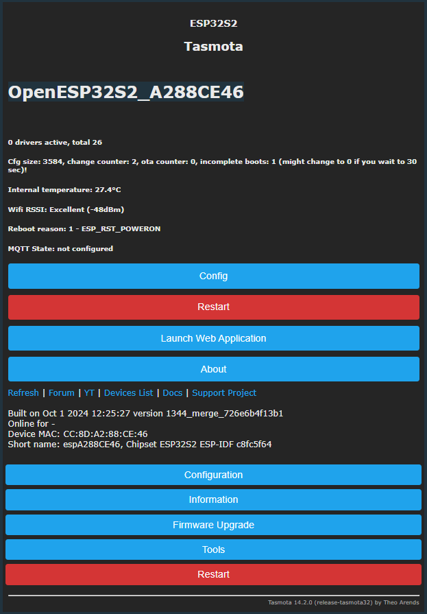

    I was just checking my sanity with some sensor functionality between Tasmota and OBK and noticed this chimera appeared in the browser by itself flashing between the two
    Screenshot of the Tasmota interface for the OpenESP32S2_A288CE46 device displaying system information.
    a minor amusement

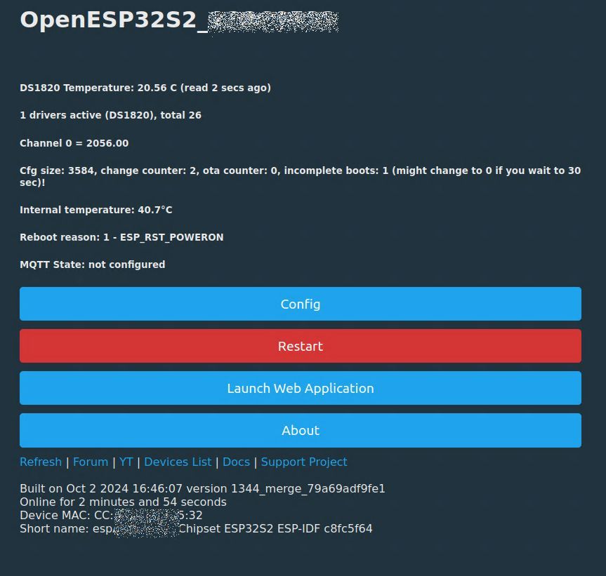

    Try ds18b20/dht again, i pushed some changes to the way gpio is configured.
    EDIT: DHT probably wouldn't work, no interrupt disabling for esp in code yet.
    EDIT2: It doesn't even start. Pushed an update, now it will start on any platform that has ENABLE_DRIVER_DHT (it is enabled on LN, but 'disabled' in code).
    EDIT3: DHT11 works for me now.
  • #131 21247756
    max4elektroda
    Posts: 758
    Help: 49
    Rate: 189
    Very good, you found it: DS1820 works again!
    Thanks a lot!
    OpenESP32S2 interface screen displaying temperature readings from the DS1820 sensor.
    Added after 36 [minutes]:
    How could I have missed that??
    Thanks for adding the temperature to the channel!

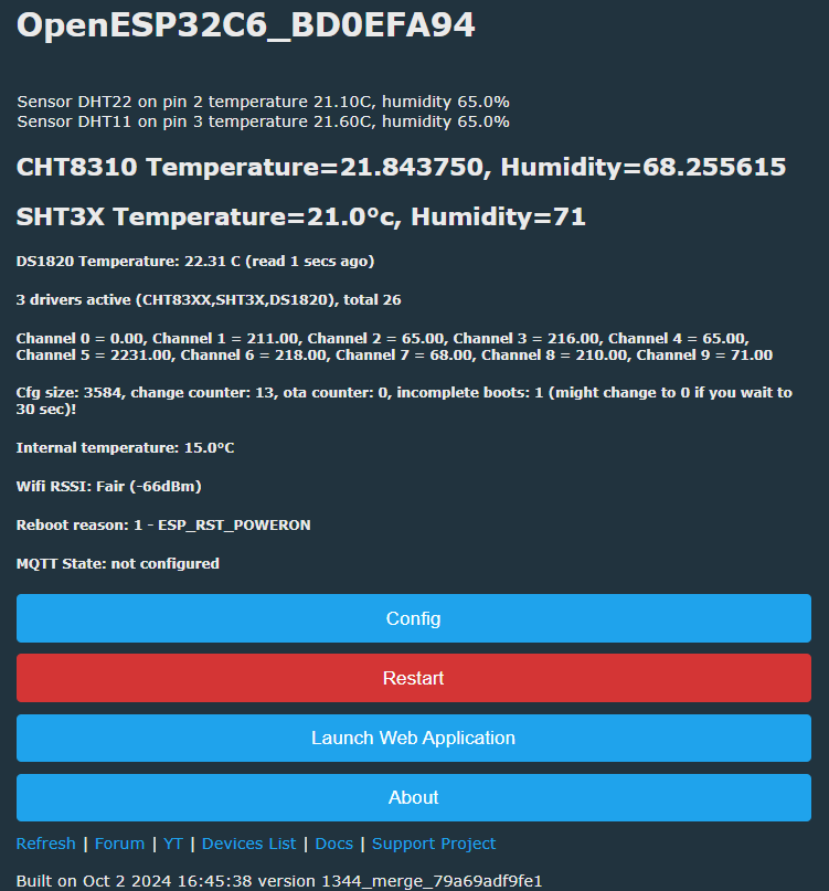

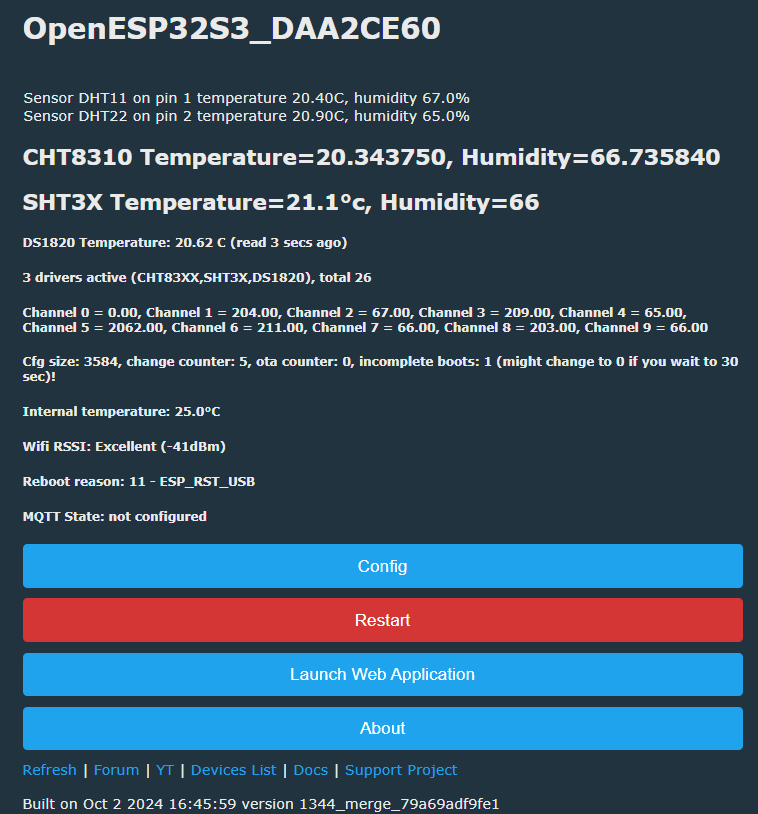

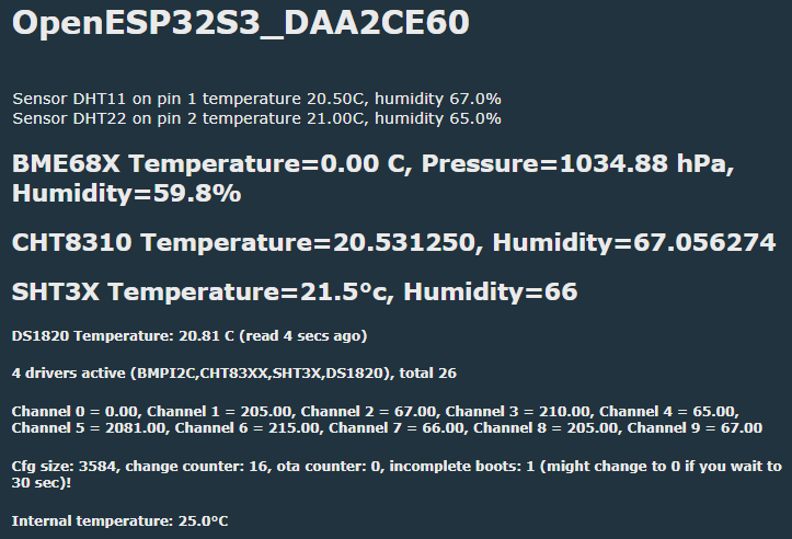

    #132 21248037
    Posts: 5215
    Help: 448
    Rate: 917

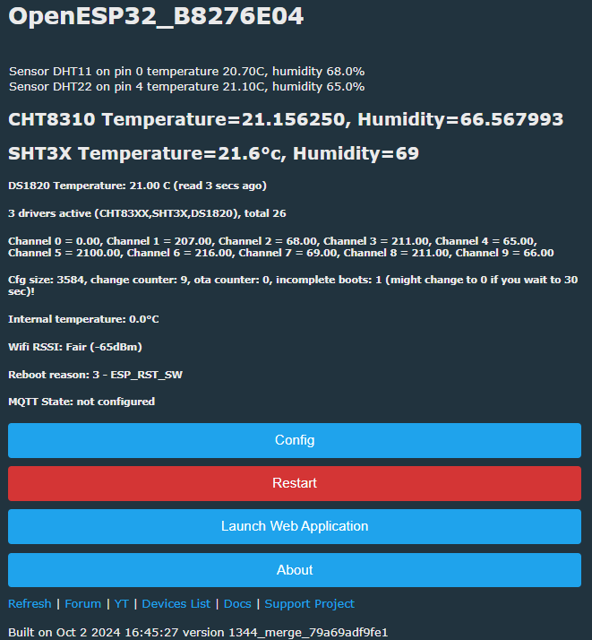

    5-sensor megamix. good work
    Screenshot of the OpenESP32C6 user interface displaying sensor data and temperatures.
    Added after 20 [minutes]:
    Screenshot of OpenESP32 interface displaying temperature and humidity readings from various sensors.
    Added after 23 [minutes]:
    Screenshot of the OpenESP32S3 software interface displaying sensor readings.
    Added after 22 [minutes]:
    and 2/3rds of a BME680
    Screenshot of OpenESP32S3_DAA2CE60 unit with readings from various temperature and humidity sensors.
    Added after 56 [seconds]:
    what's the maximum number of channels?

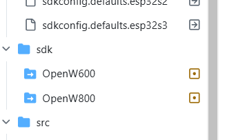

    I've wanted to merge it today but it seems that commit 393eea8 broke W800 build, any ideas what's happening there?
    https://github.com/openshwprojects/OpenBK7231T_App/pull/1344
    Maybe wrong SDKs?
    Screenshot of configuration files and SDK folders.
    I had similiar issue recently, where Github gui insisted on pushing old version of sub repository...
  • #138 21291667
    insmod
    Posts: 1432
    Help: 168
    Rate: 455
    >>21291529 Pushed an update, git didn't update sdk's on merge

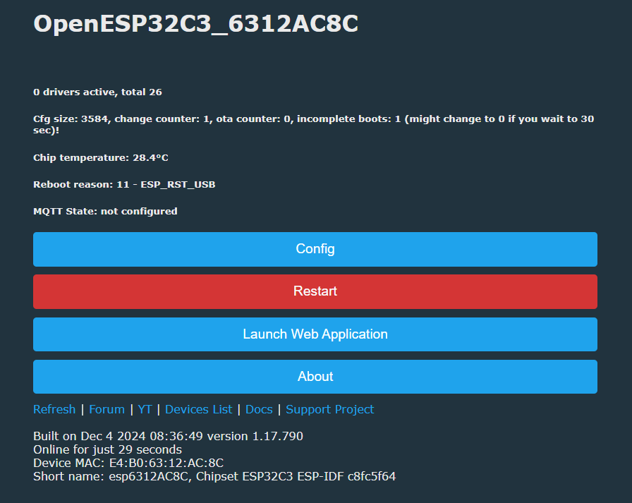

    #140 21332798
    Posts: 14763
    Rate: 12896
    Tested with C3 today, Works, nice, we need to put those ESP files on Github Releases page as well..
    User interface of the OpenESP32C3 system with configuration buttons.
    Close-up of a PCB with electronic components, including a micro USB socket, integrated circuits, and I/O connectors. LCD display module on a wooden table. Image of a green circuit board with an ESP32-C3 and Winbond chip. Close-up of a circuit board with an ESP32-C3 microcontroller and Winbond chip.
    Added after 7 [hours] 17 [minutes]:
    That took some time:

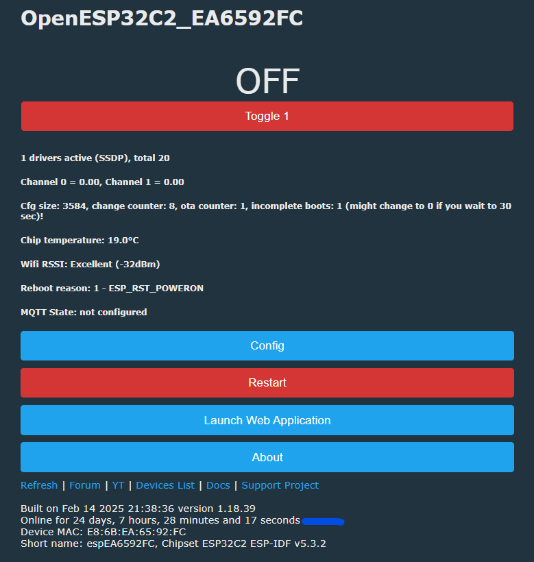

  • #149 21537112
    Posts: 5215
    Help: 448
    Rate: 917
    >>21476005
    had a tiny power cut yesterday but this stayed up. posting update in case a proper one happens
    Control panel of the ESP32C2 device showing status, WiFi info, and control buttons.
