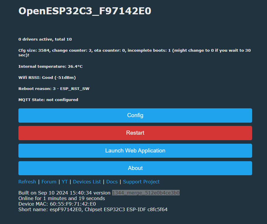

    I've flashed 1344_merge_512e0b4ce3b0 on my C3 and it works, no phantom drivers nor channels:
    OpenESP32C3 user interface with system information and configuration options.

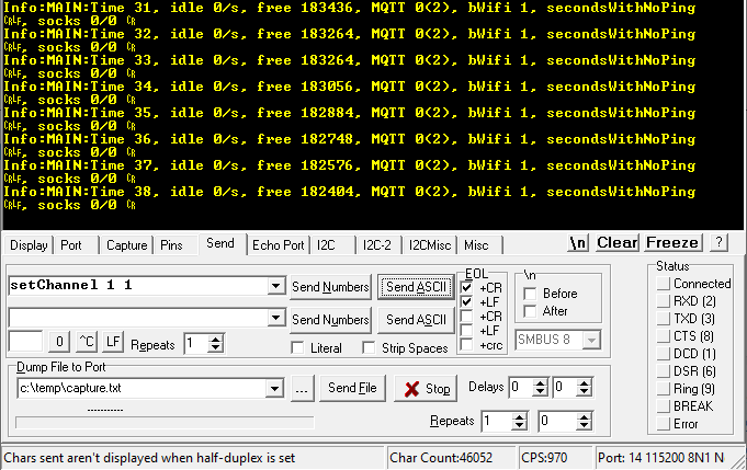

    The UART can be tested if you enable UART cmdline flag.
    // Here is how you can get log print on UART1, instead of default UART2 on Beken
    // Enable "[UART] Enable UART command line"
    // this also can be done in flags, enable command line on UART1 at 115200 baud
    SetFlag 31 1
    // UART1 is RXD1/TXD1 which is used for programming and for TuyaMCU/BL0942,
    // but now we will set that UART1 is used for log
    logPort 1
    but I guess the log port is already the flashing port on ESP (as in Tasmota), so only Flag 31 is needed?
    Hm it can't receive commands yet:
    Screenshot of a terminal program showing system logs and serial port settings.

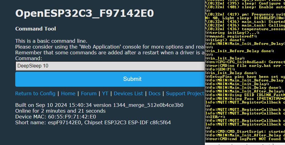

    Ok so let's try DeepSleep:
    Screenshot of OpenESP32C3 tool showing terminal logs.
    Nice, it rebooted like after 10 seconds so I guess that's working.

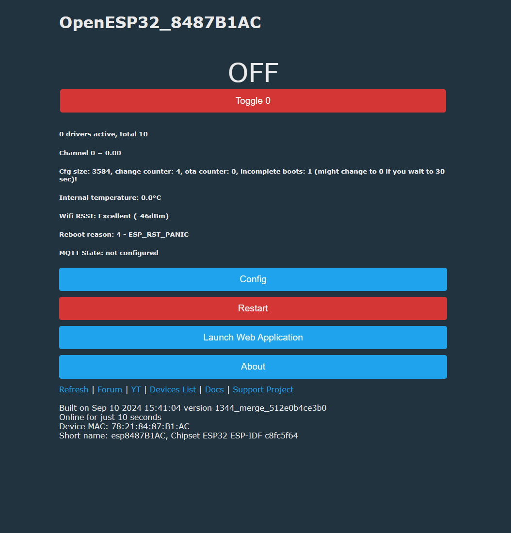

  • IO2 LED setting persists after OTA
    #64 21221870
    DeDaMrAz
    Posts: 621
    Help: 34
    Rate: 130
    @insmod
    Fix is correct :) I got a IO2 set as LED and it stayed after OTA
    OpenESP32 user interface with a Toggle 0 button and system information

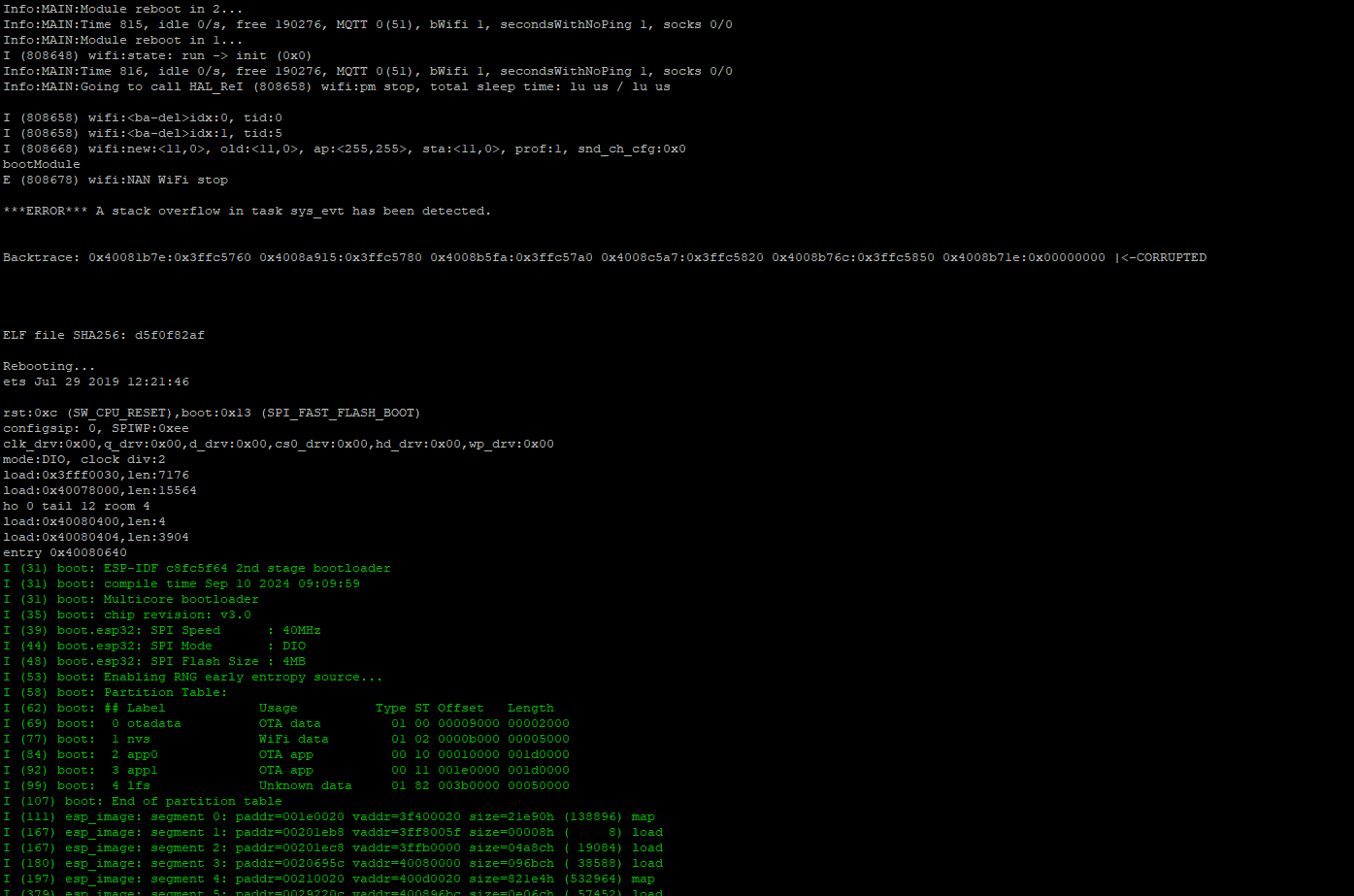

    Even reboot works now without panic dump :) but still with a stack overflow.
    Screenshot of system logs during the startup process of the ESP32 controller. Visible messages about booting, WiFi configuration, and stack overflow errors.

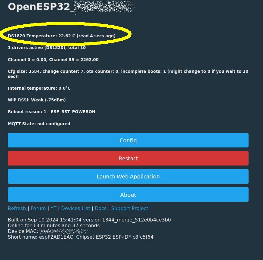

    #65 21221926
    max4elektroda
    Posts: 758
    Help: 49
    Rate: 189
    ... great, and DS1820 works, too ;-)
    Screenshot of the OpenESP32 interface showing DS1820 temperature at 22.62°C and system details.
    Added after 6 [minutes]:
    DS1820 works - and I also tried successfully with PowerSave 1 and PowerSave2.
    Just out of curiosity, not really a big issue: Does ESP32 has an internal temperature? Its always 0.0, but works fine with S2 and S3.
    [Edit]
    Just did a quick search, seems that the "old" ESP32 don't have an internal temperature sensor...

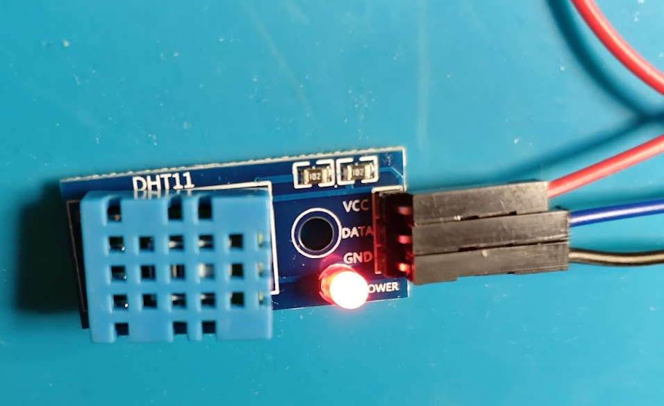

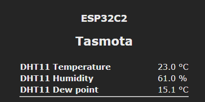

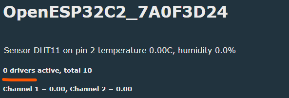

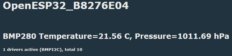

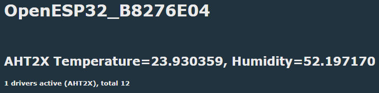

  • DHT11 not working on ESP32-C2/C3 build
    #66 21221977
    Posts: 5236
    Help: 450
    Rate: 920
    ESP32-WROOM-03 1344_merge_512e0b4ce3b0
    startdriver bmpi2c = WDT reboot
    ESP32-C2 1344_merge_512e0b4ce3b0

    ESP32-C3 1344_merge_512e0b4ce3b0

    I wonder if DHT and DS18B20 are working already
    DHT11 not for me
    GPIO2.
    To confirm sensor operation:
    Screenshot showing readings from the DHT11 sensor on ESP32C2 using Tasmota.
    No autostart.
    Screenshot showing no active drivers on ESP32C2.
  • #67 21222190
    Posts: 14797
    Rate: 12954
    DHT11 (edit - and other DHTs as well) in OBK is special, it does not reside as a "driver". It's per pin. It will not display as "1 drivers running".
  • #68 21222203

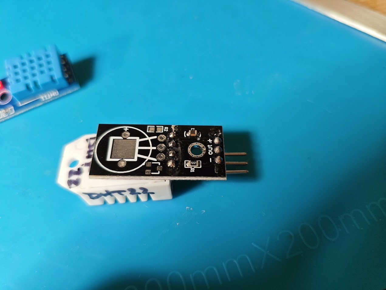

    ah OK. I've not even tried my DHT11 and DHT22 on Beken OBK.
    Connected the DHT22 anyway
    Display of sensor data for DHT22 and DHT11, indicating zero temperature and humidity.

  • ESP32 DHT11 and DHT22 still fail on GPIO4
    #70 21222245
    Posts: 5236
    Help: 450
    Rate: 920
    Anyway, it doesn't look like it's working
    indeed. thought I'd demonstrate further ;)
    Or maybe you forgot the resistor?
    theyre these with resistors on board. and DHT11 works in Tasmota (DHT22 driver doesn't seem to be in the unofficial C2 build image) edit: used AM2301 driver
    DHT11 module with resistors on a blue background. Module with three pins on a blue mat, next to a DHT11 sensor.
    Is your pin index correct?
    how do I determine this?
    I have confirmed pin 4 is GPIO4 with an LED/Relay assignment.
    I've just tried DHT11 and DHT22 on ESP32-WROOM-32 too and I have the same result.

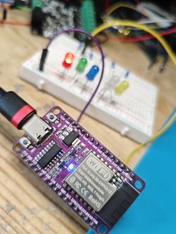

    insmod wrote:
    PWM now works
    1344_merge_7a09f42bfbdd. quick test with ESP32-C2 and a single LED is good.
    ESP32-C2 board connected to LEDs on a breadboard.
    dimming 'works'. flickery for me but I assume my LEDs are rubbish

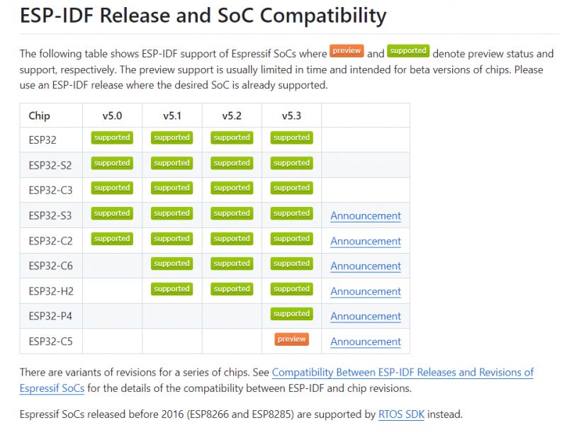

  • ESP8266 RTOS SDK may simplify the port
    #78 21223268

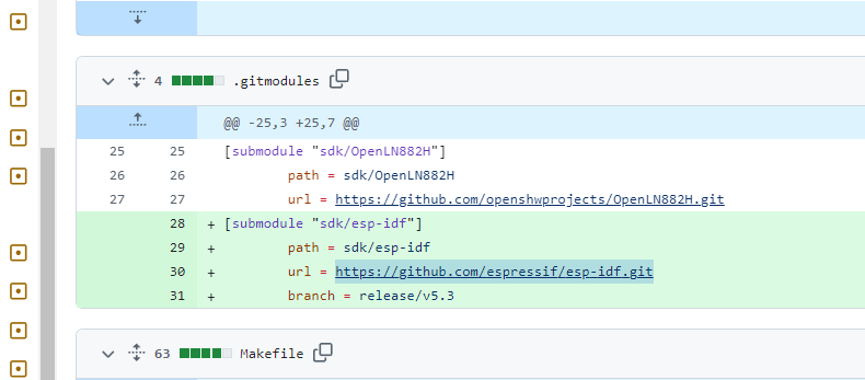

    Posts: 14797
    Rate: 12954
    Port is using esp-idf SDK:
    https://github.com/espressif/esp-idf.git
    Code snippet showing changes in the .gitmodules file, adding the esp-idf submodule.
    this SDK only supports:
    ESP-IDF compatibility table for Espressif SoCs with support indications for various versions.
    However, there is also:
    https://github.com/espressif/ESP8266_RTOS_SDK
    And it seems to have lwip and most of the required stuff. So the main question would be how to setup the project and build process, the C porting itself should be very easy.

  • BMPI2C startdriver settings for ESP32 sensors
    #80 21223521
    Posts: 5236
    Help: 450
    Rate: 920
    ESP32 WROOM-03 1344_merge_7a09f42bfbdd
    woohoo. finally got something. this is on ESP32 though. nothing for me on C2 yet.
    ESP-WROOM-32 module pin diagram with labels
    Display showing information about ESP32, temperature, and pressure from BMP280 sensor.

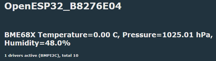

    and BME680 (but no temp)
    command rationale:
    Screenshot of sensor readings from BME68X on ESP32.

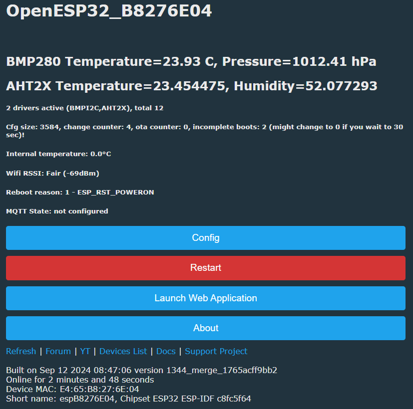

  • BMP280/AHT20 and AHT10/AHT30 driver examples
    #85 21223708
    Posts: 5236
    Help: 450
    Rate: 920

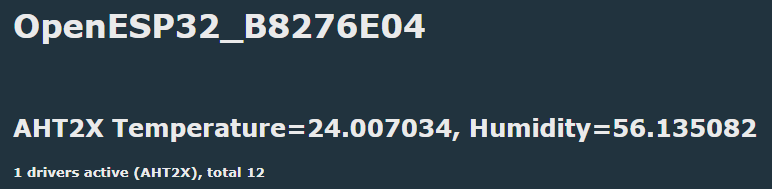

    ah yes. https://www.elektroda.com/rtvforum/topic4042463.html#21205194
    ESP32 ESP-WROOM-03 1344_merge_1765acff9bb2
    BMP280/AHT20 combined module (backlog startdriver bmpi2c 22 21 1 2 0; startDriver aht2x 22 21 3 4)
    Screenshot of the OpenESP32 web interface displaying temperature, pressure, and system status information.
    AHT10
    Screenshot showing temperature and humidity readings from the AHT2X sensor on the OpenESP32_B8276E04 device.
    AHT30
    Screenshot from the OpenESP32_B8276E04 application showing temperature and humidity from the AHT2X sensor.

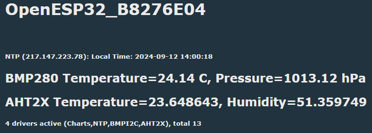

  • Startdriver ntp triggers ESP32 stack overflow
    #87 21223829
    Posts: 5236
    Help: 450
    Rate: 920
    >>21223711
    was looking to make something for all 4 readings but on ESP32 startdriver ntp causes a stack overflow and reboot until device ends up in safe mode
  • #88 21223920
    insmod
    Posts: 1432
    Help: 168
    Rate: 455
    >>21223829 Try again, i increases the stack size
  • Charts start but no data drawn
    #89 21223955
    Posts: 5236
    Help: 450
    Rate: 920
    much better. ntp starts and so does charts,
    @p.kaczmarek2 but nothing drawn. Testing with original script (but with BMP280/AHT20);
    and this I hoped would work with BMP280/AHT20
    Screenshot displaying BMP280 and AHT2X sensor data on the OpenESP32 interface.
