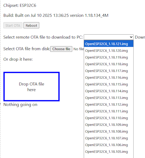

    ESP OTA list is frozen at 1.18.121
    1.18.122 was the big w800 + berry merge
    Configuring OpenBeken on ESP32 with 4MB Default Using sdkconfig.defaults.esp32
    Also the ESP downloads in the table above the assets are dead

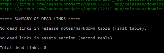

    just a little GPT thing 'I' made
    Code: Python
    Added after 5 [minutes]:
    actually, it's not fetching all assets. hmm
    Code: Python

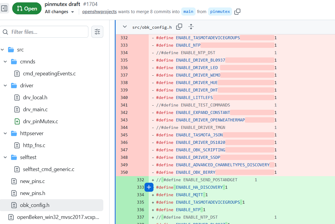

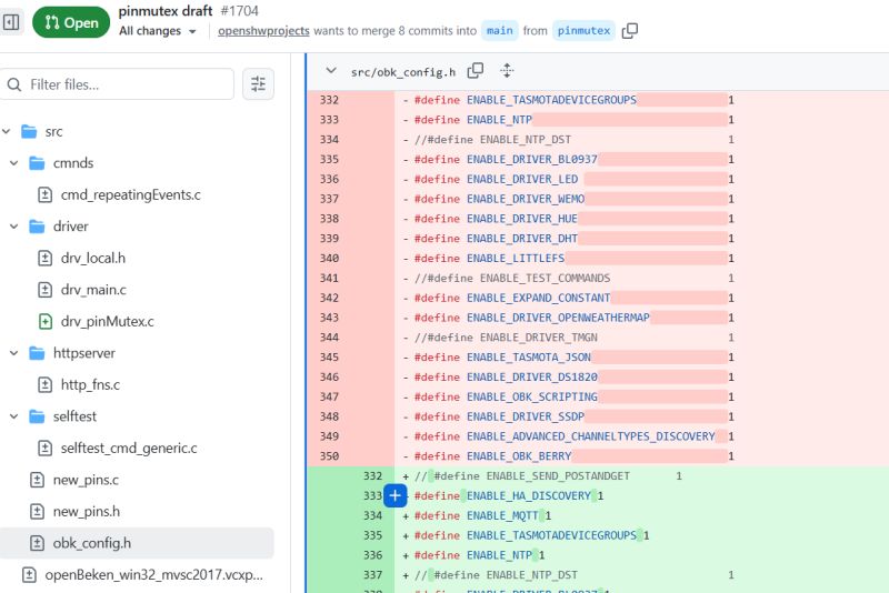

    Oh? Did something broke? If so, please do. I merged some pending PRs and now I am about to try something with BK7238 IR
  • #172 21630398
    insmod
    Posts: 1395
    Help: 164
    Rate: 436
    Restored indentations, plus fixed ESP build

    And again... it seems fixing merge conflicts in Visual Code breaks indent? Very strange. I will discard this file and take it from main.
    Changes in obk_config.h file showing removed and added preprocessor defines

    >>21630916
    Ident is already broken in main.
    I re-idented everything in spi led pull request.
    It's merge ready.
    I won't do realtek spi led in that one, if i do - it will be in a separate pull req. Current problem is that DMA requires offsets and length to be aligned to 32 bits.
    I probably won't for some time, i'm waiting for BW15 dev board.
    I use VSCodium for merge conflict resolution, it works fine (at least for me).
