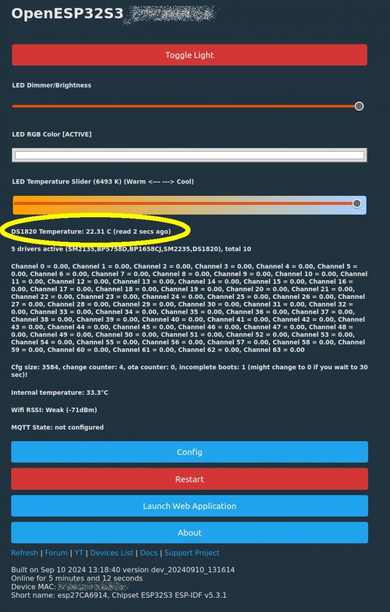

    Well I guess it's acceptable. I wonder if DHT and DS18B20 are working already? They had some strict timing requirements that were hard to satisfy on few platforms.
    I've read that BME280 works, which is good, but BME280 is I2C-based where we have a clock line so it's more or less more resilent to bad timings.

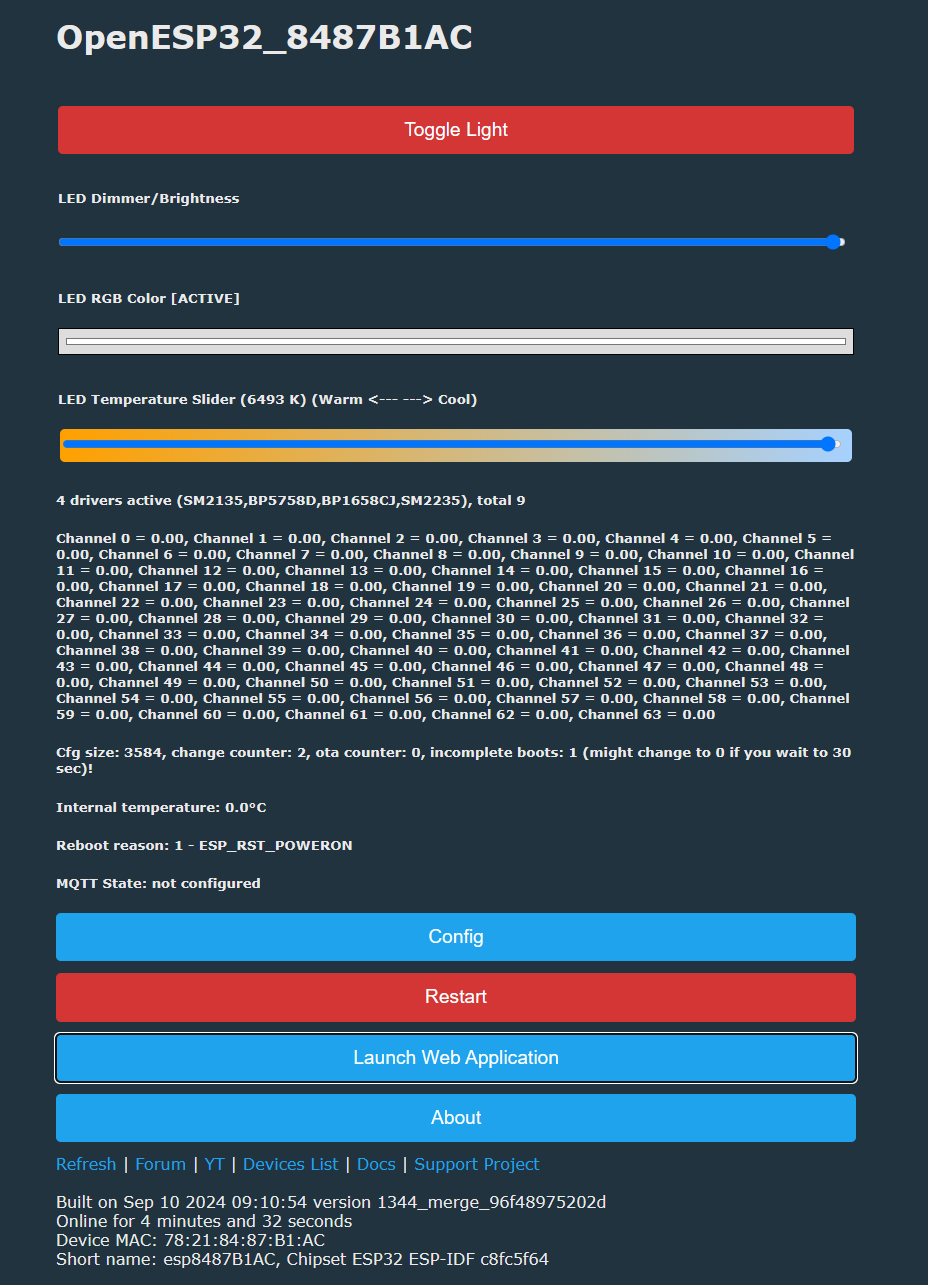

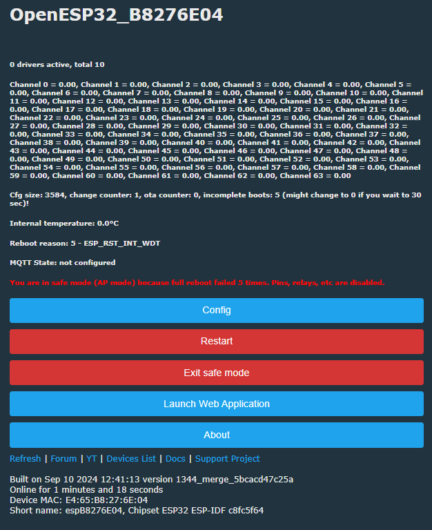

    Restart crashes the board, and after ota it crashes even before then. Thankfully OTA completes successfully, even if it could be rather long (sometimes ~5-10sec, once about a minute). ADC now works.

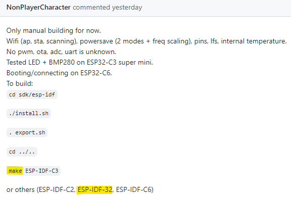

    DeDaMrAz wrote:
    ESP32-D0WD
    The ESP32-D0WDs are different aren't they architecture-wise?
    If this means a binary for the ESP32-D0WDs, can someone please make it and post
    Screenshot of a comment discussing software building for ESP32.

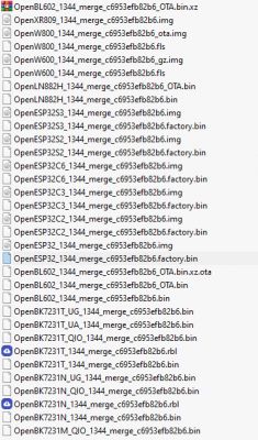

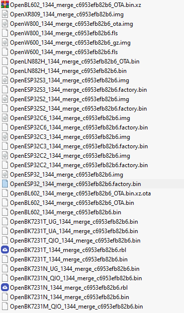

  • #35 21221237
    Posts: 5062
    Help: 438
    Rate: 893
    ah yes. cool. thanks
    Added after 12 [minutes]:
    that's a pretty sight
    List of binary and system image files in a directory.

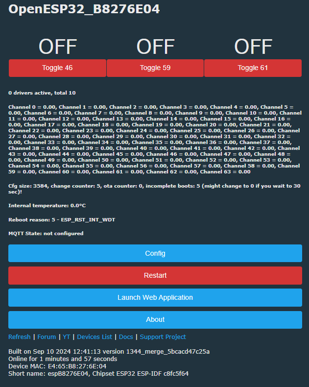

    alas. this is the current log on a 4mb ESP32-D0WDQ5-V3 (revision v3.1) (ESP-WROOM-32)

    I (78) boot.esp32: SPI Flash Size : 2MB

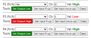

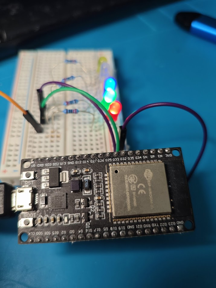

    I have some trouble to get the GPIOs working, or maybe I'm just doing something stupid when trying...
    "Toggle" of a channel with a relay pin seems not to change the output?!?

    Main problem i encountered, is that esp_restart causes a crash (most often is "A stack overflow in task sys_evt has been detected").
    If someone knows how to debug this, here is a coredump

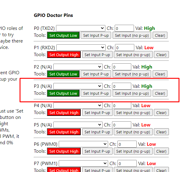

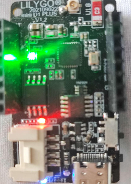

    For me, GPIO works ok, I can toggle LED on my board:

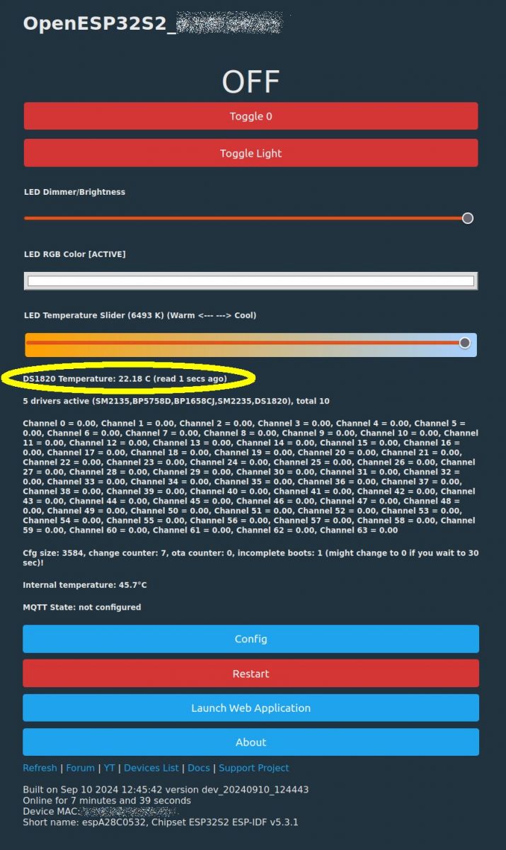

    Info:CFG:DS1820 - Pin=18 temp=+22.18
    Info:CFG:DS1820 - High=1 Low=99 Val=355 Tc=2218  -- Read CRC=32 - calculated:32
    Info:MAIN:Time 314, idle 0/s, free 58104, MQTT 0(0), bWifi 0, secondsWithNoPing -1, socks 0/0
    Info:MAIN:Time 315, idle 0/s, free 47824, MQTT 0(0), bWifi 0, secondsWithNoPing -1, socks 0/0
    Info:CFG:DS1820 - asked for conversion - Pin 18
    Info:MAIN:Time 316, idle 0/s, free 58104, MQTT 0(0), bWifi 0, secondsWithNoPing -1, socks 0/0
    Info:MAIN:Time 317, idle 0/s, free 58276, MQTT 0(0), bWifi 0, secondsWithNoPing -1, socks 0/0
    Info:MAIN:Time 318, idle 0/s, free 58276, MQTT 0(0), bWifi 0, secondsWithNoPing -1, socks 0/0
    Info:MAIN:Time 319, idle 0/s, free 58276, MQTT 0(0), bWifi 0, secondsWithNoPing -1, socks 0/0
    Info:MAIN:Time 320, idle 0/s, free 55968, MQTT 0(0), bWifi 0, secondsWithNoPing -1, socks 0/0
    Info:MAIN:Time 321, idle 0/s, free 58328, MQTT 0(0), bWifi 0, secondsWithNoPing -1, socks 0/0
    Info:MAIN:Time 322, idle 0/s, free 58620, MQTT 0(0), bWifi 0, secondsWithNoPing -1, socks 0/0
    Info:MAIN:Time 323, idle 0/s, free 22696, MQTT 0(0), bWifi 0, secondsWithNoPing -1, socks 0/0
    Info:MAIN:Time 324, idle 0/s, free 34504, MQTT 0(0), bWifi 0, secondsWithNoPing -1, socks 0/0
    Info:MAIN:Time 325, idle 0/s, free 58448, MQTT 0(0), bWifi 0, secondsWithNoPing -1, socks 0/0
    Info:MAIN:Time 326, idle 0/s, free 58156, MQTT 0(0), bWifi 0, secondsWithNoPing -1, socks 0/0
    User interface with settings and DS1820 temperature reading.
    Really fantastic work, @insmod !
    BTW: Where do all these channels. sliders etc come from?
    Added after 13 [minutes]:
    ... and here my diff_file to make DS1820 work.
    Changes made to driver:
    - no "critical" sections for reading and writing - taskENTER_CRITICAL() and taskEXIT_CRITICAL() seem to need a parameter (at least on ESP32, to decide, which CPU core is meant, if I got the error message right. So it's just disabled for the time beeing
    - usleep is "plain" usleep() from sdk. It worked right out of the box for me on S2 ...
    • esp_DS1820.diff.txt (5.83 KB) You must be logged in to download this attachment.

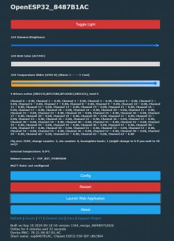

    sliders are from SM2135 driver (and similiar LED drivers), but why do you have all 60+ channels visible? Did you set their channelTypes?
  • #47 21221562
    max4elektroda
    Posts: 755
    Help: 48
    Rate: 187
    Nope, I only set the DS1820 pin and started the driver.
    Startup command is empty - I see no file in LFS.
    The other settings are somehow "preinstalled", but at a first glance I didn't find out where/how/why ...

    @divadiow @DeDaMrAz : Could you please try on your "non C/S" ESP32 if GPIOs do work as expected? On my DevBoard, they won't ...
  • #51 21221600
    Posts: 14615
    Help: 655
    Rate: 12631
    so what channel types do you have set in web app? Or maybe the PR author just modified smth...
  • #52 21221605
    DeDaMrAz
    Level 22  
    Posts: 603
    Help: 34
    Rate: 129
    >>21221591 non C/S board here and confirmed same as yours - non working with ESP32-factory.bin
    ESP-WROOM-32 board btw.
  • #53 21221608
    insmod
    Posts: 1395
    Help: 164
    Rate: 436
    Probably broken smth when updated partitions.csv. Try erase_flash, then flash factory.bin

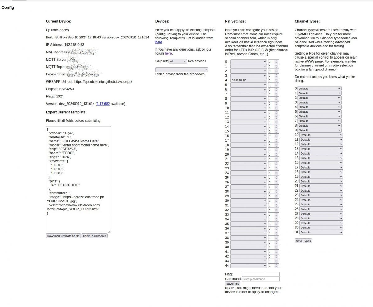

  • #54 21221613
    max4elektroda
    Posts: 755
    Help: 48
    Rate: 187
    "It wasn't me. It was like this before" ;-) ;-)
    I only configured the one pin for DS1820 and started this driver.
    Nothing else touched ...
    Screenshot of ESP32S3 device configuration with one pin set for DS1820.

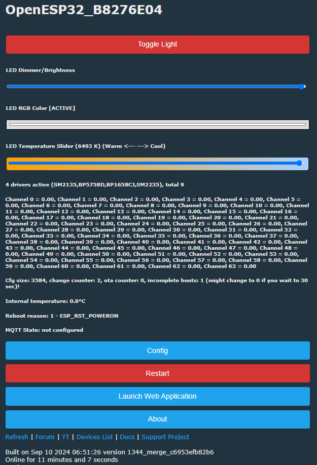

  • #55 21221622
    Posts: 5062
    Help: 438
    Rate: 893
    >>21221591
    with 1344_merge_c6953efb82b6 3 LEDs on IO2, 4, 17 pull high OK without crashing
    Screenshot of a settings interface with three lines, each with toggle switches and setting buttons.
    ESP32 board connected to three LEDs on a breadboard.
    Added after 21 [minutes]:
    the same LED functionality after erase_flash and reflash to 1344_merge_c6953efb82b6
    then with erase_flash -> 1344_merge_5bcacd47c25a (factory.bin works now) the LEDs work the same.
    Screenshot of the OpenESP32 user interface with three LED toggle buttons.
    WDT keeps putting device into safe mode though
    Screenshot of the OpenESP32 web interface in safe mode, showing system status information and configuration buttons.

  • #57 21221658
    Posts: 5062
    Help: 438
    Rate: 893
    to be clear though, I am not getting random reboots (none experienced yet anyway)
    System message with build date, version, and online time.
    but manual reboots, when initiated, always land me in safe mode. and because of this, always in AP mode.
  • #58 21221676
    max4elektroda
    Posts: 755
    Help: 48
    Rate: 187
    OpenESP32_1344_merge_5bcacd47c25a.img only starts in safe mode here. But even after exiting safe mode, I can't use the GIOs...
    Chip is ESP32-D0WDQ6 (revision v1.0)
