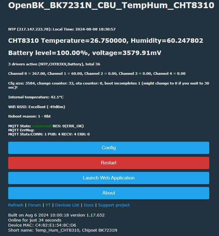

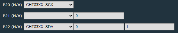

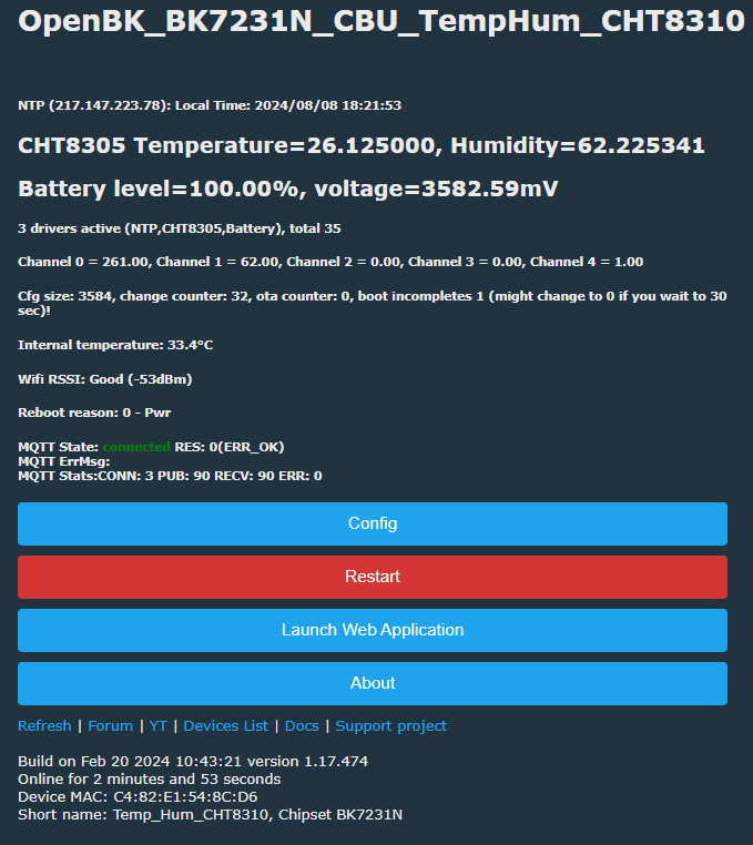

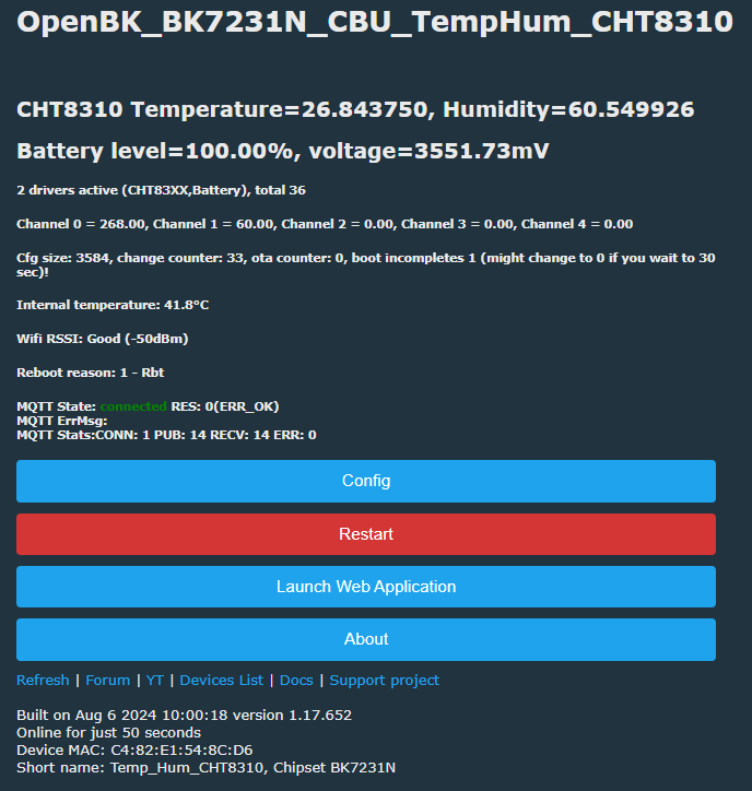

    I thought I'd dig out the TH01 with CHT8310 that was the subject of the first post. It's not been flashed for a while, way before the driver refactor. Thought I'd post before and after for no real reason other than to demonstrate the differences and any issues experienced in the process.
    No battery or CHT calibration config in autoexec, only backlog PowerSave 1; startDriver battery; startDriver NTP; startDriver CHT8305
    Before - 1.17.474
    OpenBK software interface for CHT8310 displaying temperature, humidity, and battery level data. Screenshot of module configuration settings showing P20, P21, and P22 connections.
    After - 1.17.652
    Screenshot of the OpenBK device configuration panel with CHT8310 sensor. Screenshot of pin configuration for CHT83XX sensor.
    and with no autoexec or startup commands
    OpenBK interface screen displaying CHT8310 data, including temperature, humidity, and battery level.
    so no issues.

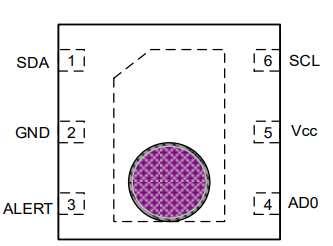

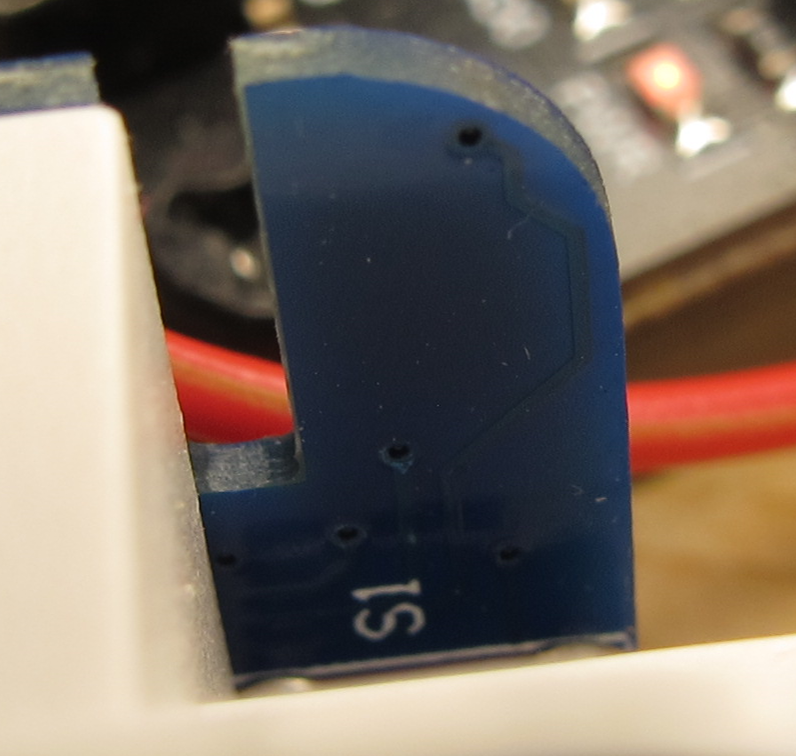

    I just thought of something obvious. I hadn't actually confirmed the alert pin goes anywhere on this device. The original fw does not have any pin info, so I can't confirm with alt_pin_pin presence in the extraction json. I'm not getting continuity from alert leg to any CBU contacts but it looks like it goes somewhere. I'll try to trace and try +0.1
    Close-up of a circuit board with visible electronic components.
    Diagram of integrated circuit pins labeled SDA, GND, ALERT, AD0, Vcc, SCL.
    Close-up of a section of a circuit board with the S1 marking and a red wire in the background.
    also, how does the driver know which GPIO the alert is on or is the alert over i2c?
    but if it's over i2c why's there an alert pin?
    Added after 9 [minutes]:
    no waking with dInput set on P7 with unused channel 9 (what is the significance of that?) - tested with CHT_Alert 10 5 2

    insmod wrote:
    Pindeepsleep will wake from any pin, assuming it is connected to mcu
    ah OK. makes sense. I'll do more testing.

    ok sure, thanks. and yes, continuity from alert leg to R7 then onwards to P7

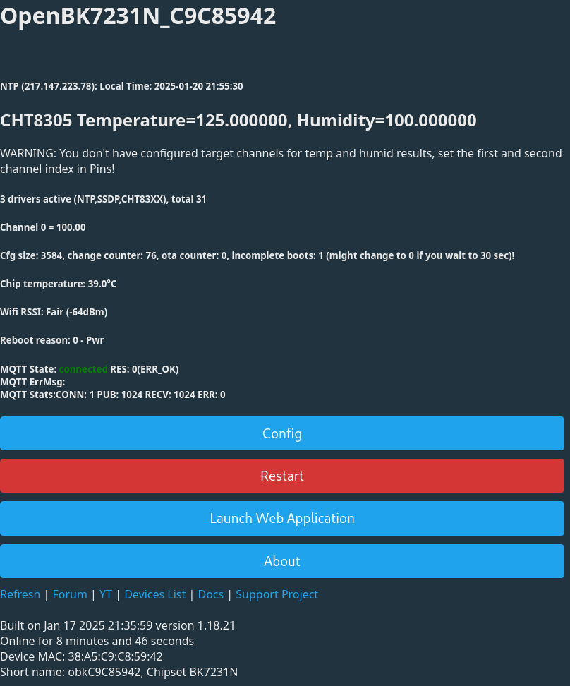

    My problems are:
    1. On the main page the temperature values are not correct on the top section, but more or less correct in CHT8310 section:

    1. Change the channel types in the web app, because it seems like you're trying to, for example, map humidity to temperature channel. Changing channel types will also help with HASS discovery

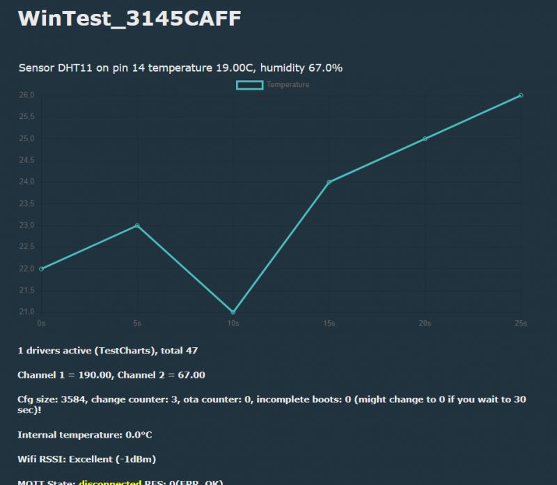

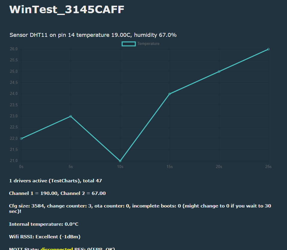

    I'm wondering how feasible would be drawing temperature/humidity charts on the device itself:
    Temperature graph showing data from DHT11 sensor on a dark background.
    The device for this use case would have to be powered from a power supply (obviously NOT batteries), but apart from that, the idea seems to make sense.

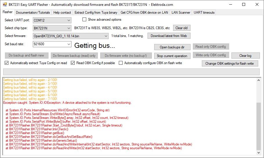

    Hi, I got one of these and after some trial flashed latest OBK without errors using the BK7231GUIFlashTool v5 and a CP2102 adaptor. But now it's bricked, won't boot (no led) and when I try to connect to serial it gets stuck in "Getting bus" cause power reboot don't work, and randomly gets the error below:
    Screenshot of BK7231 Easy UART Flasher application with communication errors.
    Any thoughts?
    Thanks in advance

    Posts: 289

    Simple question: do you have an external 3.3V voltage regulator?

    Posts: 14416
    Help: 650
    Rate: 12371
    I know this issue. Do you also hear USB unplug sound when you reset? This happens when you overload USB port. The inrush current when you connect power is too high and USB protection kicks in.
    @GAAD asked good question, but many things depend on your circuit and USB to UART converter. CP2102 doesn't look like something that can provide enough current at 3.3V for flashing.

    andresterf
    >>21385805
    Negative, powering directly from CP2102 3.3V PIN, plugged to a USB 2.0 port. I don't have an external power supply at the moment, so I will try using a USB 3.0 port for the moment.
    Added after 6 [minutes]:
    >>21385909
    It flashed without errors, all green till the end, and I don't recall the adapter making any sound when it asked for the reboot, and powering off/on the device does nothing, but if any TX/RX jumper cable is touched the above error kicks in.
    For knowledge, when trying to flash the reboot step was a little trick, and whenever it failed I had to close BK Flasher and disconnect and reconnect the adapter from the PC, otherwise it would always fail to open the serial port.
    I will try the USB 3.0 port and also will look for an external power supply.
    Thanks!
    [UPDATE]
    Tried powering using 3.3V from and old Raspi but the device is dead, no led light or any kind of response!
    [UPDATE 2]
    Actually the device isn't dead, after tweaking around I figure out it is working but the led light is off, manage to configure web access and now I will mess around the configs.

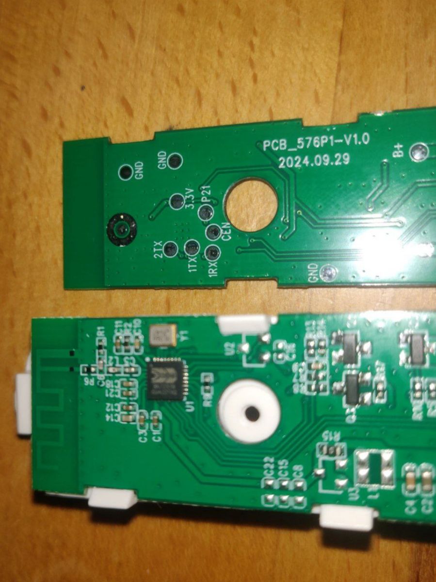

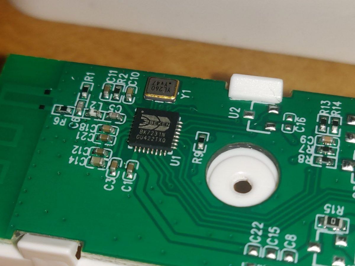

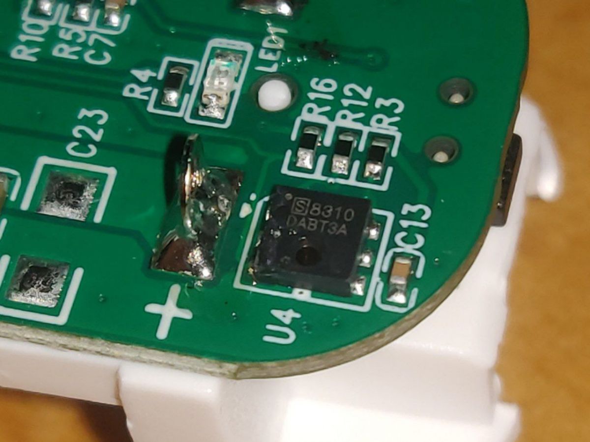

    Hi, I was wondering if I could get some help with my devices. They are certainly on BK7231N and the temperature chip seems to be a CHT8310. OpenBeken flash with the latest version with CloudCutter was without any problems. Whichever pin config I try I am getting 125°C Temperature and 100% humidity in sensor readings. How could I proceed with config?
    Close-up of a circuit board with a visible S8310 DABT3A integrated circuit.
    Close-up of a circuit board featuring a BK7231N chip and other components.
    Disassembled electronic device with a circuit board next to its casing.
    Two green circuit boards with various markings and components on a wooden surface.
    Screenshot of the OpenBK7231N software interface showing temperature and humidity reading issues.
✨ The discussion centers on the Tuya-based generic Wi-Fi temperature and humidity sensor labeled as TH08 but identified as TH01 with a Sensylink CHT8310 sensor and BK7231N chip on a CBU board. Users share experiences with flashing OpenBK firmware using BK7231GUIFlashTool and CP2102 or other USB-serial adapters, addressing issues like firmware patch detection, flashing failures, and device bricking due to power supply limitations. A community-developed CHT8310 driver integrated into the CHT8305 driver supports the sensor, requiring proper pin configuration, including dual channels for SDA and BAT_Relay pins. Calibration challenges are noted, especially temperature offsets and poor accuracy at low temperatures, with some users applying software offsets. Battery monitoring and management are discussed extensively, including identifying BAT_Relay and BAT_ADC pins, voltage calibration, and scripting autoexec.bat to optimize battery life and prevent bootloops on low battery by conditional deep sleep durations. The ALERT pin on P7 is used to wake the device from deep sleep on environmental changes, reducing power consumption. Users also explore polling rate adjustments to reduce unnecessary sensor reads. Integration with Home Assistant via MQTT is addressed, with configuration tips to avoid data misinterpretation. Some users report pairing issues with the original Tuya app after battery depletion, resolved by router resets. The community contributes device templates with detailed pin assignments and commands, improving support in OpenBeken firmware and cloudcutter profiles. Discussions include hardware details like the PW33 boost converter, power supply considerations, and potential for device display enhancements. Overall, the thread provides comprehensive technical guidance on flashing, configuring, calibrating, and optimizing the Tuya TH01/TH08 sensor with CHT8310 using OpenBK firmware.
