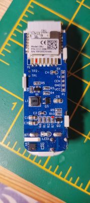

    I've updated the first post with a work-in-progress OBK template.
    wifiled_n and btn confirmed.
    Unsure/unknown:
    -should all have different channels?
    -P7 - BAT_Relay?
    I have continuity between P7 and this component with the red dot, does this indicate BAT_RELAY @artin961 ?

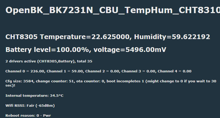

    @p.kaczmarek2 interesting there are 3 devices with "CHT83x" in the keywords, but none with pin assignments.
    also, can the template creation/import function add secondary channel support so ""CHT8305_SDA;0;1" is valid
    Fragment of configuration code with assigned values for pins.
    console using ext psu to CBU pins
    Screenshot displaying diagnostic data of the CHT8305 temperature and humidity sensor and battery level.
    console on 2x AAA batteries
    Screenshot displaying temperature, humidity, and battery status data from the OpenBK system.

    ah, my previous question is already answered. BAT_ADC and BAT_Relay should have channels set that are different to each other and to any other channel set on the same device.
    Added after 14 [minutes]:
    final template and PR https://github.com/OpenBekenIOT/webapp/pull/77

  • #46 20972286
    TheNitek
    Are you sure on the button pin? For me it seems to be 14, not 15.

    The Home Assistant discovery must be done after configuring the Battery driver. If you have run the Discovery first, then you must run it again.
  • #55 20977072
    hojnikb
    Posts: 45
    Smashing! I've done that and it works. Looks like battery report isn't on the regular 0 or 1 channel, but its own separate.
    In any case, the whole low battery behavior still needs to be resolved I'd think.
