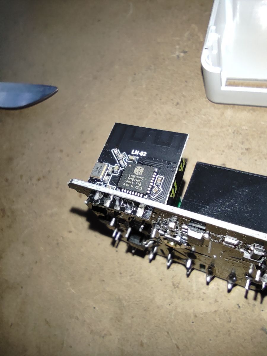

    I don't have a device to test this yet, but the results are very promising. Who can help with testing?
    I have an aftermarket switch on this chip, to be exact:
    Close-up of a circuit board with visible electronic components. With programming this I won't help, but once you have something ready I can upload and test it.
    Can you try my flash dumping tool on this and share the files?
    -(e)

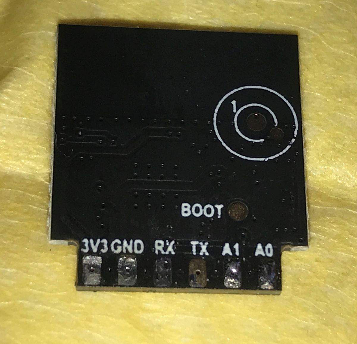

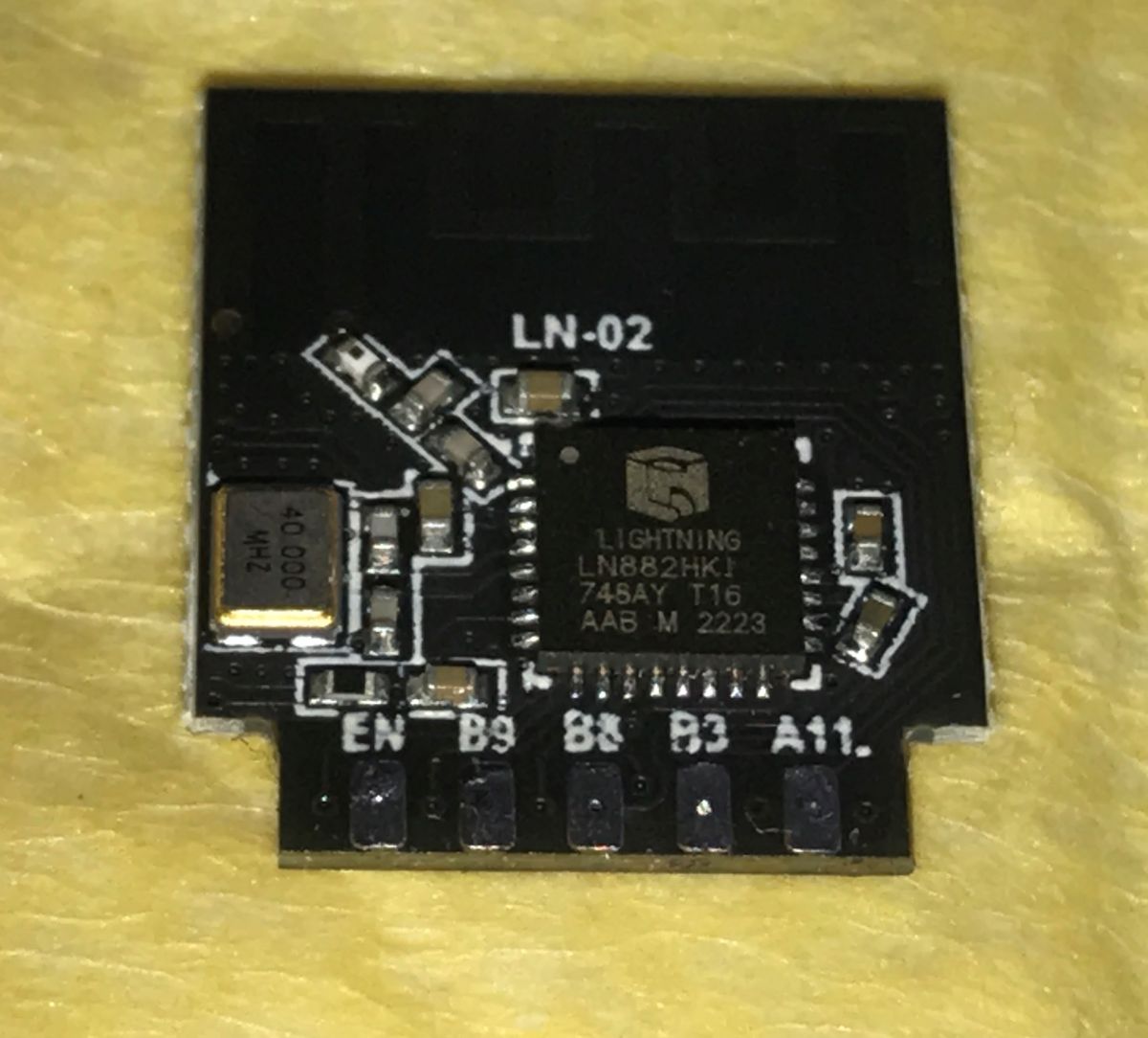

    A letter has arrived today:
    Electronic module with labels on a black background. Electronic module on yellow fabric background.
    Let's see what I can do with that module. I hope I won't brick it too early, as it's my only one so far!

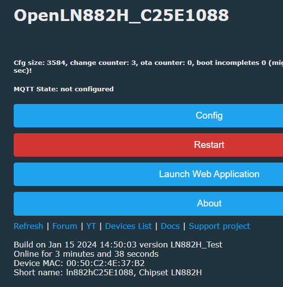

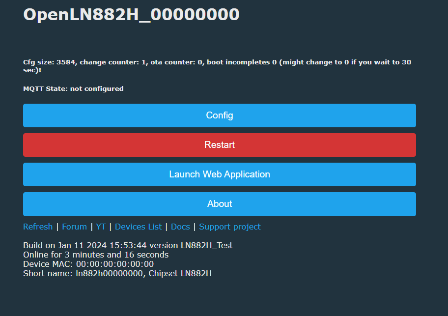

    I will try to get GPIO working:
    User interface for OpenLN882H device with configuration options.

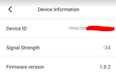

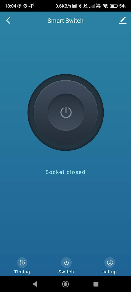

    >>20902912

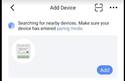

    I did a memory dump with your script in python. It takes a very long time to do, about an hour.
    This is a new device, not yet paired with the app. It works with the Cozylife app instead of SmartLife.
    • cozylife_ln882hki_dump.zip (934.02 KB) You must be logged in to download this attachment.

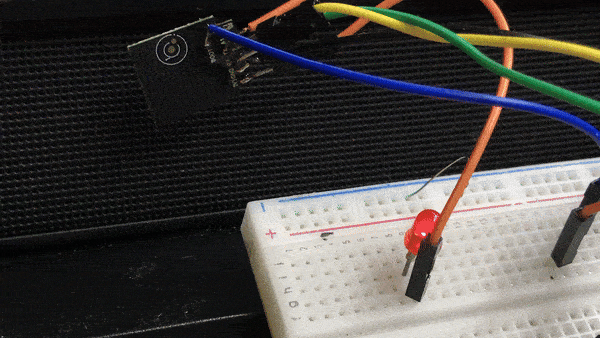

    LN882HK + OpenBeken blink LED (GPIO works!):
    Flashing LED on a breadboard connected to a sensor with wires.
    Excellent! We are making progress :)

  • J-Link SWD flashing works on WL2S board
    #100 20905937
    sithyoda
    Posts: 37
    I just picked a brand new WL2S board from another LSPA9 module and was able to dump the original firmware (dump attached).
    So I guess I soldered everything correctly to the board.
    Unfortunately, I'm still not able to flash OBK. After 3 seconds of heavy rx/tx traffic, the LEDs on my CP2102 module get dark and about 20 seconds later I get: "Fail. Error downloading file."
    After removing A9 and rebooting to normal, I see an SSID called "SmartLife-392D", so I'd say the original flash was not touched at all.
    So I flashed it with my J-Link SWD and can confirm, that this method works. I'm ready to start my tests.

    #110 20911764
    Posts: 5220
    Help: 449
    Rate: 918

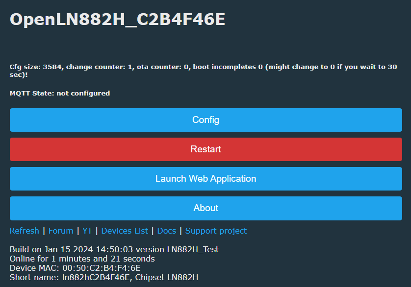

    Here is my dump and flash images from this device - https://www.elektroda.com/rtvforum/topic4014743.html#20911009
    It took approximately 1 hour 20 minutes to dump, about which chatgpt says:
    For a file of 4,186,112 bytes to be downloaded over serial in approximately 1 hour and 20 minutes, the speed would be around 6977 baud
    so not quick. Being an LN882HKI, I was expecting a 2mb bin, but it's 4mb, so :shrug:
    Screenshot showing a WiFi network named OpenLN882H_C2B4F46E.
    OpenLN882H user interface with configuration and management options.
    A1/P2 is Rel
    B3/P19 is LED_n
    B8/P24 is Btn
    • cozylife_16a_mini_switch_LN882HKI_flashdump_flash.zip (949.71 KB) You must be logged in to download this attachment.

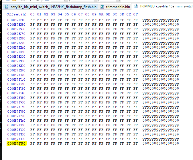

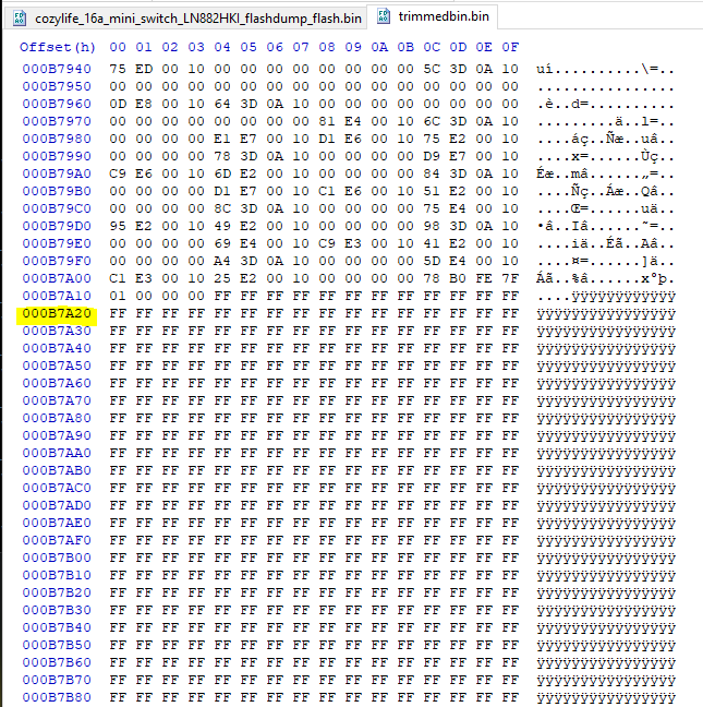

  • #114 20912470
    Posts: 5220
    Help: 449
    Rate: 918
    Oh cool.
    Thanks for checking. What did you use to analyze the dump, by the way?
    I wonder what would happen if I tried to flash it back to that dump.
  • Trim dump to 2 MiB before reflashing
    #115 20912503
    sweetlilmre
    Posts: 29
    divadiow wrote:
    Oh cool.
    If you chop the file size to 0x00200000 (2MiB or 2097152 bytes) and discard the remainder, it should work.
    In fact, if you could test this, that would be fantastic.
    I would:
    - Split the file in 2 using something like HxD at the 0x00200000 mark,
    - Take the first file and examine it; there should be tons of FF bytes at the end
    - Trim this file to the last 4K boundary that contains FF's
    - Reflash and see what happens
    But just splitting off everything above 0x00200000 should do the trick
    -(e)
  • Trimmed firmware bin flashed successfully
    #116 20912510
    Posts: 5220
    Help: 449
    Rate: 918
    Sure. Will have a go tonight
    Added after 5 [hours] 41 [minutes]:
    >>20912503
    ah yes. I see the code repeat, and...
    success!
    I made a new bin of 0 - 0x00200000 code only then trimmed FF down to and including 0x000B8000 because 0x000B8000 is the next 4k (I think?). FF starts here:
    Screenshot of a hex editor displaying data inside a binary file with a highlighted value.
    Screenshot of a hexadecimal editor with open binary files showing stored data as FF strings.
    I flashed the trimmed bin, which only took a few seconds, then repowered with no BOOT low. The Cozylife log output as expected

    and the device LED was flashing waiting for new pairing. I paired with the Cozylife app to confirm details and operation of relay was as expected. RESULT!
    Smart Switch app interface with power toggle button and status Socket closed.
    Screenshot of device information from the app, showing device ID, signal strength, and firmware version.
    Device adding app screen with nearby device search in pairing mode.
    • TRIMMED_cozylife_16a_mini_switch_LN882HKI_flashdump_flash.bin (736 KB) You must be logged in to download this attachment.

  • Full flash erase fixed OpenLN Wi-Fi setup
    #120 20914464
    Posts: 5220
    Help: 449
    Rate: 918
    Somehow I messed up the wifi and it was no longer broadcasting OpenLNxxx, even after re-flashing and reboots. Flashing back to stock also made it discoverable in the Cozylife app (maybe this is just the bluetooth bit?), but it would not complete the setup on any of my 2.4Ghz networks (always with wifi setup failed type error in app). Switched firmware back and forth a few times.
    Finally fixed with an erase of flash then a fresh OpenLN flash.
    -power up with BOOT low as normal
    -switch to RAMCODE mode with
    LN882H_CMD_Tool.exe COM9 download ram 0x20000000 .ConfigLN882H_RAM_BIN.bin
    -confirm boot mode changed to ramcode mode with
    LN882H_CMD_Tool.exe COM9 mode read
    -erase all flash with
    LN882H_CMD_Tool.exe COM9 flash erase_all
    -flash OpenLN as normal with
    LN882H_CMD_Tool.exe COM9 download flash 2000000 0x0 flashimage.bin
    Added after 19 [minutes]:
    different mac address now
    Screenshot of OpenLN882H_C25E1088 interface with configuration options.
