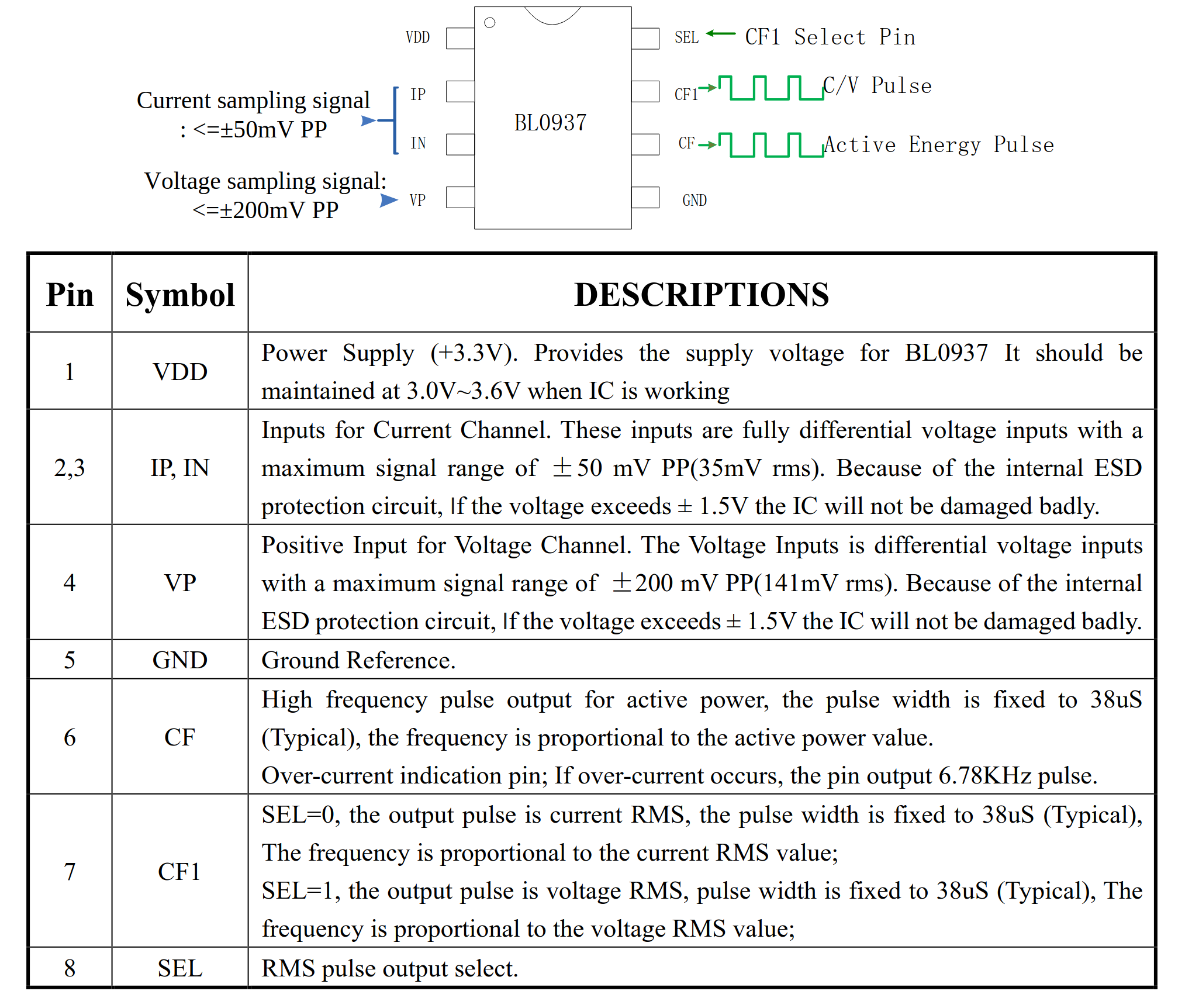

    You will need the correct pin configuration for your plug to get the power meters readings.
    Can you trace the BL0937 pins to the pins of the LN882H?
    Pinout diagram and pin function descriptions for BL0937 IC

    GoldMember wrote:
    Do you mean physical connection between BL0937 and LN882H?
    Yes, you will need to know, which of the BL0937 pins SEL, SEL1 and CF is connected to which LN882H IO pin.
    You might be lucky that someone which exactly the same device than yours allready figured this out or need to do it by yourself.
    Depending on your device you might also "guess" them, if you have a separate LN882H module with only a handful of connections and can "easily" find the relay with IO doctor (you will hear the clicking sound) if you found the right one, then you might also just try all possible permutations. But since the BL0937 usually has the pins easily accessible, it should be possible to check the connections by eye (following the PCB connections) or with a multimeter.

    GoldMember
    Posts: 26
    BL0937 pin - LN 882H pin
    6 --------------- 25
    7 --------------- 26
    8 --------------- 27

    max4elektroda
    Posts: 756
    Help: 48
    Rate: 187

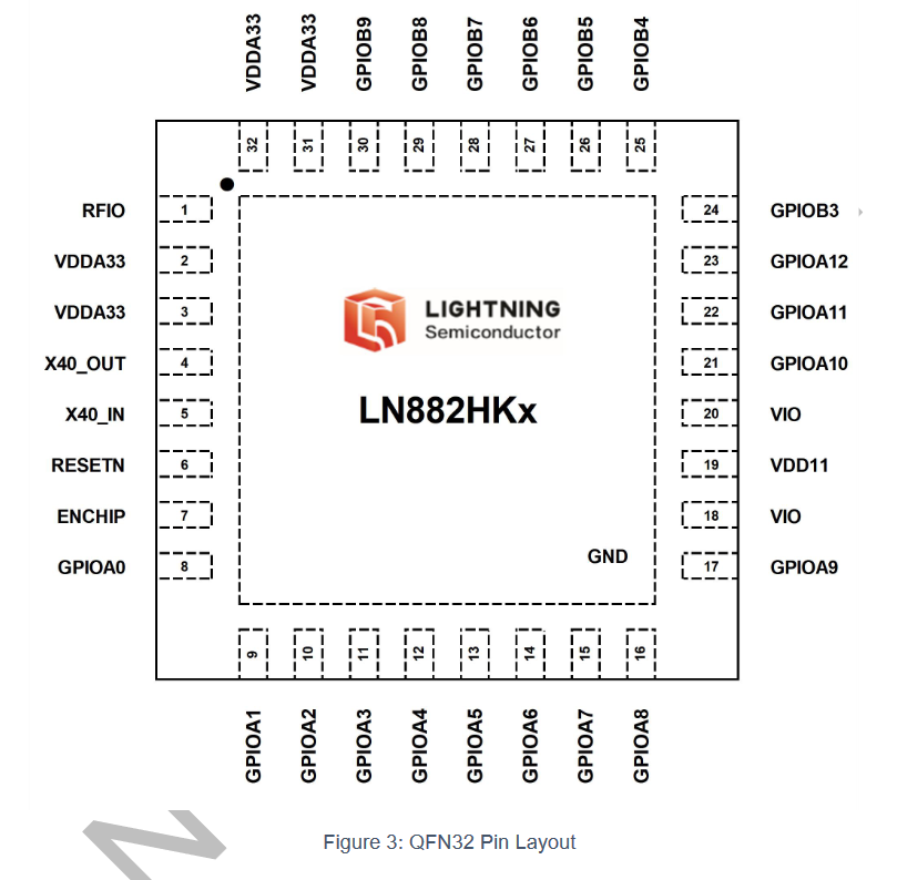

    According to this
    Pin layout diagram of the LN882HKx chip by Lightning Semiconductor (QFN32)
    It should be
    CF (Pin 6) = B4 (Pin 25)
    CF1 (Pin 7) = B5 (Pin 26)
    SEL (Pin 8) = B6 (Pin 27)
    Does it work with this assignment?

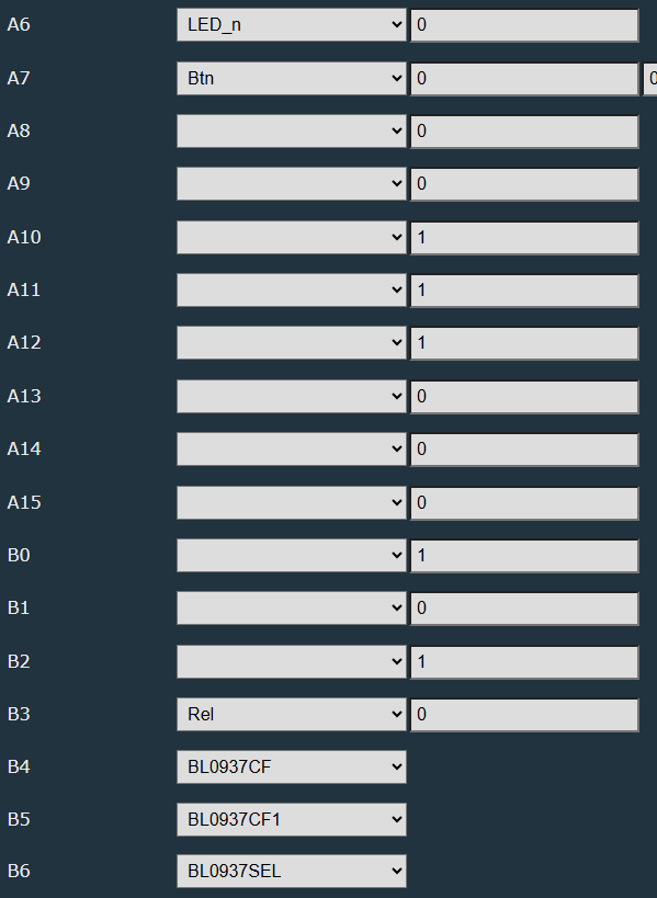

  • #71 21799463
    GoldMember
    Posts: 26
    Yes, it works. Configuration has to be like that:

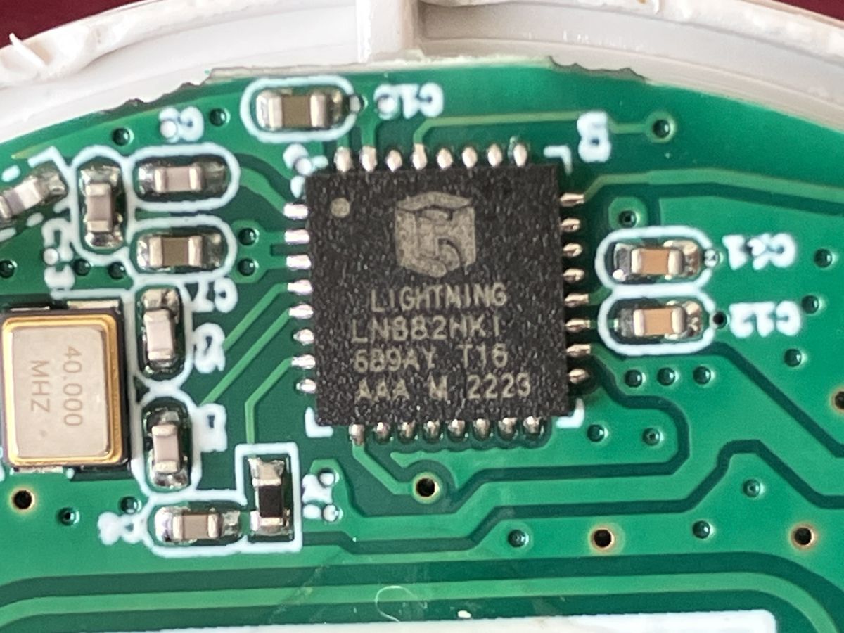

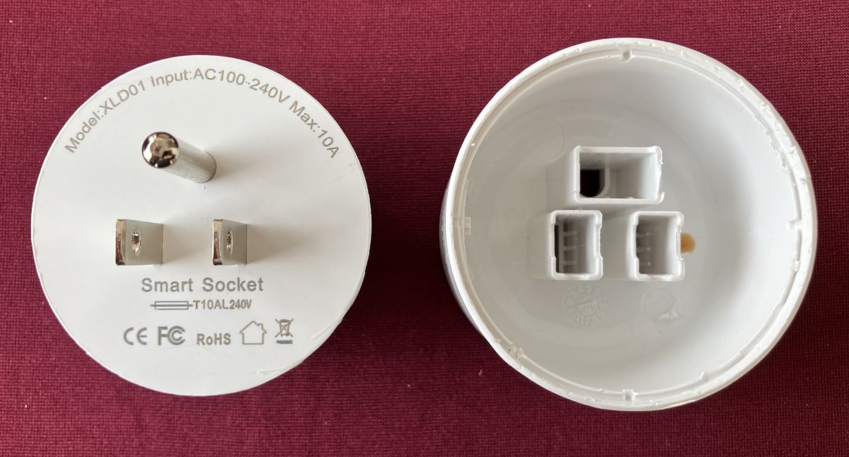

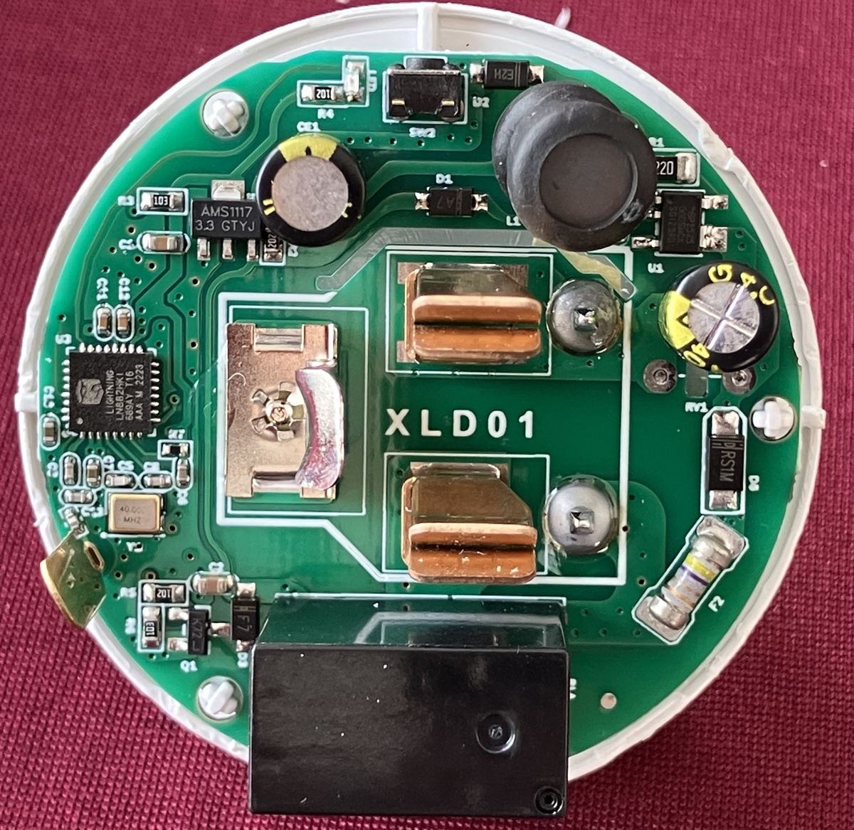

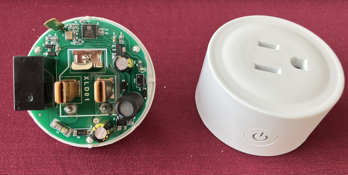

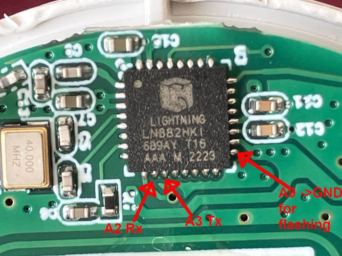

    I have a similar Smart Socket with LN882HKI (it's CozyLife XLD01 10A; check the attached pictures).
    I would really appreciate it if anyone could help me find where I can attach RX, TX, 3.3 V, GND, CEN wires for flashing.
    I've also checked the bottom side of the PCB; nothing useful is there, unfortunately.

    You will need A2 and A3 (Rx and Tx) and A9 needs to be connected to GND for flashing.
    Tried to add the info to your image:
    Close-up of a PCB with a “LIGHTNING” IC and red arrows labeling pins A2 Rx, A3 Tx, and A9→GND for flashing
    If these pins are not connected (maybe there are contacts on the other side of PCB ? but it doesn't look like this) you will need to solder or use some needles...

    Thank you so much @max4elektroda!
    Wondering if there's any place to attach 3.3 V and CEN for reset during flashing. I guess plugging the socket normally and quickly off/on power when needed may also work?
  • #75 21832386
    max4elektroda
    Posts: 756
    Help: 48
    Rate: 187
    I hope it's clear that flashing should NEVER be done while the plug is connected to high voltage?
    LN882H doesn't need reconnecting or CEN, this is only needed with Beken, if I'm not mistaken.
    For this chip, only A9 needs to be connected to GND for flashing.
    I would use LDO (the voltage regulator) for supply of 3.3 V. Your power supply should be capable of delivering enough current to drive the chip, usually output of an USB Uart is not enough!
    On your first picture I see an AMS1117 3.3 on the upper left. Pin 1 (the left one, below the "3.3") is GND, Pin 2 (middle and the big one on the upper side) is +3.3V.
    You might also try "using" the LDO by using a 5V source on the input of the LDO. The 5V should be attached to pin 3, the one to the right while GND is the same (Pin 1).
    If you are unsure, ask again, much better than breaking something with a wrong connection...
