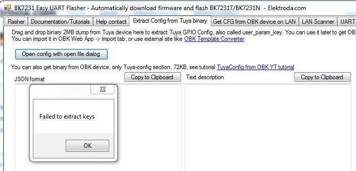

    blacksun2 wrote:
    How can you extract the Tuya OBK information from "flash.bin"? The Elektroda Flasher tool for Beken can't handle flash.bin.
    your dump is from a device with schema e1k70tx4 which we've seen before. Is your device template not this?:
    Easy Flasher cannot extract every config from dump file.
    As far as I know, this is still correct:
  • Easy Flasher cannot extract every Tuya config
    ah, ok, I didn't know that. I thought Easy Flasher can extract any Tuya Templates from any dump of Tuya-devices.

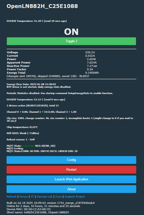

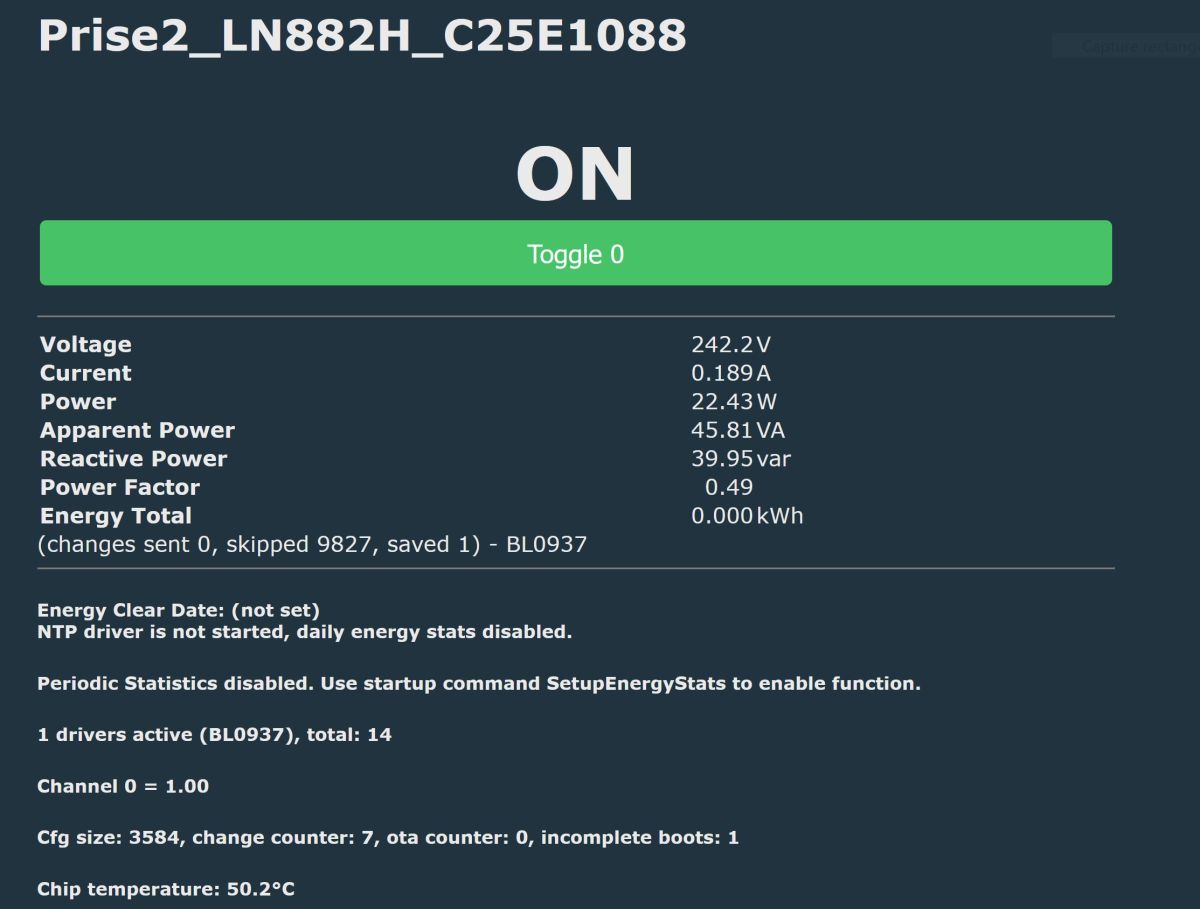

    I have this running currently.
    gif
    Screenshot of OpenLN882H device dashboard displaying sensor and status data
    I can't remember if I calibrated it and I'm not sure if the reading behaviour indicates something is off, but it looks like it's working

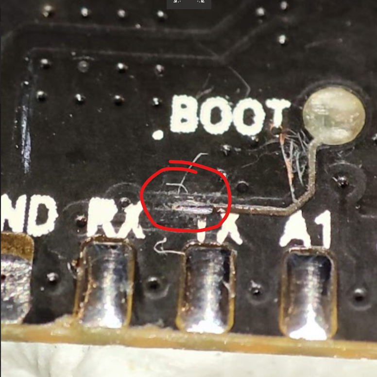

    Added after 10 [minutes]:
    olivluca wrote:
    but I broke the A9 pad while soldering, so I cannot flash it via serial.
    could scrape some of the coating off the leading trace? like: https://www.elektroda.com/rtvforum/topic4028087-30.html#20966104
    Close-up of PCB showing exposed trace between RX and TX pins, marked with a red circle
  • #41 21614489

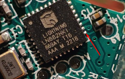

    Close-up of LNB821HK1 chip on PCB with a red arrow pointing at a circuit trace
    So the datasheet is wrong then?
    It's actually like the picture posted below and I'm quite bad with a soldering iron, I'll see if I can get help from a colleague with better equipment and abilities :-D
    @olivluca I would advise against flashing not tested solutions, especially when you can't go back easily when pads break.
    Do you have module version, or like from first post?
    Yes, it's like that, but if nobody tests untested solutions they'll never become tested ;-)
    In any case I broke the pad while re-soldering the cable to flash openbeken....

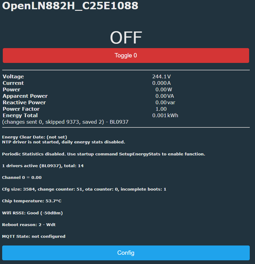

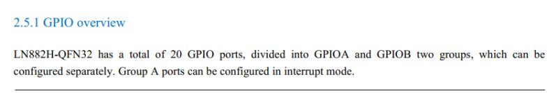

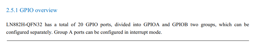

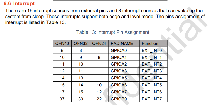

    unsure. I see this
    Interrupt pin assignment table showing PAD names GPIOA0–GPIOB9 and EXT_INT functions
    GPIO description stating 20 ports split into GPIOA and GPIOB, with interrupt mode for Group A

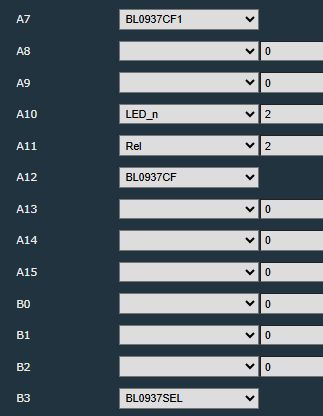

    my assignments:
    Screenshot of port configuration A7–B3 with dropdown selections
    Added after 11 [minutes]:
    are external interrupts a different thing? I don't know enough..

    olivluca
    Posts: 16
    In your configuration both CF and CF1 are in bank A, in this device (according to the json in the first page which I copied here) are in bank B, it's a different device.
      "vendor": "Tuya",
      "bDetailed": "0",
      "name": "ISPTEC Tuya Smart Socket EU16/20A Wifi Smart Plug With Power Monitoring",
      "model": "EU20A",
      "chip": "LN882H",
      "board": "TODO",
      "flags": "1024",
      "keywords": [
        "LN882HKI",
        "BL0937"
      "pins": {
        "6": "LED_n;0",
        "7": "Btn;0",
        "19": "Rel;0",
        "20": "BL0937CF;0",
        "21": "BL0937CF1;0",
        "22": "BL0937SEL;0"
      "command": "",
      "wiki": "https://www.elektroda.com/rtvforum/topic4091325.html"
    Added after 3 [hours] 59 [minutes]:
    It turns out that, in spite of the documentation, even GPIOs of bank B can generate interrupts. I fixed the problem in libretiny with this modification.
    I found the missing calls by looking at the BL0937 driver in OpenBeken, so thank you.

  • Flasher not syncing with LN882H bootloader
    #59 21796414
    GoldMember
    Posts: 26
    Hi,
    I bought recently two smart plugs on LN882H and I can't flash them with OpenBeken. Here is log from Easy Flasher:
    Loaded 805584 bytes from firmwares/OpenLN882H_1.18.233.bin...
    Now is: piątek, 2 stycznia 2026 13:36:27.
    Flasher mode: LN882H
    Going to open port: COM3.
    Port ready!
    Sync with LN882H...
    sending version... waiting for: Mar 14 2021/00:23:32
    Unknown command 'version'sending version... waiting for: Mar 14 2021/00:23:32
    Still no reply - maybe you need to pull BOOT pin down or do full power off/on before next attempt
    What is wrong?
