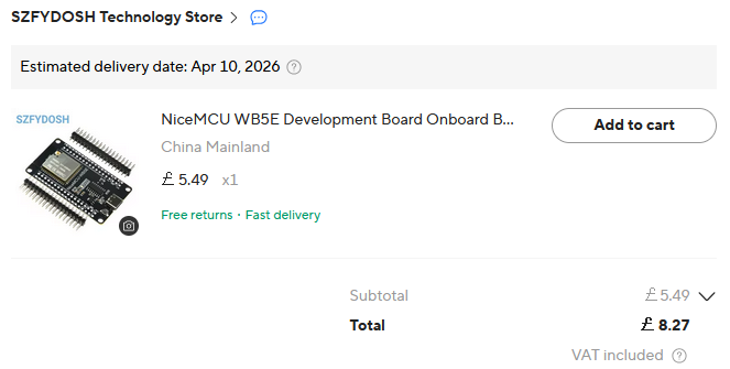

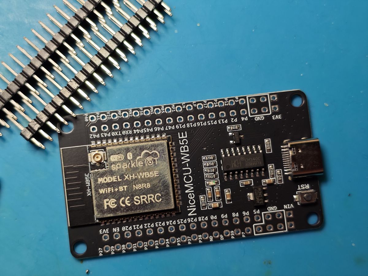

    not exactly ESP8266 bargain basement cheap, but couldn't resist.
    Store checkout screenshot: NiceMCU WB5E board, £5.49, total £8.27, estimated delivery Apr 10, 2026

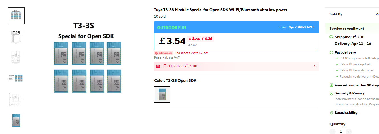

    What is OpenSDK?
  • #367 21877108
    Posts: 14754
    Rate: 12875
    Maybe we should change OBK name to OpenSDK...

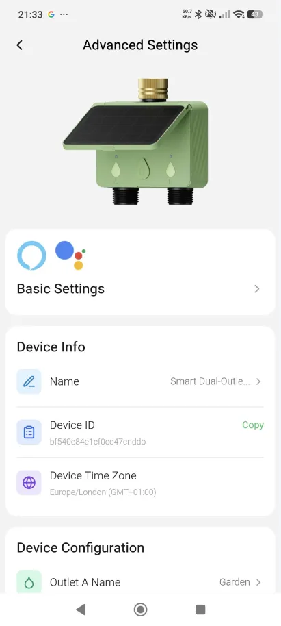

    Interesting, a TuyaMCU?

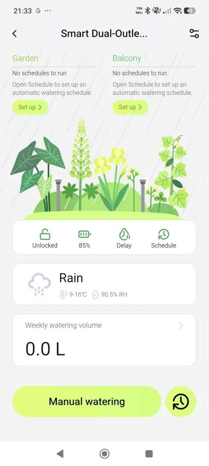

  • BK7258 boots but TuyaMCU comms fail
    #381 21895704
    Posts: 5208
    Help: 446
    Rate: 914

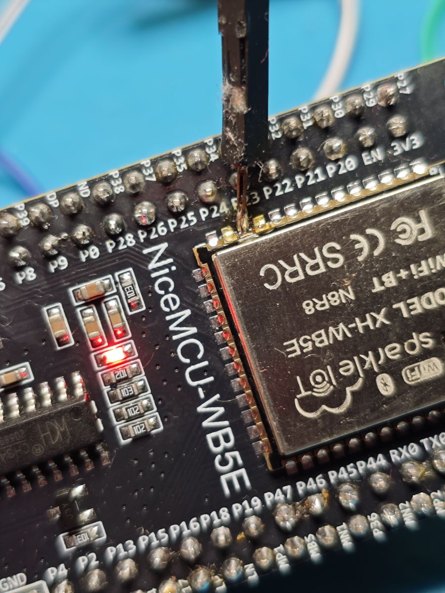

    seems to be, though it's not quite standard. the MCU I think sends product info first instead of heartbeat or something. TMDA won't talk to it. IO34 might need something on it too, low or high hasn't helped bring it to life though.
    it boots on BK7258. boot log without TuyaMCU comms:
  • BK7236 boot query and TuyaMCU simulator reply
    #382 21895833
    Posts: 5208
    Help: 446
    Rate: 914

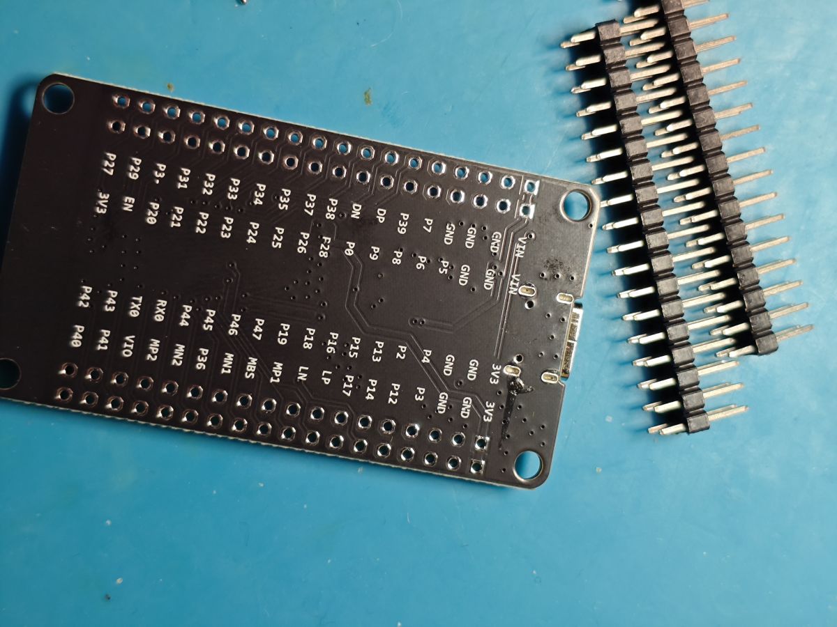

    MCU is on IO0/IO1, 38400 baud.
    XH-WB5E NiceMCU doesn't route IO1 from module to a header, so had to solder
    NiceMCU XH-WB3S BK7238 Flashing, Testing, Pinout, Development, Porting
    NiceMCU XH-WB3S BK7238 Flashing, Testing, Pinout, Development, Porting Phone screenshot of “Advanced Settings” with a green controller icon featuring a solar panel
    Attached is simulator used to communicate and reset dump for pairing.
    At boot the BK7236 asks for product info of the TuyaMCU by sending
    55 AA 00 01 00 00 00
    . Simulator replies with product key for this product.
    • TuyaMCU_BK7236_T3_GUI_Simulator_v1.9.zip (276 Bytes) You must be logged in to download this attachment.
