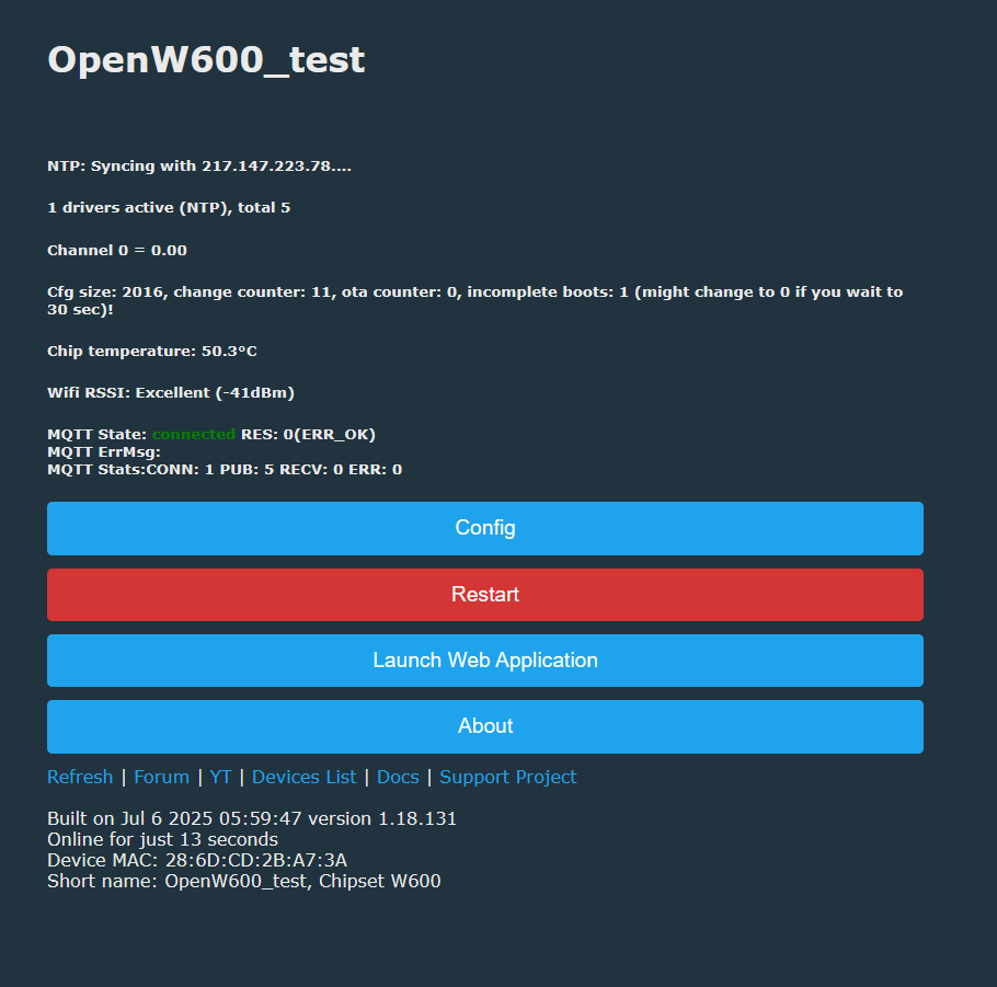

    @divadiow
    I've noticed NTP sync is pending on your device and I've seen it somewhere else doing the same, does it eventually sync or not? If not workaround I found was to add a 5-10 second delay before NTP driver start.
    @p.kaczmarek2 and @insmod
    Just a ping on NTP driver not starting on some devices, sorry not sure which but I'll check.
    It is on W600 with FW 1.18.131 will test after OTA to new version
    RTL8720DN, RTL8710B, RTL8710BX Compatibility with OpenBeken?
    OTA on 1.18.135 done, without delay on startDriver NTP
    Info:NTP:NTP_CheckForReceive: Error while receiving server's msg
    but after about 60 seconds it gets the NTP
    Info:NTP:Seconds since Jan 1 1900 = 3961663620
    Info:NTP:Unix time  : 1752674820
    Info:NTP:Local Time: 2025-07-16 14:07:00

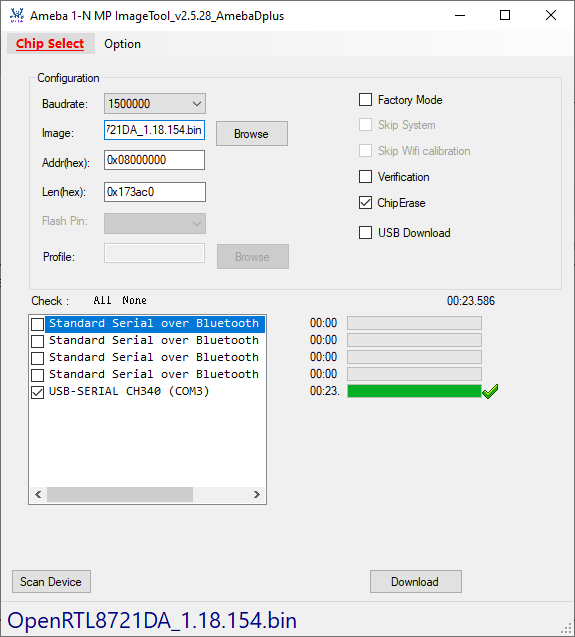

  • #334 21611926
    insmod
    Posts: 1388
    Help: 164
    Rate: 432

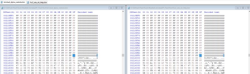

    Opened pull req EF for flasher
    https://github.com/openshwprojects/BK7231GUIFlashTool/pull/59
    Not working. Reading ends up with CRC error. Writing - CRC error on device.
    Main problem is CFG offsets - pinsState_t should be 2 times the size on RTL8720D (64 pins instead of 32).
    Move to unsafe cfg, like i've done earlier in EF demo?
    Added Floaders (AmebaD, AmebaD_New, AmebaDplus, AmebaLite, AmebaZ, AmebaZ2) in base64 format.
    Default AmebaD floader works. New one from ameba-rtos doesn't work. It gets flash id successfully, but doesn't read anything (command api changed?)
  • #335 21612039
    Posts: 14580
    Help: 654
    Rate: 12604
    Nice, but quick question - does it break compatibility?
    I am hoping to find enough time to add LN882H flashing tomorrow or later upcoming week, so I want to have your changes merged, but I don't want them to break existing config of OBK at the moment.
    #336 21612047
    insmod
    Posts: 1388
    Help: 164
    Rate: 432
    [postid:d469f422f4][/postid:d469f422f4]
    It shouldn't. I changed almost nothing in what was already there.
    Only OBKFlashLayout.getConfigLocation started returning sector count as an out variable.
    Everything else was either in RTLFlasher or behind RTL8720DN check.
    I'm not sure if writing config in tandem with firmware would work, since erase is not done for config specifically.
    Different? amebad flashloader sources: https://github.com/particle-iot/realtek_ambd_...ject_lp/asdk/flashloader/rtl_flash_download.c
    Potential newer chips tool? https://github.com/Ameba-AIoT/ameba-rtos/blob..._tools/scripts/flash/base/download_handler.py

    Backup, taken with crudely modified tool and tool itself are attached.
    python3 flash.py -p COM16 -d devices/Profiles/AmebaDplus_FreeRTOS_NOR.rdev -i . -b 1500000 -or bw20.bin
    It can probably be used for RTL8720E, just with a different profile (AmebaLite_FreeRTOS_NOR.rdev)
    • flash.rar (105.52 KB) You must be logged in to download this attachment.
    • bw20.rar (751.21 KB) You must be logged in to download this attachment.

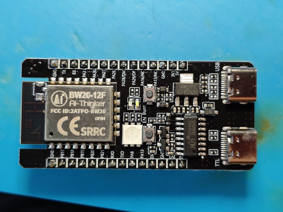

  • #337 21612234
    Posts: 5027
    Help: 438
    Rate: 891

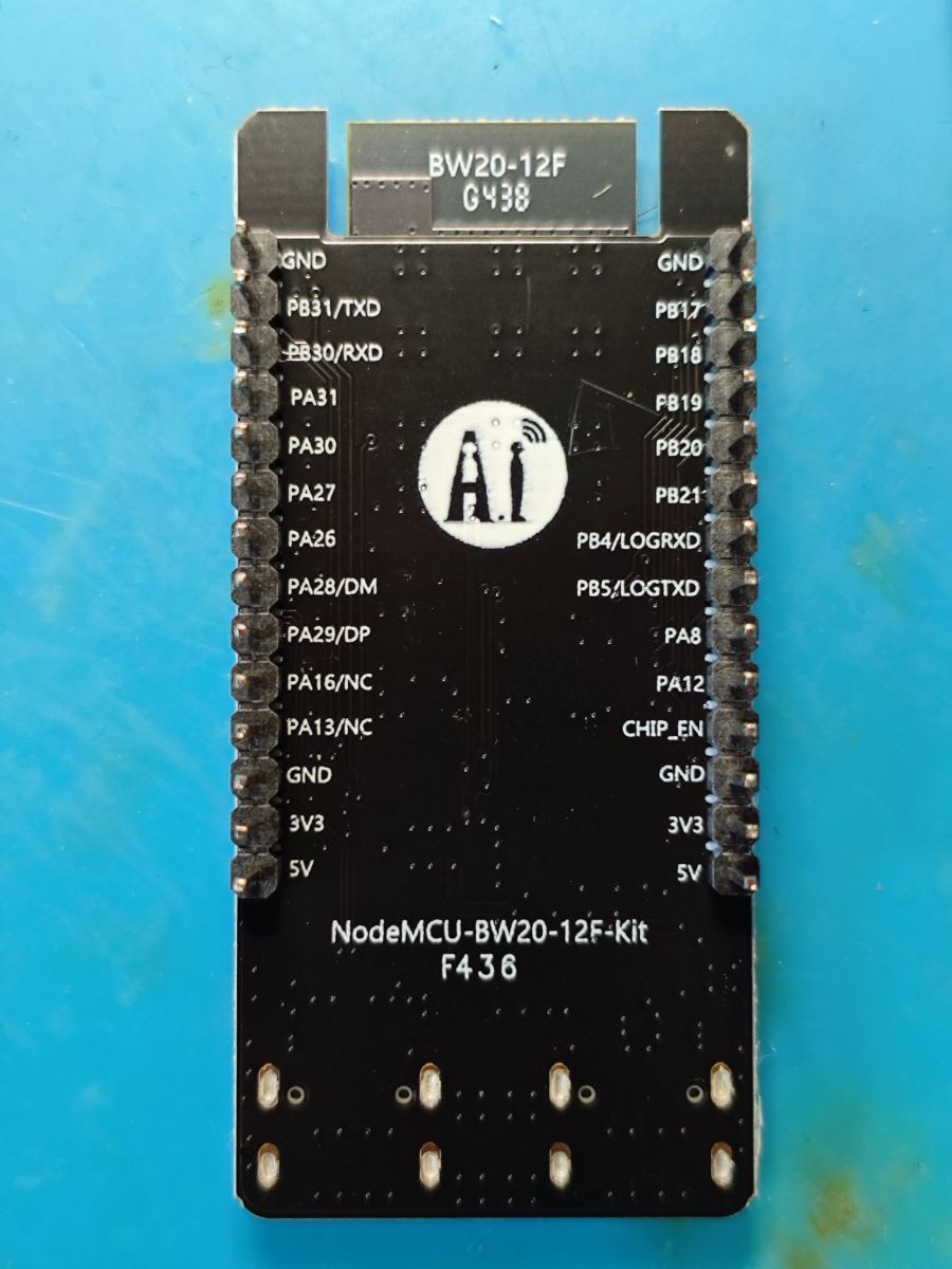

    Cool. Just in time. BW20-12F-Kit should arrive tomorrow
  • #338 21612236
    insmod
    Posts: 1388
    Help: 164
    Rate: 432
    Restoring this backup to OBK flashed BW20-kit worked.

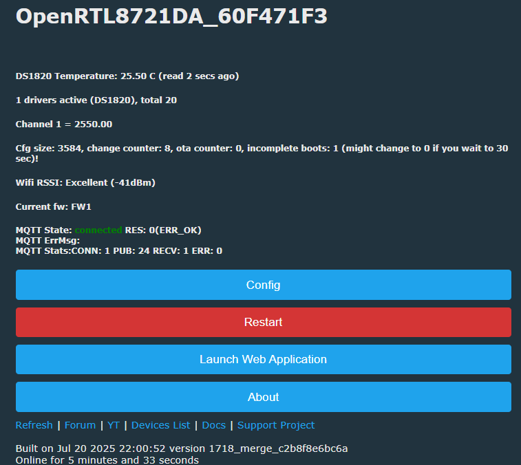

    #339 21612965
    Posts: 5027
    Help: 438
    Rate: 891
    same
    RTL8720DN, RTL8710B, RTL8710BX Compatibility with OpenBeken? RTL8720DN, RTL8710B, RTL8710BX Compatibility with OpenBeken?

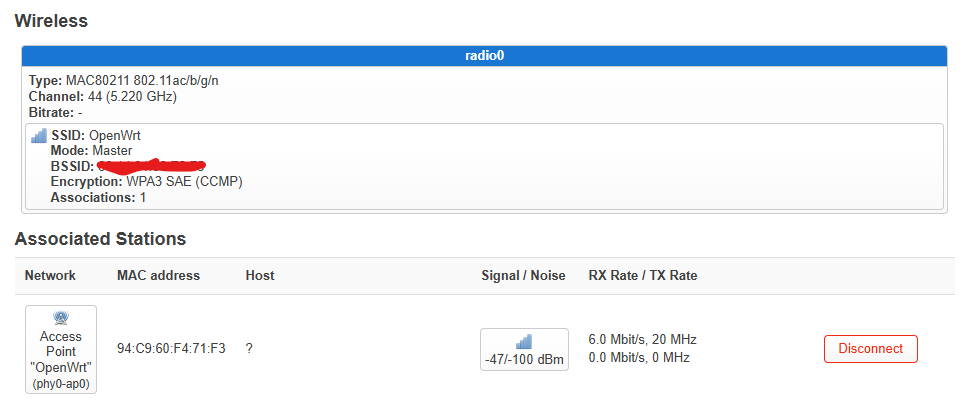

    Added after 11 [hours] 11 [minutes]:
    OBK. Interesting baud @1500000
    Added after 1 [hours] 3 [minutes]:
    seems to have connected and is accessible with 802.11AC WPA3-SAE-only AP
    Added after 4 [minutes]:
    802.11N
    Added after 26 [minutes]:
    maybe platforms.md needs 2.4Ghz/5Ghz column too

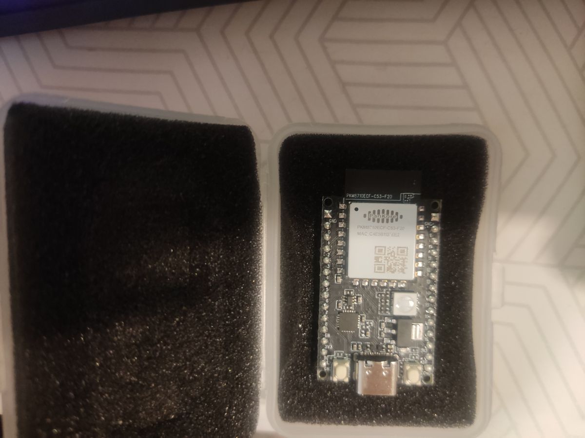

  • #340 21633146
    insmod
    Posts: 1388
    Help: 164
    Rate: 432
    PKM8710ECF
    Realtek chip box with QR codes and feature list on the label PKM8710ECF module in black foam case, visible USB-C port and QR label

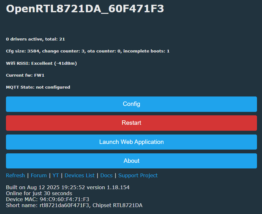

    insmod wrote:
    but on reboot - verification failure
    ah yes
    Ameba tool interface showing firmware upload to USB-SERIAL CH340 (COM3) port
    OpenRTL8721DA network interface showing configuration and system buttons

    insmod wrote:
    Even on RTL8721DA?
    Before last update it worked.
    OK that was a silly test. OTA was PR 1718_merge_c2b8f8e6bc6a to 1.18.154
    REST (red update bar in main GUI - is this REST method? 😳)
    HTTP
    3rd go on WEB APP
    Maybe I wipe and start again. My initial UART to 1.18.154 was with chip erase though. Working for you?

    insmod wrote:
    You can check what is wrong by taking a backup first with flashed via rest, second with http and run binary comparison between them.
    good shout.
    other machine Win/Chrome no diff
    Added after 11 [minutes]:
    Linux/FF no diff. If it's on proper wifi I get checksum error and so no reboot and no brick.
    If on Windows AP I get OTA success and brick on reboot. Not had a problem with either AP type with other devices. Weird. Will do backup of difference on Windows AP after brick and HTTP method success
    Added after 22 [minutes]:
    difference starts here. written 1 byte out?
    Comparison of two binary files in hex editor showing byte difference at 00215FF0
