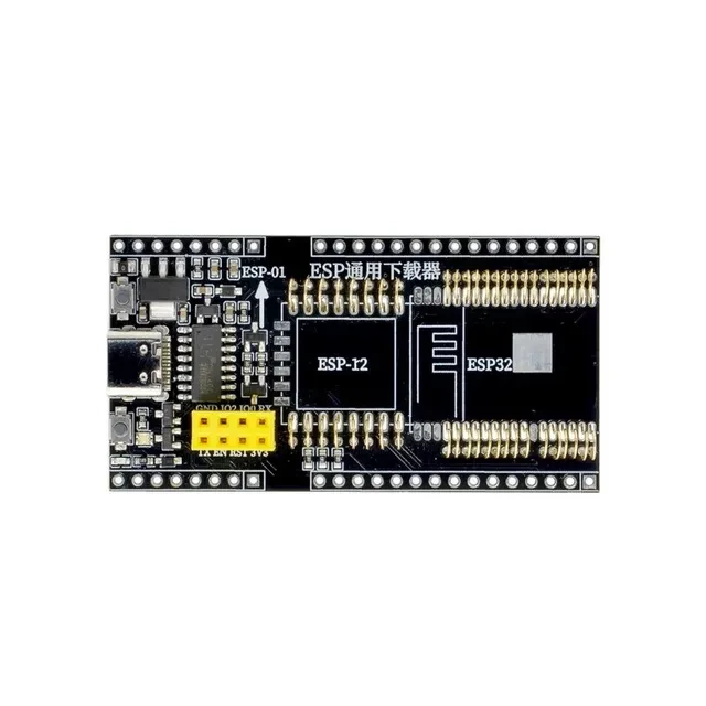

    >>21360762 WBR3 is a no (or if you preflash it, and then rely only on ota).
    But if you have a BW15, then, since its log uart pins are easily accessible, just connect log_tx and tx, log_rx and rx and it should work.
    I use this board for all esp-12 sized modules, and it worked ok for a bw15.
    RTL8720DN, RTL8710B, RTL8710BX Compatibility with OpenBeken?
    Though it only booted if the com port was opened (some pull-up thing?).

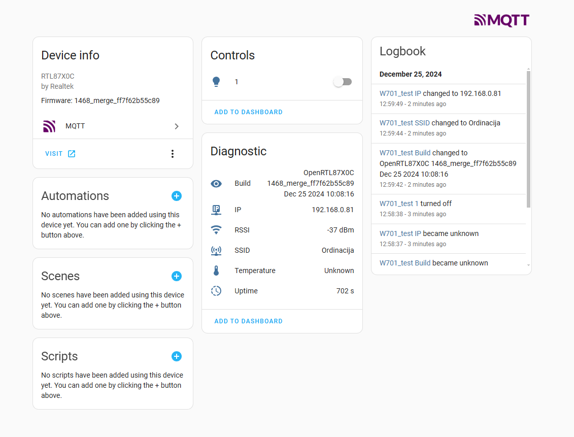

    @insmod
    MQTT is not working on WBR3
    Info:MQTT:mqtt_connection_cb: Disconnected, reason: 5(Refused not authorized)

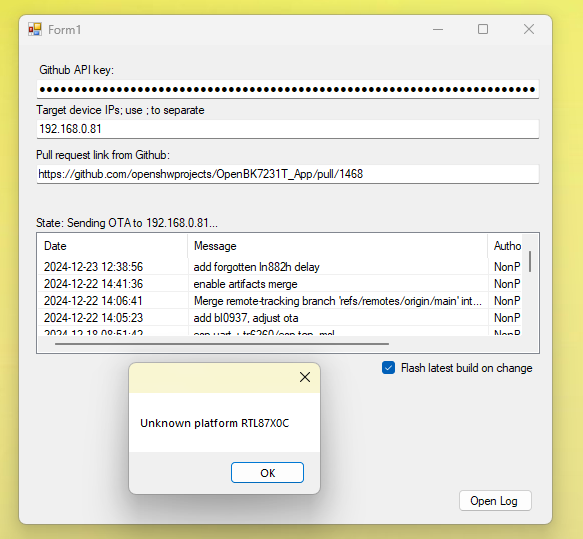

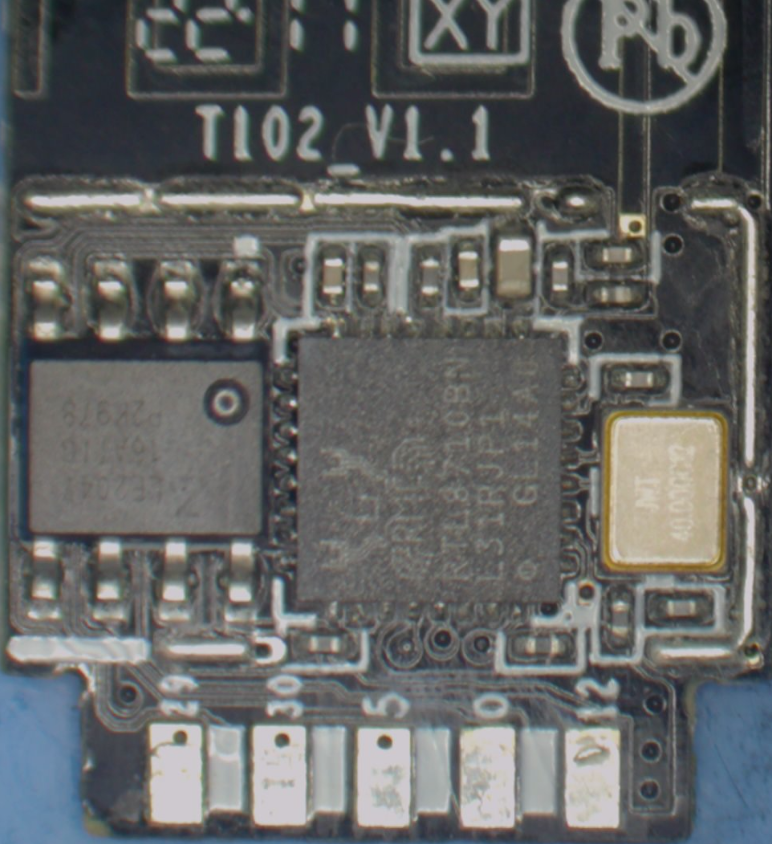

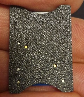

    @p.kaczmarek2
    PROTA tool is not recognizing RTL platforms.
    Error message in a program window showing Unknown platform RTL87X0C.
    Next module in line for testing...
    Close-up of an electronic module labeled T102 V1.1 with various components.
  • #63 21361003
    Posts: 14599
    Help: 654
    Rate: 12614
    Prota has Platforms list here, where RTL was not yet added:
    https://github.com/openshwprojects/OBKotaTool/blob/main/PROTATool/Platforms.cs
  • #65 21361267
    insmod
    Posts: 1390
    Help: 164
    Rate: 433

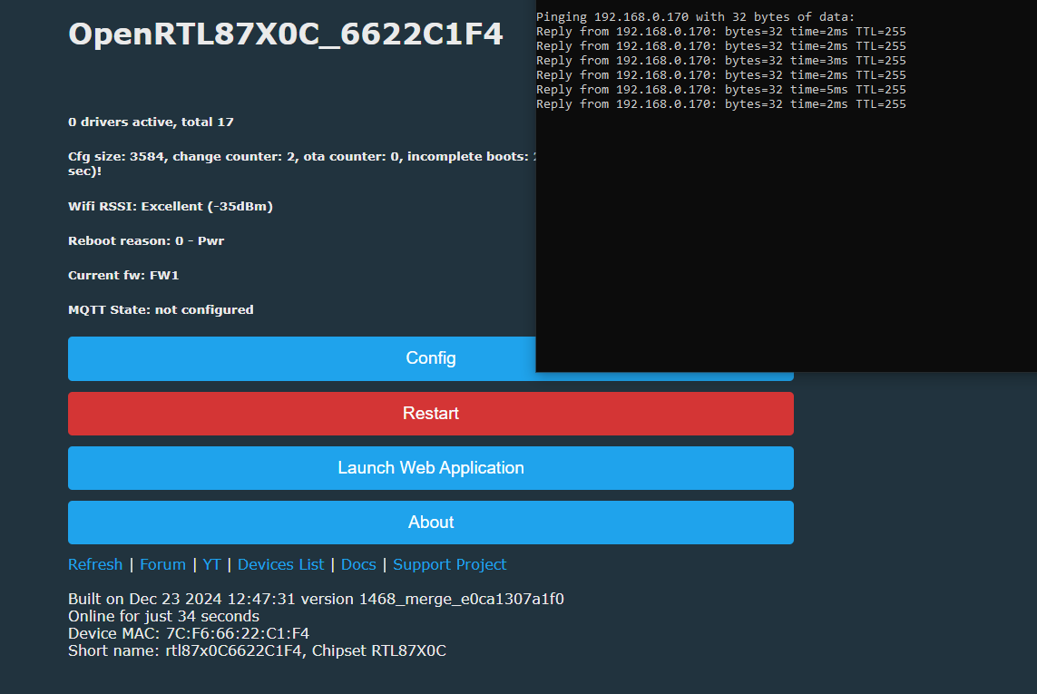

    >>21361242 AmebaZ is RTL B, any RTL A is Ameba1. I have a t102 BX module, as well as wrg1 (RTL8711AM) from a zigbee bridge. But afaik, Ameba1 cannot be flashed via uart, only swd.

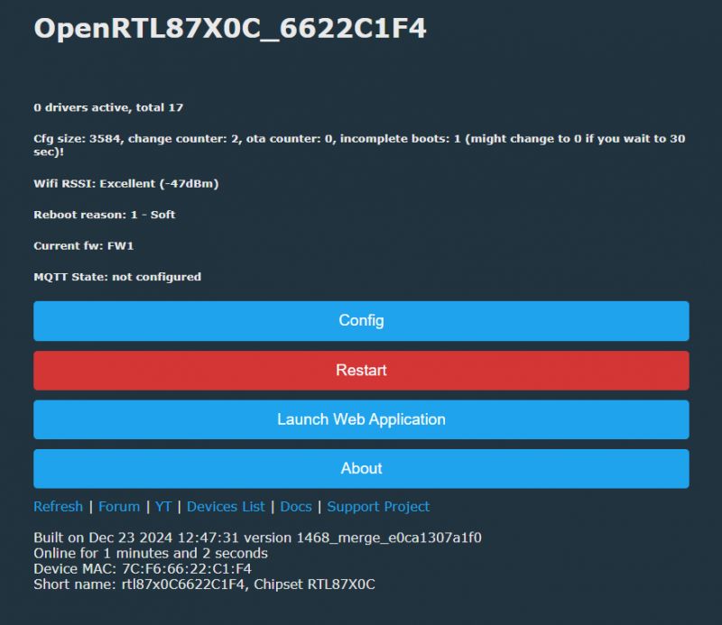

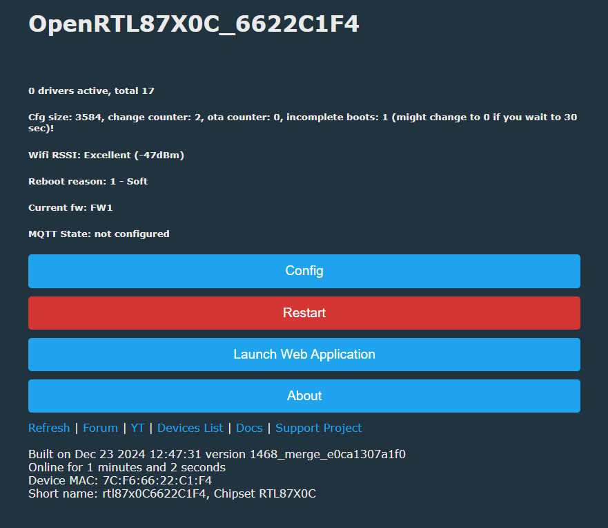

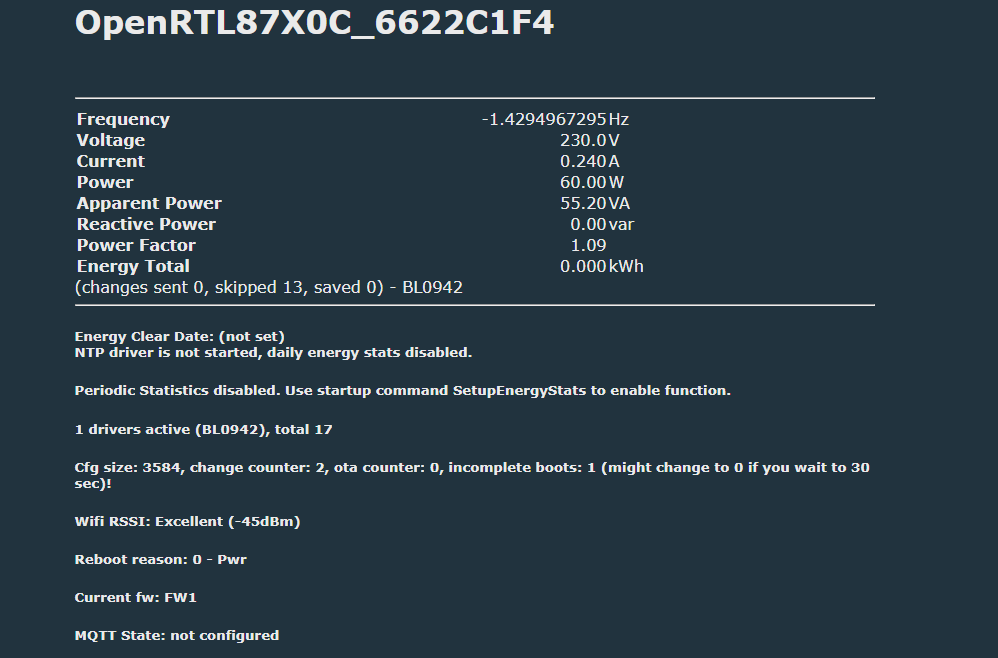

  • #67 21361443
    Posts: 14599
    Help: 654
    Rate: 12614
    Great job @insmod !!!
    OpenRTL87X0C user interface with device information and function buttons.
    What's left before merge? Check if DHT11 works on... BL602 and W600/W800?

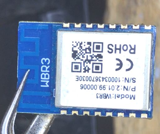

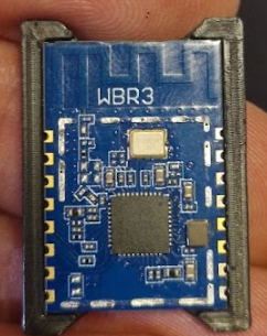

    WBR3 electronic module held by metal tweezers.

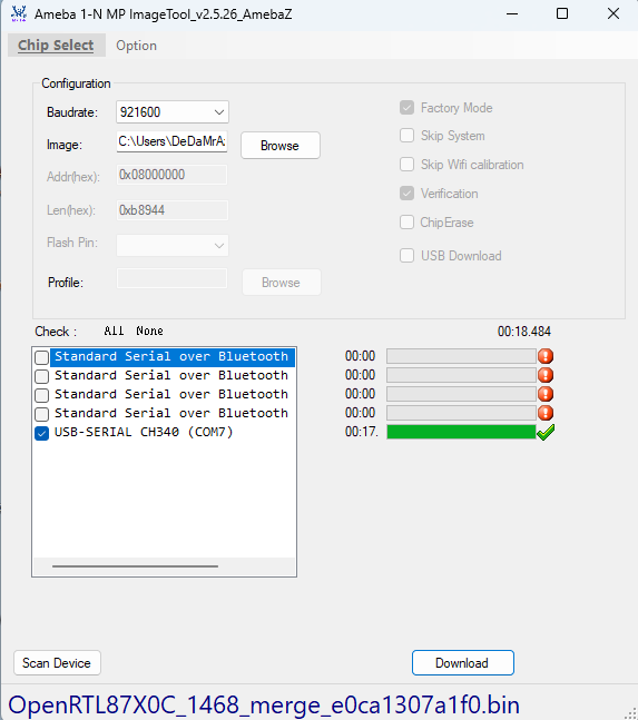

    DeDaMrAz wrote:
    We got the option how to flash AmebaZ device (RTL8710BN or RTL8195A) also pinout and flashing procedure is clear so we "only" need an image for it :)
    RTL8710BN worked with https://github.com/openshwprojects/OpenRTL8710BN but was not stable and I lost the module and was not able to continue.
    @insmod what do you think about it? It's somewhat old SDK so maybe it's worth to take newer?

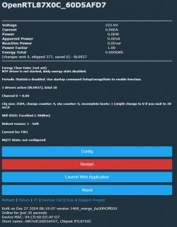

    I played around with PWM on A12 and it is not perfect but it's working, waveform is stable but first approximately 20% of the slider is zero, but my A12 was set to PWM and I rebooted the module, this is the logport output:
    Info:MAIN:Time 43, idle 0/s, free 91832, MQTT 0(2), bWifi 1, secondsWithNoPing -1, socks 2/21
    Info:MAIN:Time 44, idle 0/s, free 92000, MQTT 0(2), bWifi 1, secondsWithNoPing -1, socks 2/21
    Info:MAIN:Time 45, idle 0/s, free 92168, MQTT 0(2), bWifi 1, secondsWithNoPing -1, socks 2/21
    Info:MAIN:Time 46, idle 0/s, free 91832, MQTT 0(2), bWifi 1, secondsWithNoPing -1, socks 2/21
    Info:MAIN:Module reboot in 2...
    Info:MAIN:Time 47, idle 0/s, free 91832, MQTT 0(3), bWifi 1, secondsWithNoPing -1, socks 2/21

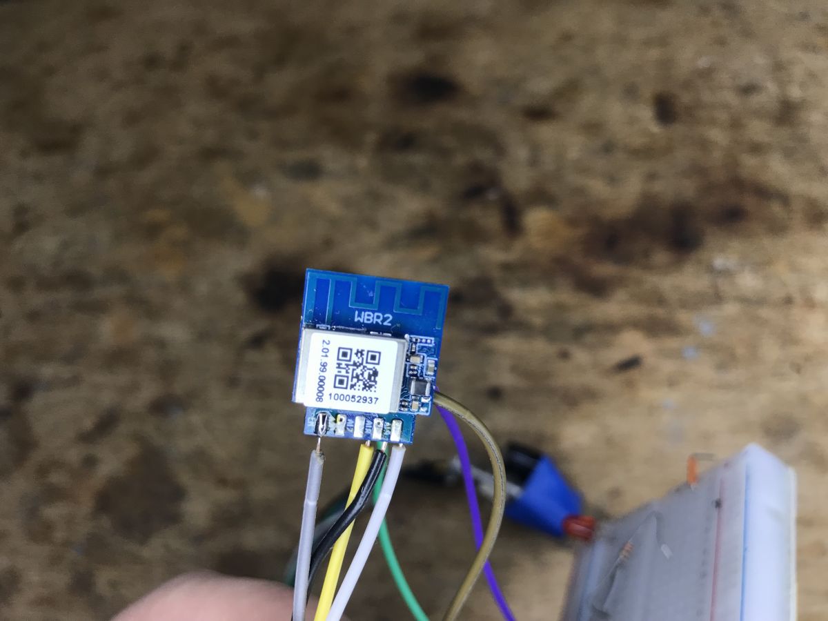

    WBR2 log:
    == Rtl8710c IoT Platform ==
    Chip VID: 5, Ver: 3
    ROM Version: v3.0
    Test Mode: boot_cfg1=0x20
    Download Image over UART2[tx=16,rx=15] baud=115200

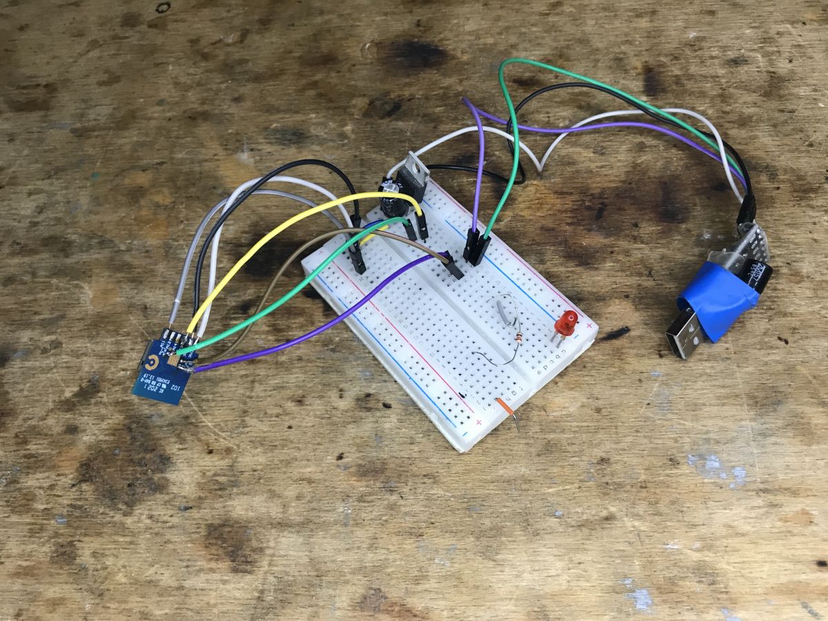

    Works on WBR2 as well:
    WBR2 electronic module connected to wires. Breadboard with connected wires and modules on a wooden background.
    I need to make some testing setup...

    insmod wrote:
    Fixed pwm
    Realtek for some reason cut mqtt authorization out from lwip. Why? I don't know. Fixed that too.
    Screenshot of MQTT interface showing device info, controls, diagnostics, and logbook.
    PWM + reboot is fixed, confirmed, I'll test more during the day. I need to flash another module and place in into the dev board for ease of access.

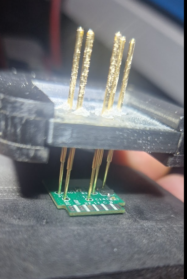

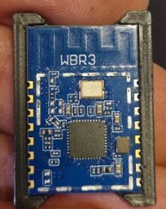

    Adapter module for WBR3 module if anybody needs that (apart from me) stl and SketchUp file attached.
    Close-up of a WBR3 module encased in a black frame.
    Close-up of the textured surface of a WBR3 module adapter held in a hand.
    • WBR3 needle bed.rar (213.38 KB) You must be logged in to download this attachment.

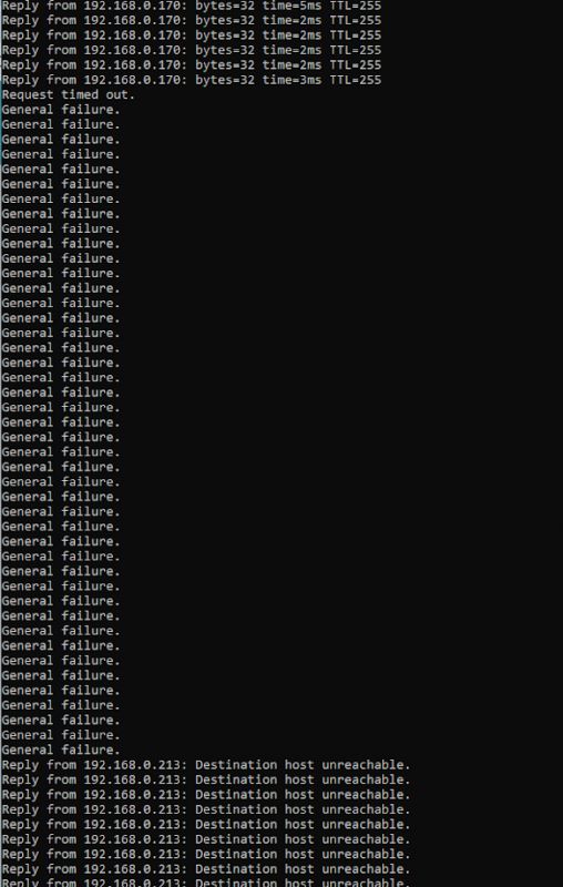

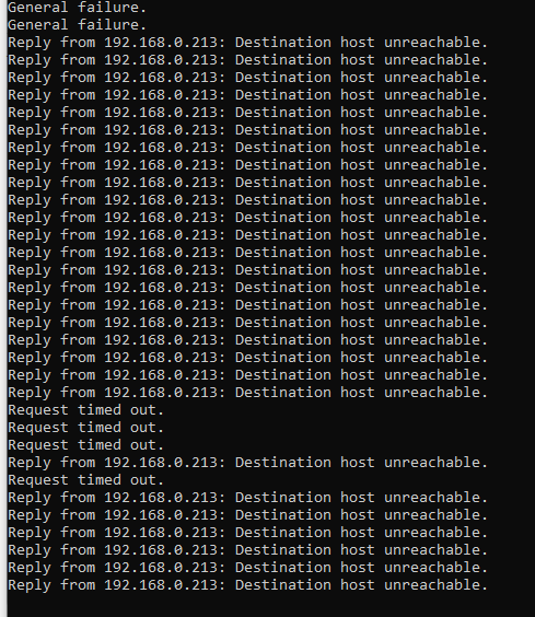

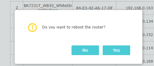

    Are RTLs joining back after router restart?
    Screenshot of OpenRTL device interface with configuration menu and ping response. Pop-up window asking to reboot the router. Screen showing ping command results with connection failures and network errors. Screen showing network error messages like General failure and Destination host unreachable.
    It didn't join after router reboot, and I'm waiting like 5 minutes already.

    Same problem as above, looks like the module is not disconnecting at all, I'll post a log in a minute.
    Info:MAIN:Time 143, idle 0/s, free 93224, MQTT 0(9), bWifi 1, secondsWithNoPing 1, socks 2/21
    Info:MAIN:Time 144, idle 0/s, free 93392, MQTT 0(9), bWifi 1, secondsWithNoPing 1, socks 2/21
    Info:MAIN:Time 145, idle 0/s, free 93392, MQTT 0(9), bWifi 1, secondsWithNoPing 1, socks 2/21
    Info:MAIN:Time 146, idle 0/s, free 93392, MQTT 0(9), bWifi 1, secondsWithNoPing 1, socks 2/21
    Info:MAIN:Time 147, idle 0/s, free 93392, MQTT 0(9), bWifi 1, secondsWithNoPing 1, socks 2/21
    [Driver]: sta recv deauth reason code(3) sta:70:3a:cb:78:88:e0
    HAL_DisconnectFromWifiInfo:MAIN:Time 148, idle 0/s, free 97560, MQTT 0(9), bWifi 1, secondsWithNoPing 2, socks 2/21
    Info:MAIN:Time 149, idle 0/s, free 97832, MQTT 0(9), bWifi 1, secondsWithNoPing 3, socks 2/21
    Info:MAIN:Time 150, idle 0/s, free 97960, MQTT 0(9), bWifi 1, secondsWithNoPing 4, socks 2/21
    Info:MAIN:Time 151, idle 0/s, free 97960, MQTT 0(9), bWifi 1, secondsWithNoPing 5, socks 2/21
    Info:MAIN:Time 152, idle 0/s, free 97896, MQTT 0(9), bWifi 1, secondsWithNoPing 6, socks 2/21
    and when WiFi get back online
    Info:MAIN:Time 202, idle 0/s, free 96296, MQTT 0(12), bWifi 1, secondsWithNoPing 56, socks 2/21
    Info:MAIN:Time 203, idle 0/s, free 96296, MQTT 0(12), bWifi 1, secondsWithNoPing 57, socks 2/21
    Info:MAIN:Time 204, idle 0/s, free 96232, MQTT 0(12), bWifi 1, secondsWithNoPing 58, socks 2/21
    Info:MAIN:Time 205, idle 0/s, free 96232, MQTT 0(12), bWifi 1, secondsWithNoPing 59, socks 2/21
    Info:MAIN:Time 206, idle 0/s, free 96168, MQTT 0(12), bWifi 1, secondsWithNoPing 60, socks 2/21
    Info:MAIN:Time 207, idle 0/s, free 96168, MQTT 0(13), bWifi 1, secondsWithNoPing 61, socks 2/21
    [cmd_threa] _freertos_spinlock(->1001684c) failed, retry
    Info:MAIN:Time 208, idle 0/s, free 96104, MQTT 0(13), bWifi 1, secondsWithNoPing 62, socks 2/21
    Info:MAIN:Time 209, idle 0/s, free 96104, MQTT 0(13), bWifi 1, secondsWithNoPing 63, socks 2/21
    Info:MAIN:Time 210, idle 0/s, free 96040, MQTT 0(13), bWifi 1, secondsWithNoPing 64, socks 2/21
    Info:MAIN:Time 211, idle 0/s, free 96040, MQTT 0(13), bWifi 1, secondsWithNoPing 65, socks 2/21

    UART receive works on:
    Built on Dec 23 2024 12:47:31 version 1468_merge_e0ca1307a1f0
    Online for 5 minutes and 31 seconds
    Device MAC: 7C:F6:66:22:C1:F4
    Short name: rtl87x0C6622C1F4, Chipset RTL87X0C
    Screenshot of OpenRTL87X0_6622C1F4 web interface showing energy data.

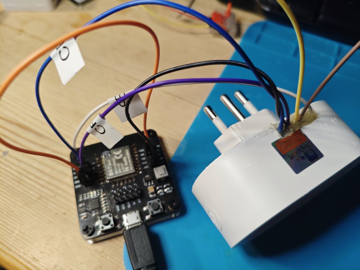

    Test code on PC:
    Code: text
    Yellow wire is PC TX to Realtek RX:
    Electronic module with soldered wires on a wooden table.

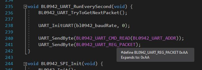

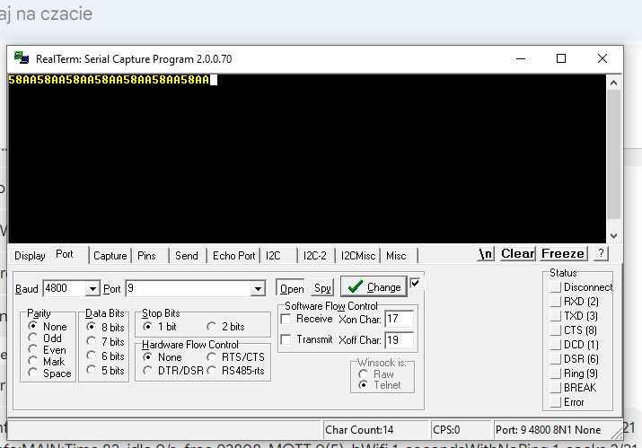

    Realtek sending to PC also works:
    Screenshot of RealTerm serial communication program.
    That 58AA is sent by BL0942 driver, as implemented here:
    Screenshot showing a code snippet in programming language related to UART for the BL0942 driver.
    @DeDaMrAz HAL_DisconnectFromWifiInfo didn't set WiFi to 0 ?

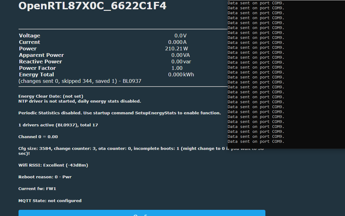

    I also did very hacky BL0937 test just to see if interrupt on change is working - I've set CF/CF1 role to pin and spammed it with UART packets. I know it's not UART, but just to make some changes... and it reacts:
    Screenshot of OpenRTL87X0C system test displaying measurement data and system status.
    so the gpio interrupt must be firing, at least more or less correctly.

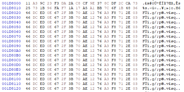

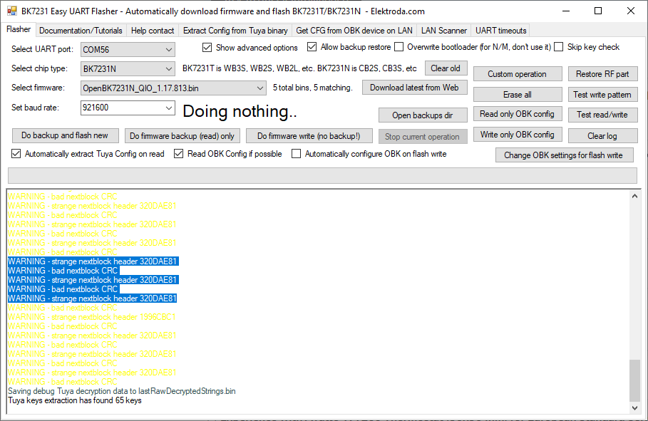

    just playing with that WBR3 dump
    I see the Tuya config is available from 1D8000
    Screenshot of a hex data snippet.

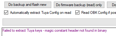

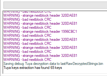

    and when extracted and run through EF you get the keys. Annoyingly I did that before running the whole file through which has the same result 🙄.
    With the link to BK7231T being because the module starts with a W https://github.com/openshwprojects/BK7231GUIF...2e661a58ddb0/BK7231Flasher/TuyaModules.cs#L20
    Screenshot of BK7231 Easy UART Flasher software displaying warnings at the bottom.
    on another note, may I propose this colour change
    Screenshot with an error message in the Tuya configuration extraction tool. Screenshot showing warning messages related to Tuya data decryption.
    https://github.com/openshwprojects/BK7231GUIFlashTool/pull/46

    >>21364096
    I got this from a T102_v1.1 backup (bl0937 plug)
       "Kp":"13298",
       "Kv":"571",
       "Ki":"24333",
       "Ke":"1560"
    Tuya config extractor - magic is at 2011136
    Saving debug Tuya decryption data to lastRawDecryptedStrings.bin
    Tuya keys extraction has found 4 keys
    And this from T3-3S
    Tuya config extractor - magic is at 3997696
    WARNING - strange nextblock header 9BB094AC
    WARNING - bad nextblock CRC
    WARNING - strange nextblock header 9E88251C
    WARNING - strange nextblock header 60276DA0
    WARNING - strange nextblock header 703DA9F9
    Failed to extract Tuya keys - no json start found

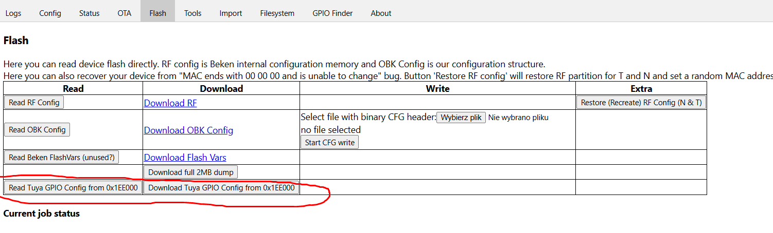

    #88 21364160
    Posts: 14599
    Help: 654
    Rate: 12614

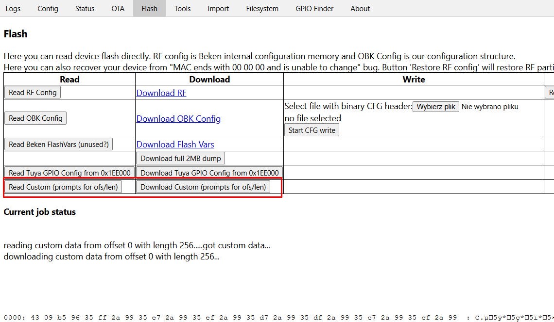

    If they have the same storage block, then we can also add the extraction to the Web App:
    Screenshot of a web application page for managing device memory, showing the Flash section with a table of options for reading, downloading, and writing configurations.
    https://github.com/OpenBekenIOT/webapp/blob/gh-pages/vue/flash.vue
    probably add conditional to change offset here:
    Code: Javascript
    use info from here:
    Code: Javascript

    another BL0937 but 'real' - as real as my dodgy module-less smart plug can be
    User interface screen of a device monitoring power data.
    Electronic board with wires connected to a smart plug

    I'm looking into adding download for it. For now, I've added custom download to the web App:
    Screenshot of a web application for managing device flash configuration.
