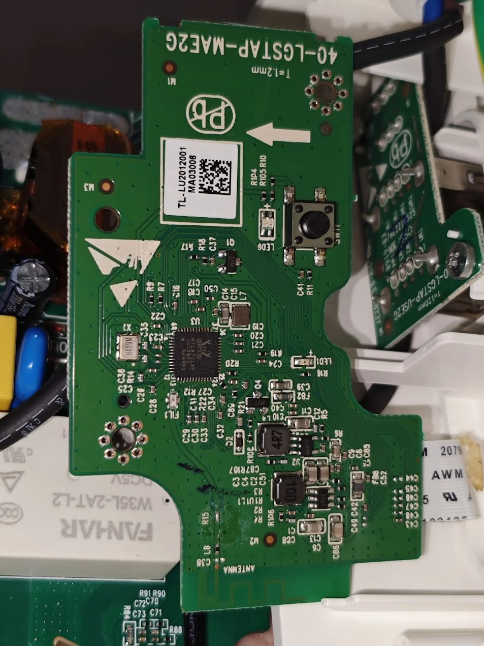

    interesting. RTL8711AF device in the wild https://www.reddit.com/r/indotech/comments/1k...ung_multi_tap_lg_mttlw01_teardown_discussion/
    PCB with RTL8711AF chip, push button, and various electronic components
    Added after 1 [hours] 17 [minutes]:
    ah AF ≠ AM
    We don't support AF

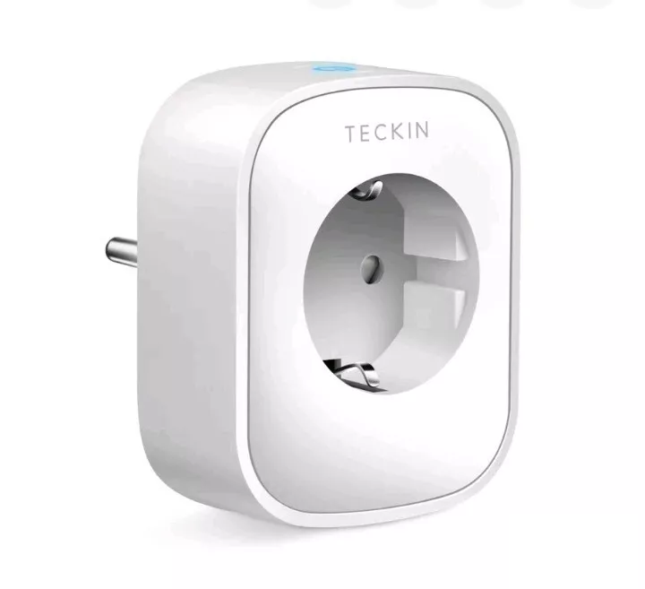

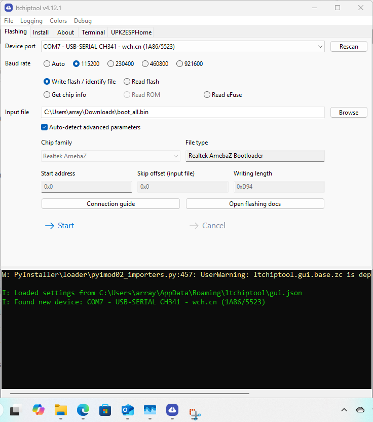

  • #363 21648741
    array81
    Posts: 20

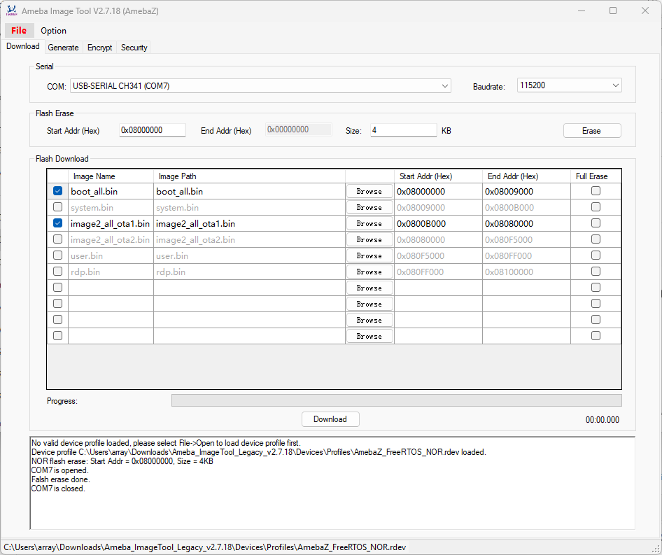

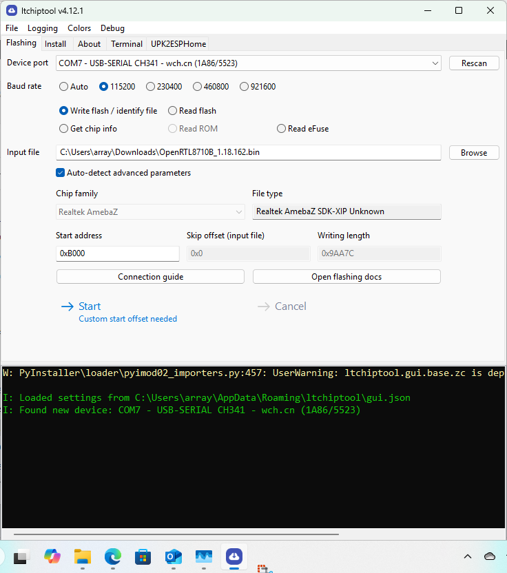

    Has anyone tried using OpenBeken on Teckin SP22 sockets (RTL8710BN - T112_V1.1)? Is there a configuration file?
    Added after 1 [hours] 31 [minutes]:
    I used ltchiptool to flash OpenRTL8710B_1.18.162.bin but no wifi is generated. Any idea?
  • #364 21648828
    insmod
    Posts: 1388
    Help: 164
    Rate: 432
    >>21648741
    Disable autodetect parameters and set starting address to 0x0

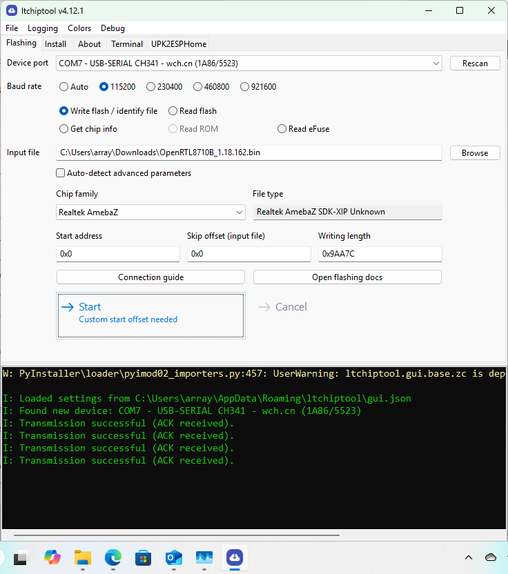

  • #365 21648847
    array81
    Posts: 20
    >>21648828
    Starting address is 0x0, see the image:
    Screenshot of ltchiptool v4.12.1 with the start address set to 0x0 for a Realtek AmebaZ device.
  • #366 21648859
    insmod
    Posts: 1388
    Help: 164
    Rate: 432
    >>21648847
    Tried it myself, got "Please Re-boot and try again, or re-burn the flash image" in uart.
    Added after 12 [minutes]:
    Flash attached file to 0x0
    Then flash OpenBeken at 0xB000
    • boot_all.bin (4.56 KB) You must be logged in to download this attachment.
  • #367 21648875
    Posts: 5027
    Help: 438
    Rate: 891
    I don't believe there was ever an AmebaZ-specific guide made was there? I recall making instructions to help someone recover to factory then to move to OpenRTL. https://www.elektroda.com/rtvforum/topic4093142-180.html#21433931
    This option too now of course https://github.com/openshwprojects/FlashTools/tree/main/Realtek/AmebaZ_FlashTool
  • #368 21648937
    array81
    Posts: 20
    >>21648859
    I tried. I first flashed the file you attached, then the OpenBK one, changing the starting address. I'm attaching images of the two settings. Nothing seems to change. Also, the LED on the RTL8710BN doesn't flash when I power the socket. I had previously installed ESPHome (with LibreTiny), and it worked, but it had reboots due to a known bug (the latest versions of ESPHome have problems with LibreTiny), so I was hoping to use OpenBK (which I already use on other devices).
    Window of litchiptool v4.12.1 showing flash settings for Realtek AmebaZ chip using COM7 USB-SERIAL CH341 interface.
    Screenshot of ltchiptool showing flash settings for Realtek RTL8710BN microcontroller.
    Added after 15 [minutes]:
    >>21648875
    I tried resetting the device and then flashing OpenBK but nothing changed:
    Screenshot of Ameba Image Tool V2.7.18 with three selected binary files and HEX addresses set for flashing via COM7.
    Added after 2 [hours] 7 [minutes]:
    I managed to do it by following divadiow's instructions step by step.
    Now the problem is that I can't find the PINs. So far, I've only found the red and blue LEDs. I can't find the button, the relay, or the energy meter module.
    Added after 42 [minutes]:
    Is there a simple way to detect BL0937 pins?

  • #370 21654509
    array81
    Posts: 20
    >>21649483
    Thanks.
    These are the correct PINs for the Teckin SP22 with T112 v1.1
    "0": "BL0937CF;63",
    "1": "LED_n;53",
    "8": "BL0937CF1;55",
    "9": "BL0937SEL;54",
    "10": "Rel;53",
    "11": "LED_n;52",
    "14": "Btn;53"
    Now I have another problem with a socket of the same model. I don't have a backup for this socket (I forgot to do so). I tried loading the backup of the other socket, then OpenBK, then deleting 4k from 0x080D0000. However, the socket keeps going into a boot loop. Any suggestions?
    Can I backup the socket I got working with ltchiptool and then use ltchiptool to load the file on the new socket? (Same make and model)

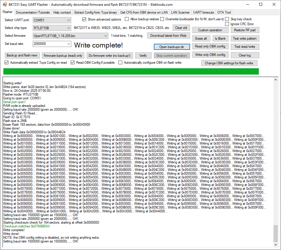

  • #375 21729605
    Posts: 5027
    Help: 438
    Rate: 891

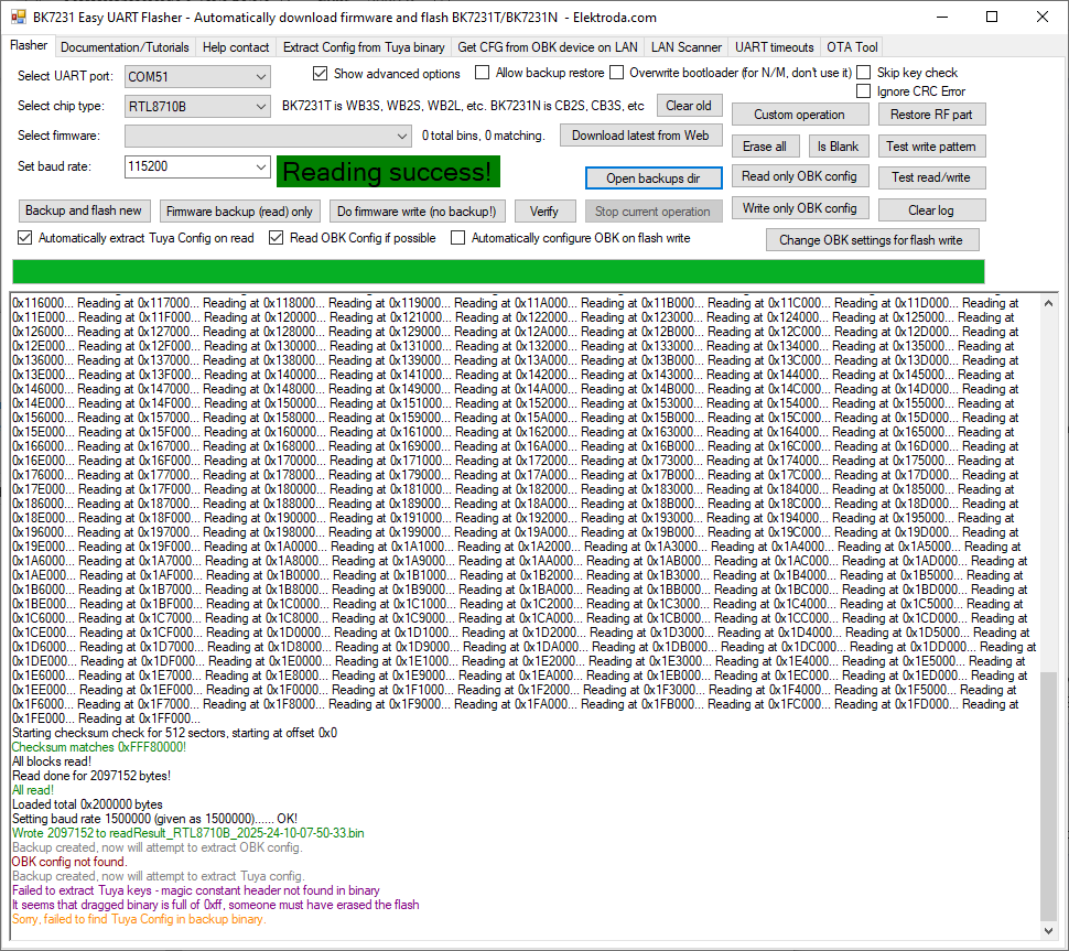

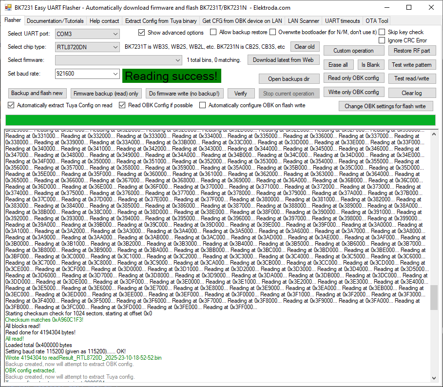

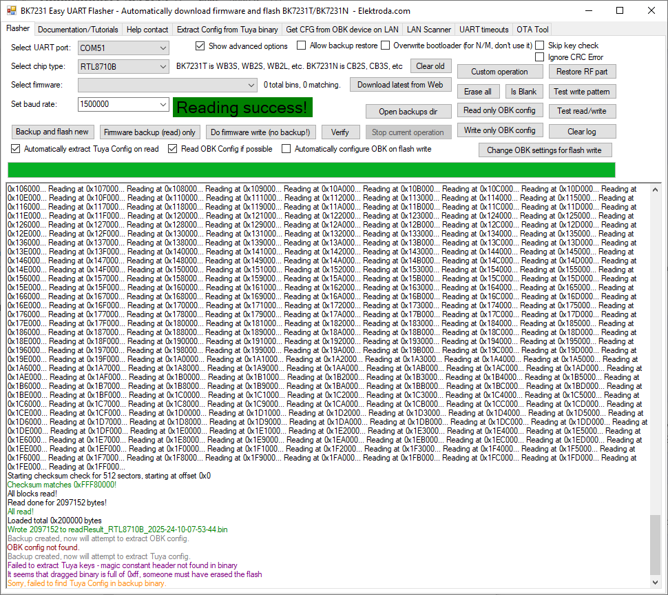

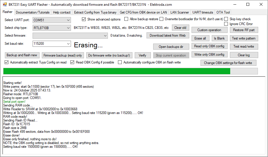

    very nice. playing with DN.
    BK7231 Easy UART Flasher interface with “Reading success!” message displayed BK7231 Easy UART Flasher UI showing flash log and warning/error messages Easy UART Flasher interface with “Write complete!” message in main window
    whole-flash 4mb restore worked too. obk flashed booted
    #376 21729963

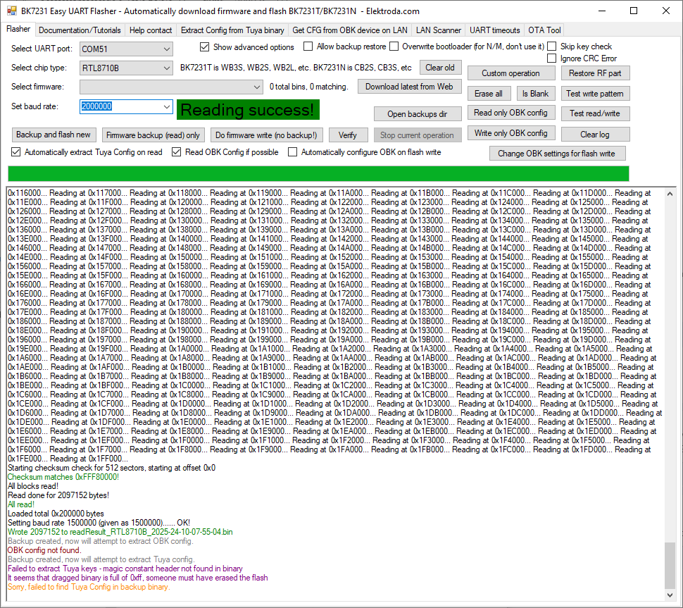

    Posts: 5027
    Help: 438
    Rate: 891

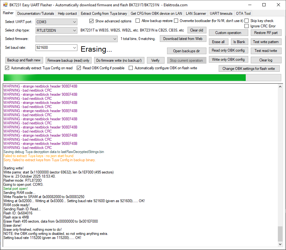

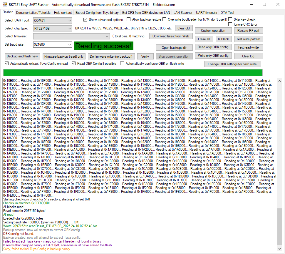

    Z1 erase completes but GUI sits like it's in progress. stops after baud change
    BK7231 Easy UART Flasher interface during flash memory erase operation
    Z1 erase succeeds and subsequent 115200 read shows blank flash
    BK7231 Easy UART Flasher UI with “Reading success!” and memory dump log visible.
    921600 read success
    BK7231 Easy UART Flasher interface showing Reading success! message
    1500000 read success
    BK7231 Easy UART Flasher interface with Reading success! message displayed
    2000000 read success (though I'm guessing it's topping out somewhere close to 1mb baud - should time each probably)
    Screenshot of BK7231 Easy UART Flasher showing “Reading success!” message

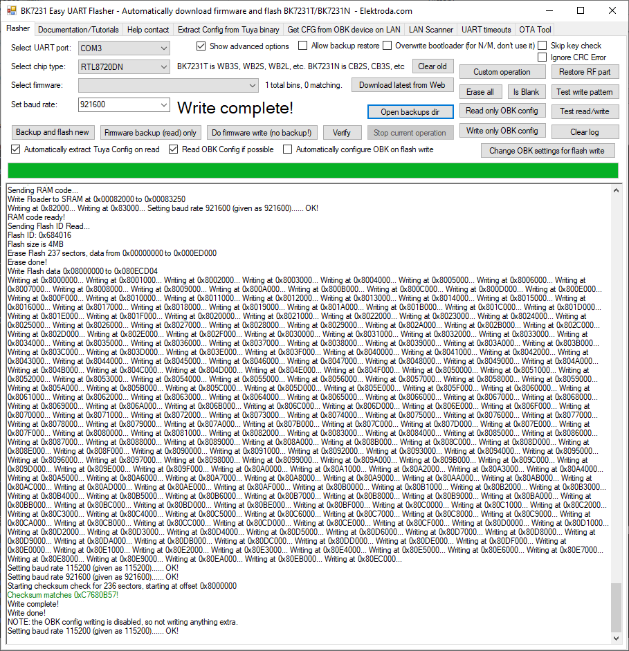

    2000000 OBK write success to blank
    Screenshot of BK7231 Easy UART Flasher showing “Write complete!” message
    OBK boots :)
  • #377 21782369

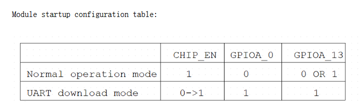

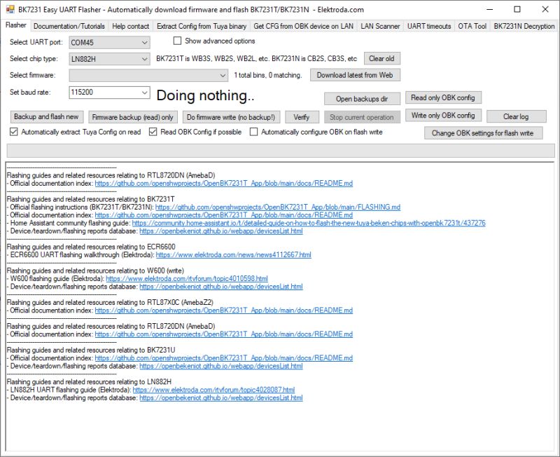

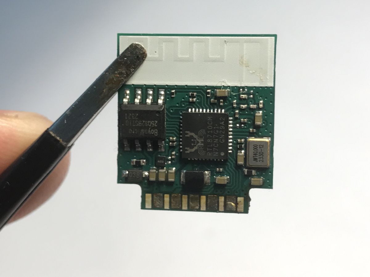

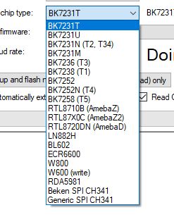

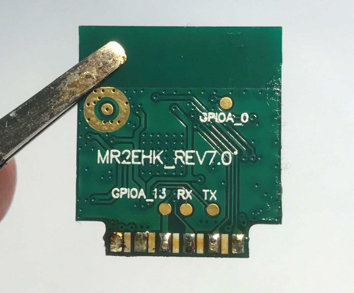

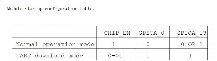

    We need to add info here which is which Ameba:
    Dropdown list with chip names, RTL87X0C option highlighted
    I am getting lost myself there, I've got this to flash:
    Electronic module with chip and antenna held by tweezers
    Green PCB with MR2EHK_REV7.0 label and gold contacts at the bottom edge
    Module startup configuration table with modes and GPIO settings
  • #379 21783235
    Posts: 5027
    Help: 438
    Rate: 891
    Yes. I do need to lookup RTLs sometimes to be sure.
    What does more info look like though, EF is kinda small and crowded. A tab where anyone can type in part or complete models of any chip markings and a match is made in real-time below? lol, dunno. dunno
  • #380 21783244

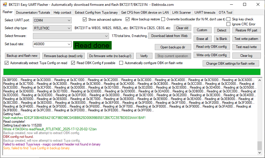

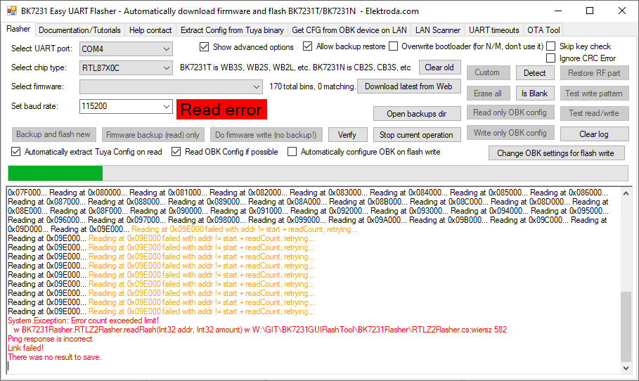

    Posts: 14580
    Help: 654
    Rate: 12604
    Just like we have (T4) next to BK name, then add (Ameba Z2) ?
    Added after 3 [minutes]:

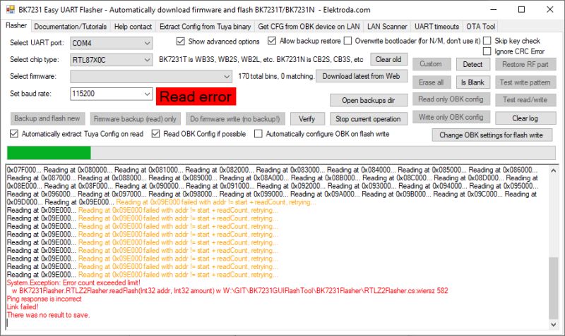

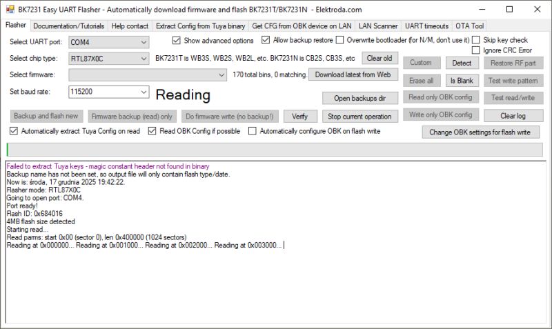

    == Rtl8710c IoT Platform ==
    Chip VID: 5, Ver: 3
    ROM Version: v3.0
    == Boot Loader ==
    Aug 31 2021:15:42:24
    Boot Loader <==
    == RAM Start ==
    Build @ 14:51:40, Jan  5 2024
    $8710c>interface 0 is initialized
    interface 1 is initialized
    Initializing WIFI ...
    WIFI initialized
    MRS-WIFI-COUNTR-0069 | set country code: JP, 0x0b
     write mac address success, please reset wifi driver!
    init_thread(61), Available heap 0x356308
    ####  Meross Smart Things  ####
    reset reason : 0
           model : mss810
    Enter INTERACTIVE MODE
    #          mac : 48:e1:e9:d8:d0:ce
        chip set : rtl8710cm
          hw_ver : 7.0.0
          fw_ver : 7.3.3
        compiler : gcc 6.5.0
    compile time : 2024/01/05-14:51:34
     curr_fw_idx : 1
    Login:
    Screenshot of BK7231 Easy UART Flasher during flash memory reading of RTL87X0C chip.
    Error..
    Screenshot of BK7231 Flasher showing flash memory read error message
    Added after 19 [minutes]:
    Screenshot of BK7231 Easy UART Flasher showing read completed and Tuya Config extraction error
  • #381 21783290

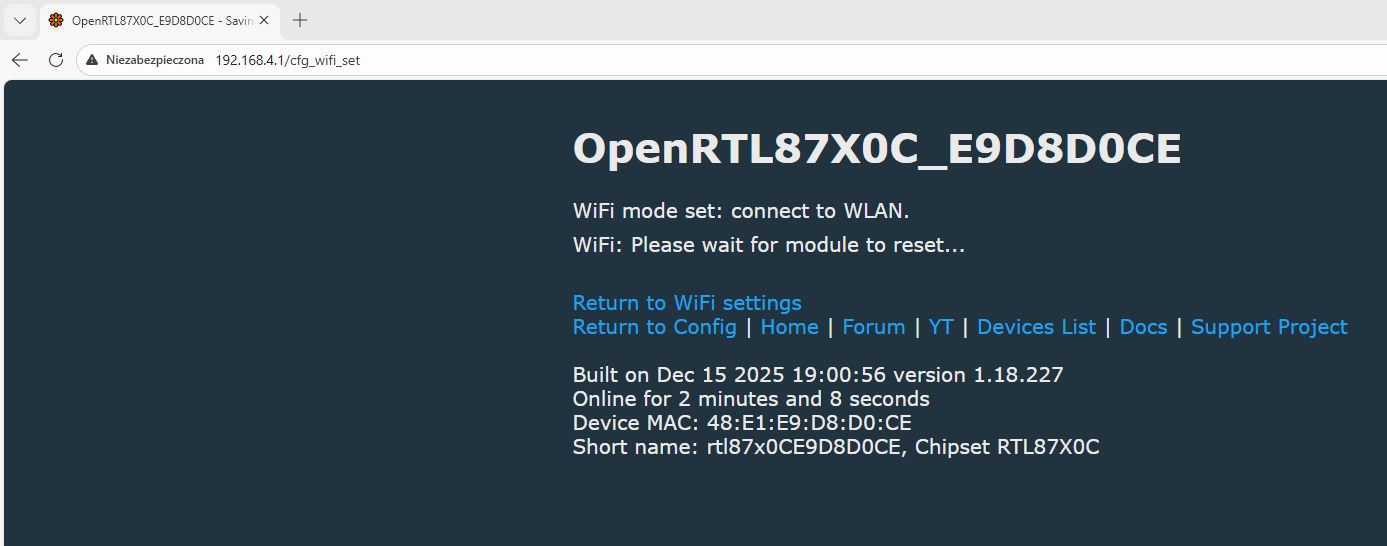

    I am at configuration stage, so it seems to work:
    Wi-Fi module configuration screen showing OpenRTL87X0C_E9D8D0CE and device details

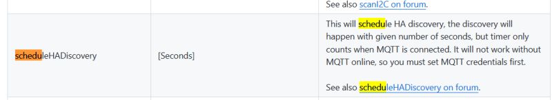

    Anyone having problems with MQTT and Home Assistant? After some time (I'm not sure if it's hours or days), the device becomes unavailable on Home Assistant even though it works. At that point, I have to go into "Home Assistant Configuration" and press "Start Home Assistant Discovery," and the device immediately starts working again. For a while longer, then the problem starts again. Is there a way to permanently fix this?
  • #387 21786432
    Posts: 14580
    Help: 654
    Rate: 12604

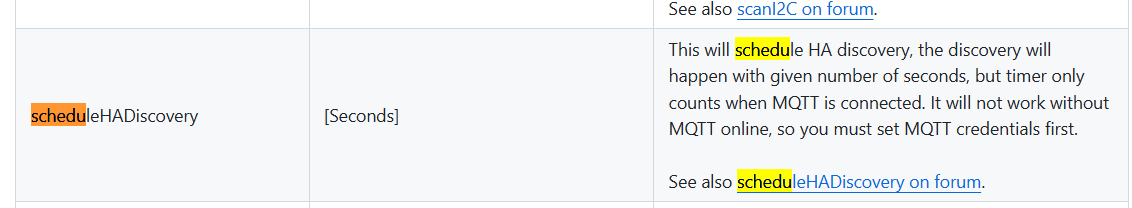

    I don't recognize this issue but I know that you can automatically invoke HA discovery on reboot or on timer via autoexec.bat commands.
    Screenshot of a documentation table with highlighted “scheduleHADiscovery” text

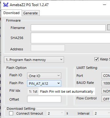

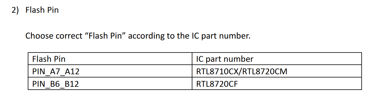

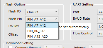

    regarding Z2 in Easy Flasher, I'm just trying to work out the situation regarding flash pin pairs and how it handles the two. This is from the PG Tool guide doc
    Table mapping Flash Pins to IC part numbers RTL8710CX, RTL8720CM, and RTL8720CF
    Screenshot of AmebaZ2 PG Tool interface showing firmware flashing settings
    Dropdown menu for selecting flash pins in configuration software
    3 pairs it seems.
    • UM0503 Realtek Ameba-ZII Image PG Tool user manual.pdf (601.83 KB) You must be logged in to download this attachment.

    but doesn't it mean that old devices (from old batches) will still use it?
    By the way, why do we even have to choose it as in the dropdown list?
