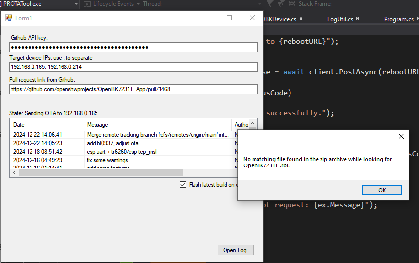

    I see you've updated the workflow to newer version as well. Currently now it has a drawback, as artifacts are no longer in a single file, so PROTA stopped working:
    Screenshot of PROTATool.exe showing an error about a missing file in the ZIP archive.
    Would it be possible to also enable "Merge artifacts" step on the PRs?

    >>21358821 Enabled artifacts merging, previously it was configured to not merge in any pr or branch, only for main/alpha branches, as to not break release script.
    In the future, it is better to update the tool to download only selected platform artifact, mainly to reduce traffic.

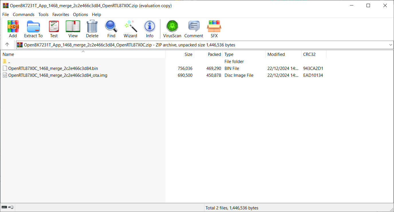

    not sure where you're looking...
    Screenshot showing a ZIP archive management program window with two extracted file paths.

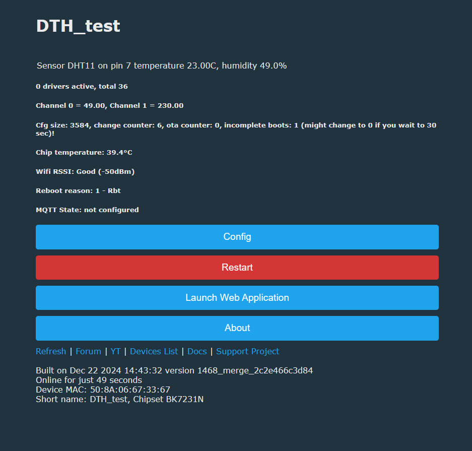

    Just to hijack the thread :) DHT11 test on N platform results
    Screenshot of the DHT11 test interface displaying temperature and humidity.
    Let me know on what platform and what driver needs to be tested, still waiting for TR and W600 but I think I got the rest on the table

    >>21359475 W701, W701M, W701P and W701H are ok and will work. W701D and RTL8720CS are of a different family, and therefore unsupported.
    On DHT_test, is powersave enabled or not? The delays are a little different if ps is enabled.

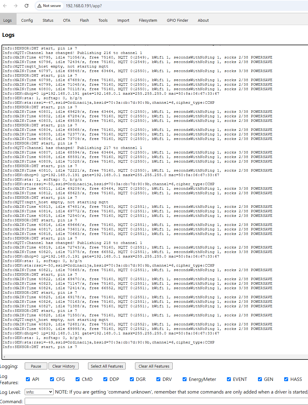

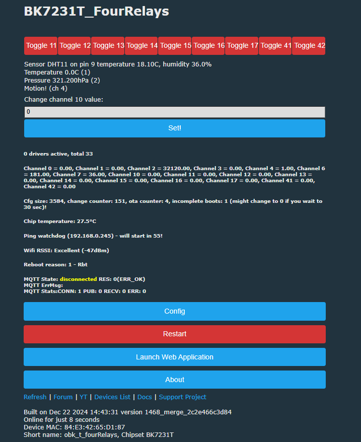

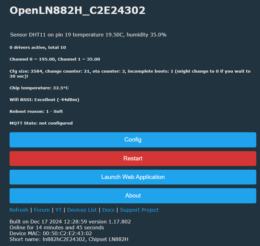

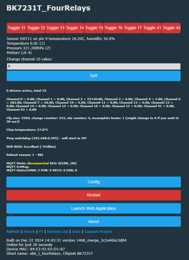

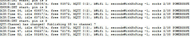

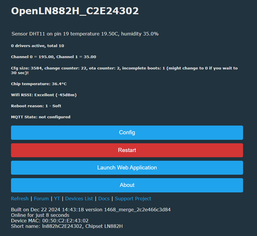

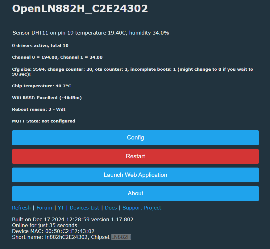

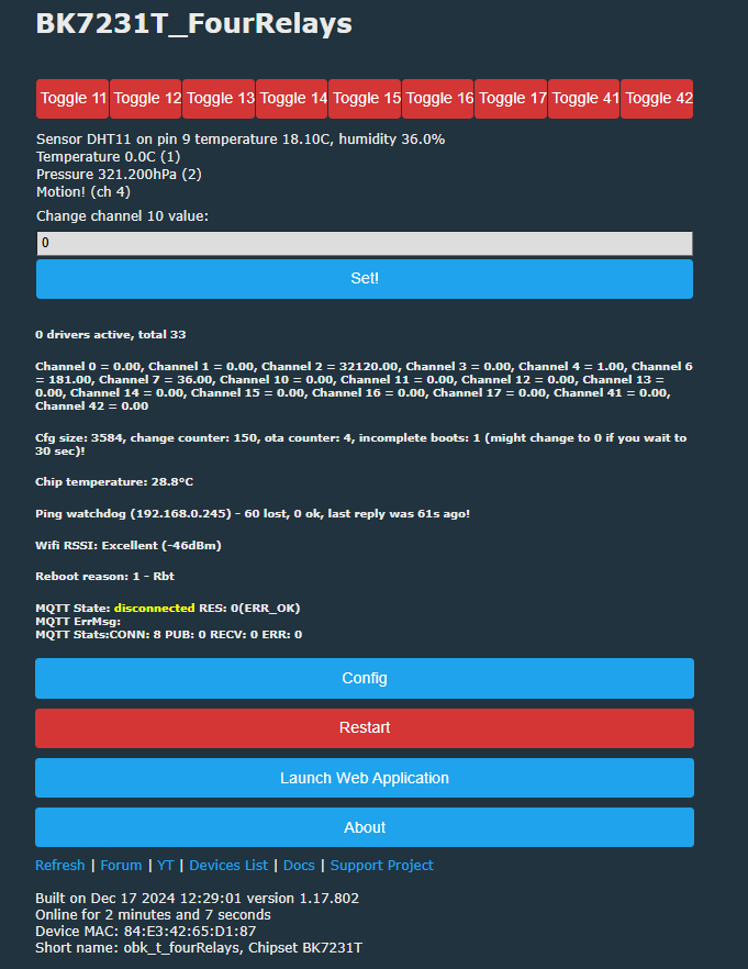

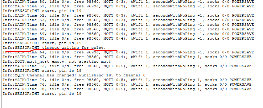

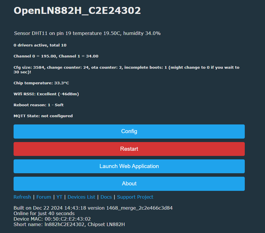

    BK7231T + DHT11 (no power save) on 1.17.802:
    User interface for BK7231T_FourRelays device with DHT11 sensor.

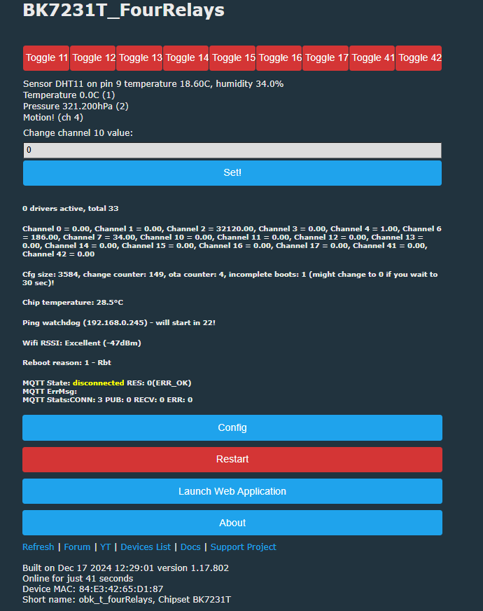

    BK7231T + DHT11 (power save) on 1.17.802:
    Screenshot of BK7231T_FourRelays interface showing DHT11 sensor information and control options.
    BK7231T + DHT11 (no power save) on https://github.com/openshwprojects/OpenBK7231T_App/pull/1468 :
    User interface for BK7231T_FourRelays with DHT11 sensor information and control options.
    BK7231T + DHT11 (power save) on https://github.com/openshwprojects/OpenBK7231T_App/pull/1468 :
    Screenshot of the BK7231T_FourRelays interface displaying DHT11 sensor readings and configuration options. Screenshot of console with diagnostic data for BK7231T and DHT11.

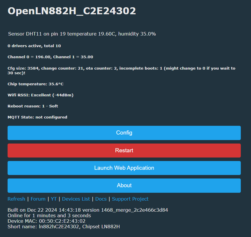

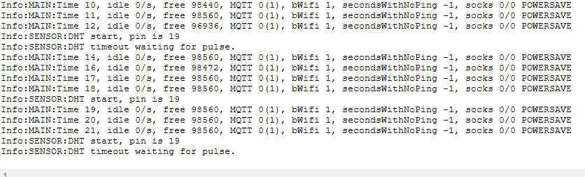

    LN882H + DHT11 (no power save) on 1.17.802:
    User interface of OpenLN882H with DHT11 sensor data
    LN882H + DHT11 (power save) on 1.17.802:
    Screenshot of the OpenLN882H_C2E24302 user interface displaying DHT11 sensor information.

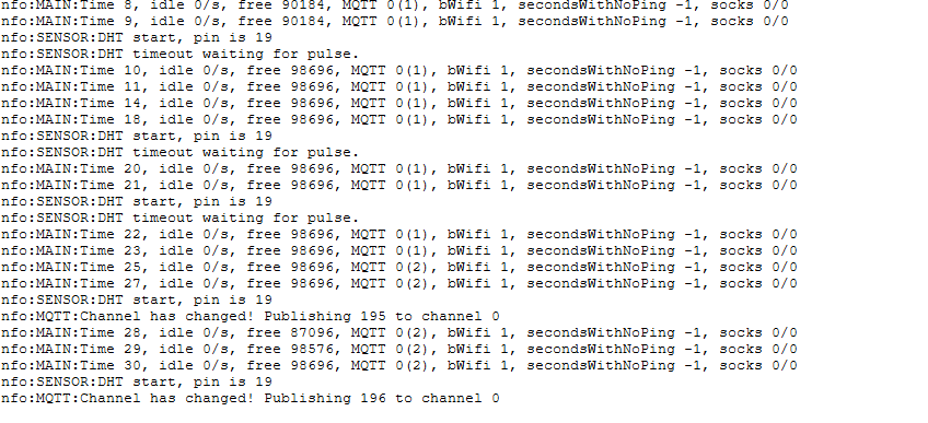

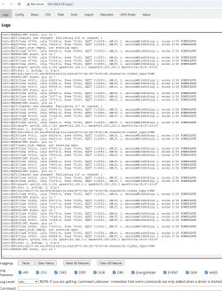

    It works but sometimes times out
    Screenshot of a console log showing device information with DHT sensor status and performance statistics.
    LN882H + DHT11 (power save) on https://github.com/openshwprojects/OpenBK7231T_App/pull/1468 :
    Screenshot of the OpenLN882H_C2E24302 interface displaying temperature and humidity information.
    sometimes:
    Screenshot of device logs indicating a DHT sensor timeout.
    LN882H + DHT11 (no power save) on https://github.com/openshwprojects/OpenBK7231T_App/pull/1468 :
    OpenLN882H user interface with DHT11 sensor data
    Screenshot of debugging logs with DHT error messages
    The conclusion is that it works, but it sometimes timeouts, I feel like I saw this even on Beken.
    Application interface logs showing data and operations on the server.

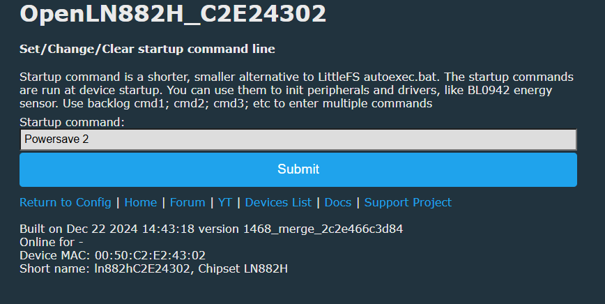

    It's with powerSave 1, I assume?
    Did/could you also check if even "powerSave 2" will work on LN882H?
  • #45 21359796
    Posts: 14599
    Help: 654
    Rate: 12615
    What is PowerSave 2 on LN882H? I can check.
    Configuration screen of OpenLN882H_C2E24302 with a field for entering a startup command.
    (rebooted)
    Screenshot of the OpenLN882H device interface with DHT11 sensor information.

    Yes, it's some time ago now ;-), but we introduced two power save modes on LN882H: 1 not so strict, even power metering with BL0937 worked and 2 stricter, pulse counting didn't work with this mode.
    Its simply "powerSave 2"

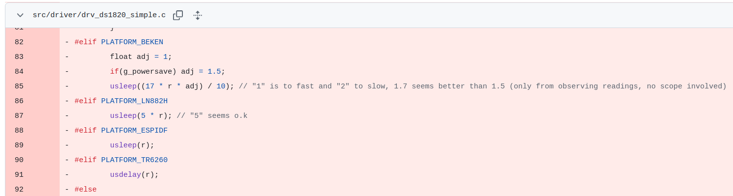

  • #48 21359894
    max4elektroda
    Posts: 754
    Help: 48
    Rate: 187
    For for me on LN882H the new "HAL_Delay_us" will not work with DS1820.
    I had it set to 5 times usleep to work in the driver
    Screenshot showing a code snippet in the file drv_ds1820_simple.c with various platform conditions.
    And if I got it right, it now uses "default" "nop"-lines from src/hal/generic/hal_generic.c.
    I'm a bit confused, that DHT works while DS1820 doesn't.
    Can someone else confirm that DS1820 is (not) working on LN882H with this version?

  • #50 21359953
    max4elektroda
    Posts: 754
    Help: 48
    Rate: 187
    insmod wrote:
    Instead of usleep, i tried to use ln_block_delayus
    Hero! Works fine, one single reading error during the first three minutes reading every 2 seconds!!!
    Hope it won't break DHT...
    Added after 8 [minutes]:
    Works with "powerSave 1" and even "powerSave 2" !!

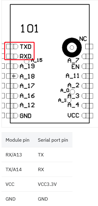

    Here we go, another one for the collection - https://www.aliexpress.com/i/1005003073843142.html
    Electronic module with highlighted chip features.
    EDIT: beware of the shipping cost, but you can find that module on other stores, that was the idea.

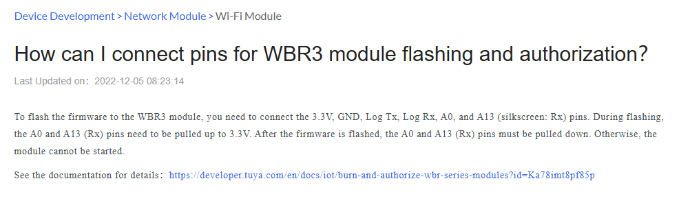

    Added after 7 [hours] 16 [minutes]:

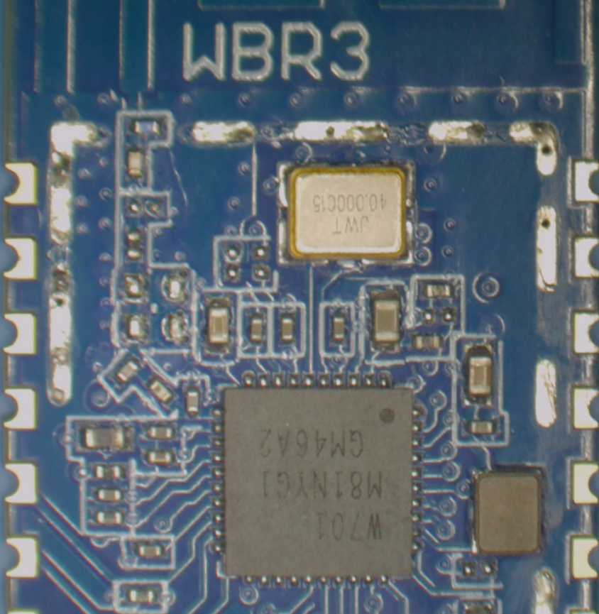

    @insmod
    This threw me into a loop. I am trying to flash WBR3 module that has W701 chip on it but it looks like it is RTL8720CF chip that is Ameba-Z II family.
    Datasheet here - https://v4.cecdn.yun300.cn/100001_2110255103/RTL872xZ2%20IC%20Datasheet.pdf
    Tuya documentation is super confusing and not helpful at all.
    Screenshot of documentation section about connecting pins for WBR3 module.
    This is my device and the pinout corresponds to CF chip datasheet
    Close-up of WBR3 electronic module with W701 chip.
    Also back of it looks as Tuya documentation is showing it
    Pin diagram of the WBR3 module with an integrated circuit.
    But at least I got to spend some time researching which is something I like :)
    Now going back for some more homework....

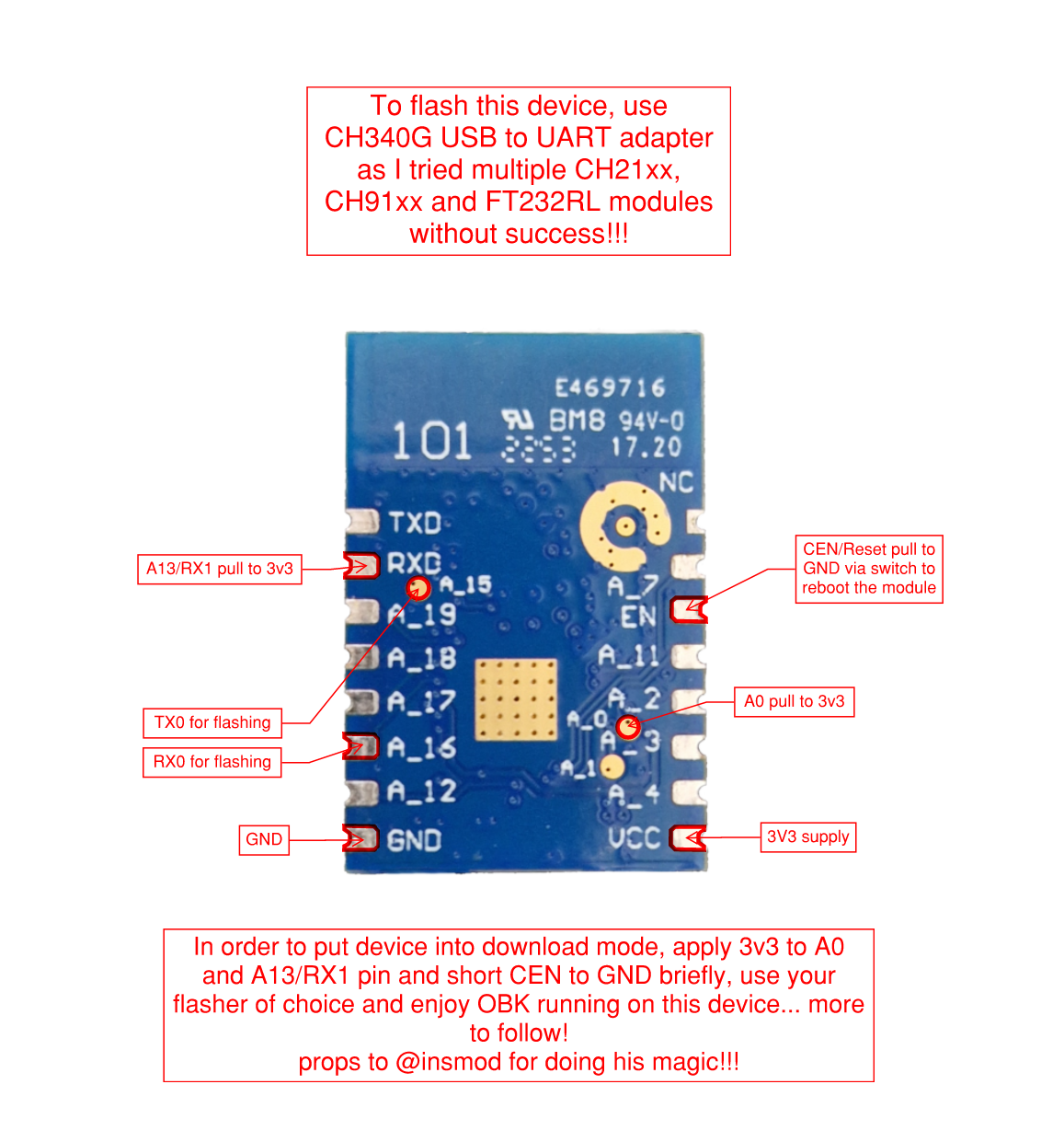

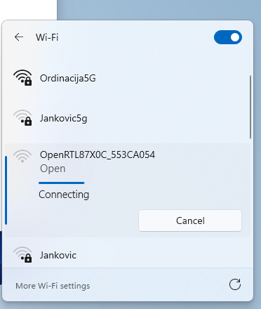

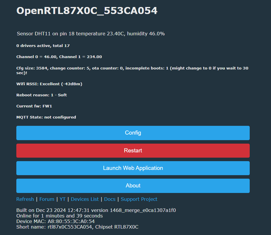

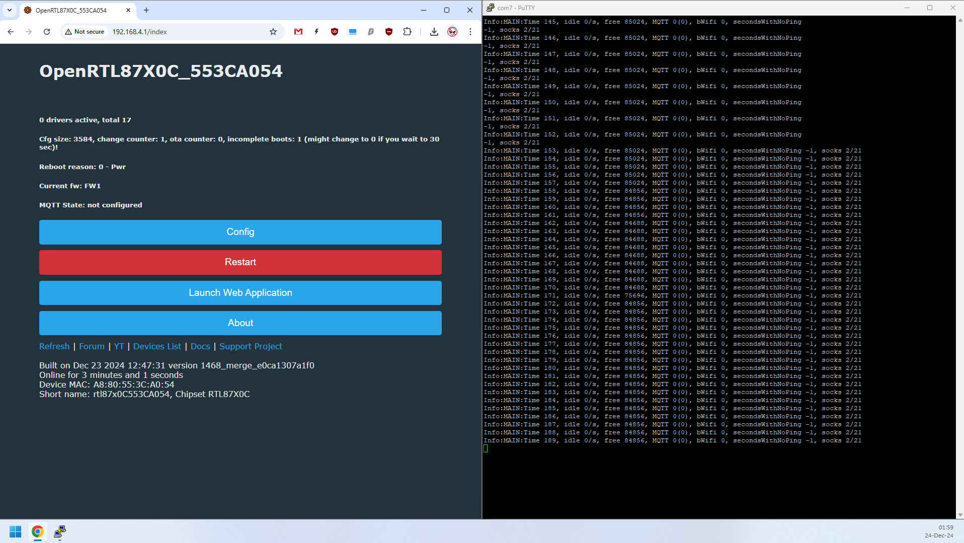

    For the future visitors - I only managed this to work with CH340G UART converter.... took me 2 hours of troubleshooting and traffic capture to figure that out....
    List of available Wi-Fi networks on a computer screen with the OpenRTL87X0C_553CA054 network selected and connecting. Screenshot of OpenRTL87X0C interface and Putty terminal window.
    For anybody new I'll add a connection diagram and a walk trough how to flash this F**KING module - pardon my French! 🤬
    Screenshot of the OpenRTL87X0C control panel displaying sensor information and configuration options.
    All based on Tuya WBR3 module with W701 chip...
    Tuya WBR3 module with marked flashing points.
