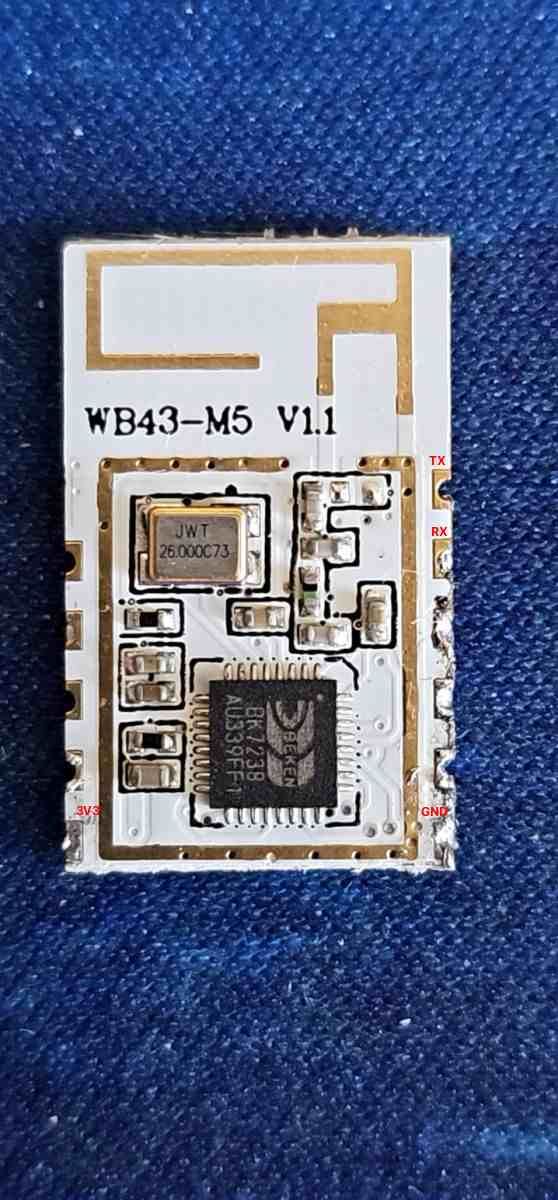

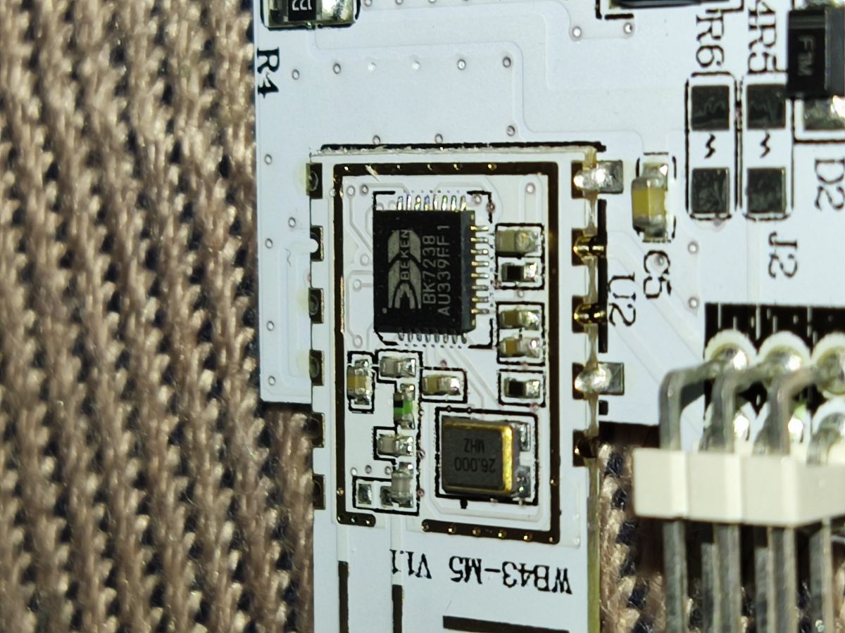

    I bought two of these exact bulbs with a BK7238 Module (WB43-M5 V1.1) with Surplife App and were able to flash it using the following pin layout, see image below.
    Sorry for the small font indicating RX, TX, 3V3 and GND.
    WB43-M5 V1.1 module with labeled RX, TX, 3V3, and GND pins on a white PCB

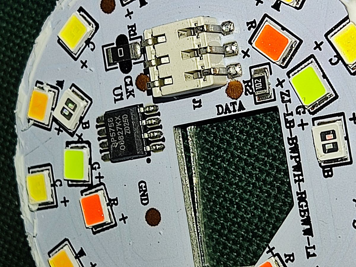

    Pin layout for RGB driver; was working and then stopped, maybe I have the wrong pins?
    "pins": {
    "24": "BP5758D_CLK;0",
    "26": "BP5758D_DAT;0"
  • #33 21633362
    Posts: 14754
    Rate: 12875
    Hey, that's a nice finding! Do you have original firmware dump?
    Also, can you elaborate, what do you mean by "stopped working"? You mean it stopped after OTA or when? Was it working fully correctly, or did you just get random colors once? Because you know, if you have chosen wrong I2C LED driver, you might have gotten a random color once or twice, without it working fully.

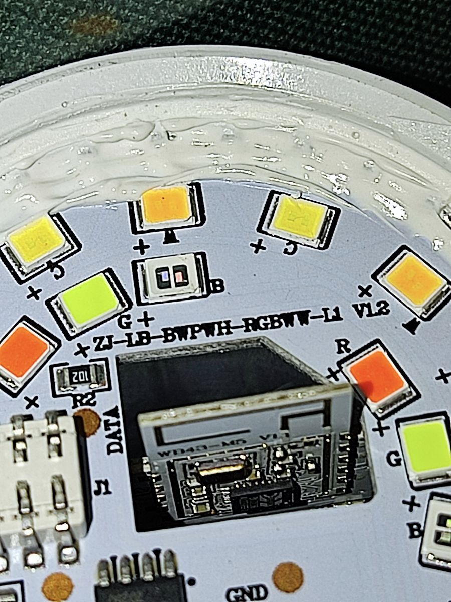

  • Firmware upgrade restored bulb operation
    #46 21633920
    diepeterpan
    Posts: 22
    Weird news, I was able to flash back the backup firmware. I then paired it with the app on iOS, but the bulb did not want to turn on or anything, and I presumed it was fried.
    Then the app said there is a firmware upgrade for the bulb. I upgraded it, and the bulb then started to work, so nothing is fried.
    Now I don't know whether I want to try OpenBeken again; I might not be lucky a second time around.
    BTW, in HomeAssistant you can use the "Magic Home" plugin to use these lights with the original firmware - https://www.home-assistant.io/integrations/flux_led/
    Some more pictures of my bulb below, just a FYI.
    Close-up of smart bulb's internal PCB with colorful LEDs and microchips
    Close-up of a white PCB with Beken BK7231N chip and electronic components
    Close-up of an LED bulb circuit board with RGB LEDs and electronic components
    Close-up of WB3S Wi-Fi module and RGBWW LEDs on a smart bulb circuit board
    When I have time again to waste, I will try Flash again with OpenBeken.
