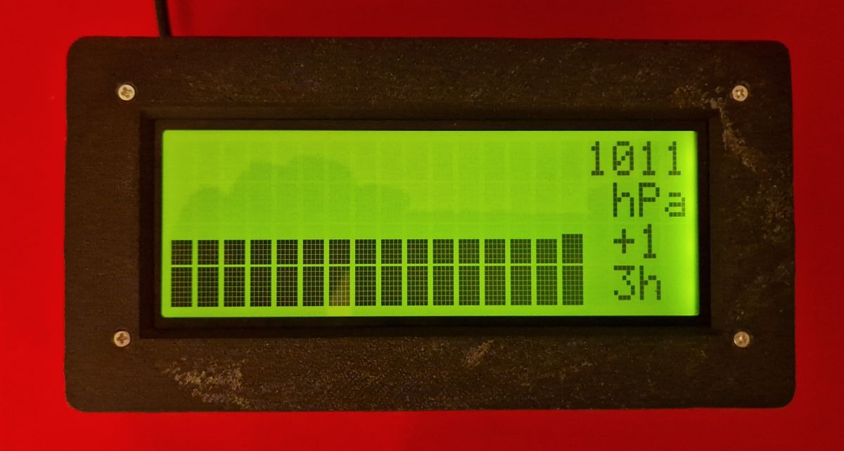

  • I bought a barometer. The seller said there was a mistake, not 50pln but 500pln it was supposed to be. He refunded the money.
    I bought another one - broken, it's sitting under the kitchen table waiting for a return label.
    I bought a third one - a new USSR, but it didn't survive transport....
    So much for the basic question "why do this, isn't it easier to buy on the alegro?", or: "they are available online - why waste time?".
    I found the projects SECRET and closed on the electrode, so had to look elsewhere. It was supposed to be simple, easy, clear, not very expensive.
    I rummaged through my resources. I had a display (about 50pln), a Nano (about 12pln), and for 4pln I bought an I2C SPI BMP280 3.3V pressure transmitter.
    I used this development: Link but it proved problematic to use the AdaFruit BME280 product because of the price (over 70pln cheapest I could find).
    I have converted the code to the following, as the regular BME280 does not support all the commands as the AdaFruit does:

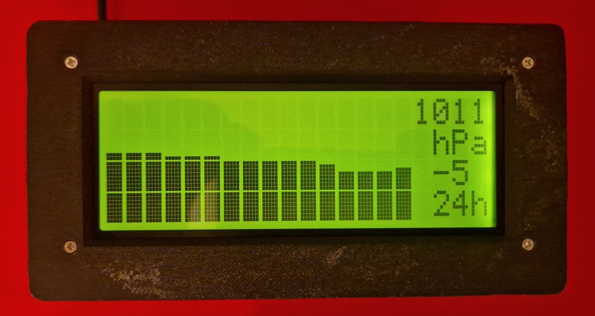

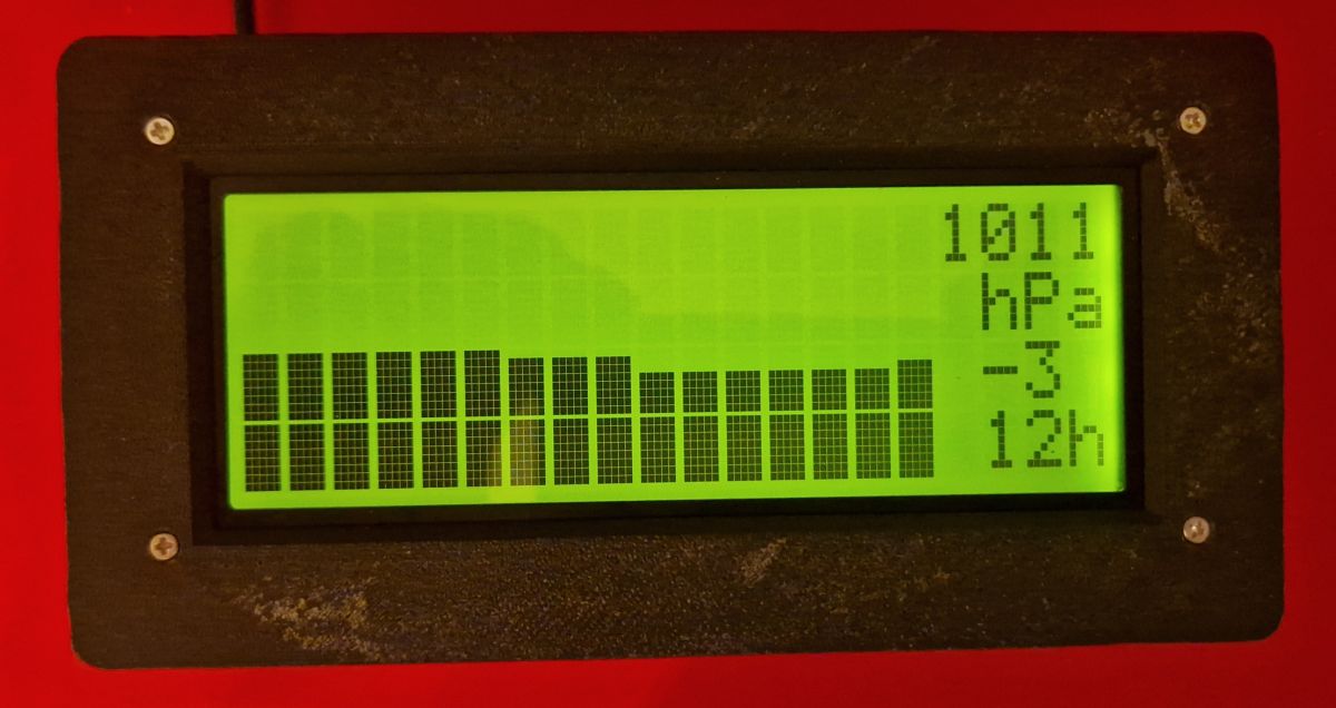

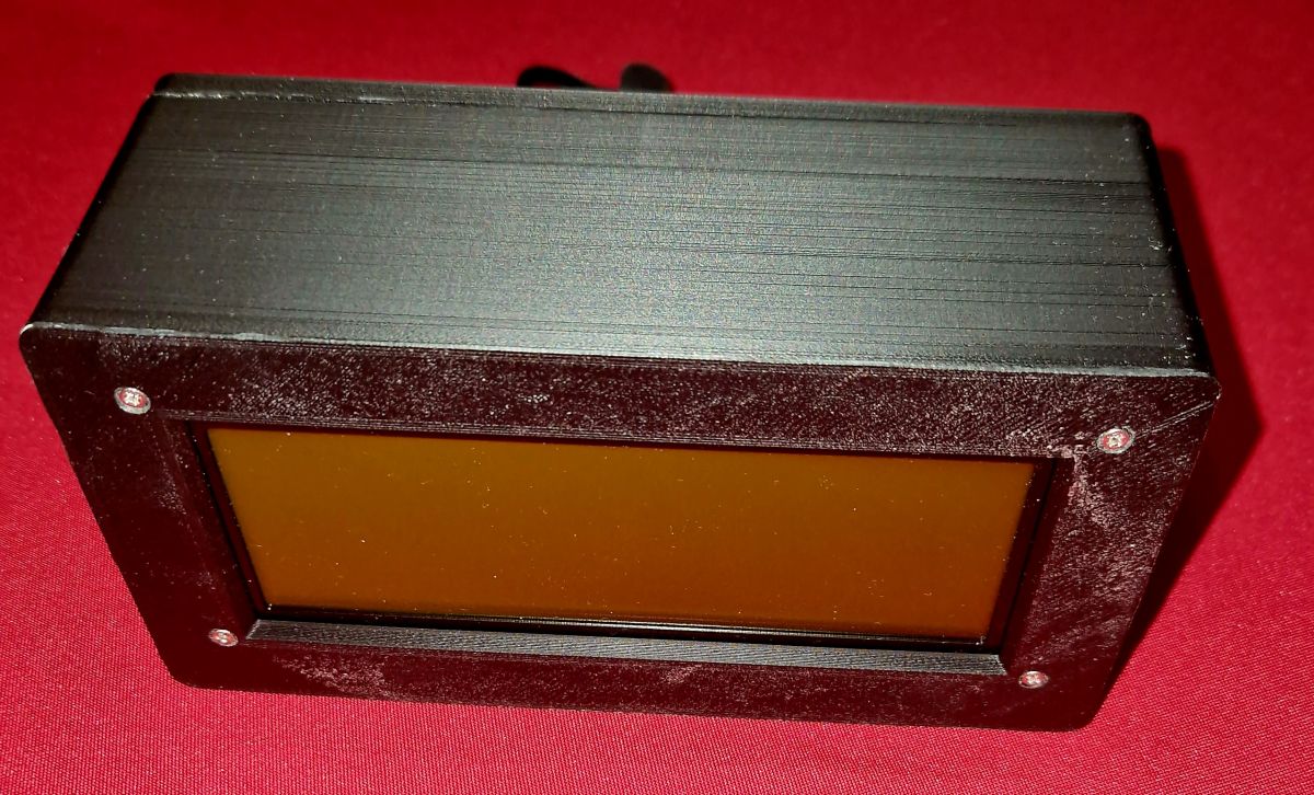

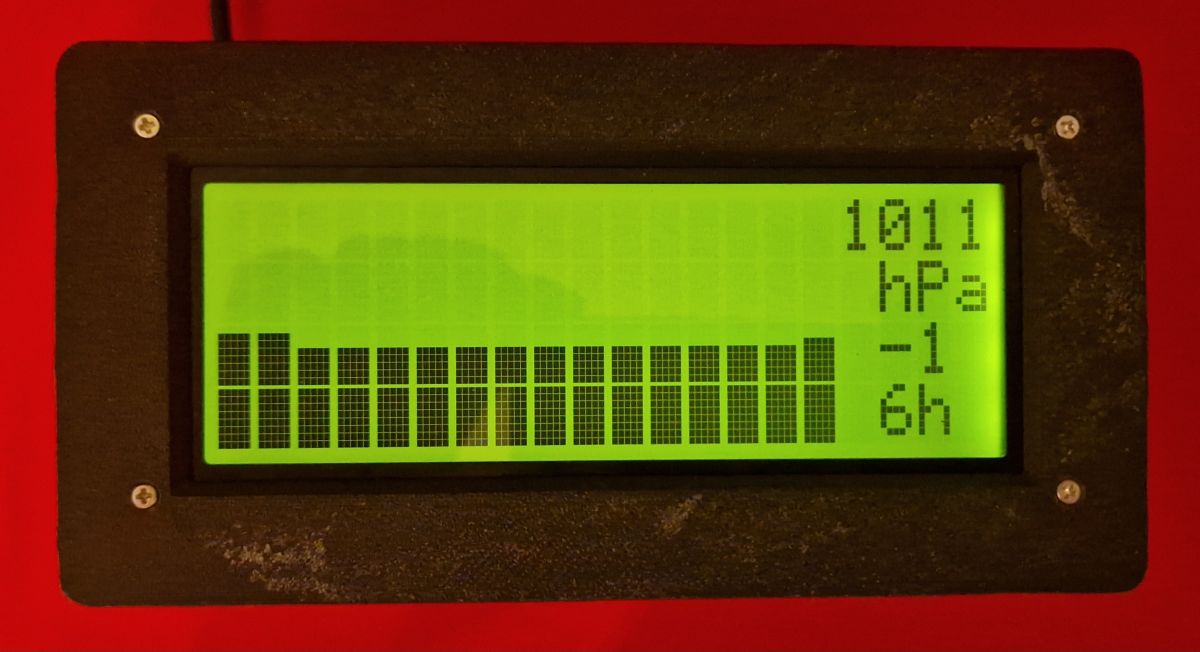

    I connected a 5kOhm potentiometer to the I2C converter jumper so that I could 'adjust the brightness' of the display.
    Power supply with samsung cable - I cut off the broken USB-C end.
    A bend from a broken power supply.

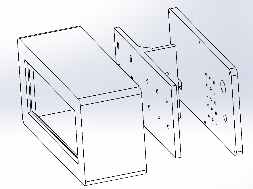

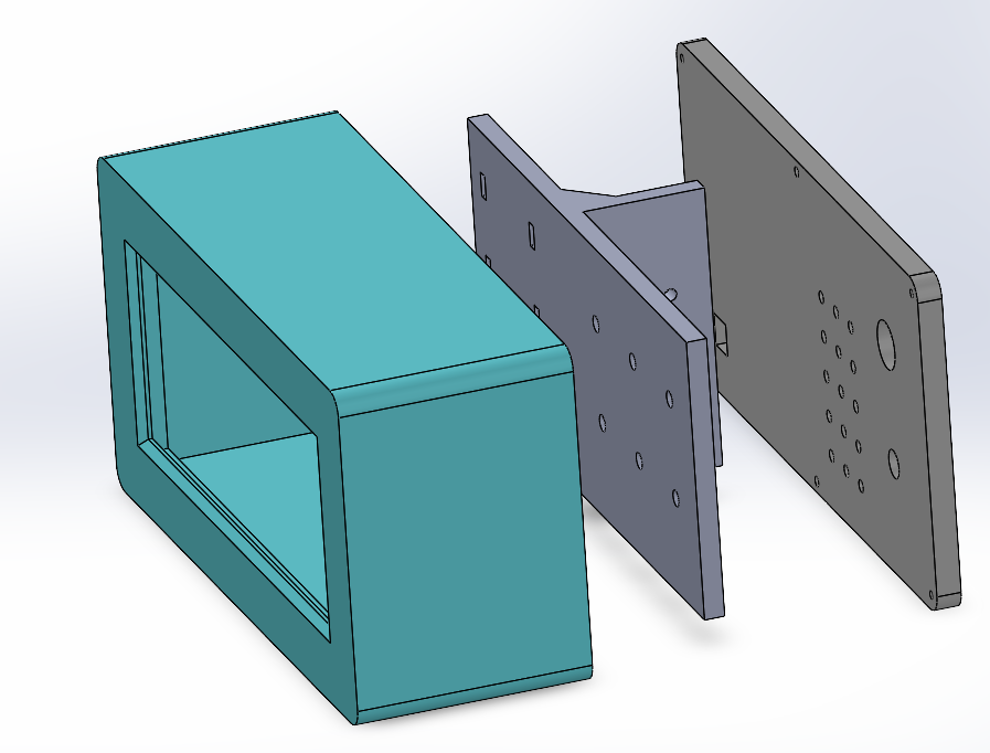

    3D printing I made ABS. SolidWorks, STEP, STL files - attached.
    Works cool. Recommended.
    It looks like this:
    Black barometer in a rectangular casing with an LCD display, set on a red background. .
    Black electronic DIY project with a cable on a red background. .
    DIY digital barometer with LCD display in a black casing. .
    LCD screen showing pressure readings and bar graph .
    LCD display showing barometer data. .
    LCD display with pressure graph and data .
    3D render of a housing with three separate components, part of an electronic project. .
    3D case design for a barometer created in CAD software. .

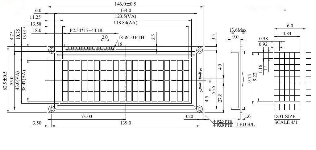

    LCD display layout with dimension details. .
    IF YOU WOULD LIKE, please suggest changing the code as described below.
    TO:
    - The dream would be that the graph would be scaled for each interval (3, 6, 12, 24h) and start with the minimum measured pressure value as the minimum of the Y axis and end with the maximum measured pressure value and this would be the MAX of the Y axis.
    Of course, this is a redesign. Not my design. The author is Mirko Pavleski. I only adapted to the poor-elements.

  • Core parts named in the build were a 20x4 display (~50 PLN), Arduino Nano (~12 PLN), and I2C SPI BMP280 3.3 V transmitter (4 PLN), keeping the main electronics around 66 PLN before enclosure and wiring. [#21421897]
  • The code stores pressure history in base_array[128], plots 16 points on the display, and switches interval views by doubling interval from 1 to 8, giving 3 h, 6 h, 12 h, and 24 h windows. [#21421897]
  • The fixed graph scale in the posted code uses MIN_VAL 990 and MAX_VAL 1035, so small pressure changes can look visually flat until auto-scaling is added. [#21421897]
  • The author’s target was explicit: simple, easy to install, clear from a few metres, and low cost = max 150 PLN total. [#21422553]
