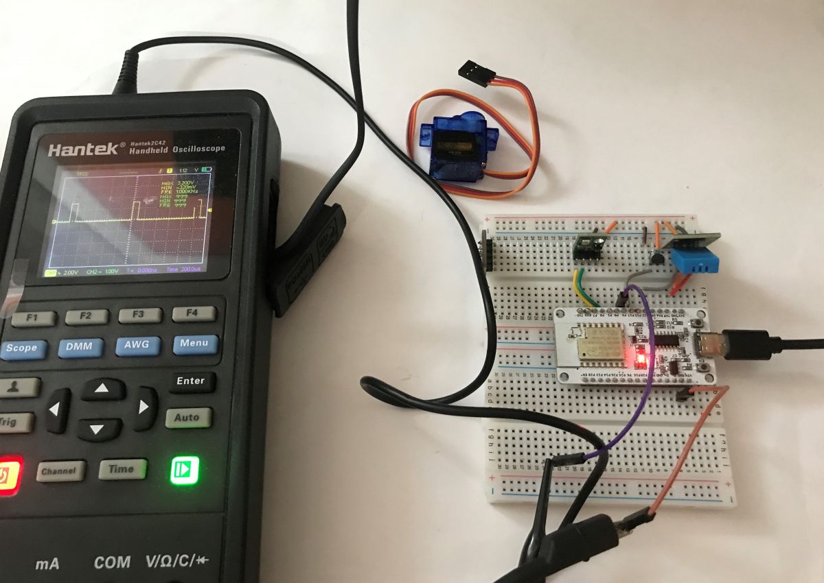

    Sure, it's a good idea. Let me try this out so we can figure out a config for you:
    Handheld oscilloscope with signal graph and breadboard with electronic components.
    @divadiow do you have any servos?
    @insmod I think it may be a good time to clear up pwm frequency settings and maybe add them per pin, can you check out this PR? https://github.com/openshwprojects/OpenBK7231T_App/pull/1554 WIP
    Added after 32 [minutes]:
    Set required pin to PWM_ScriptOnly. Give it channel 20. Just to be sure, use my PR or wait for merge. Use autoexec.bat:
    PWMFrequency 20
    startDriver httpButtons
    setButtonEnabled 0 1
    setButtonLabel 0 "Set -90"
    setButtonCommand 0 "setChannelFloat 20 5"
    setButtonEnabled 1 1
    setButtonLabel 1 "Set 0"
    setButtonCommand 1 "setChannelFloat 20 3"
    setButtonEnabled 2 1
    setButtonLabel 2 "Set 90"
    setButtonCommand 2 "setChannelFloat 20 1"
    It works, more or less:

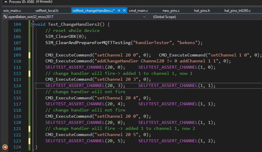

    // want to turn off PWM on CH20 after 2 seconds
    // addRepeatingEvent   [IntervalSeconds][RepeatsOr-1][CommandToRun]
    alias turn_off_after_time addRepeatingEvent 2 1 setChannel 20 0
    // this should run turn_off_after_time every time that CH20 becomes not 0 but does nothing
    addChangeHandler Channel20 != 0 turn_off_after_time
    But it does not work. turn_off_after_time works, and addChangeHandler works, but channel 20 changes don't trigger the alias. Any suggestions?

    That change handler is called when a transition from 0 to non 0 value happens. It won't be called when CH20 transitions from non-zero to non-zero value.
    I think you rather need:
    alias set90deg backlog setChannelFloat 20 0.2; turn_off_after_time
    The following will explicitly call delay and reset after you set given position in the servo.

    Posts: 14797
    Rate: 12954
    Can you provide more information how to replicate addChangeHandler not working?
    I've tried to check addChangeHandler in self test but it passes both on my machine and on Github.
    Test commit:
    https://github.com/openshwprojects/OpenBK7231...mmit/8c01b0cf83aaa2f34d2498b25b163ac1c51ebe8e
    Screenshot:
    Piece of code in Visual Studio editor.
    Unless the problem is in the float version?
    It seems that's the case...
    Well, for now, I can try to add a work around, but I am not sure if it will work good with fractional parts, I will try to look into it a bit later more. I will just most likely adjust change callbacks to work with floating points internally.

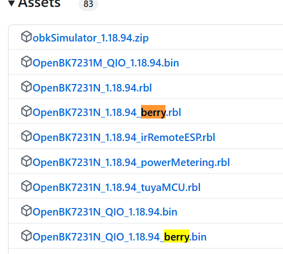

    I haven't seen this message. Maybe you can give a repeating event with time delay instead?
    Or .. use Berry. We've added Berry script 10 days ago, maybe you can use that:
    https://www.elektroda.com/rtvforum/topic4117238.html
    List of downloadable files from the Assets section with highlighted berry filenames.
