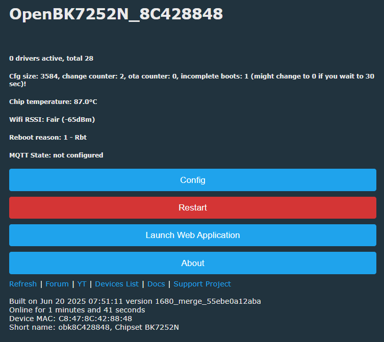

    insmod wrote:
    BK7252N build, untested.
    congratulations. 1680_merge_55ebe0a12aba QIO flashed:
    Shenzhen Pinmei / Linklemo A9 Mini Camera with Beken BK7252NQN481 – Photos, Boot Log, Flash Backup
    only BL log from TX pad on this device. OTA is successful to and from 1680_merge_55ebe0a12aba and _7231u_t_b0f287a571d0
    Added after 3 [minutes]:
    P2 is blue LED on this A9 and it is controllable

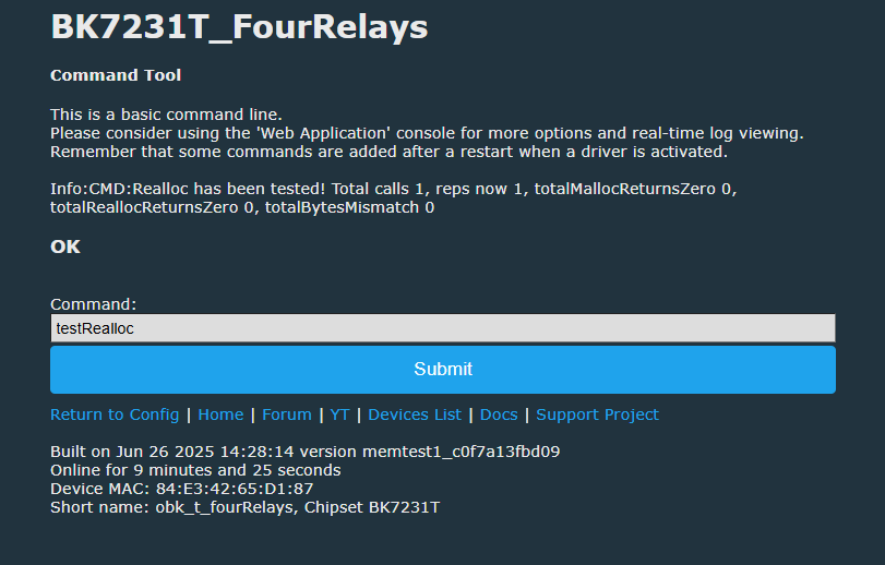

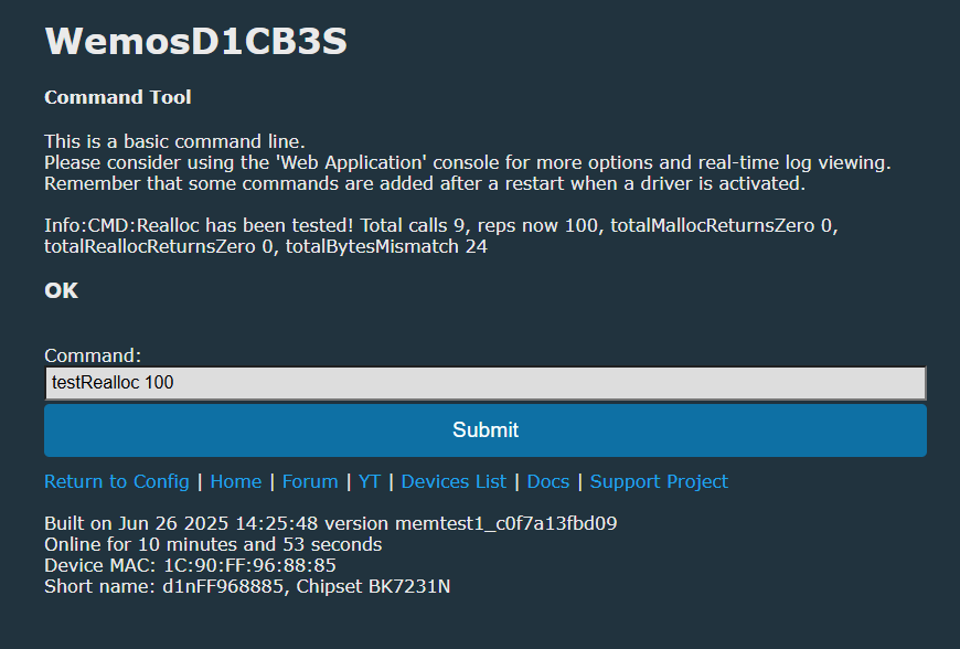

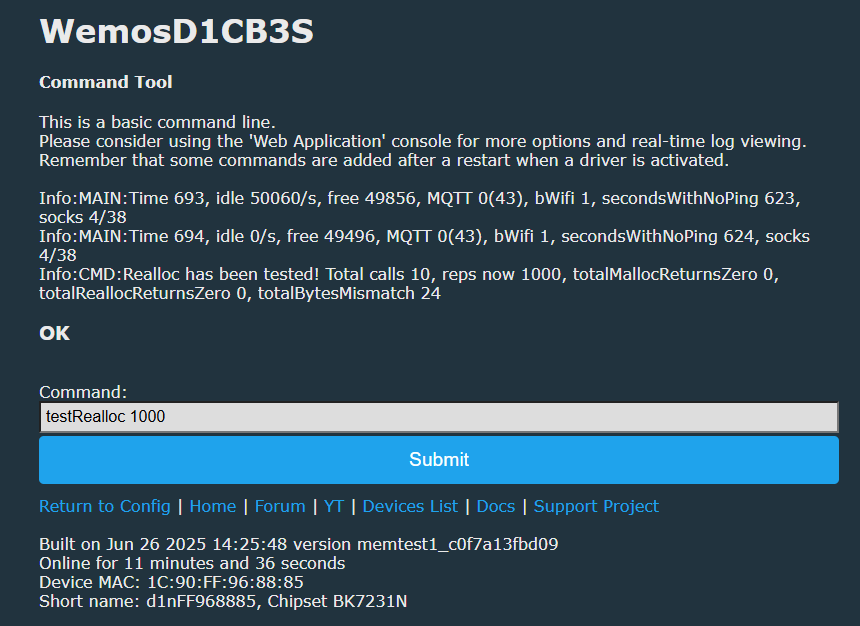

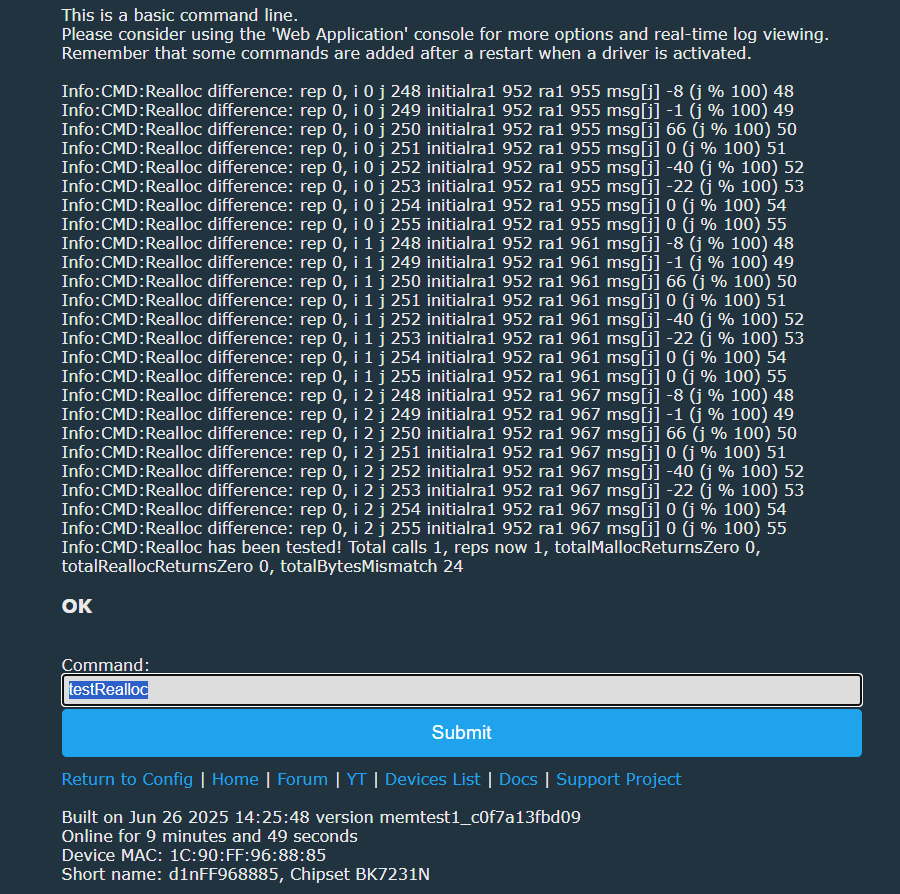

  • Realloc corruption appears rare and unreproducible
    #38 21590303
    Posts: 14793
    Rate: 12938
    I was sure that it works. I've retested now and I am not sure.
    It seems that realloc on N is still RARELY (but still) mangling the bytes?
    Code: C / C++
    Huh. I rerun it and I can't reproduce that.

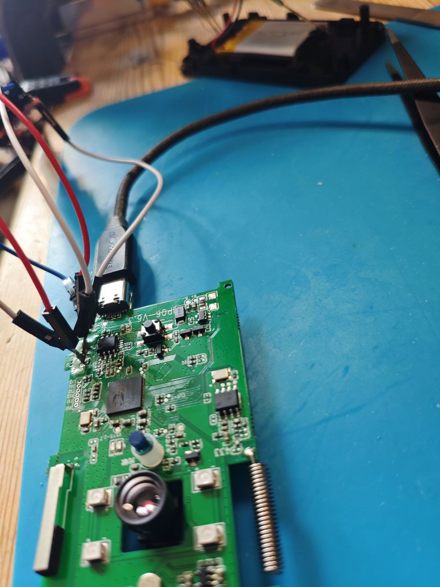

  • Need bootloader mode to read BK7252 flash
    #41 21626696
    Laloshifrin
    Posts: 32
    Thanks for your great work! I'm on a cheap chinese cam very similar to the one of the topic and running on the same MCU. It has INO-A10N-V2.3 Ca13 printed on PCB. I was triyng to get it streaming without Linklemo app. I managed to get boot log. Now I'm trying to read firmware with no luck. I'm on linux, I don't have Windows (though I'm thinking to install a virtual one). I connected V3.3, GND, Rx and Tx pins to my USB to UART adapter that can read correctly any log but I'm missing something because bk_loader is unable to read flash. I think I have to do something to put MCU in bootloader/download mode. @divadiow!!! How did you do it?
    Thanks again :)

    I'm using linux command line BKFIL application (bk_loader) but after "Getting Bus..." I get "LinkCheck Timeout". I supposed that MCU isn't in correct mode. I was asking if you did some kind of operation to put it in "read (or write) mode"... I read something about CEN to GND but I didn't find anything about in you posts. Can you help me please?

    Simply applying power, like with BK7231, should be enough to start the flash backup at the right moment. Are your wires short?
    Are you powering cam from USB UART adaptor solely? This may not be able to give it enough power.
    Added after 5 [minutes]:
    Battery was de-soldered and power applied from micro-USB port. Common grounds.
  • #45 21626732
    Laloshifrin
    Posts: 32
    Yes, I'm powering from adapter, 3.3V and GND. Blue led blinks 4 times... power seems to be enough, wires are less than 10cm long. Cam never had battery but has BAT+ and GND pads, the ones I'm powering.

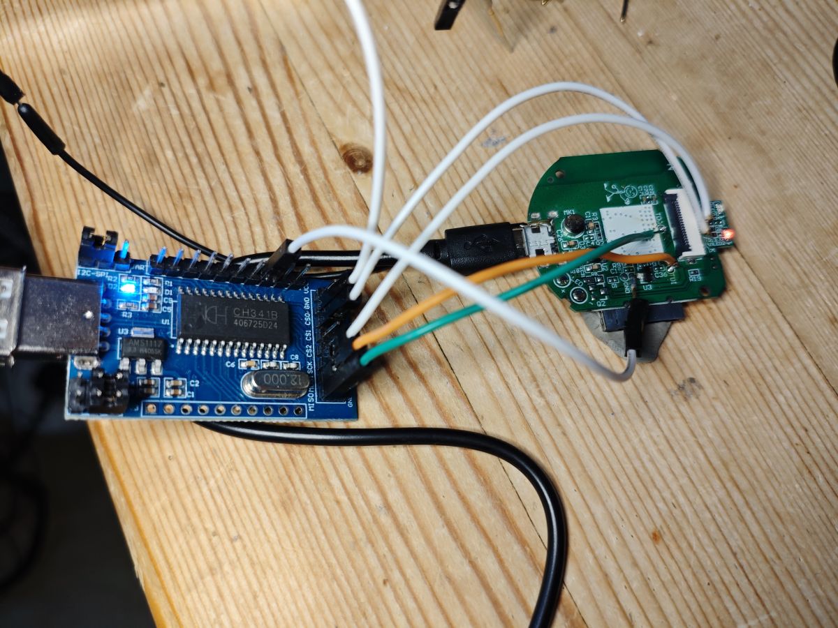

    Found a pic I didn't post. Shows me powering from micro-USB. This was SPI flash rig though
    CH341A module connected via wires to an SPI header on a circuit board

    yes it has. It's the only official way to power cam. On the board there are battery pads but no battery was never installed.
    So you powered it with 5V?
  • Use 5V USB power with common ground
    Yes, I powered it with 5V USB. There’ll be an LDO on the PCB to step it down to 3.3V for the Beken MCU and other components. Just make sure you have a common ground between the USB-TTL adapter and the board.

    If a device takes USB 5V or 12/24v barrel jack connector I tend to use that for power rather than bothering to solder up 3.3v
    eg
    PCB board with wires connected and USB-TTL adapter plugged in
