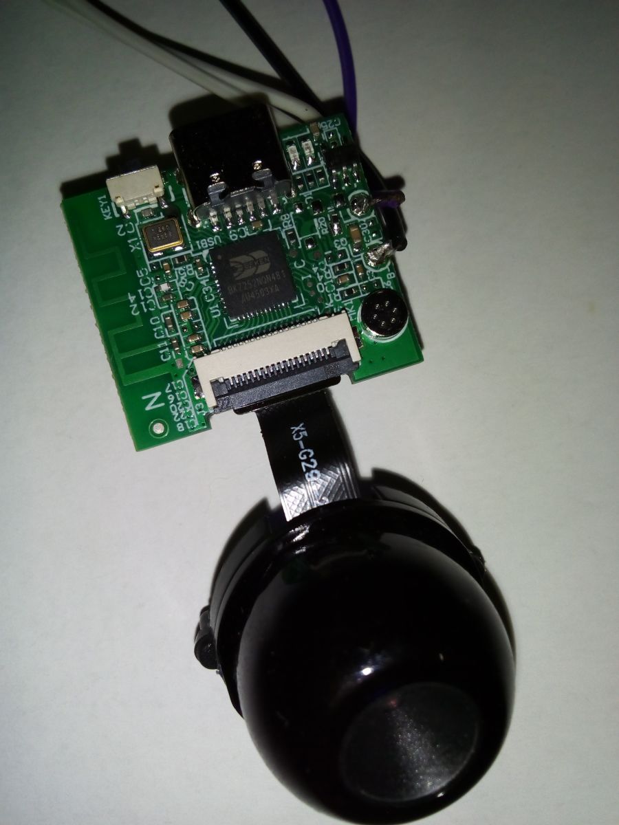

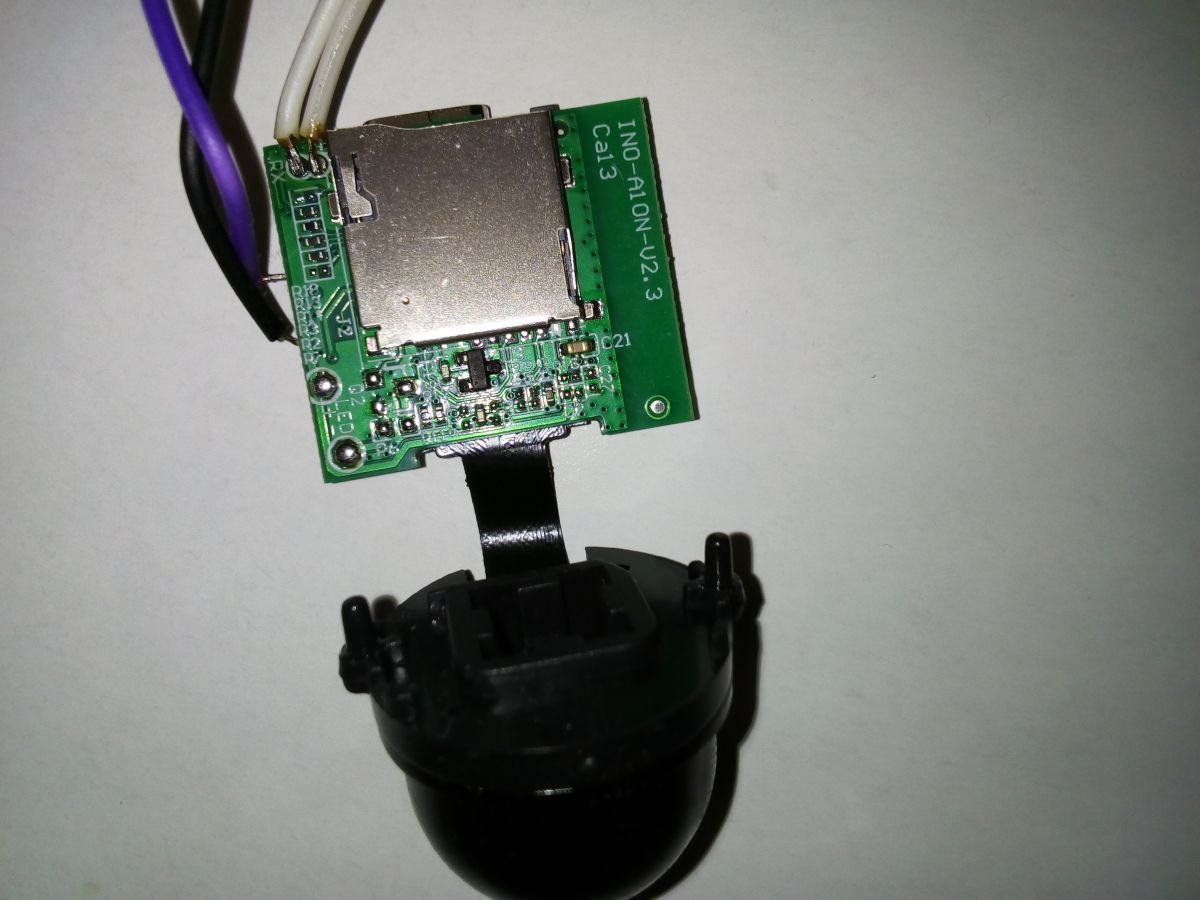

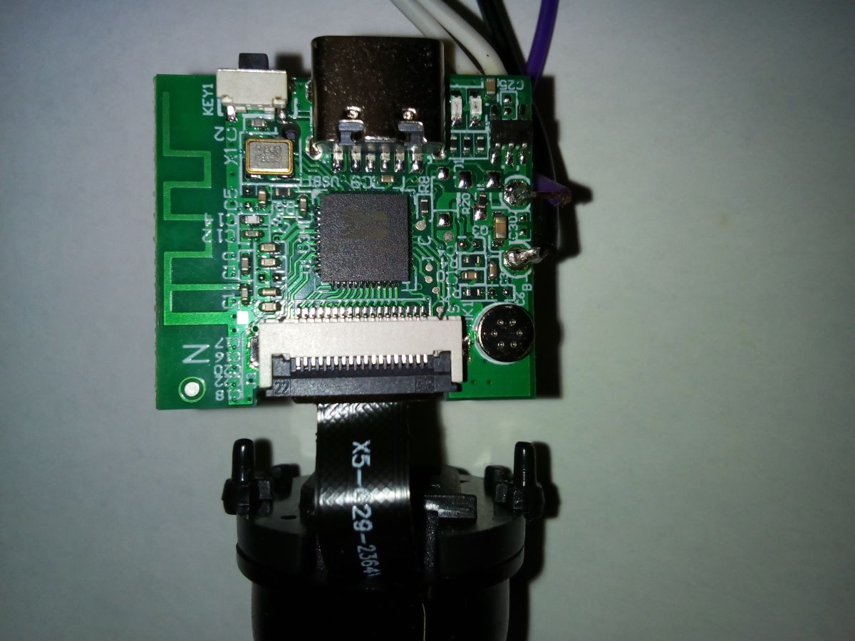

    Here's my cam:
    Camera module with exposed PCB and connected X5-G25 lens
    Camera module with visible electronics, USB-C connector, and ribbon cable to sensor
    Close-up of camera with exposed PCB and microSD card slot
    Purple WiFi HD camera box labeled “ITEM NO:HSR-X5 MINI”
    HD camera box with A12-Black label and manufacturer info from China
    WiFi camera box with large lens image and HD VIDEO CAMERA text
    Added after 6 [minutes]:

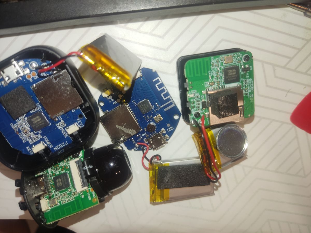

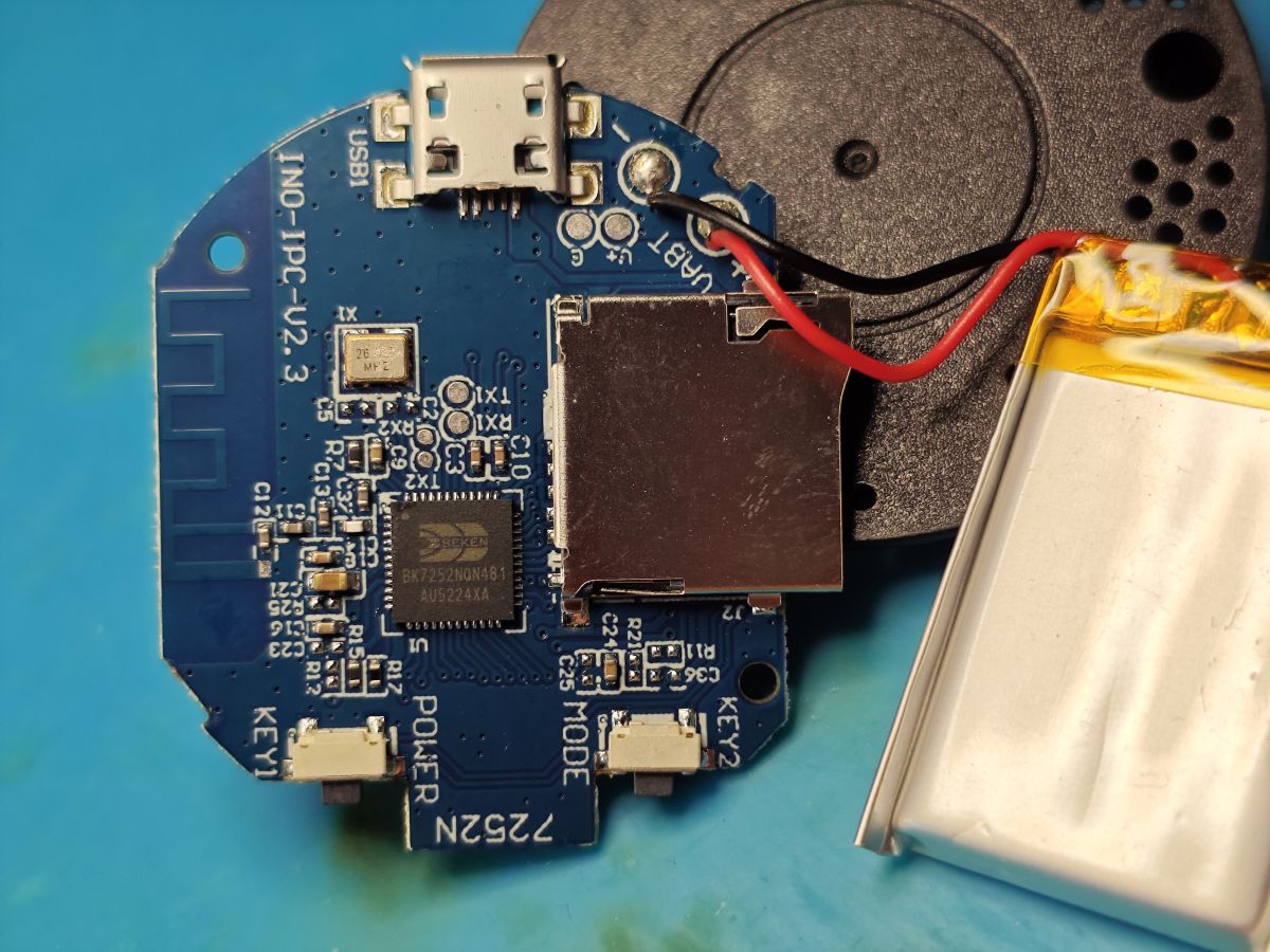

    Received my order of 4 cameras.
    One of them is TXW817-810, but 3 others are ALL BK7252N.
    One is the same as here, but with a blue PCB.
    Shenzhen Pinmei / Linklemo A9 Mini Camera with Beken BK7252NQN481 – Photos, Boot Log, Flash Backup
  • #79 21703292
    insmod
    Posts: 1387
    Help: 164
    Rate: 432
    Cameras:
    With this one - GC0329C
    TXW817 A9 - SP0828
    X5 - GC0310(a3)/GC0312(b3)
    The square one, marked as INO-A13N-V2.2 - GC0329C
    Added after 20 [minutes]:
    This one backup is named 7252n, square one - 7252n_square.
    Didn't take X5 backup, UART pins are difficult to solder, and i didn't bother because i need only one for a dev board.
    • backups.rar (1.86 MB) You must be logged in to download this attachment.

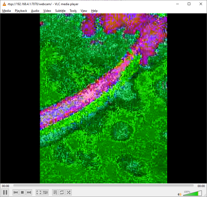

    im getting close(r) with SP0828 driver.
    Distorted webcam feed with dominant green, pink, and purple colors
    Can I trouble you for your backup of TXW when you get to that point?

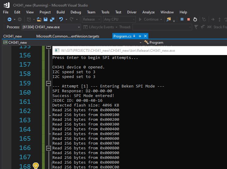

    Currently I'm trying to make a better SPI flasher for them so development is easier:

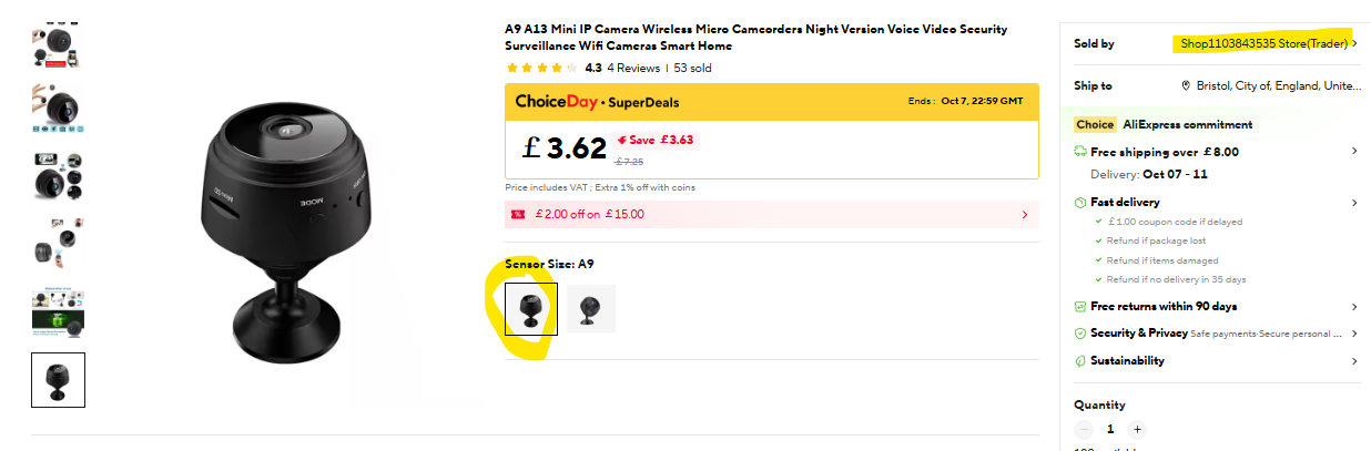

    Yes! Do a flash backup!
    (also pls include screenshot from alie because this link will expire probably relatively soon)
  • #90 21708767
    Posts: 5020
    Help: 438
    Rate: 891
    always
    added

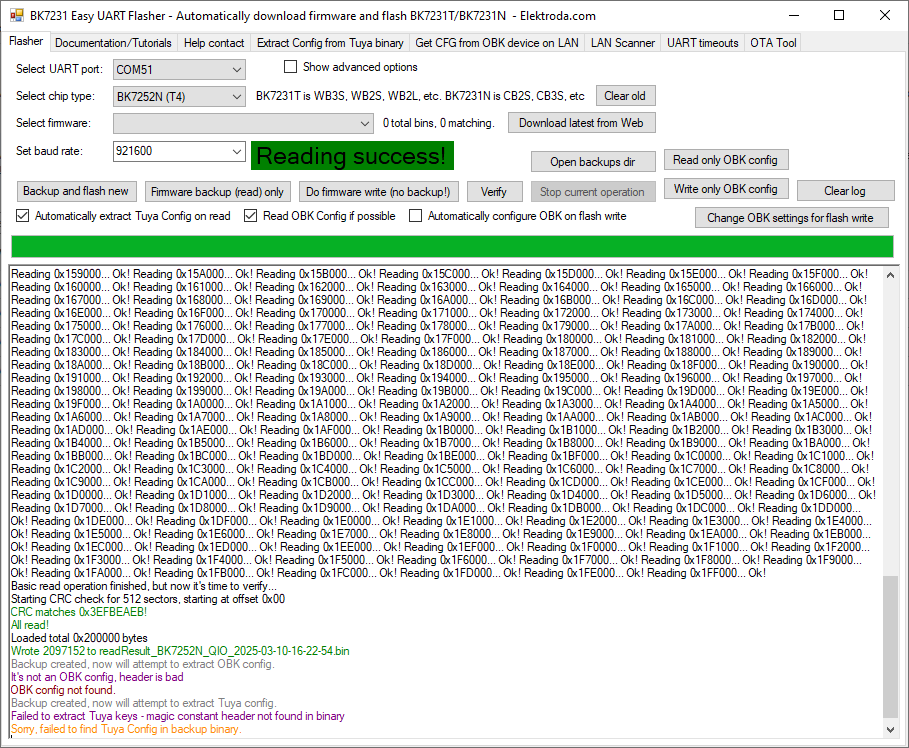

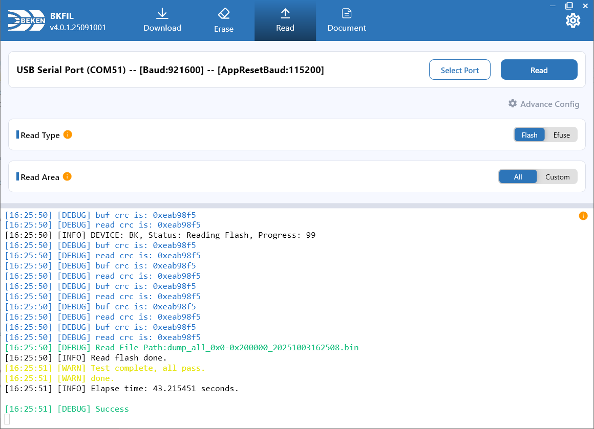

    >>21708747
    another Linklemo/XCThings device.
    Successful data read from BK7252N chip using BK7231 Easy UART Flasher tool
    Spoiler:
    Backup name has not been set, so output file will only contain flash type/date.
    Starting read!
    Read parms: start 0x00 (sector 0), len 0x200000 (0 sectors)
    Now is: 03 October 2025 16:22:15.
    Flasher mode: BK7252N
    Going to open port: COM51.
    Serial port open!
    Getting bus... (now, please do reboot by CEN or by power off/on)
    Getting bus success!
    Going to set baud rate setting (921600)!
    Will try to read device flash MID (for unprotect N):
    Flash MID loaded: 1560EB
    Will now search for Flash def in out database...
    Flash def found! For: 1560EB
    Flash information: mid: 1560EB, icName: TH25Q16HB, manufacturer: TH, szMem: 200000, szSR: 2, cwUnp: 0, cwEnp: 7, cwMsk: 407C, sb: 2, lb: 5, cwdRd: 05-35-FF-FF, cwdWr: 01-FF-FF-FF
    Flash size is 2MB
    Entering SetProtectState(True)...
    sr: 0
    sr: 0
    final sr: 0
    msk: 407c
    cw: 0, sb: 2, lb: 5
    bfd: 0
    SetProtectState(True) success!
    Going to start reading at offset 0x00...
    Reading 0x00... Ok! Reading 0x1000... Ok! Reading 0x2000... Ok! Reading 0x3000... Ok! Reading 0x4000... Ok! Reading 0x5000... Ok! Reading 0x6000... Ok! Reading 0x7000... Ok! Reading 0x8000... Ok! Reading 0x9000... Ok! Reading 0xA000... Ok! Reading 0xB000... Ok! Reading 0xC000... Ok! Reading 0xD000... Ok! Reading 0xE000... Ok! Reading 0xF000... Ok! Reading 0x10000... Ok! Reading 0x11000... Ok! Reading 0x12000... Ok! Reading 0x13000... Ok! Reading 0x14000... Ok! Reading 0x15000... Ok! Reading 0x16000... Ok! Reading 0x17000... Ok! Reading 0x18000... Ok! Reading 0x19000... Ok! Reading 0x1A000... Ok! Reading 0x1B000... Ok! Reading 0x1C000... Ok! Reading 0x1D000... Ok! Reading 0x1E000... Ok! Reading 0x1F000... Ok! Reading 0x20000... Ok! Reading 0x21000... Ok! Reading 0x22000... Ok! Reading 0x23000... Ok! Reading 0x24000... Ok! Reading 0x25000... Ok! Reading 0x26000... Ok! Reading 0x27000... Ok! Reading 0x28000... Ok! Reading 0x29000... Ok! Reading 0x2A000... Ok! Reading 0x2B000... Ok! Reading 0x2C000... Ok! Reading 0x2D000... Ok! Reading 0x2E000... Ok! Reading 0x2F000... Ok! Reading 0x30000... Ok! Reading 0x31000... Ok! Reading 0x32000... Ok! Reading 0x33000... Ok! Reading 0x34000... Ok! Reading 0x35000... Ok! Reading 0x36000... Ok! Reading 0x37000... Ok! Reading 0x38000... Ok! Reading 0x39000... Ok! Reading 0x3A000... Ok! Reading 0x3B000... Ok! Reading 0x3C000... Ok! Reading 0x3D000... Ok! Reading 0x3E000... Ok! Reading 0x3F000... Ok! Reading 0x40000... Ok! Reading 0x41000... Ok! Reading 0x42000... Ok! Reading 0x43000... Ok! Reading 0x44000... Ok! Reading 0x45000... Ok! Reading 0x46000... Ok! Reading 0x47000... Ok! Reading 0x48000... Ok! Reading 0x49000... Ok! Reading 0x4A000... Ok! Reading 0x4B000... Ok! Reading 0x4C000... Ok! Reading 0x4D000... Ok! Reading 0x4E000... Ok! Reading 0x4F000... Ok! Reading 0x50000... Ok! Reading 0x51000... Ok! Reading 0x52000... Ok! Reading 0x53000... Ok! Reading 0x54000... Ok! Reading 0x55000... Ok! Reading 0x56000... Ok! Reading 0x57000... Ok! Reading 0x58000... Ok! Reading 0x59000... Ok! Reading 0x5A000... Ok! Reading 0x5B000... Ok! Reading 0x5C000... Ok! Reading 0x5D000... Ok! Reading 0x5E000... Ok! Reading 0x5F000... Ok! Reading 0x60000... Ok! Reading 0x61000... Ok! Reading 0x62000... Ok! Reading 0x63000... Ok! Reading 0x64000... Ok! Reading 0x65000... Ok! Reading 0x66000... Ok! Reading 0x67000... Ok! Reading 0x68000... Ok! Reading 0x69000... Ok! Reading 0x6A000... Ok! Reading 0x6B000... Ok! Reading 0x6C000... Ok! Reading 0x6D000... Ok! Reading 0x6E000... Ok! Reading 0x6F000... Ok! Reading 0x70000... Ok! Reading 0x71000... Ok! Reading 0x72000... Ok! Reading 0x73000... Ok! Reading 0x74000... Ok! Reading 0x75000... Ok! Reading 0x76000... Ok! Reading 0x77000... Ok! Reading 0x78000... Ok! Reading 0x79000... Ok! Reading 0x7A000... Ok! Reading 0x7B000... Ok! Reading 0x7C000... Ok! Reading 0x7D000... Ok! Reading 0x7E000... Ok! Reading 0x7F000... Ok! Reading 0x80000... Ok! Reading 0x81000... Ok! Reading 0x82000... Ok! Reading 0x83000... Ok! Reading 0x84000... Ok! Reading 0x85000... Ok! Reading 0x86000... Ok! Reading 0x87000... Ok! Reading 0x88000... Ok! Reading 0x89000... Ok! Reading 0x8A000... Ok! Reading 0x8B000... Ok! Reading 0x8C000... Ok! Reading 0x8D000... Ok! Reading 0x8E000... Ok! Reading 0x8F000... Ok! Reading 0x90000... Ok! Reading 0x91000... Ok! Reading 0x92000... Ok! Reading 0x93000... Ok! Reading 0x94000... Ok! Reading 0x95000... Ok! Reading 0x96000... Ok! Reading 0x97000... Ok! Reading 0x98000... Ok! Reading 0x99000... Ok! Reading 0x9A000... Ok! Reading 0x9B000... Ok! Reading 0x9C000... Ok! Reading 0x9D000... Ok! Reading 0x9E000... Ok! Reading 0x9F000... Ok! Reading 0xA0000... Ok! Reading 0xA1000... Ok! Reading 0xA2000... Ok! Reading 0xA3000... Ok! Reading 0xA4000... Ok! Reading 0xA5000... Ok! Reading 0xA6000... Ok! Reading 0xA7000... Ok! Reading 0xA8000... Ok! Reading 0xA9000... Ok! Reading 0xAA000... Ok! Reading 0xAB000... Ok! Reading 0xAC000... Ok! Reading 0xAD000... Ok! Reading 0xAE000... Ok! Reading 0xAF000... Ok! Reading 0xB0000... Ok! Reading 0xB1000... Ok! Reading 0xB2000... Ok! Reading 0xB3000... Ok! Reading 0xB4000... Ok! Reading 0xB5000... Ok! Reading 0xB6000... Ok! Reading 0xB7000... Ok! Reading 0xB8000... Ok! Reading 0xB9000... Ok! Reading 0xBA000... Ok! Reading 0xBB000... Ok! Reading 0xBC000... Ok! Reading 0xBD000... Ok! Reading 0xBE000... Ok! Reading 0xBF000... Ok! Reading 0xC0000... Ok! Reading 0xC1000... Ok! Reading 0xC2000... Ok! Reading 0xC3000... Ok! Reading 0xC4000... Ok! Reading 0xC5000... Ok! Reading 0xC6000... Ok! Reading 0xC7000... Ok! Reading 0xC8000... Ok! Reading 0xC9000... Ok! Reading 0xCA000... Ok! Reading 0xCB000... Ok! Reading 0xCC000... Ok! Reading 0xCD000... Ok! Reading 0xCE000... Ok! Reading 0xCF000... Ok! Reading 0xD0000... Ok! Reading 0xD1000... Ok! Reading 0xD2000... Ok! Reading 0xD3000... Ok! Reading 0xD4000... Ok! Reading 0xD5000... Ok! Reading 0xD6000... Ok! Reading 0xD7000... Ok! Reading 0xD8000... Ok! Reading 0xD9000... Ok! Reading 0xDA000... Ok! Reading 0xDB000... Ok! Reading 0xDC000... Ok! Reading 0xDD000... Ok! Reading 0xDE000... Ok! Reading 0xDF000... Ok! Reading 0xE0000... Ok! Reading 0xE1000... Ok! Reading 0xE2000... Ok! Reading 0xE3000... Ok! Reading 0xE4000... Ok! Reading 0xE5000... Ok! Reading 0xE6000... Ok! Reading 0xE7000... Ok! Reading 0xE8000... Ok! Reading 0xE9000... Ok! Reading 0xEA000... Ok! Reading 0xEB000... Ok! Reading 0xEC000... Ok! Reading 0xED000... Ok! Reading 0xEE000... Ok! Reading 0xEF000... Ok! Reading 0xF0000... Ok! Reading 0xF1000... Ok! Reading 0xF2000... Ok! Reading 0xF3000... Ok! Reading 0xF4000... Ok! Reading 0xF5000... Ok! Reading 0xF6000... Ok! Reading 0xF7000... Ok! Reading 0xF8000... Ok! Reading 0xF9000... Ok! Reading 0xFA000... Ok! Reading 0xFB000... Ok! Reading 0xFC000... Ok! Reading 0xFD000... Ok! Reading 0xFE000... Ok! Reading 0xFF000... Ok! Reading 0x100000... Ok! Reading 0x101000... Ok! Reading 0x102000... Ok! Reading 0x103000... Ok! Reading 0x104000... Ok! Reading 0x105000... Ok! Reading 0x106000... Ok! Reading 0x107000... Ok! Reading 0x108000... Ok! Reading 0x109000... Ok! Reading 0x10A000... Ok! Reading 0x10B000... Ok! Reading 0x10C000... Ok! Reading 0x10D000... Ok! Reading 0x10E000... Ok! Reading 0x10F000... Ok! Reading 0x110000... Ok! Reading 0x111000... Ok! Reading 0x112000... Ok! Reading 0x113000... Ok! Reading 0x114000... Ok! Reading 0x115000... Ok! Reading 0x116000... Ok! Reading 0x117000... Ok! Reading 0x118000... Ok! Reading 0x119000... Ok! Reading 0x11A000... Ok! Reading 0x11B000... Ok! Reading 0x11C000... Ok! Reading 0x11D000... Ok! Reading 0x11E000... Ok! Reading 0x11F000... Ok! Reading 0x120000... Ok! Reading 0x121000... Ok! Reading 0x122000... Ok! Reading 0x123000... Ok! Reading 0x124000... Ok! Reading 0x125000... Ok! Reading 0x126000... Ok! Reading 0x127000... Ok! Reading 0x128000... Ok! Reading 0x129000... Ok! Reading 0x12A000... Ok! Reading 0x12B000... Ok! Reading 0x12C000... Ok! Reading 0x12D000... Ok! Reading 0x12E000... Ok! Reading 0x12F000... Ok! Reading 0x130000... Ok! Reading 0x131000... Ok! Reading 0x132000... Ok! Reading 0x133000... Ok! Reading 0x134000... Ok! Reading 0x135000... Ok! Reading 0x136000... Ok! Reading 0x137000... Ok! Reading 0x138000... Ok! Reading 0x139000... Ok! Reading 0x13A000... Ok! Reading 0x13B000... Ok! Reading 0x13C000... Ok! Reading 0x13D000... Ok! Reading 0x13E000... Ok! Reading 0x13F000... Ok! Reading 0x140000... Ok! Reading 0x141000... Ok! Reading 0x142000... Ok! Reading 0x143000... Ok! Reading 0x144000... Ok! Reading 0x145000... Ok! Reading 0x146000... Ok! Reading 0x147000... Ok! Reading 0x148000... Ok! Reading 0x149000... Ok! Reading 0x14A000... Ok! Reading 0x14B000... Ok! Reading 0x14C000... Ok! Reading 0x14D000... Ok! Reading 0x14E000... Ok! Reading 0x14F000... Ok! Reading 0x150000... Ok! Reading 0x151000... Ok! Reading 0x152000... Ok! Reading 0x153000... Ok! Reading 0x154000... Ok! Reading 0x155000... Ok! Reading 0x156000... Ok! Reading 0x157000... Ok! Reading 0x158000... Ok! Reading 0x159000... Ok! Reading 0x15A000... Ok! Reading 0x15B000... Ok! Reading 0x15C000... Ok! Reading 0x15D000... Ok! Reading 0x15E000... Ok! Reading 0x15F000... Ok! Reading 0x160000... Ok! Reading 0x161000... Ok! Reading 0x162000... Ok! Reading 0x163000... Ok! Reading 0x164000... Ok! Reading 0x165000... Ok! Reading 0x166000... Ok! Reading 0x167000... Ok! Reading 0x168000... Ok! Reading 0x169000... Ok! Reading 0x16A000... Ok! Reading 0x16B000... Ok! Reading 0x16C000... Ok! Reading 0x16D000... Ok! Reading 0x16E000... Ok! Reading 0x16F000... Ok! Reading 0x170000... Ok! Reading 0x171000... Ok! Reading 0x172000... Ok! Reading 0x173000... Ok! Reading 0x174000... Ok! Reading 0x175000... Ok! Reading 0x176000... Ok! Reading 0x177000... Ok! Reading 0x178000... Ok! Reading 0x179000... Ok! Reading 0x17A000... Ok! Reading 0x17B000... Ok! Reading 0x17C000... Ok! Reading 0x17D000... Ok! Reading 0x17E000... Ok! Reading 0x17F000... Ok! Reading 0x180000... Ok! Reading 0x181000... Ok! Reading 0x182000... Ok! Reading 0x183000... Ok! Reading 0x184000... Ok! Reading 0x185000... Ok! Reading 0x186000... Ok! Reading 0x187000... Ok! Reading 0x188000... Ok! Reading 0x189000... Ok! Reading 0x18A000... Ok! Reading 0x18B000... Ok! Reading 0x18C000... Ok! Reading 0x18D000... Ok! Reading 0x18E000... Ok! Reading 0x18F000... Ok! Reading 0x190000... Ok! Reading 0x191000... Ok! Reading 0x192000... Ok! Reading 0x193000... Ok! Reading 0x194000... Ok! Reading 0x195000... Ok! Reading 0x196000... Ok! Reading 0x197000... Ok! Reading 0x198000... Ok! Reading 0x199000... Ok! Reading 0x19A000... Ok! Reading 0x19B000... Ok! Reading 0x19C000... Ok! Reading 0x19D000... Ok! Reading 0x19E000... Ok! Reading 0x19F000... Ok! Reading 0x1A0000... Ok! Reading 0x1A1000... Ok! Reading 0x1A2000... Ok! Reading 0x1A3000... Ok! Reading 0x1A4000... Ok! Reading 0x1A5000... Ok! Reading 0x1A6000... Ok! Reading 0x1A7000... Ok! Reading 0x1A8000... Ok! Reading 0x1A9000... Ok! Reading 0x1AA000... Ok! Reading 0x1AB000... Ok! Reading 0x1AC000... Ok! Reading 0x1AD000... Ok! Reading 0x1AE000... Ok! Reading 0x1AF000... Ok! Reading 0x1B0000... Ok! Reading 0x1B1000... Ok! Reading 0x1B2000... Ok! Reading 0x1B3000... Ok! Reading 0x1B4000... Ok! Reading 0x1B5000... Ok! Reading 0x1B6000... Ok! Reading 0x1B7000... Ok! Reading 0x1B8000... Ok! Reading 0x1B9000... Ok! Reading 0x1BA000... Ok! Reading 0x1BB000... Ok! Reading 0x1BC000... Ok! Reading 0x1BD000... Ok! Reading 0x1BE000... Ok! Reading 0x1BF000... Ok! Reading 0x1C0000... Ok! Reading 0x1C1000... Ok! Reading 0x1C2000... Ok! Reading 0x1C3000... Ok! Reading 0x1C4000... Ok! Reading 0x1C5000... Ok! Reading 0x1C6000... Ok! Reading 0x1C7000... Ok! Reading 0x1C8000... Ok! Reading 0x1C9000... Ok! Reading 0x1CA000... Ok! Reading 0x1CB000... Ok! Reading 0x1CC000... Ok! Reading 0x1CD000... Ok! Reading 0x1CE000... Ok! Reading 0x1CF000... Ok! Reading 0x1D0000... Ok! Reading 0x1D1000... Ok! Reading 0x1D2000... Ok! Reading 0x1D3000... Ok! Reading 0x1D4000... Ok! Reading 0x1D5000... Ok! Reading 0x1D6000... Ok! Reading 0x1D7000... Ok! Reading 0x1D8000... Ok! Reading 0x1D9000... Ok! Reading 0x1DA000... Ok! Reading 0x1DB000... Ok! Reading 0x1DC000... Ok! Reading 0x1DD000... Ok! Reading 0x1DE000... Ok! Reading 0x1DF000... Ok! Reading 0x1E0000... Ok! Reading 0x1E1000... Ok! Reading 0x1E2000... Ok! Reading 0x1E3000... Ok! Reading 0x1E4000... Ok! Reading 0x1E5000... Ok! Reading 0x1E6000... Ok! Reading 0x1E7000... Ok! Reading 0x1E8000... Ok! Reading 0x1E9000... Ok! Reading 0x1EA000... Ok! Reading 0x1EB000... Ok! Reading 0x1EC000... Ok! Reading 0x1ED000... Ok! Reading 0x1EE000... Ok! Reading 0x1EF000... Ok! Reading 0x1F0000... Ok! Reading 0x1F1000... Ok! Reading 0x1F2000... Ok! Reading 0x1F3000... Ok! Reading 0x1F4000... Ok! Reading 0x1F5000... Ok! Reading 0x1F6000... Ok! Reading 0x1F7000... Ok! Reading 0x1F8000... Ok! Reading 0x1F9000... Ok! Reading 0x1FA000... Ok! Reading 0x1FB000... Ok! Reading 0x1FC000... Ok! Reading 0x1FD000... Ok! Reading 0x1FE000... Ok! Reading 0x1FF000... Ok!
    Basic read operation finished, but now it's time to verify...
    Starting CRC check for 512 sectors, starting at offset 0x00
    CRC matches 0x3EFBEAEB!
    All read!
    Loaded total 0x200000 bytes
    Wrote 2097152 to readResult_BK7252N_QIO_2025-03-10-16-22-54.bin
    Backup created, now will attempt to extract OBK config.
    It's not an OBK config, header is bad
    OBK config not found.
    Backup created, now will attempt to extract Tuya config.
    Failed to extract Tuya keys - magic constant header not found in binary
    Sorry, failed to find Tuya Config in backup binary.
    Screenshot of BKFIL software reading flash memory from a USB-connected device
