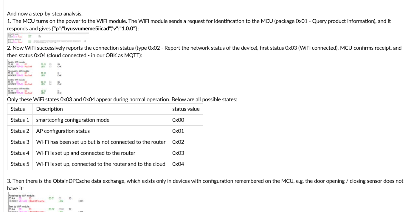

    Almost, but not exactly. I know it's inconvenient, because I went through this when doing previous TuyaMCu topics, including this presentation:
    [CB3S/BK7231N] Temperature/Humidity Sensor with TuyaMCU - Diagram, Reverse Engin
    but you need to manually order those packets. Our Analyzer tool is not quick enough to maintain order.
    You can use information from article linked above, especially this paragraph:
    Experience? / ONENUO 228WTH Smoke Detector with Temp/Humidity: OBK Flashing, Chip Info, Battery Life
    Honestly I don't even remember myself this protocol well at the moment, but it is also described on Tuya site, I'll attach the link if I find it.
    So, the basic workflow for solving your issue would be:
    1. create a clearly described, step by step log of communication with TuyaMCU on Tuya device - but not unsorted, like you posted
    2. create the same for OBK
    3. Figure out exactly at which point of time communication breaks, i.e. which exactly packet is sent by OBK incorrectly
  • #32 21590469

    Those packets in PDFs are sorted?
    So you are saying that OBK is not sending
    55 AA 00 02 00 01 02 04
    HEADER VER=00 McuConf LEN 02 CHK
    Maybe we can also ping @DeDaMrAz , he was creating the previous battery powered guide with me

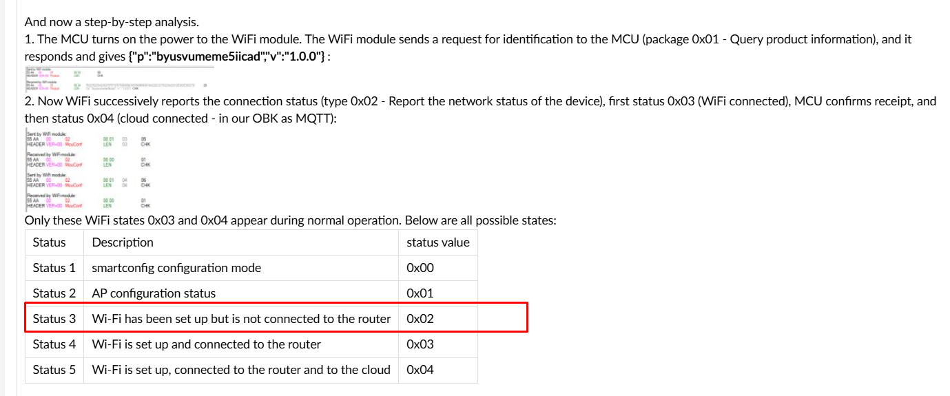

    >>21599574 As far as I can tell they are sorted from start to end. I monitored traffic with Real-Term. Wonder how one message could possibly overtake the following anyway.
    Exactly, I looks to me, like the mcuconf 02 message is missing, only 03 and 04 are present.
    I understand that investing time in inefficent devices is questionable. So, don't invest too much. I'll order a Zigbee gateway the next days and hope to cause less trouble then ;-)

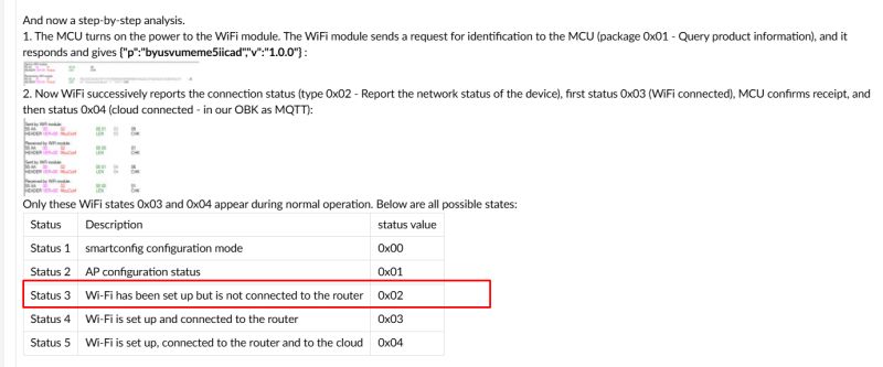

    but if the MCUconf with 0x02 status is missing, it just means that OBK (?) reports a quicker connection:
    I'm not sure if it can be the issue. Maybe there is a futher difference down in the exchange? For example, in dpCache?

    You're probably right. I did set Flag 37 + 51, so it should do a fast connect.
    What about the message "Info:TuyaMCU:ProcessIncoming: TUYA_CMD_MCU_CONF, TODO!" in the logs?
  • #41 21599930
    Posts: 14567
    Help: 654
    Rate: 12578
    I've looked at the code and it seems implemented, probably message can be removed.
