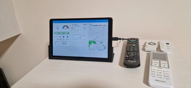

    Have an old tablet that's been sitting in a drawer for years collecting dust? Give it a second life and turn it into a control panel for the Home Assistant - the mini project shown here is very simple, and gives you full control over your own home automation. You don't even need a dedicated app - a simple web browser will do. I will show here in practice what this can look like.
    The starting point is a working touchscreen tablet. Probably many of us have one that is either already too weak for today's applications or, for example, has problems with the range or the cell inside. Already at this stage we have 90% of the fun ready to go. We used the Samsung Tab A10 (SM-T510) for the presentation.
    Now all that's left to do, according to preference, is to disable or select screen blanking in the settings, log in to our HA panel and place the link on the desktop and prepare the power station. You can use a 3D printer for this:
    Touch control panel for Home Assistant - how to use an old tablet? Simple mini DIY .

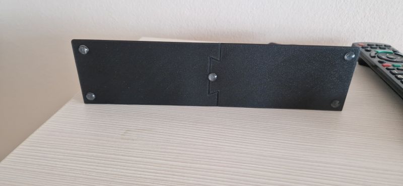

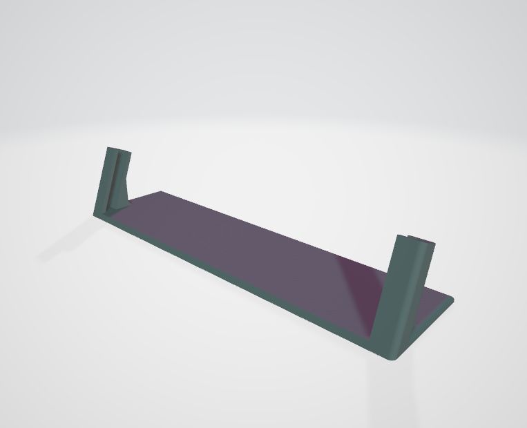

    Depending on our taste, we can choose a wall mount or a stand on a table or desk. In the case of a desk stand, the legs will also be useful:
    At this stage we already have a virtually finished project, although here you can still think about optimising the cabling and buy at least an angled USB connector, or you can even go a step further and plug in the power supply from the back of the tablet. This, of course, only if you feel up to opening it up and reworking it.
    The end result depends on what we set ourselves on the Dashboard and Home Assistant views, below are examples from us:

The discussion describes a simple DIY way to repurpose an old Android tablet as a Home Assistant touch control panel using only a web browser or dedicated kiosk app. The main setup involves disabling screen blanking, pinning the HA dashboard to the home screen, and powering the tablet continuously or through automation. Participants compare different tablets and Android versions, noting that older devices often fail because modern Home Assistant pages depend on newer WebView/browser support. Several solutions are proposed for kiosk operation and power management, including Fully Kiosk Browser, WallPanel, Chrome, smart sockets, PIR-triggered power cycling, battery-level automations, and root-based charging control via Magisk/ACC. Mounting methods are also discussed, such as wall brackets, magnetic docks, angled USB plugs, and using a tablet case frame. The thread also covers battery wear, charging limits, and alternatives like replacing cells or using external power control to prevent swelling and extend device life.
TL;DR: Re-using a tablet cuts e-waste by 1 kg per unit and takes under 15 minutes; “Don’t throw it away — use it” [Elektroda, gulson, post #21583732] Android 5+ plus a fresh WebView fixes 90 % of loading issues [Elektroda, Sp33di, post #21583694]
Why it matters: You gain a constantly-on smart-home dashboard for near-zero cost instead of buying a $100 display.
• Minimum Android version: 5.0 (Lollipop) with updated Android WebView ≥ ver. 119 [Elektroda, Sp33di, post #21583694] • Ideal charge window: 20 %–80 % to slow capacity loss by ≈20 % per year [Elektroda, gulson, post #21583732] • Continuous draw: tablets peak at 3–5 A when the screen wakes [Elektroda, chemik_16, post #21584627] • 3-D printed mounts cost approx. $5–$15, STLs are free [Thingiverse Pricing, 2025] • Fully Kiosk licence: €7 one-time; free version shows a watermark [Fully Kiosk Docs, 2025]
How do I turn an old Android tablet into a Home Assistant control panel?
  1. Disable screen timeout in Android settings.
  2. Open your HA URL in Chrome or a kiosk app.
  3. Add the page to Home Screen so it autoloads. The process takes under 15 min [Elektroda, p.kaczmarek2, post #21583474]
