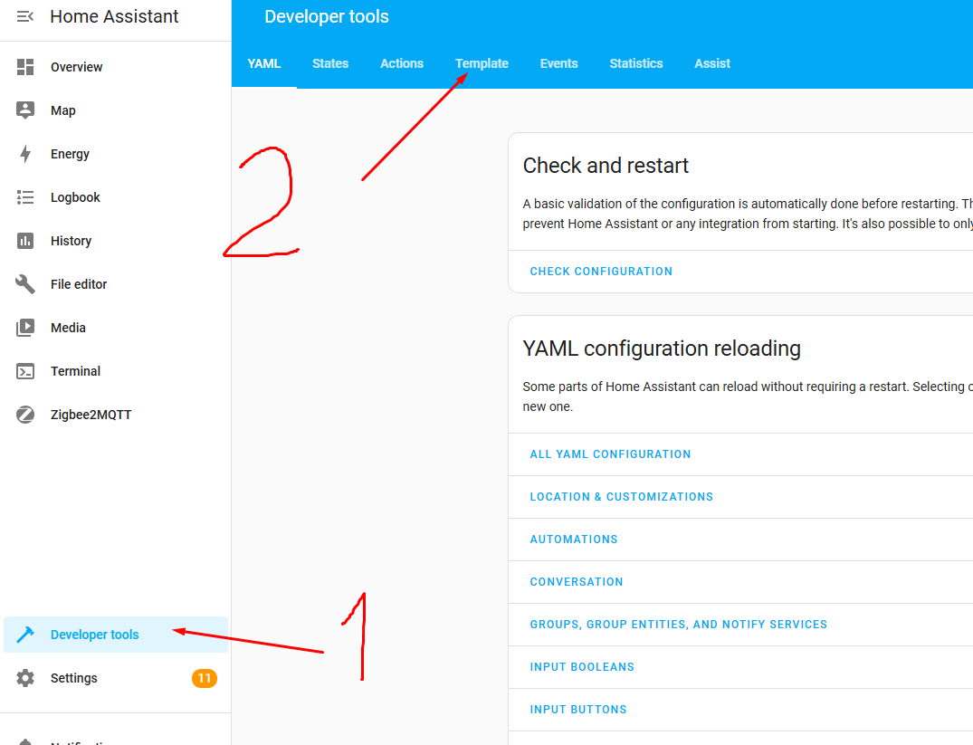

    Home Assistant's graphical interface is based on the powerful Jinja2 template language. Jinja2 is used to process sensor data, create conditions in automations or dynamically format messages. To make working with Jinja2 easier, Home Assistant offers a convenient Template Editor tool in which you can live preview and test the templates. Here, I will briefly introduce this tool and then show a dozen examples of what the templates allow you to do.
    The Template Editor is available under Developer Tools in the Template menu:
    How do I create and test templates for Home Assistant? Jinja2, Developer Tools and Template .

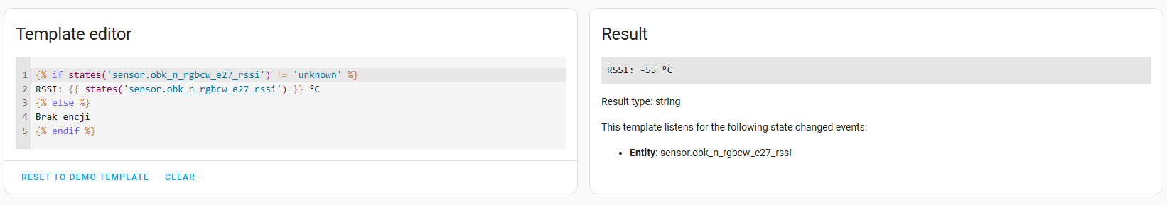

    When it opens, we are greeted by two columns - the template's source code and its live preview in HA:

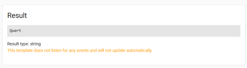

    The preview updates itself - you don't need to save anything, what you type on the left you get on the right.

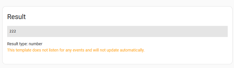

    1. Reading entity values 2.
    Let's start with the simplest thing, i.e. taking the value of some sensor. Such a sensor, of course, must already be paired with the HA, e.g. via Hass Discovery or via Zigbee.
    Example:
    Code: text
    This entry will return the current value of sensor.temperature. If the entity does not exist or something has gone wrong, it will not show an error - it will just return 'unknown'.

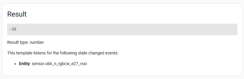

    This is how you can get at many values - for example, RSSI from OBK:
    Code: text

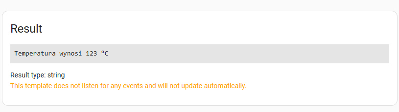

    The presence of a unit and rounding can also be specified in the states call:
    Code: text
    This will return the temperature with °C.

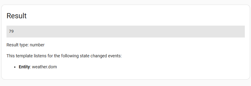

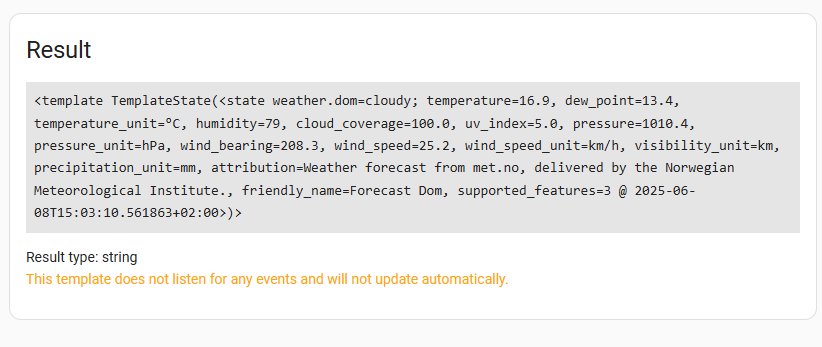

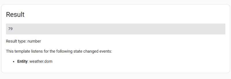

    2. Entity attributes .
    Sometimes, however, the entity value alone is not enough, e.g. in weather the humidity or cloudiness state comes in handy. This is no longer states(), but state_attr():
    Code: text
    Result:
    For debugging purposes, the entire house entity can also be previewed:
    Code: text

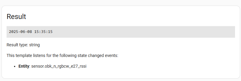

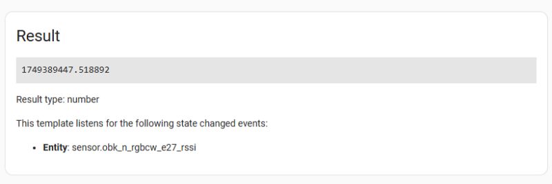

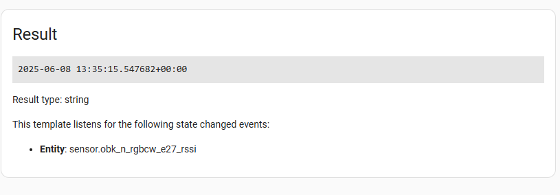

    4. When the entity was last changed .
    Sometimes we want to check when an entity last changed its state - for example, when a door was opened. This is what the last_changed property is used for.

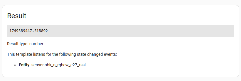

    The easiest way is to extract the raw timestamp:
    Code: text
    How do I create and test templates for Home Assistant? Jinja2, Developer Tools and Template.
    If instead of a number in seconds we prefer something more readable - full date and time:
    Code: text

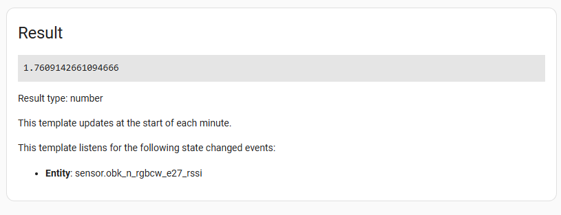

    5. Counting time .
    Similarly, you can count how long ago an event happened - simply subtract timestamps. Used now() and as_timestamp():
    Code: text
    This returns how many minutes ago there was traffic, rounded to one decimal place.

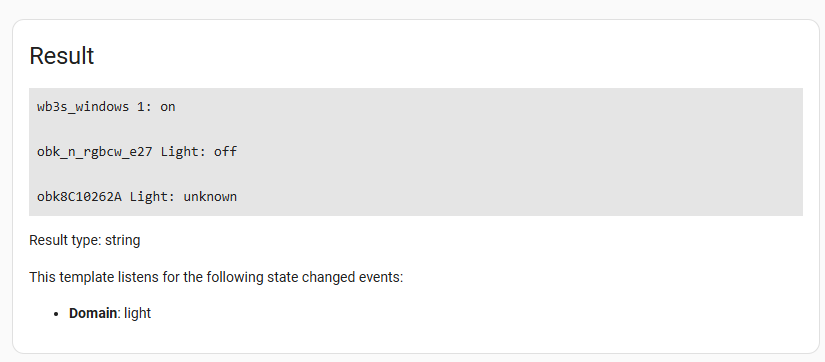

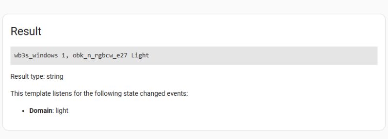

    6. Loops - for and in .
    Jinja2 also allows you to fly through a list, such as entities of a given type. Such a template lists all the lights and their states:
    Code: text
    If you only want the ones that are included - it is possible to add a condition in the same loop:
    Code: text
    This is useful for e.g. notifications, automations or for debugging system status without clicking through the interface.

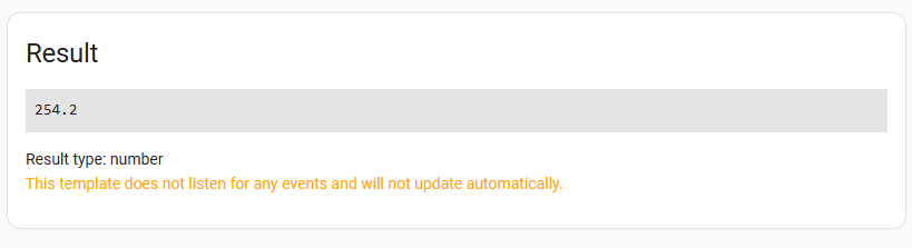

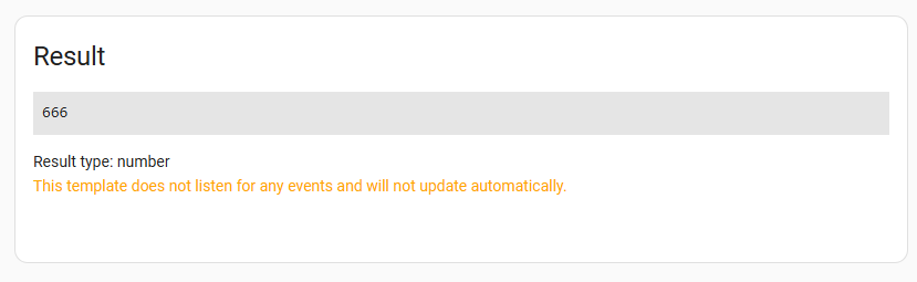

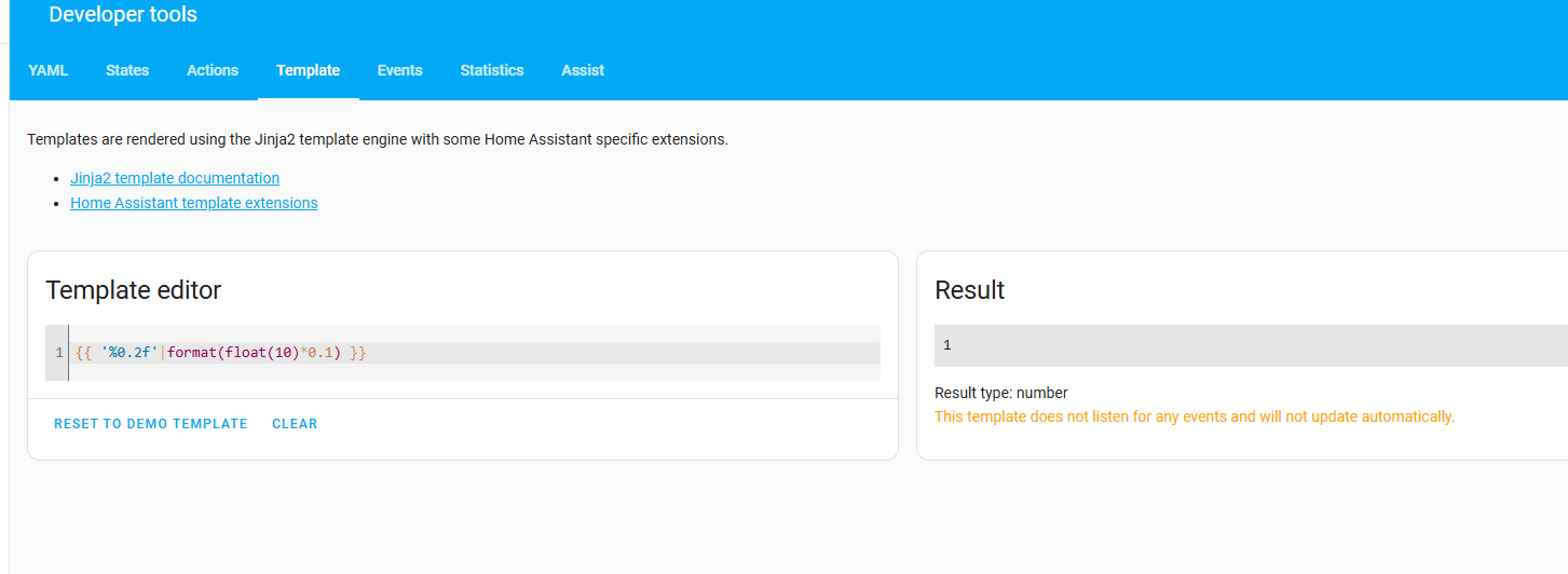

    7. Mathematical operations .
    In Jinja2, you can perform various mathematical operations directly in the templates. For example, if you want to convert the temperature from Celsius to Fahrenheit, just add a simple formula:
    Code: text
    The result will be rounded to one decimal place thanks to the round() filter.

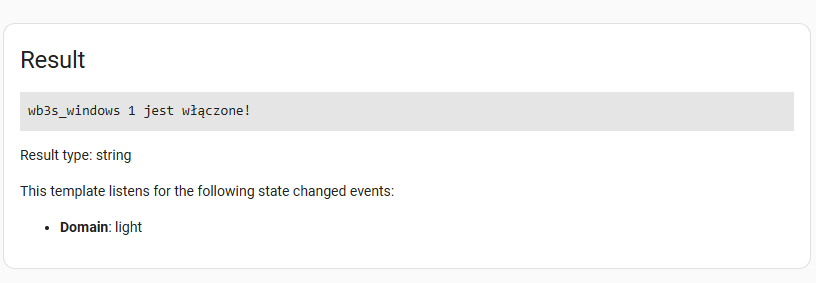

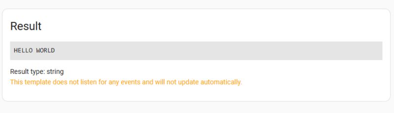

    8. Text operations .

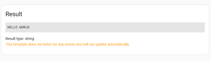

    You can also use filters to manipulate text, such as changing the case of letters:
    Code: text
    This is useful for standardising text in messages or displaying them in a particular format.

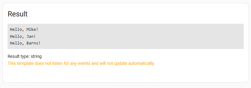

    Often you need to combine values from different entities or add your own messages. Jinja2 allows you to do this via the ~ operator:
    Code: text

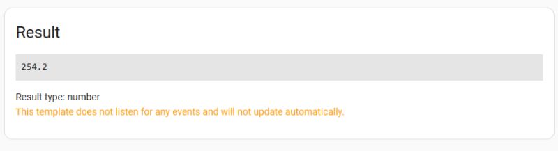

    9. List handling and data filtering .
    Jinja2 allows advanced work with lists. For example, if you want to collect the names of all enabled lights in one comma-separated line, you can use a template like this:
    Code: text
    This is a combination of filters: selectattr selects elements with the given attribute, map retrieves the selected attribute (here the name), and join merges the list into a single text.

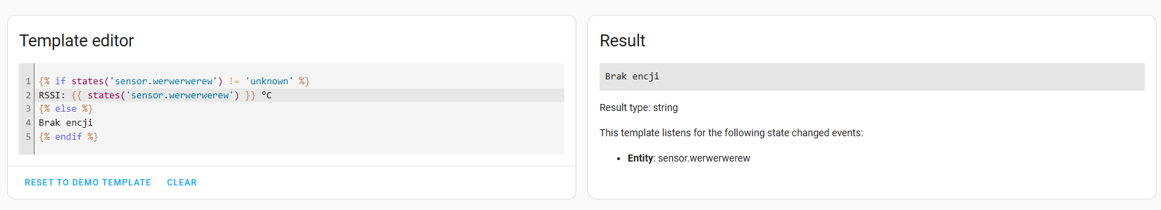

    10. Checking entity availability .
    To make sure the entity exists before using it:
    Code: text
    This template checks that the sensor.temperature entity is available and does not return the value 'unknown'.

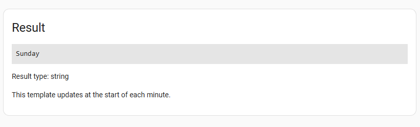

    11. Displaying the full name of the day of the week
    To get the full name of the day of the week:
    Code: text
    The strftime('%A') function returns the full name of the day of the week, e.g. 'Sunday'.

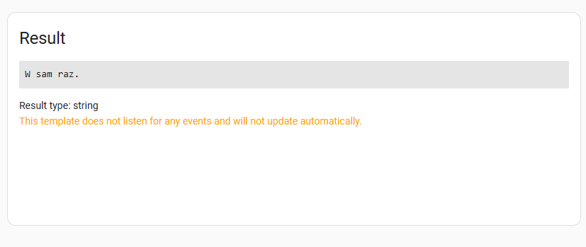

    12. Macros (reusable) .
    It is also possible to define a macro which can then be used repeatedly:
    Code: text
    Result:
