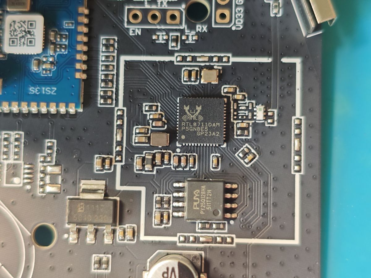

    insmod wrote:
    RTL8721DAx/RTL8721DCx/RTL8721DGx (all amebadplus) if F - 4mb integrated, if M - external.
    dual-band mulit-mode gateway has arrived. here's an M with external flash in the flesh
    Creating a simple BW16E (RTL8720DN) DIY flash tool command line utility
    should probably do a new topic for it
    do you plan support in EF @insmod ?

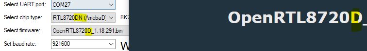

    RTL8720DN chip type in EF should be renamed to RTL8720D to match OBK release and filenames like how the other platforms do?
    Screenshot of OpenRTL8720D showing COM27 UART port and 921600 baud rate settings

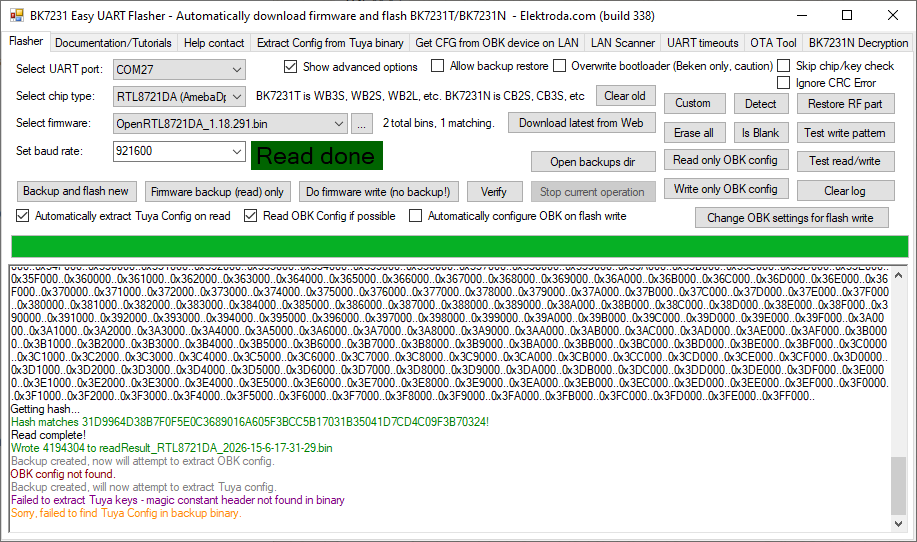

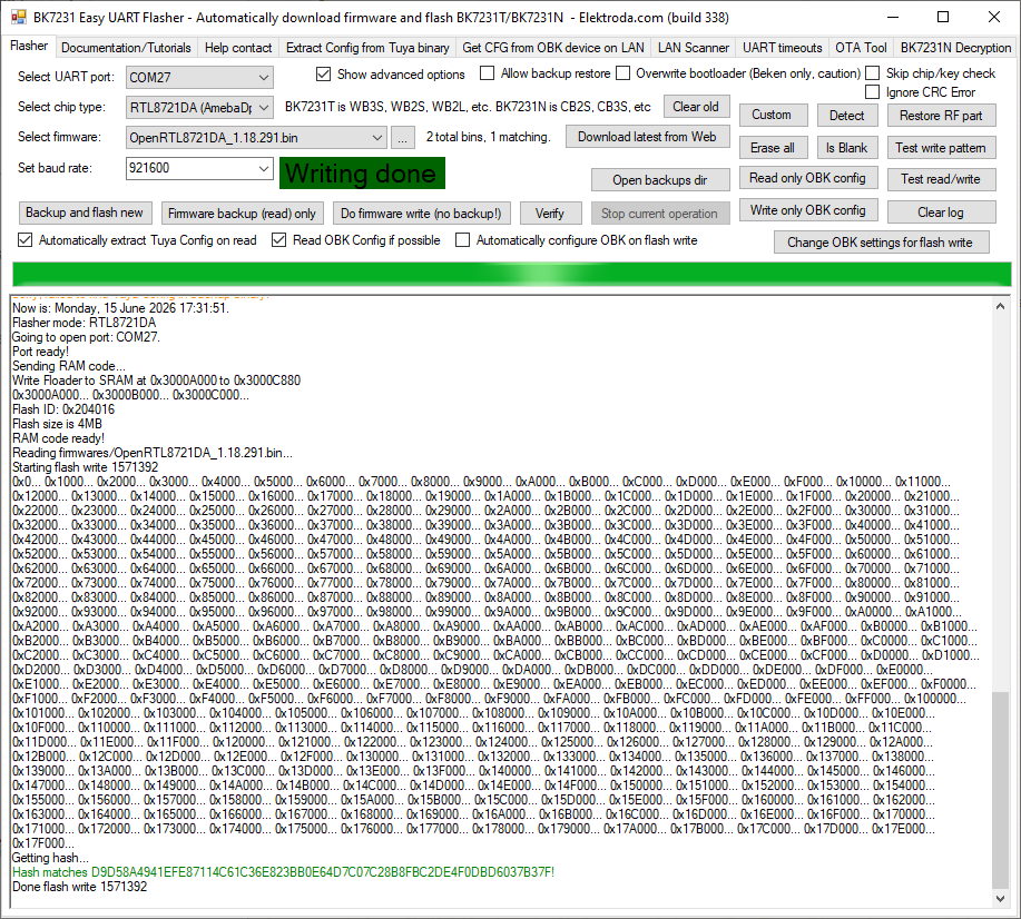

    insmod wrote:
    RTL8721DA
    Screenshot of BK7231 Easy UART Flasher showing “Read done” and a firmware read log in hexadecimal. Screenshot of BK7231 Easy UART Flasher showing “Writing done” and a flashing log.
