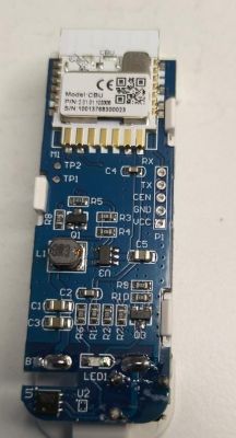

    Which bytes can change between reboots?
  • #32 21622233
    Posts: 5073
    Help: 441
    Rate: 898
    Well. I dunno but when I kept it in boot mode between dumps, so no app boot, the bytes were identical.
    Added after 25 [minutes]:
    I'll do read tests again. If that user's device didn't boot up in between then that would be an issue
  • #33 21622289
    Posts: 14631
    Help: 655
    Rate: 12647
    But the read does CRC check, as implemented by @insmod. So there should be no errors...
  • #34 21622390
    Posts: 5073
    Help: 441
    Rate: 898
    to remove any doubt:
    Tuya_3.5.4_FEIT_Chasing_FETAP20CAN_(schemaID-fxxrjk)_LN882H_1.0.18.bin to blank LN882H
    115200 - done in 184.0235767s
    230400 - done in 92.9656231s
    460800 - done in 47.4550467s
    921600 - done in 24.7300339s
    A9 low throughout
    Dialog box with message “The chosen files are identical” and “OK” button
