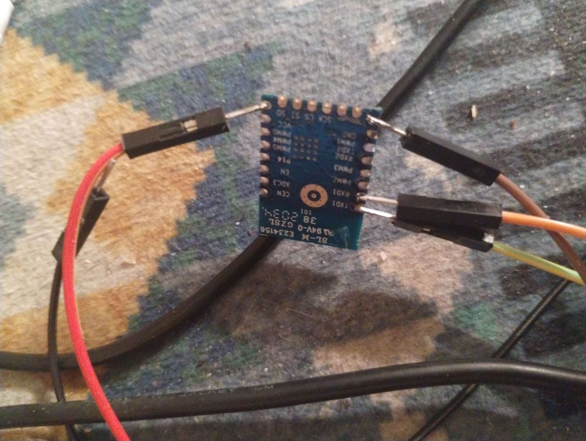

    I used a ch341a to connect to these pins on the module. I was surprised to see that the bottom still had all of the labels! You actually don't need to remove the module from the main PCB; I was just curious about what the bottom looked like. I followed this guide https://www.elektroda.com/rtvforum/topic3951016.html to flash, but I didn't need an external 3.3v power supply. Maybe that's because I was plugged into a usb3 port? I use fedora linux, and I used the python script because the .net flashing application kept giving me errors on both windows and linux.
    ESP8266 module connected with jumper wires for power and data

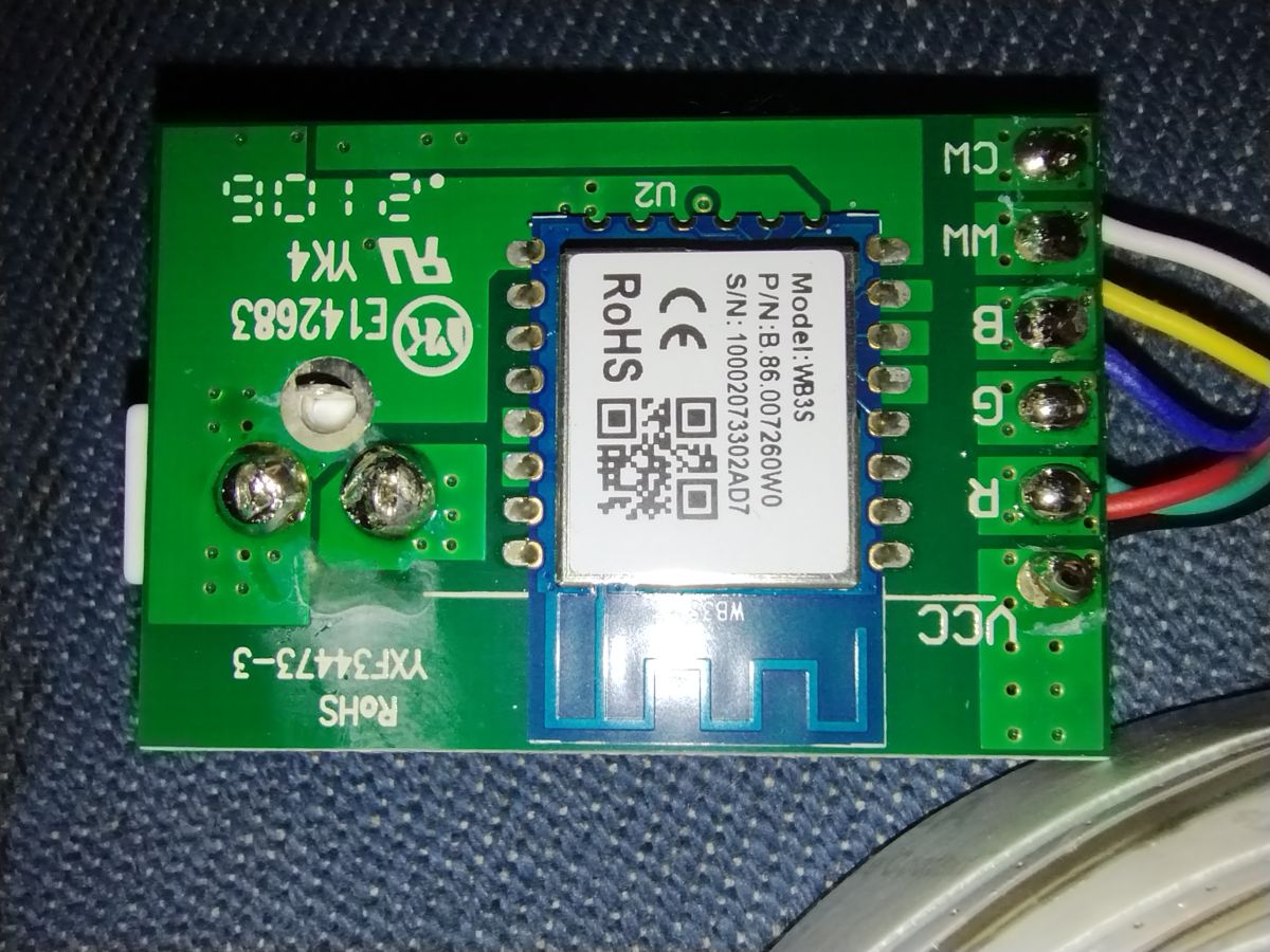

    Here Is a closeup of the top of the board. Notice that the wires aren't connected very well! I re-soldered them with flux after taking this picture. The solder used on the board seemed extremely soft... I was able to indent it with my fingernail and it melted at around 400F.

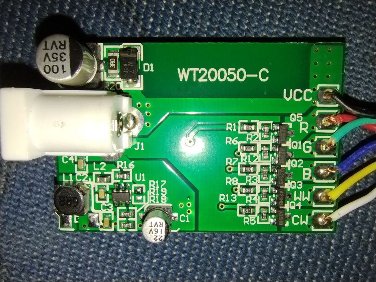

    Here is a closeup of the bottom of the board! There doesn't seem to be any middle layer on the green PCB; just a top and bottom!
    Check out that power connector! It's just plain missing a whole connection! How are they saving any money by not soldering that?!

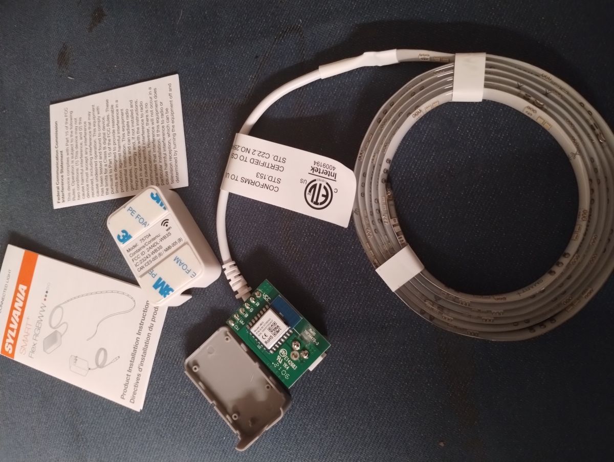

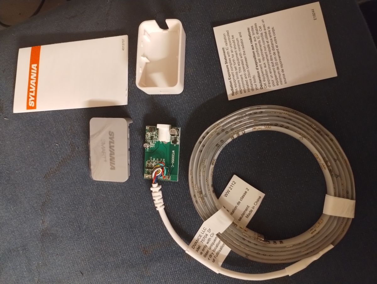

    Here is what came in the box: The gray piece can be just popped out with a fingernail, but I used a small screwdriver.

    There is no IR sensor, and there are no buttons. I wonder how they expected people to reset the devices? Maybe it had something to do with power cycling?

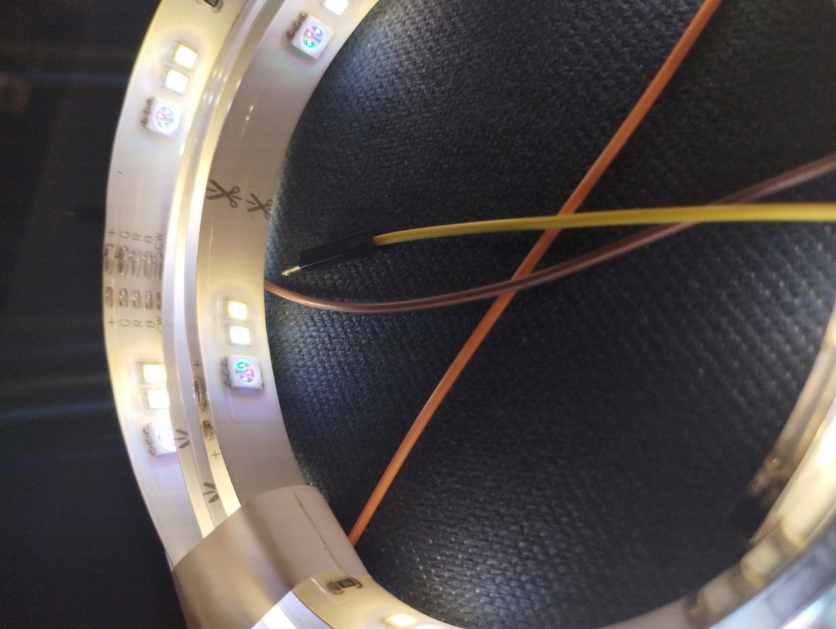

    Both the box and the strip say that this is a RGBWW strip, which I guess technically is true, but it's actually an RGBCW strip.
    The power supply it comes with is 12v 1a. It says on the front of the box that it's expandable to 13 feet, but I'm thinking that if I used a chunkier power supply that it could go even further! Is this the correct thought process?
