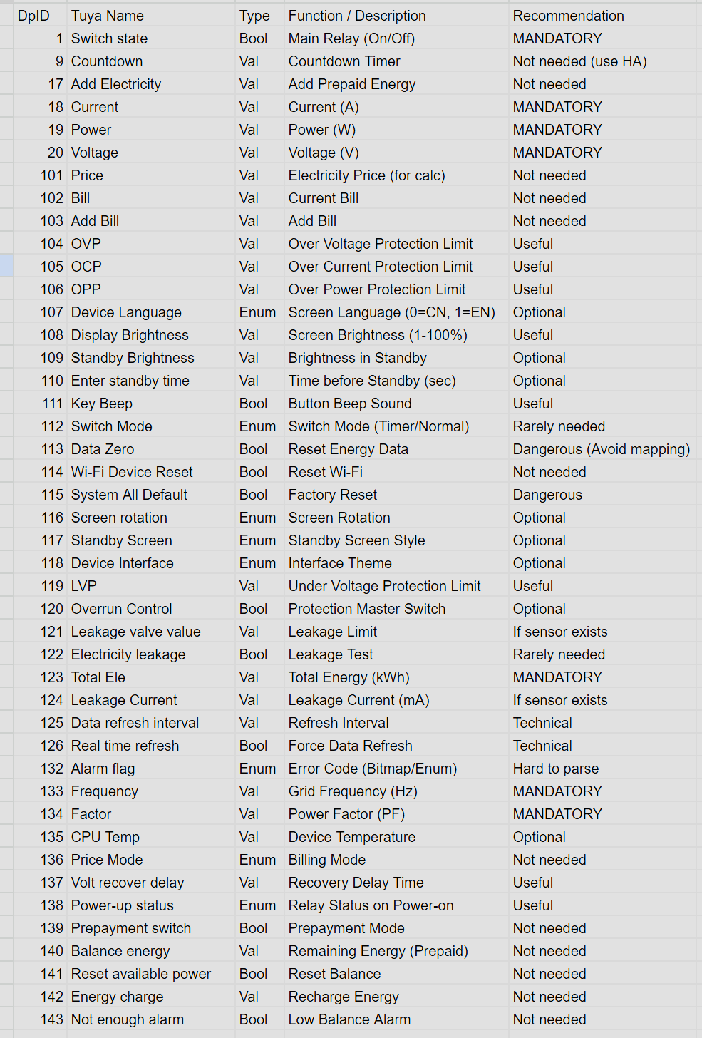

    yarik8117
    Posts: 10
    >>21784541
    Tuya device parameter table with functions and recommendations
    • dpid in.txt (544 Bytes) You must be logged in to download this attachment.

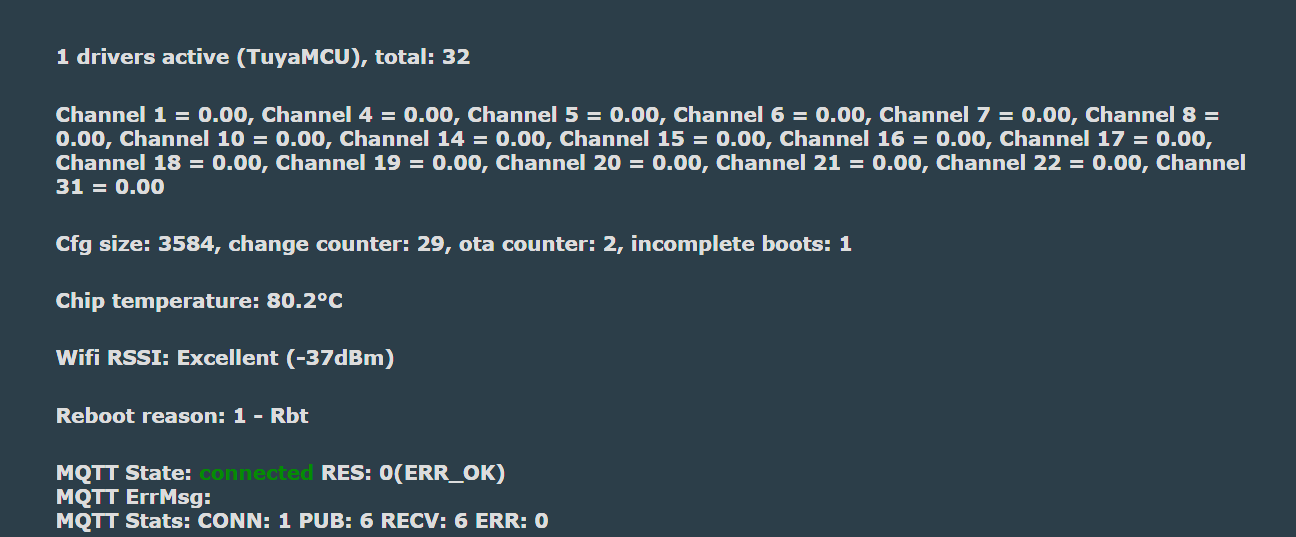

    is anything giving sign OpenBK7238 is talking to the TuyaMCU? what about with flag 26 enabled to swap uart?
  • #68 21785019
    yarik8117
    Posts: 10
    >>21784969 >>21784969
    I don't see any signs of interaction. No buttons or data are being transmitted. I enabled flag 26 and disabled it, but it doesn't help.
    Screenshot of system status with one active TuyaMCU driver and 32 total channels

    No data from TuyaMCU in the console or on the sensor. No data at all. What else can I do? I am new to this and am trying to figure it out. Apparently, the DpId is the same, exactly the same as in the first post, only the bit width of some sensors is different. But no data is coming in at all, as if TuyaMCU does not exist.
  • #72 21785332
    Posts: 5068
    Help: 438
    Rate: 894
    How did you flash BK7238? Did you have to cut traces or desolder t1-2s-nl module? How are you powering the device now, is it all back together and on the mains?
    Any results from command tuyaMcu_sendQueryState?
  • #73 21785444
    GoldMember
    Posts: 26
    In my case I desoldered the module and flashed it with BK Flasher. Everythinhg went ok so I put it back together and connected to mains.
    Result of command:
    Error:CMD:cmd tuyaMcu_sendQueryState NOT found (args )
    Unknown command

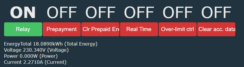

  • #75 21787621
    GoldMember
    Posts: 26
    It's working!
    Interface with relay button and electrical data, status ON
    Except the power meter. I tried command startDriver BL0942 in autoexec but when is on nothing works.
    Any idea why is not showing power?
  • #76 21787625
    Posts: 5068
    Help: 438
    Rate: 894
    what does your line for power in autoexec look like?
    startdriver bl0942 is not for TuyaMCU devices. Power reading will just be another dpID like the other things.

    My mistake was probably in "tuyaMcu_setBaudRate 115200". I set it to 9600.
  • #80 21787724
    GoldMember
    Posts: 26
    Now power is also working, it has to be like that:
    linkTuyaMCUOutputToChannel 19 val 6
    setChannelType 6 Power_div100
    setChannelLabel 6 "Power"

Key insight: GR2P-WS is not a simple standalone smart relay. It is a TuyaMCU design, so flashing OpenBeken only replaces the Wi‑Fi module; the device works correctly only after you map the right DpIDs and baud rate in autoexec.bat.
  • The early GR2P-WS schema exposed 44 DpIDs, including relay control, voltage, current, power, total energy, prepaid functions, alarms, frequency, power factor, and display settings. [#21142057]
  • On the early CB2S board, measured rails were about 10.1 V from the PN8016 supply and 3.23 V for logic, with the relay coil presumed to be 9 V. [#21142057]
  • The GR2PWSL leakage version adds an external residual-current transformer with a reported 1:1000 ratio plus roughly 510 Ω shunt and ~500 Ω series parts for leakage sensing. [#21572984]
  • A late T1-2S-NL GR2P-WS worked only after switching TuyaMCU speed to 115200 baud; using DpID 19 for power fixed the broken power reading. [#21787724]

What are DpIDs in TuyaMCU devices, and how do I extract the GR2P-WS schema or Things Data Model from Tuya Developer?
DpIDs are Tuya datapoint identifiers that represent functions like switch state, power, voltage, or alarms. "DpIDs" are protocol fields that define each readable or writable function, including type, scale, unit, and access mode. For GR2P-WS, the thread extracted the Things Data Model from Tuya Developer using “Query Things Data Model,” then reformatted it into a readable table. The early model exposed 44 DpIDs, while a later T1-2S-NL dump still matched modelId e1kylf6c, confirming the same basic schema even on newer hardware. [#21784596]
