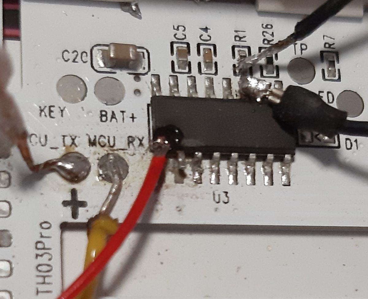

  • #34 21891334
    Posts: 5220
    Help: 449
    Rate: 918
    maybe it's now just the TuyaMCU sending stuff to T1 RX that's getting in the way
  • #35 21891398
    io2345
    Posts: 273
    Rate: 7

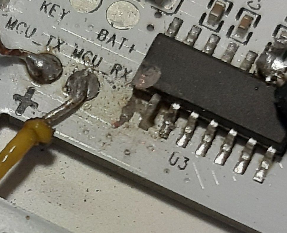

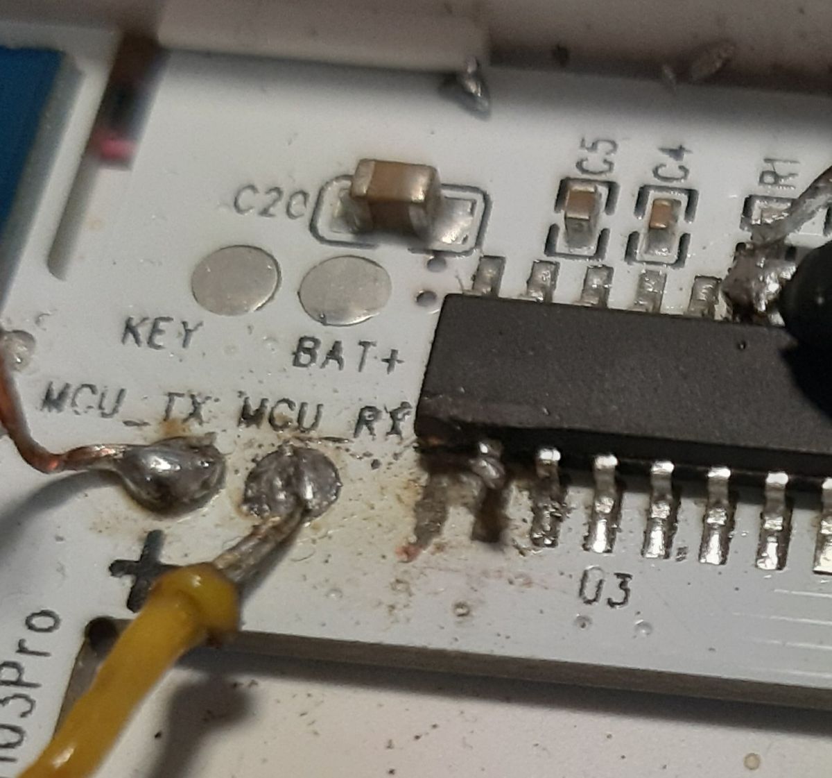

    >>21891334 Surprisingly enough, that helped - thank you for suggesting. I detached MCUs pin 9 as well, and now I managed to flash - on the third attempt.
    Holy Moly, T1-3S is harder to defeat than CB-3S was.
  • #36 21894981
    io2345
    Posts: 273
    Rate: 7
    >>21891398 Must have wrecked the MCU while desoldering/resoldering connections. Connection to MQTT ok, but values are always zero.
  • #37 21895635
    Posts: 5220
    Help: 449
    Rate: 918

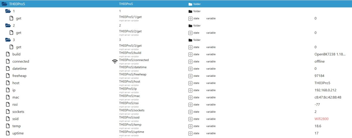

    oh! is the MCU still sending to the T1-3S? Are the temp/hum values 0 in OBK too?

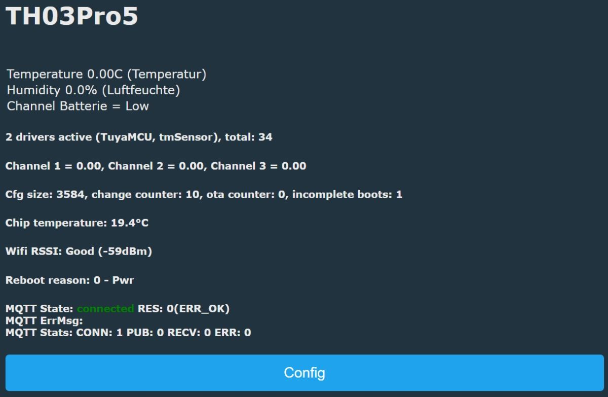

  • OBK boots but TH03 Pro sensor data never arrives
    #38 21895785
    io2345
    Posts: 273
    Rate: 7
    >>21895635 The device is flashed to OBK. I assume that the T1-3S module transmits what it receives, but the MCU does not send data. But it might have a different reason for malfunctioning as well...
    After inserting the battery the display shows reasonable temperature- and humidity-values, but the WiFi-symbol keeps running for some minutes, then stops. The OBK-page shows
    TH03 Pro Temperature Humidity Sensor Compatibility with OpenBeken Integration (possibly)
    The log on the Webpage shows this while the WiFi symbol is running and stops after that:
    Warn:CFG:CFG_InitAndLoad: Correct config has been loaded with 10 changes count.
    Info:NTP:CLOCK driver initialized.
    Info:MAIN:Main_Init_Delay
    Info:MAIN:Using SSID [Wifi2800]
    Info:MAIN:Using Pass [Password]
    Info:MQTT:MQTT_RegisterCallback called for bT TH03Pro5/ subT TH03Pro5/+/set
    Info:MQTT:MQTT_RegisterCallback called for bT cmnd/TH03Pro5/ subT cmnd/TH03Pro5/+
    Info:MQTT:MQTT_RegisterCallback called for bT TH03Pro5/ subT TH03Pro5/+/get
    Info:MQTT:MQTT_RegisterCallback called for bT homeassistant/ subT homeassistant/+
    Info:CMD:CMD_StartScript: started @startup at the beginning
    Info:HTTP:TCP server listening
    Info:MAIN:Starting TuyaMCU.
    Info:MAIN:Started TuyaMCU.
    Info:MAIN:Starting tmSensor.
    Info:MAIN:Started tmSensor.
    Info:GEN:Channel 1 type changed to Temperature_div10
    Info:GEN:Channel 2 type changed to Humidity
    Info:GEN:Channel 3 type changed to ReadOnlyLowMidHigh
    Info:MAIN:Time 1, idle 539922/s, free 127368, MQTT 0(0), bWifi 0, secondsWithNoPing -1, socks 2/24

    Once the symbol stops running, it does not start again
    Finally, that's what I have in my MQTT-Broker:

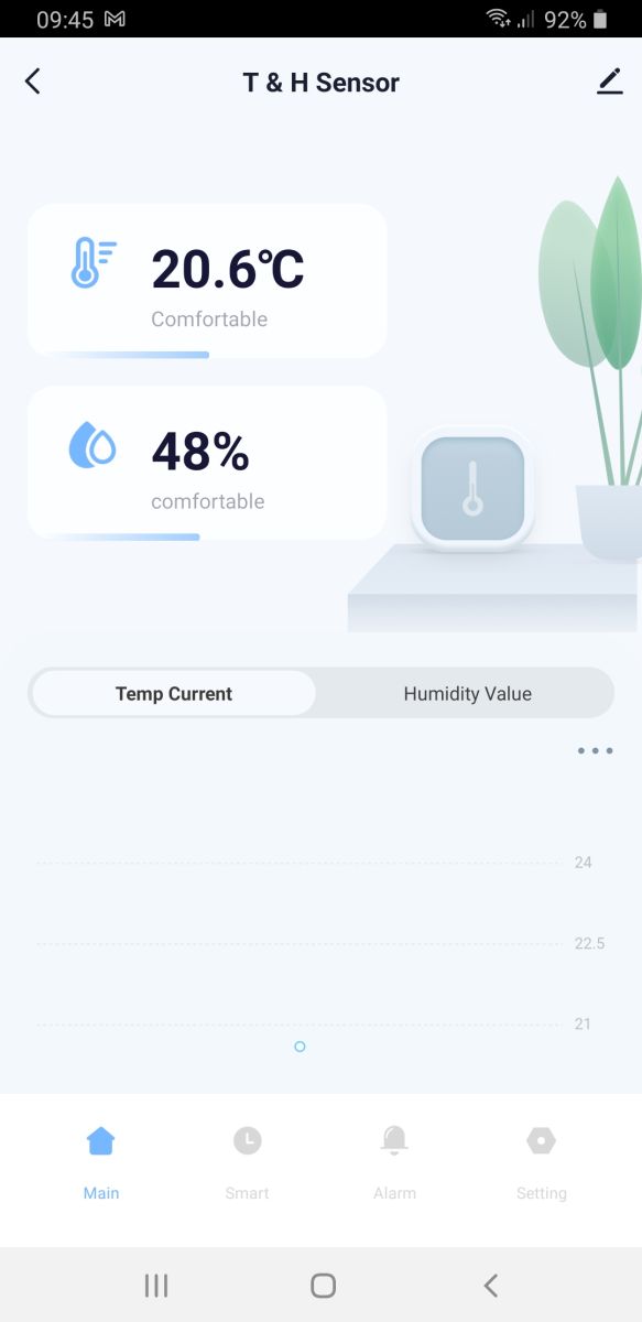

    >>21895785 We have reached a point where things are beginning to be interesting. The device is working fine with original Tuya firmware:
    Screenshot of the “T & H Sensor” app showing 20.6°C temperature and 48% humidity
    What to do next? Stay on Tuya or re-flash OBK? And why is the CB-3S and T1-3S Version reacting differently? The circuit layout and PCB of the device is the same (as far as I can tell) and has the same identifier. So both Wifi-devices should do just the same, don't they?

    Finally broke off one leg of the MCU from multiple bending due to constantly changing from original firmware to OBK and back. So I can't solve the riddle :-/

    divadiow wrote:
    You could potentially solder a tiny lead bridge from the MCU leg stub to the pad perhaps to repair?

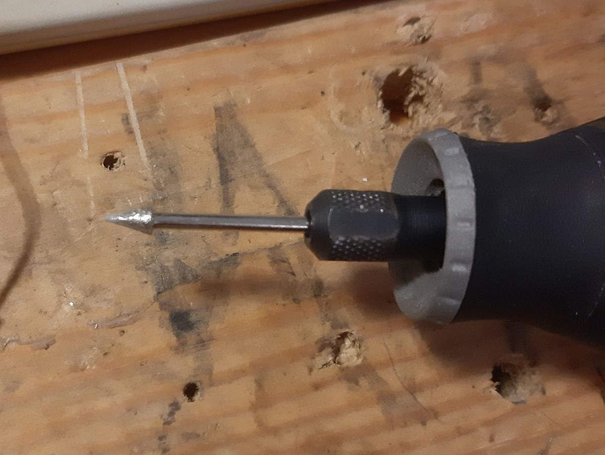

    Sadly the leg broke off right at the housing of the MCU. And the pad in fact was the first part to vanish - had the leg soldered with a short wire to the big MCU_TX Pad on the board, which has direct connection to the RX-Connector of the Wifi-module.
    Hinzugefügt nach 3 [Stunden] 36 [Minuten]:
    >>21904109 What may happen, if you can't accept things:
    MCU with broken leg:
    Mill-cut with small tip:
    Only remove as much plastic as necessary to expose the inner wire. Carefully clean the rest with a knife:
    Solder a wire to the inner line with as little heat as possible:
    Hard to believe, but it works. So, let's continue the story :-)

    Log of the Web Application, starting from boot, then sending tuyaMCU_SendQueryState,:
    Warn:CFG:CFG_InitAndLoad: Correct config has been loaded with 2 changes count.
    Info:MAIN:Using SSID [WiFi2800]
    Info:MAIN:Using Pass [password]
    Info:MQTT:MQTT_RegisterCallback called for bT obk8C428848/ subT obk8C428848/+/set
    Info:MQTT:MQTT_RegisterCallback called for bT obks/ subT obks/+/set
    Info:MQTT:MQTT_RegisterCallback called for bT cmnd/obk8C428848/ subT cmnd/obk8C428848/+
    Info:MQTT:MQTT_RegisterCallback called for bT cmnd/obks/ subT cmnd/obks/+
    Info:MQTT:MQTT_RegisterCallback called for bT obk8C428848/ subT obk8C428848/+/get
    Info:MAIN:Time 1, idle 572285/s, free 128024, MQTT 0(0), bWifi 0, secondsWithNoPing -1, socks 2/24
    Info:TuyaMCU:Received: 55 AA 03 00 00 01 00 03
    Info:TuyaMCU:ProcessIncoming[v=3]: cmd 0 (Hearbeat) len 8
    Info:MAIN:Time 2, idle 411080/s, free 128024, MQTT 0(0), bWifi 0, secondsWithNoPing -1, socks 2/24
    Info:TuyaMCU:Received: 55 AA 03 01 00 37 7B 22 70 22 3A 22 78 65 61 67 69 6D 61 6E 74 62 37 64 37 61 70 62 22 2C 22 76 22 3A 22 31 2E 30 2E 30 22 2C 22 6D 22 3A 30 2C 22 6E 22 3A 31 2C 22 73 6D 22 3A 30 7D 24
    Info:TuyaMCU:ProcessIncoming[v=3]: cmd 1 (QueryProductInformation) len 62
    Info:TuyaMCU:ParseQueryProductInformation: received {"p":"xeagimantb7d7apb","v":"1.0.0","m":0,"n":1,"sm":0}
    Info:MAIN:Time 3, idle 377684/s, free 128024, MQTT 0(0), bWifi 0, secondsWithNoPing -1, socks 2/24
    Info:TuyaMCU:Received: 55 AA 03 02 00 00 04
    Info:TuyaMCU:ProcessIncoming[v=3]: cmd 2 (MCUconf) len 7
    Info:TuyaMCU:ProcessIncoming: TUYA_CMD_MCU_CONF, TODO!
    Info:MAIN:Time 4, idle 383318/s, free 128024, MQTT 0(0), bWifi 0, secondsWithNoPing -1, socks 2/24
    Info:MAIN:Time 5, idle 383019/s, free 128024, MQTT 0(0), bWifi 0, secondsWithNoPing -1, socks 2/24
    Info:MAIN:Registered for wifi changes
    Info:MAIN:Connecting to SSID [WiFi2800]
    Info:TuyaMCU:Received: 55 AA 03 00 00 01 01 04
    Info:MAIN:Time 6, idle 0/s, free 120168, MQTT 0(0), bWifi 0, secondsWithNoPing -1, socks 2/24
    Info:MAIN:Time 7, idle 320775/s, free 121200, MQTT 0(0), bWifi 1, secondsWithNoPing -1, socks 2/24
    Info:TuyaMCU:Received: 55 AA 03 03 00 00 05
    Info:TuyaMCU:ProcessIncoming[v=3]: cmd 3 (WiFiState) len 7
    Info:MAIN:Time 8, idle 411878/s, free 121200, MQTT 0(0), bWifi 1, secondsWithNoPing -1, socks 2/24

    Does it tell us anything?
    Hinzugefügt nach 21 [Minuten]:
    I changed now autoexec.bat to the supposed values (according to TuyaDevelopersPage-Log):
    startDriver TuyaMCU
    setChannelLabel 1 "Temperatur"
    setChannelLabel 2 "Luftfeuchte"
    setChannelLabel 3 "Batterie"
    setChannelType 1 Temperature_div10
    linkTuyaMCUOutputToChannel 102 val 1
    setChannelType 2 Humidity
    linkTuyaMCUOutputToChannel 103 val 2
    setChannelType 3 ReadOnlyLowMidHigh
    linkTuyaMCUOutputToChannel 104 enum 3
    Readings are still zero
    Hinzugefügt nach 4 [Minuten]:
    One might get the impression, that this MCU-Type is using some additional technique in cojunction with T1-module - is it supposed to avoid people from flashing devices with alternative firmware?

    Doubt it, probably just some new additions to protocol.
    I see that module receives 3 unknown commands, 22, 23 and 24.
    Add "tuyaMcu_defWiFiState 4" after startdriver, if it doesn't help - change 4 to 5.
  • TuyaMCU heartbeat received, then JSON data packet
    #54 21904633
    io2345
    Posts: 273
    Rate: 7
    Tried it with this autoexec.bat:
    startDriver TuyaMCU
    tuyaMcu_sendQueryState
    And the Log was:
    Warn:CFG:CFG_InitAndLoad: Correct config has been loaded with 3 changes count.

    Then the log suddenly stopped.
    I will try again without "tuyaMcu_sendQueryState"
    Hinzugefügt nach 30 [Minuten]:
    Full Log with this autoexec.bat
    startDriver TuyaMCU
    can't be done. If this entry is in autoexec.bat, the device seems to hang upon reboot. You only have 4 or 5 seconds to do a lfs_format on command line, to get rid of it again.
    with "tuyaMcu_defWiFiState 5" I get a log, though:

    Probably there's nothing I can do from my side, to get things done - a case for developers, I guess?

    Info:MAIN:Time 67, idle 419699/s, free 115176, MQTT 1(1), bWifi 1, secondsWithNoPing -1, socks 2/24
    Info:MAIN:Time 68, idle 398712/s, free 115176, MQTT 1(1), bWifi 1, secondsWithNoPing -1, socks 2/24
    Info:MAIN:Time 69, idle 401914/s, free 115176, MQTT 1(1), bWifi 1, secondsWithNoPing 1, socks 2/24
    Info:MAIN:Time 70, idle 385927/s, free 115176, MQTT 1(1), bWifi 1, secondsWithNoPing 2, socks 2/24
    Info:GEN:dhcp=0 ip=192.168.1.38 gate=192.168.1.1 mask=255.255.255.0 mac=c8:47:8c:42:88:48
    Info:GEN:sta:rssi=-31,ssid=OpenWrt,bssid=b0:4e:26:ab:98:1a,channel=6,cipher_type:CCMP
    Info:MAIN:Time 71, idle 391921/s, free 115176, MQTT 1(1), bWifi 1, secondsWithNoPing 3, socks 2/24
    Info:MAIN:Time 72, idle 384862/s, free 115176, MQTT 1(1), bWifi 1, secondsWithNoPing 4, socks 2/24
    Info:MAIN:Time 73, idle 382247/s, free 114560, MQTT 1(1), bWifi 1, secondsWithNoPing 5, socks 3/24
    tuyaMCU sent captured packets
    [RX]- 00
    [RX]- 55 AA 03 00 00 01 00 03
    [RX]- 55 AA 03 01 00 37 7B 22 70 22 3A 22 31 75 67 74
    6D 67 6C 76 76 6E 77 6C 75 6E 34 61 22 2C 22 76
    22 6E 22 3A 31 2C 22 73 6D 22 3A 30 7D 75
    [RX]- 55 AA 03 02 00 00 04
    [RX]- 55 AA 03 00 00 01 01 04
    [RX]- 55 AA 03 03 00 00 05
    [RX]- 55 AA 03 90 00 03 02 17 18 C6
