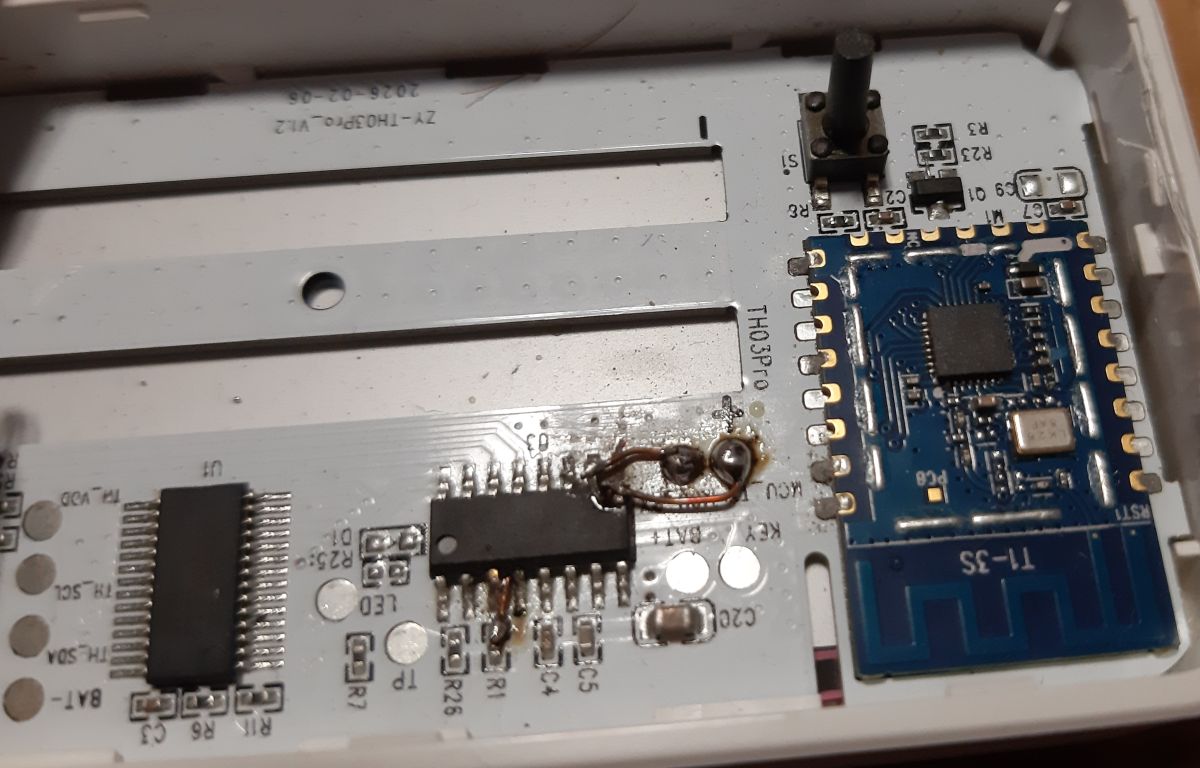

    divadiow wrote:
    and the dpIDs for xeagimantb7d7apb are:
    102 - temp
    103 - humidity
    104 - battery
    Thank you, that confirms what I could read out from Tuyas developer page. That's why I use this autoexec.bat:
    startDriver TuyaMCU
    setChannelLabel 1 "Temperatur"
    setChannelLabel 2 "Humidity"
    setChannelLabel 3 "Batterie"
    setChannelType 1 Temperature_div10
    linkTuyaMCUOutputToChannel 102 val 1
    setChannelType 2 Humidity
    linkTuyaMCUOutputToChannel 103 val 2
    setChannelType 3 ReadOnlyLowMidHigh
    linkTuyaMCUOutputToChannel 104 enum 3
    But: Values are Zero on output for 1, 2 and 3.
    Where is the error?

    >>21911370 Must have mixed up versions while flashing - I was on version 9ca530ba6f50 from post #72 instead the one of post #77.
    Let me try again with version fcacdfa0b9bc from #77
    And I will try OTA once more. To keep device awake I had to use "addRepeatingEventUID 3 40 903 uartSendHex 55AA000300010609"
    Autoexec.bat was gone after OTA, as always.
    Dual UART-Communication log:

    Breaking news: Valid values in MQTT!
    Hinzugefügt nach 2 [Stunden] 44 [Minuten]:
    Sorry for the confusion, but that happens when you have several different firmwares lying around.
    Device is fully functional with Firmware fcacdfa0b9bc and the above autoexec.bat.
    Excellent work from @divadiow and thank you for the reliable support by @insmod
    Still waiting for the confirmation of @leonardojc that his device is up and running as well.
    Hard to believe, though, that this desecrated device is still working:

  • TuyaMCU mapping for TH03 Pro sensor channels
    #95 21911598
    leonardojc
    Posts: 9
    It's working!!
    I'm using this:
    firmware version tuyamcu2_fcacdfa0b9bc
    startDriver TuyaMCU
    setChannelLabel 1 "Temperature"
    setChannelLabel 3 "Battery"
    linkTuyaMCUOutputToChannel 3 enum 3
    Thanks guys!!
    Excellent work from @divadiow @insmod @io2345
