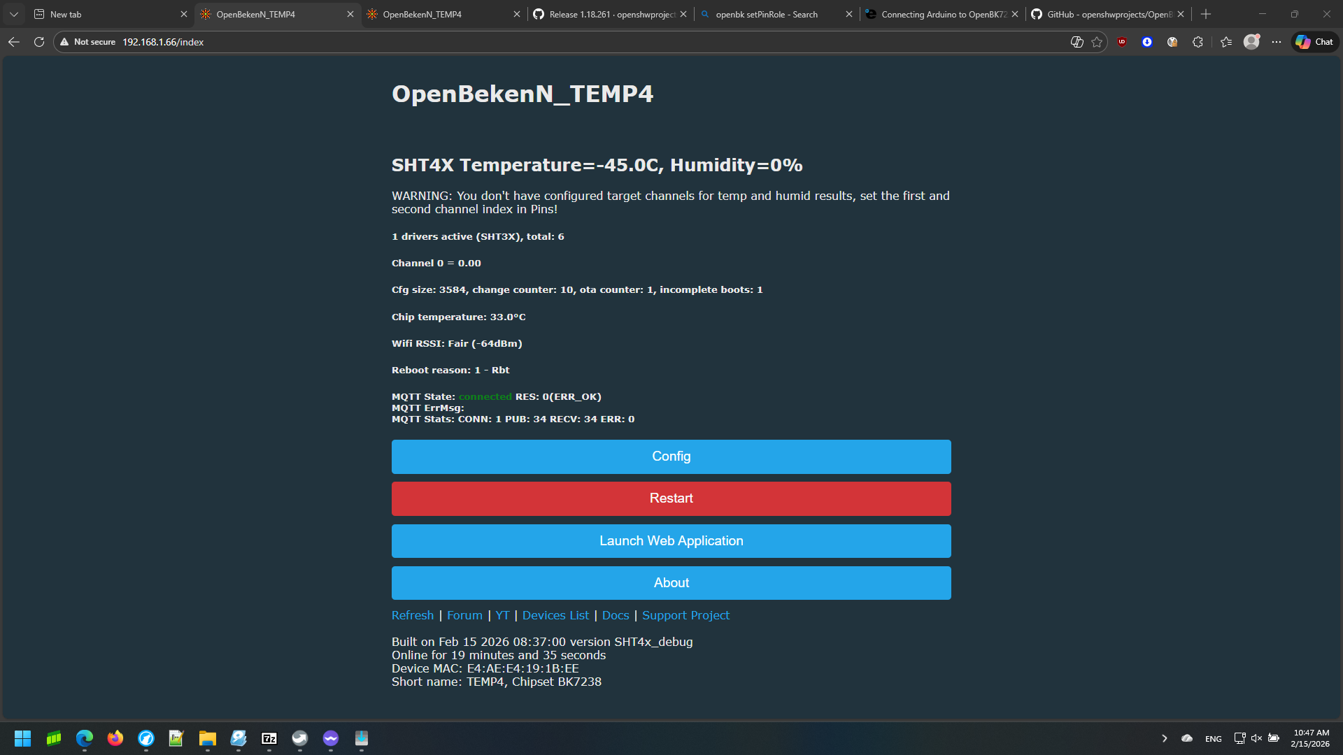

  • SHTXX driver starts but reads 00 00 81 00
    #33 21839052
    leon22heart
    Posts: 72
    Rate: 7

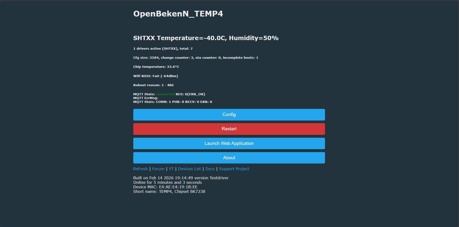

    >>21838980 Good morning to all .By flashing the latest firmware i have :
    1. not assigninig pins and strting yhe driver by commands
    Info:MAIN:Time 46, idle 416364/s, free 122776, MQTT 1(1), bWifi 1, secondsWithNoPing -1, socks 2/24
    Info:MAIN:Time 47, idle 383197/s, free 122776, MQTT 1(1), bWifi 1, secondsWithNoPing -1, socks 2/24
    Info:MAIN:Started shtxx.
    Info:CMD:[WebApp Cmd 'startdriver shtxx 24 17' Result] OK
    Info:MAIN:Time 48, idle 385871/s, free 122576, MQTT 1(1), bWifi 1, secondsWithNoPing -1, socks 2/24
    Info:MAIN:Time 49, idle 388928/s, free 114272, MQTT 1(1), bWifi 1, secondsWithNoPing -1, socks 2/24
    Info:MAIN:Time 50, idle 409677/s, free 122576, MQTT 1(1), bWifi 1, secondsWithNoPing -1, socks 2/24
    Info:GEN:dhcp=0 ip=192.168.1.66 gate=192.168.1.1 mask=255.255.255.0 mac=e4:ae:e4:19:1b:ee
    Info:GEN:sta:rssi=-64,ssid=LOLIDAS24TP_IOT,bssid=9c:05:d6:ba:e3:ee,channel=11,cipher_type:CCMP
    Info:SENSOR:SHTXX : Read buffer: 00 00 81 00 (0 0 129 0)
    Info:MAIN:Time 51, idle 434822/s, free 122576, MQTT 1(1), bWifi 1, secondsWithNoPing -1, socks 2/24
    Info:MAIN:Time 52, idle 395786/s, free 114272, MQTT 1(1), bWifi 1, secondsWithNoPing -1, socks 2/24
    Info:MAIN:Time 53, idle 421092/s, free 122576, MQTT 1(1), bWifi 1, secondsWithNoPing -1, socks 2/24
    Info:MAIN:Time 54, idle 416297/s, free 122576, MQTT 1(1), bWifi 1, secondsWithNoPing -1, socks 2/24
    Info:MAIN:Time 55, idle 419555/s, free 122576, MQTT 1(1), bWifi 1, secondsWithNoPing -1, socks 2/24
    Info:MAIN:Time 56, idle 426305/s, free 122576, MQTT 1(1), bWifi 1, secondsWithNoPing -1, socks 2/24
    Info:MAIN:Time 57, idle 406538/s, free 122576, MQTT 1(1), bWifi 1, secondsWithNoPing -1, socks 2/24
    Info:MAIN:Time 58, idle 418345/s, free 122576, MQTT 1(1), bWifi 1, secondsWithNoPing -1, socks 2/24
    Info:MAIN:Time 59, idle 413044/s, free 121960, MQTT 1(1), bWifi 1, secondsWithNoPing -1, socks 3/24
    Info:MAIN:Time 60, idle 412702/s, free 120104, MQTT 1(1), bWifi 1, secondsWithNoPing -1, socks 2/24
    Info:MAIN:Time 61, idle 423250/s, free 114272, MQTT 1(1), bWifi 1, secondsWithNoPing -1, socks 2/24
    Info:MAIN:Time 62, idle 389658/s, free 122576, MQTT 1(1), bWifi 1, secondsWithNoPing -1, socks 2/24
    Info:MAIN:Time 63, idle 411178/s, free 121960, MQTT 1(1), bWifi 1, secondsWithNoPing -1, socks 3/24
    Info:MAIN:Time 64, idle 399773/s, free 122576, MQTT 1(1), bWifi 1, secondsWithNoPing -1, socks 2/24
    Info:MAIN:Time 65, idle 406865/s, free 122576, MQTT 1(1), bWifi 1, secondsWithNoPing -1, socks 2/24
    Info:MAIN:Time 66, idle 405780/s, free 122576, MQTT 1(1), bWifi 1, secondsWithNoPing -1, socks 2/24
    Info:MAIN:Time 67, idle 402686/s, free 122576, MQTT 1(1), bWifi 1, secondsWithNoPing 1, socks 2/24
    Info:MAIN:Time 68, idle 396820/s, free 121960, MQTT 1(1), bWifi 1, secondsWithNoPing 2, socks 2/24
    Info:MAIN:Time 69, idle 410485/s, free 122576, MQTT 1(1), bWifi 1, secondsWithNoPing 3, socks 2/24
    Info:MAIN:Time 70, idle 409428/s, free 122576, MQTT 1(1), bWifi 1, secondsWithNoPing 4, socks 2/24
    OpenBekenN_TEMP4 status page showing −40.0°C, 50% humidity, and Config/Restart buttons

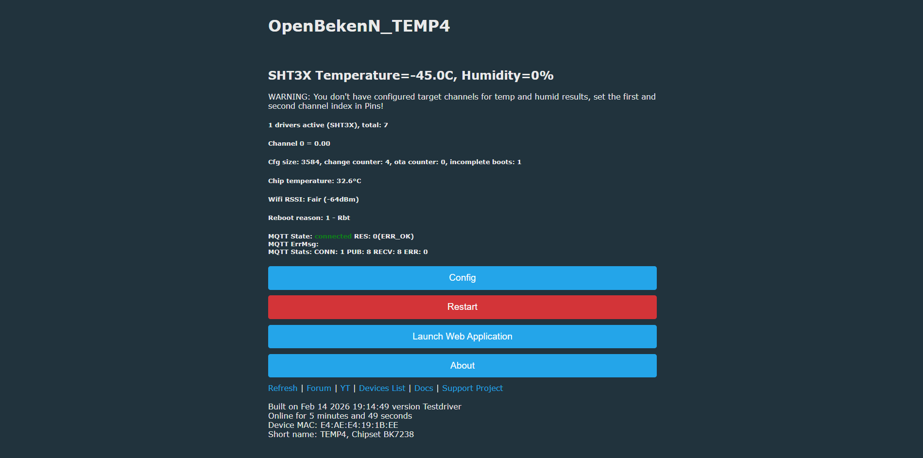

    2. by assigning pins and rebooting i have ( driver starts automatically)
    Info:MAIN:Time 8, idle 394144/s, free 128056, MQTT 0(0), bWifi 1, secondsWithNoPing -1, socks 2/24
    Info:MQTT:mqtt_userName leon22heart
    mqtt_pass ********
    mqtt_clientID TEMP4
    mqtt_host raspi5-home:1883
    Info:MQTT:mqtt_host raspi5-home is being resolved by gethostbyname
    Info:MAIN:Time 9, idle 401798/s, free 122176, MQTT 0(0), bWifi 1, secondsWithNoPing -1, socks 2/24
    Info:MQTT:mqtt_host raspi5-home resolution SUCCESS
    Info:MAIN:Time 10, idle 387877/s, free 122120, MQTT 0(1), bWifi 1, secondsWithNoPing -1, socks 2/24
    Info:MQTT:mqtt_subscribed to TEMP4/+/set
    Info:MQTT:mqtt_subscribed to bekens/+/set
    Info:MQTT:mqtt_subscribed to cmnd/TEMP4/+
    Info:MQTT:mqtt_subscribed to cmnd/bekens/+
    Info:MQTT:mqtt_subscribed to TEMP4/+/get
    Info:MQTT:mqtt_subscribed to homeassistant/+
    Info:MAIN:Time 11, idle 390619/s, free 122400, MQTT 1(1), bWifi 1, secondsWithNoPing -1, socks 2/24
    Info:GEN:CHANNEL_Set channel 0 has changed to -450 (flags 0)
    Info:MQTT:Channel has changed! Publishing -450 to channel 0
    Info:MQTT:Publishing val -450 to TEMP4/0/get retain=0
    Info:GEN:CHANNEL_Set channel 0 has changed to 0 (flags 0)
    Info:MQTT:Channel has changed! Publishing 0 to channel 0
    Info:MQTT:Publishing val 0 to TEMP4/0/get retain=0
    Info:SENSOR:SHT3X_Measure: Temperature:-45.0C Humidity:0%
    Info:MQTT:MQTT client in mqtt_incoming_publish_cb topic TEMP4/0/get
    Info:MAIN:Time 12, idle 412759/s, free 120856, MQTT 1(1), bWifi 1, secondsWithNoPing -1, socks 2/24
    Info:MAIN:Time 13, idle 391251/s, free 122400, MQTT 1(1), bWifi 1, secondsWithNoPing -1, socks 2/24
    Info:MAIN:Time 14, idle 382238/s, free 122400, MQTT 1(1), bWifi 1, secondsWithNoPing -1, socks 2/24
    Info:MAIN:Time 15, idle 404798/s, free 122400, MQTT 1(1), bWifi 1, secondsWithNoPing -1, socks 2/24
    Info:MAIN:Time 16, idle 397841/s, free 122384, MQTT 1(1), bWifi 1, secondsWithNoPing -1, socks 2/24
    Info:MAIN:Time 17, idle 392956/s, free 122384, MQTT 1(1), bWifi 1, secondsWithNoPing -1, socks 2/24
    Info:MAIN:Time 18, idle 400026/s, free 114080, MQTT 1(1), bWifi 1, secondsWithNoPing -1, socks 2/24
    Info:MAIN:Time 19, idle 395844/s, free 122384, MQTT 1(1), bWifi 1, secondsWithNoPing -1, socks 2/24
    Info:MAIN:Time 20, idle 387088/s, free 122384, MQTT 1(1), bWifi 1, secondsWithNoPing -1, socks 2/24
    Screenshot of OpenBekenN_TEMP4 showing SHT3X: −45.0°C, humidity 0%, plus Config and Restart buttons

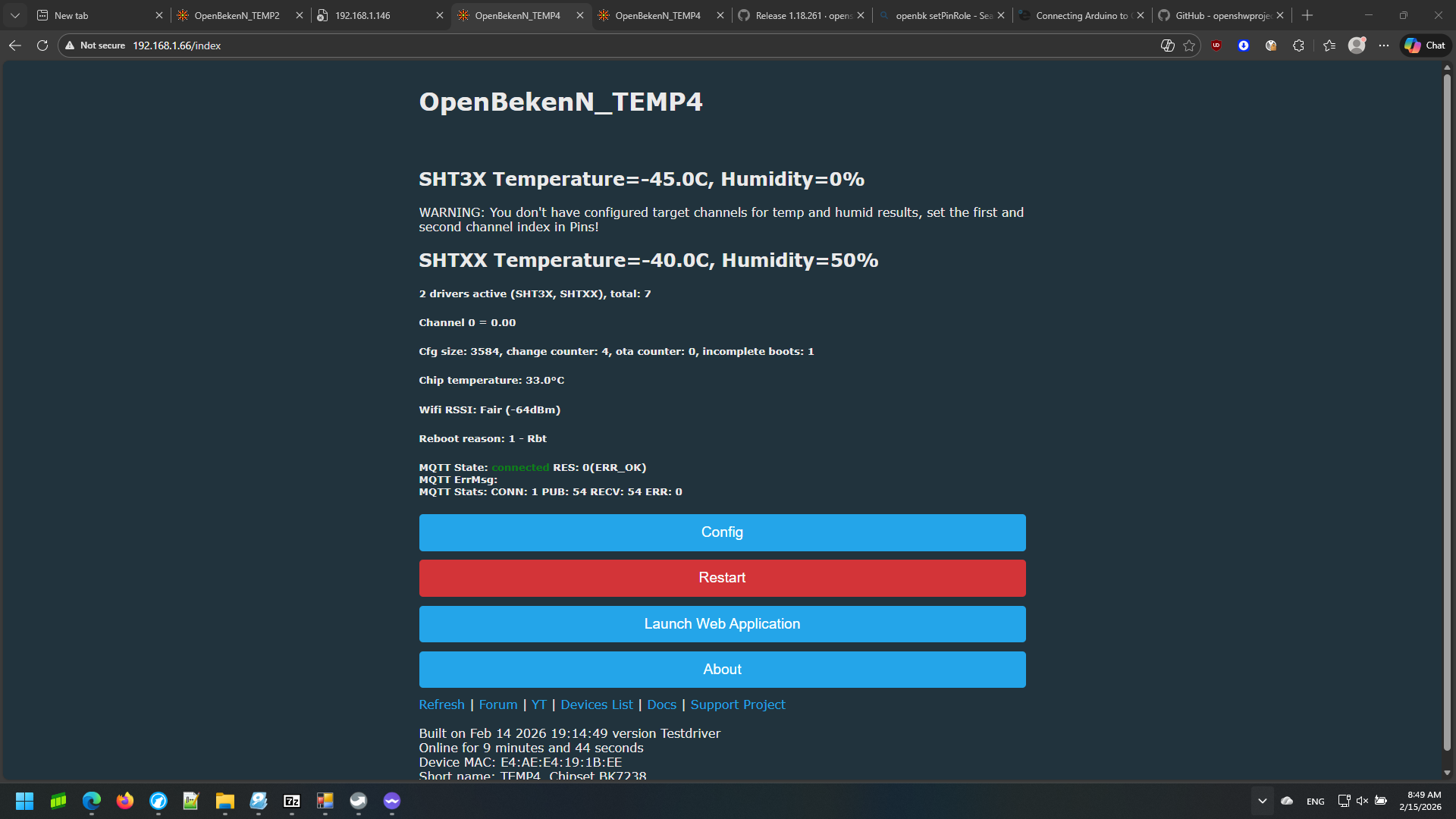

    if i also stop the driver and restart it shtxx or sh3x or both
    Screenshot of OpenBekenN_TEMP4 web panel showing temperature/humidity readings and buttons like Config and Restart

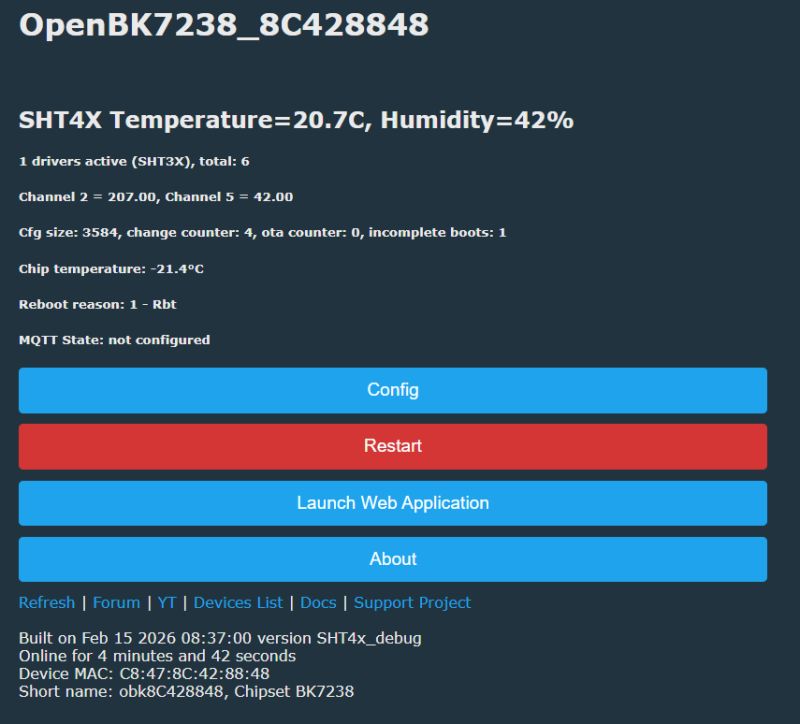

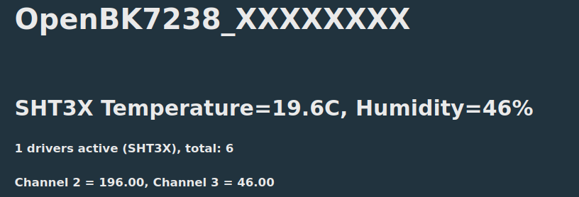

  • Force SHT4x type with SHT_SetType 4
    #37 21839095
    max4elektroda
    Posts: 758
    Help: 49
    Rate: 189
    Ah, I forgot to mention: There's also the command to force the type.
    So even if it detects SHT3x you might try
    SHT_SetType 4
    to see the results when sensor is treated as SHT4x in my case (wrong sensor, since I have SHT31):
    OpenBK7238 screenshot showing SHT4X reading: 130.0°C temperature and 100% humidity
    set back to type 3:
    OpenBK7238 screenshot showing SHT3X readings: 19.6°C temperature, 46% humidity, and channel values.
    PS: will be offline now for some hours ...
  • No pins defined for SHT3X driver startup
    #38 21839098
    leon22heart
    Posts: 72
    Rate: 7
    >>21839085 Flahed it.
    1. No pins defined and then backlog stopdriver sht3x; startdriver sht3x
    Info:CMD:[WebApp Cmd 'backlog stopdriver sht3x ' Result] OK
    Info:MAIN:Time 200, idle 383068/s, free 122472, MQTT 1(1), bWifi 1, secondsWithNoPing 134, socks 2/24
    Info:GEN:sta:rssi=-66,ssid=LOLIDAS24TP_IOT,bssid=9c:05:d6:ba:e3:ee,channel=11,cipher_type:CCMP
    Info:MAIN:Time 201, idle 380305/s, free 122384, MQTT 1(1), bWifi 1, secondsWithNoPing 135, socks 2/24
    Info:MAIN:Time 202, idle 384038/s, free 122472, MQTT 1(1), bWifi 1, secondsWithNoPing 136, socks 2/24
    Info:MAIN:Time 203, idle 383540/s, free 122472, MQTT 1(1), bWifi 1, secondsWithNoPing 137, socks 2/24
    Info:MAIN:Time 204, idle 378877/s, free 122472, MQTT 1(1), bWifi 1, secondsWithNoPing 138, socks 2/24
    Info:MAIN:Time 205, idle 367188/s, free 122472, MQTT 1(1), bWifi 1, secondsWithNoPing 139, socks 2/24
    Info:MAIN:Time 206, idle 394510/s, free 122176, MQTT 1(1), bWifi 1, secondsWithNoPing 140, socks 2/24
    Info:MAIN:Time 207, idle 369501/s, free 122472, MQTT 1(1), bWifi 1, secondsWithNoPing 141, socks 2/24
    Info:MAIN:Time 208, idle 381558/s, free 113448, MQTT 1(1), bWifi 1, secondsWithNoPing 142, socks 3/24
    Debug:API:POST to api/cmnd
    Debug:CMD:cmd [stopDriver SHT3X]
    Info:MAIN:Drv SHT3X not running.
    Info:CMD:[WebApp Cmd 'stopDriver SHT3X' Result] OK
    Info:MAIN:Time 209, idle 388997/s, free 122472, MQTT 1(1), bWifi 1, secondsWithNoPing 143, socks 2/24
    Info:MAIN:Time 210, idle 403837/s, free 122384, MQTT 1(1), bWifi 1, secondsWithNoPing 144, socks 2/24
    Info:GEN:sta:rssi=-65,ssid=LOLIDAS24TP_IOT,bssid=9c:05:d6:ba:e3:ee,channel=11,cipher_type:CCMP
    Info:MAIN:Time 211, idle 380959/s, free 122472, MQTT 1(1), bWifi 1, secondsWithNoPing 145, socks 2/24
    Info:MAIN:Time 212, idle 384157/s, free 122472, MQTT 1(1), bWifi 1, secondsWithNoPing 146, socks 2/24
    Info:MAIN:Time 213, idle 377301/s, free 122472, MQTT 1(1), bWifi 1, secondsWithNoPing 147, socks 2/24
    Info:MAIN:Time 214, idle 377129/s, free 122472, MQTT 1(1), bWifi 1, secondsWithNoPing 148, socks 2/24
    Info:MAIN:Time 215, idle 377449/s, free 122472, MQTT 1(1), bWifi 1, secondsWithNoPing 149, socks 2/24
    Info:MAIN:Time 216, idle 383926/s, free 122472, MQTT 1(1), bWifi 1, secondsWithNoPing 150, socks 2/24
    Info:MAIN:Time 217, idle 397818/s, free 122472, MQTT 1(1), bWifi 1, secondsWithNoPing 151, socks 2/24
    Info:MAIN:Time 218, idle 400753/s, free 122472, MQTT 1(1), bWifi 1, secondsWithNoPing 152, socks 2/24
    Info:MAIN:Time 219, idle 409096/s, free 122472, MQTT 1(1), bWifi 1, secondsWithNoPing 153, socks 2/24
    Info:MAIN:Time 220, idle 399235/s, free 120800, MQTT 1(1), bWifi 1, secondsWithNoPing 154, socks 2/24
    Info:MAIN:Time 221, idle 407023/s, free 120800, MQTT 1(1), bWifi 1, secondsWithNoPing 155, socks 2/24
    Info:MAIN:Time 222, idle 391831/s, free 120800, MQTT 1(1), bWifi 1, secondsWithNoPing 156, socks 2/24
    Info:MAIN:Time 223, idle 401242/s, free 122472, MQTT 1(1), bWifi 1, secondsWithNoPing 157, socks 2/24
    Info:MAIN:Time 224, idle 391958/s, free 122472, MQTT 1(1), bWifi 1, secondsWithNoPing 158, socks 2/24
    Info:MAIN:Time 225, idle 400629/s, free 121856, MQTT 1(1), bWifi 1, secondsWithNoPing 159, socks 3/24
    Info:MAIN:Time 226, idle 405385/s, free 122472, MQTT 1(1), bWifi 1, secondsWithNoPing 160, socks 2/24
    Info:MAIN:Time 227, idle 400260/s, free 122472, MQTT 1(1), bWifi 1, secondsWithNoPing 161, socks 2/24
    Info:MAIN:Time 228, idle 402025/s, free 122472, MQTT 1(1), bWifi 1, secondsWithNoPing 162, socks 2/24
    Info:MAIN:Time 229, idle 406058/s, free 122472, MQTT 1(1), bWifi 1, secondsWithNoPing 163, socks 2/24
    Info:MAIN:Time 230, idle 400638/s, free 122472, MQTT 1(1), bWifi 1, secondsWithNoPing 164, socks 2/24
    Info:GEN:sta:rssi=-68,ssid=LOLIDAS24TP_IOT,bssid=9c:05:d6:ba:e3:ee,channel=11,cipher_type:CCMP
    Info:MAIN:Time 231, idle 405983/s, free 122472, MQTT 1(1), bWifi 1, secondsWithNoPing 165, socks 2/24
    Info:MAIN:Time 232, idle 408577/s, free 122472, MQTT 1(1), bWifi 1, secondsWithNoPing 166, socks 2/24
    Info:MAIN:Time 233, idle 401845/s, free 122472, MQTT 1(1), bWifi 1, secondsWithNoPing 167, socks 2/24
    Info:MAIN:Time 234, idle 400650/s, free 122472, MQTT 1(1), bWifi 1, secondsWithNoPing 168, socks 2/24
    Info:MAIN:Time 235, idle 405730/s, free 122472, MQTT 1(1), bWifi 1, secondsWithNoPing 169, socks 2/24
    Info:MAIN:Time 236, idle 407435/s, free 122472, MQTT 1(1), bWifi 1, secondsWithNoPing 170, socks 2/24
    Info:MAIN:Time 237, idle 396910/s, free 122472, MQTT 1(1), bWifi 1, secondsWithNoPing 171, socks 2/24
    Info:MAIN:Time 238, idle 398392/s, free 121856, MQTT 1(1), bWifi 1, secondsWithNoPing 172, socks 3/24
    Info:MAIN:Time 239, idle 401512/s, free 114168, MQTT 1(1), bWifi 1, secondsWithNoPing 173, socks 2/24
    Info:MAIN:Time 240, idle 395049/s, free 122472, MQTT 1(1), bWifi 1, secondsWithNoPing 174, socks 2/24
    Info:MAIN:Time 241, idle 405293/s, free 122472, MQTT 1(1), bWifi 1, secondsWithNoPing 175, socks 2/24
    Info:MAIN:Time 242, idle 396966/s, free 122472, MQTT 1(1), bWifi 1, secondsWithNoPing 176, socks 2/24
    Info:MAIN:Time 243, idle 392023/s, free 122472, MQTT 1(1), bWifi 1, secondsWithNoPing 177, socks 2/24
    Debug:CMD:cmd [startDriver SHT3X]
    Info:SENSOR:SHT3x: using pins 9 (SCL) and 14 (SDA)
    Info:SENSOR:SHT: Detecting sensor type...
    Info:SENSOR:DEBUG SHT_DetectSensorType() testing for SHT3x: 0x36 got NACK
    Info:SENSOR:DEBUG SHT_DetectSensorType() testing for SHT4x: 0x89 got NACK
    Info:SENSOR:SHT: Sensor detection inconclusive, defaulting to SHT3X
    Info:SENSOR:SHT3X sensor detected
    Info:SENSOR:SHT : Status : FF FF
    Info:MAIN:Started SHT3X.
    Info:CMD:[WebApp Cmd 'startDriver SHT3X' Result] OK
    Info:MAIN:Time 244, idle 399168/s, free 122472, MQTT 1(1), bWifi 1, secondsWithNoPing 178, socks 2/24
    Info:MAIN:Time 245, idle 412697/s, free 122472, MQTT 1(1), bWifi 1, secondsWithNoPing 179, socks 2/24
    Info:MAIN:Time 246, idle 409975/s, free 122472, MQTT 1(1), bWifi 1, secondsWithNoPing 180, socks 2/24
    Info:MAIN:Time 247, idle 407374/s, free 122472, MQTT 1(1), bWifi 1, secondsWithNoPing 181, socks 2/24
    Info:GEN:CHANNEL_Set channel 0 has changed to 1300 (flags 0)
    Info:GEN:CHANNEL_Set channel 0 has changed to 100 (flags 0)
    Info:SENSOR:SHT3X_Measure: Temperature:130.0C Humidity:100%
    Info:MAIN:Time 248, idle 403476/s, free 122472, MQTT 1(1), bWifi 1, secondsWithNoPing 182, socks 2/24
    Info:MAIN:Time 249, idle 381264/s, free 122472, MQTT 1(1), bWifi 1, secondsWithNoPing 183, socks 2/24
    Info:MAIN:Time 250, idle 382402/s, free 122472, MQTT 1(1), bWifi 1, secondsWithNoPing 184, socks 2/24
    Info:MAIN:Time 251, idle 385652/s, free 122472, MQTT 1(1), bWifi 1, secondsWithNoPing 185, socks 2/24
    Info:MAIN:Time 252, idle 385034/s, free 122472, MQTT 1(1), bWifi 1, secondsWithNoPing 186, socks 2/24
    Info:MAIN:Time 12, idle 399896/s, free 120912, MQTT 1(1), bWifi 1, secondsWithNoPing -1, socks 2/24
    Info:MAIN:Time 13, idle 392574/s, free 122456, MQTT 1(1), bWifi 1, secondsWithNoPing -1, socks 2/24
    Info:MAIN:Time 14, idle 403270/s, free 122456, MQTT 1(1), bWifi 1, secondsWithNoPing -1, socks 2/24
    Info:MAIN:Time 15, idle 399993/s, free 122456, MQTT 1(1), bWifi 1, secondsWithNoPing -1, socks 2/24
    Info:MAIN:Time 16, idle 410116/s, free 114152, MQTT 1(1), bWifi 1, secondsWithNoPing -1, socks 2/24
    Info:MAIN:Time 17, idle 412148/s, free 122456, MQTT 1(1), bWifi 1, secondsWithNoPing -1, socks 2/24
    Info:MAIN:Time 18, idle 395277/s, free 112480, MQTT 1(1), bWifi 1, secondsWithNoPing -1, socks 2/24
    Info:MAIN:Time 19, idle 403199/s, free 122456, MQTT 1(1), bWifi 1, secondsWithNoPing -1, socks 2/24
    Info:MAIN:Time 20, idle 394136/s, free 122456, MQTT 1(1), bWifi 1, secondsWithNoPing -1, socks 2/24
    Info:GEN:sta:rssi=-62,ssid=LOLIDAS24TP_IOT,bssid=9c:05:d6:ba:e3:ee,channel=11,cipher_type:CCMP
    Info:MAIN:Time 21, idle 404004/s, free 122456, MQTT 1(1), bWifi 1, secondsWithNoPing -1, socks 2/24
    Info:SENSOR:SHT3X : Stopping Driver and reset sensor
    Info:MAIN:Drv SHT3X stopped.
    Info:MAIN:Time 22, idle 406202/s, free 122456, MQTT 1(1), bWifi 1, secondsWithNoPing -1, socks 2/24
    Info:MAIN:Time 23, idle 408543/s, free 122456, MQTT 1(1), bWifi 1, secondsWithNoPing -1, socks 2/24
    Info:MAIN:Time 24, idle 393054/s, free 122456, MQTT 1(1), bWifi 1, secondsWithNoPing -1, socks 2/24
    Info:MAIN:Time 25, idle 389844/s, free 122456, MQTT 1(1), bWifi 1, secondsWithNoPing -1, socks 2/24
    Info:MAIN:Time 26, idle 407663/s, free 122456, MQTT 1(1), bWifi 1, secondsWithNoPing -1, socks 2/24
    Info:MAIN:Time 27, idle 411799/s, free 112480, MQTT 1(1), bWifi 1, secondsWithNoPing -1, socks 2/24
    Info:MAIN:Time 28, idle 413027/s, free 122456, MQTT 1(1), bWifi 1, secondsWithNoPing -1, socks 2/24
    Info:MAIN:Time 29, idle 395816/s, free 122456, MQTT 1(1), bWifi 1, secondsWithNoPing -1, socks 2/24
    Info:MAIN:Time 30, idle 383316/s, free 122456, MQTT 1(1), bWifi 1, secondsWithNoPing -1, socks 2/24
    Info:MAIN:Time 31, idle 380797/s, free 121736, MQTT 1(1), bWifi 1, secondsWithNoPing -1, socks 3/24
    Info:SENSOR:SHT3x: using pins 24 (SCL) and 17 (SDA)
    Info:SENSOR:DEBUG SHT_DetectSensorType() testing for SHT3x: 0x36 got ACK, 0x82 got ACK
    Info:SENSOR:SHT: Detected SHT3X (Serial: 000081, CRC: 00)
    Info:SENSOR:SHT : Status : 00 00
    Info:MAIN:Time 32, idle 455622/s, free 120824, MQTT 1(1), bWifi 1, secondsWithNoPing -1, socks 2/24
    Info:MAIN:Time 33, idle 307781/s, free 122456, MQTT 1(1), bWifi 1, secondsWithNoPing -1, socks 2/24
    Info:MAIN:Time 34, idle 410417/s, free 122456, MQTT 1(1), bWifi 1, secondsWithNoPing -1, socks 2/24
    Info:MAIN:Time 35, idle 396591/s, free 122456, MQTT 1(1), bWifi 1, secondsWithNoPing -1, socks 2/24
    Info:MAIN:Time 36, idle 396892/s, free 122456, MQTT 1(1), bWifi 1, secondsWithNoPing -1, socks 2/24
    Info:MAIN:Time 37, idle 407127/s, free 120784, MQTT 1(1), bWifi 1, secondsWithNoPing -1, socks 2/24
    Info:MAIN:Time 38, idle 407857/s, free 122456, MQTT 1(1), bWifi 1, secondsWithNoPing -1, socks 2/24
    Info:MAIN:Time 39, idle 401790/s, free 122456, MQTT 1(1), bWifi 1, secondsWithNoPing -1, socks 2/24
    Info:MAIN:Time 40, idle 397100/s, free 122456, MQTT 1(1), bWifi 1, secondsWithNoPing -1, socks 2/24
    Info:MAIN:Time 41, idle 808978/s, free 122456, MQTT 1(1), bWifi 1, secondsWithNoPing -1, socks 2/24
    Info:MAIN:Time 42, idle 405834/s, free 120576, MQTT 1(1), bWifi 1, secondsWithNoPing -1, socks 2/24
    Info:MAIN:Time 43, idle 388607/s, free 122456, MQTT 1(1), bWifi 1, secondsWithNoPing -1, socks 2/24
    Info:MAIN:Time 44, idle 404275/s, free 114152, MQTT 1(1), bWifi 1, secondsWithNoPing -1, socks 2/24
    Info:MAIN:Time 45, idle 404798/s, free 122456, MQTT 1(1), bWifi 1, secondsWithNoPing -1, socks 2/24
    Info:MAIN:Time 46, idle 414018/s, free 122456, MQTT 1(1), bWifi 1, secondsWithNoPing -1, socks 2/24
    Info:MAIN:Time 47, idle 398010/s, free 120784, MQTT 1(1), bWifi 1, secondsWithNoPing -1, socks 2/24
    Info:MAIN:Time 48, idle 395712/s, free 122456, MQTT 1(1), bWifi 1, secondsWithNoPing -1, socks 2/24

  • #39 21839111
    max4elektroda
    Posts: 758
    Help: 49
    Rate: 189

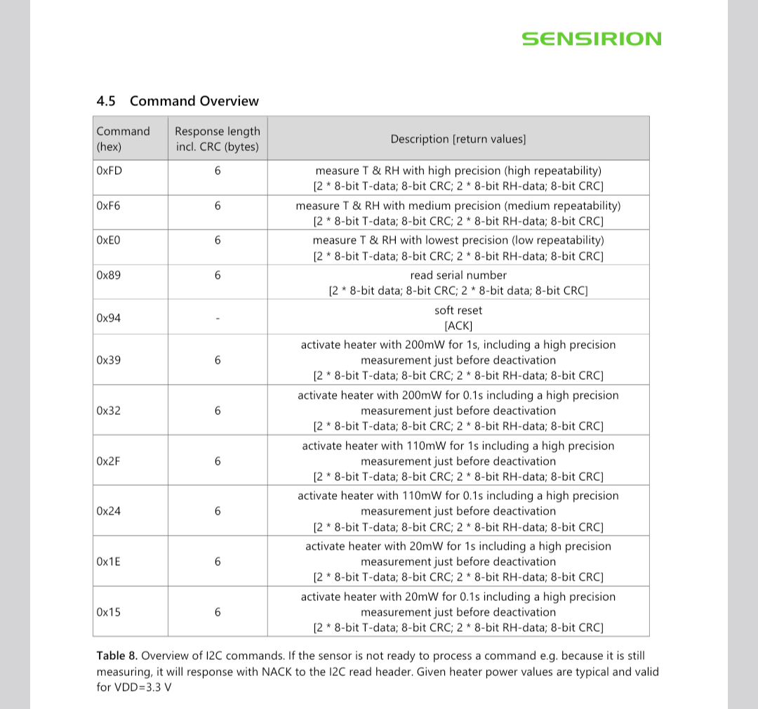

    Hm, if it's an SHT4X it should not respond to serial number requests on that commands like SHT3X if I understand the document correctly
    Sensirion “Command Overview” table listing I2C commands, response length incl. CRC, and descriptions.
    But maybe forcing SHT4X mode helps...
  • Force mode works after pin setup and reboot
    #40 21839126
    leon22heart
    Posts: 72
    Rate: 7
    >>21839111 Have not seen the force mode post . By setting the pins properly , rebooting , starting the driver and forcing the mode i have
    Info:MAIN:Time 12, idle 411598/s, free 120560, MQTT 1(1), bWifi 1, secondsWithNoPing -1, socks 2/24
    Info:MAIN:Time 13, idle 387933/s, free 114136, MQTT 1(1), bWifi 1, secondsWithNoPing -1, socks 2/24
    Info:MAIN:Time 14, idle 403851/s, free 122440, MQTT 1(1), bWifi 1, secondsWithNoPing -1, socks 2/24
    Info:MAIN:Time 15, idle 404675/s, free 122440, MQTT 1(1), bWifi 1, secondsWithNoPing -1, socks 2/24
    Info:MAIN:Time 16, idle 408744/s, free 122440, MQTT 1(1), bWifi 1, secondsWithNoPing -1, socks 2/24
    Info:MAIN:Time 17, idle 395142/s, free 122440, MQTT 1(1), bWifi 1, secondsWithNoPing -1, socks 2/24
    Info:MAIN:Time 18, idle 407677/s, free 122440, MQTT 1(1), bWifi 1, secondsWithNoPing -1, socks 2/24
    Info:MAIN:Time 19, idle 410155/s, free 122440, MQTT 1(1), bWifi 1, secondsWithNoPing -1, socks 2/24
    Info:MAIN:Time 20, idle 399726/s, free 113520, MQTT 1(1), bWifi 1, secondsWithNoPing -1, socks 3/24
    Info:GEN:sta:rssi=-63,ssid=LOLIDAS24TP_IOT,bssid=9c:05:d6:ba:e3:ee,channel=11,cipher_type:CCMP
    Info:MAIN:Time 21, idle 418920/s, free 122440, MQTT 1(1), bWifi 1, secondsWithNoPing -1, socks 2/24
    Info:MAIN:Time 22, idle 469455/s, free 120896, MQTT 1(1), bWifi 1, secondsWithNoPing -1, socks 2/24
    Info:SENSOR:Sensor type set to SHT4X
    Info:CMD:[WebApp Cmd 'SHT_SetType 4' Result] OK

    Screenshot of OpenBekenN_TEMP4 dashboard showing SHT4X: -45.0°C and 0% humidity
  • #43 21839151
    max4elektroda
    Posts: 758
    Help: 49
    Rate: 189
    Thanks, so it seems it's no SHT3X nor an SHT4X (or my SHT4X code is simply wrong).
    Or mybe it's some "incomplete" clone?
    Will try to bring the code from the hacky driver into the SHT3X driver, so we maybe need some tests to get real values for temp and hum...
    But later...

    >>21839151 Of course. Troubleshooting a new driver or sensor will not finish in 1 day. Take your time.
    PS1: Forgot to mention that, with the hacky working solution yesterday, the temp readings were reasonable and updating with small deviations. The humidity readings, on the other hand, were fluctuating from 10% to 79%.
    SHT45 detected on I2C address 0x44
    #45 21839236
    Posts: 5218
    Help: 448
    Rate: 917
    Red electronic PCB module with two white connectors and circular mounting holes
    SHT45
    Built on Feb 15 2026 08:37:00 version SHT4x_debug
    scani2c soft
    Screenshot of OpenBK status page showing SHT4X: 20.7°C, 42% humidity, with Config and Restart buttons

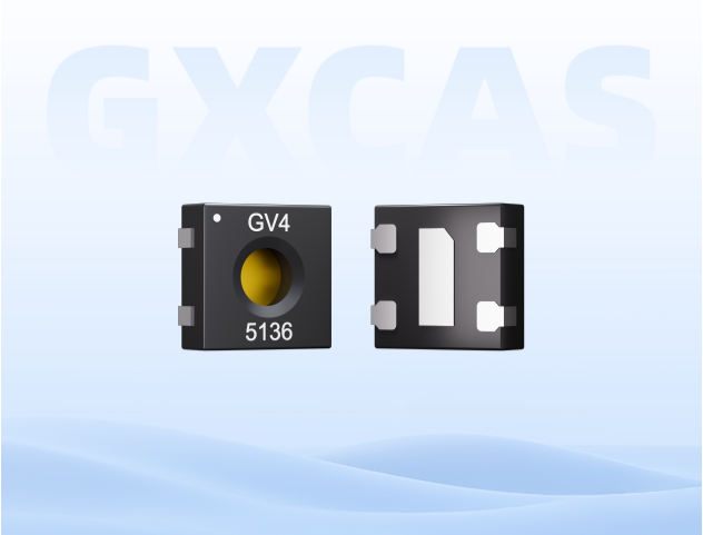

    • GXHTV4_datasheet_V1.6_20250919170610.pdf (306.67 KB) You must be logged in to download this attachment.
    • GXHTV4_DEMO_驱动程序_V1.4_20251022173704.zip (3.15 KB) You must be logged in to download this attachment.
  • #48 21839358
    max4elektroda
    Posts: 758
    Help: 49
    Rate: 189
    Thank you so much @divadiow, how come you seem to find that information so easy while I failed trying ?!?
    Will include that information to the testing code, great!
  • #49 21839370
    Posts: 5218
    Help: 448
    Rate: 917
    ah I cheated.
    I was describing what looked to be a C or G in a logo to the left of the GV4 text to ChatGPT and it found the whole thing
  • #50 21839406
    leon22heart
    Posts: 72
    Rate: 7
    >>21839370 I scanned the chip again with 6400 dpi vs. 3200 I used before. I yet can't conclude that what I am seeing is an imperfection on the chip and not letters. If you are spot on, then I applaud your vision. I never imagined that there was one more letter there.
    original
    Temu Temp-Humidity Sensor (BK7238, AU5068XA) - Batch 25WSDJ01 /Model F-SL01WB Pinout
    from 2nd sensor
  • #51 21839409
    Posts: 5218
    Help: 448
    Rate: 917
    maybe there is nothing there and I'm seeing things. anyway, we know what the sensor is now :)

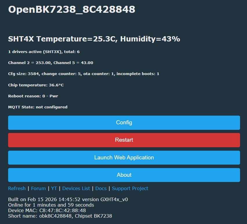

    • OpenBK7238_GXHT4x_V0.zip (1.86 MB) You must be logged in to download this attachment.
  • SHT4x and SHT40 both detected successfully
    #53 21839462
    Posts: 5218
    Help: 448
    Rate: 917
    max4elektroda wrote:
    Maybe @divadiow could test if SHT4x still works?
    seems to yes. SHT45
    Built on Feb 15 2026 14:45:52 version GXHT4x_v0
    having trouble locating my SHT40 to check that
    Added after 8 [minutes]:
    found.
    SHT40
    Screenshot of OpenBK7238 web panel showing SHT4X temperature 25.3°C and humidity 43%

    Changed detection so it should identify GXHTV4 now. Else only added some more debug output to hopefully get closer to why it fails....
    The only difference to the "hacky" driver is that we now read 6 instead of 4 bytes.
    But that's exactly how it's also done in demo code:
       if(GXHT4X_Wait_Ack()==0)
          GXHT4X_SDA_in();
          buff[0]=GXHT4X_Read_Byte(1);
          buff[1]=GXHT4X_Read_Byte(1);
          buff[2]=GXHT4X_Read_Byte(1);
          buff[3]=GXHT4X_Read_Byte(1);
          buff[4]=GXHT4X_Read_Byte(1);
          buff[5]=GXHT4X_Read_Byte(0);
          GXHT4X_StoP();
          if(CRC_8(buff, 2) == buff[2] && CRC_8(buff + 3, 2) == buff[5])
             tem = ((buff[0]<<8) | buff[1]);//ÎÂ¶ÈÆŽœÓ
             hum = ((buff[3]<<8) | buff[4]);//ʪ¶ÈÆŽœÓ
             temperature = 175.0 * (float)tem / 65535.0 - 45.0 ;   // T = -45 + 175 * tem / (2^16)
             humidity = 125.0 * (float)hum / 65535.0 - 6;         // RH = -6 + 125 * hum / (2^16)
             if(humidity >= 100)
                humidity = 100;
             if((temperature>=-45&&temperature<=125)&&(humidity>=0 && humidity<=100))//¹ýÂËŽíÎóÊýŸÝ
                *GXHT4x_TEMP = temperature;
                *GXHT4x_HUMI = humidity;
    • OpenBK7238_GXHTV4_v01.zip (1.86 MB) You must be logged in to download this attachment.

    >>21839563 Same config as before (reboot, stop, start)
    Info:CMD:[WebApp Cmd 'logfeature 22 1' Result] OK
    Info:SENSOR:SHT3X : Wrote command 0xE0
    Info:SENSOR:SHT3X : Read buffer: FF F2 E0 43 05 D0 (255 242 224 67 5 208)
    Info:SENSOR:GXHTV4 - try CHTX style calculation: Temp=124.97 - Hum=87.60
    Info:SENSOR:SHT3X_Measure: Temperature:129.9C Humidity:26%
    Info:SENSOR:SHT4X/GXHTV4: Stopping Driver and reset sensor
    Info:SENSOR:SHT3X cmd: SNB=[FFF24305], CRC=[E0,D0]
    Info:SENSOR:SHT: ✓ Detected SHT3X (Valid CRC - Serial: FFF24305)
    Info:SENSOR:SHT : Status : FF F2
    Info:SENSOR:SHT3X : Wrote command 0x24 0x16
  • SHT3X serial changed, breaking detection
    #58 21839600
    max4elektroda
    Posts: 758
    Help: 49
    Rate: 189
    Oh no, what happened now?
    It always used to be
    Info:SENSOR:SHT3X cmd: SNB=[00000000], CRC=[81,81]
    Info:SENSOR:SHT: ✓ Detected SHT3X (Valid CRC - Serial: 00000000)
    Now its another (valid) serial ?!?
    So my "detection" fails...
