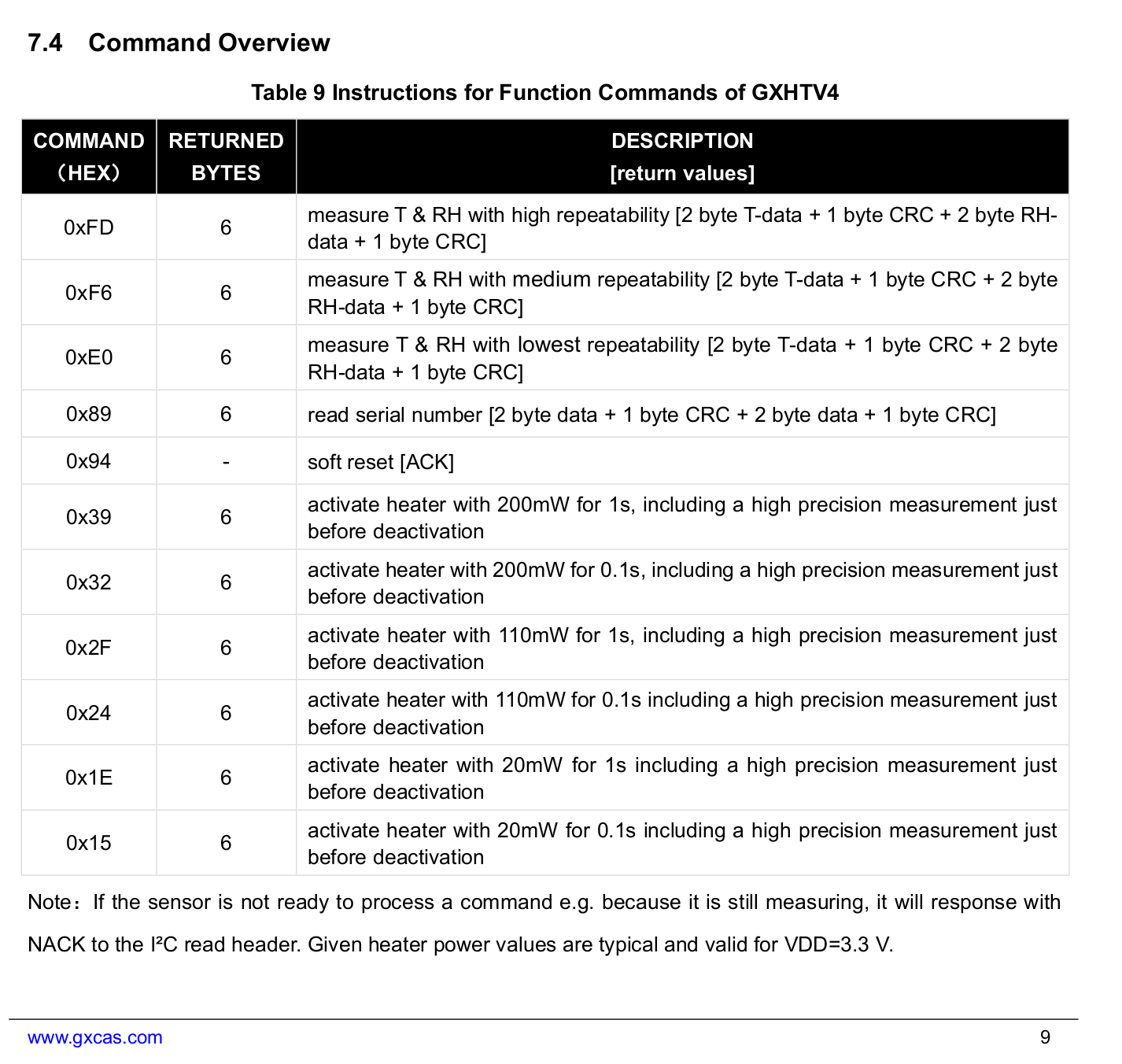

    Well something strange happened . Went for a full uart flash just to eliminate factors . rebooted and
    mqtt_pass ********

    Info:SENSOR:SHT3X : Wrote command 0xE0
    Info:SENSOR:SHT3X : Read buffer: 65 82 BB 78 F4 CB (101 130 187 120 244 203)
    Info:SENSOR:GXHTV4 - try CHTX style calculation: Temp=25.43 - Hum=73.23
    Info:SENSOR:SHT3X : Read buffer: 65 61 29 78 E2 2E (101 97 41 120 226 46)
    Info:SENSOR:GXHTV4 - try CHTX style calculation: Temp=25.34 - Hum=16.20

    Shouldn't the serial remain constant due to the CRC check ?
    Yes, that's what I would expect/hoped.
    It really is strange: First log shows, sensor is identified as GXHTV4 - and showing "reasonable" values:
    Info:GEN:No change in channel 0 (still set to 243) - ignoring
    Info:GEN:No change in channel 1 (still set to 53) - ignoring
    Info:SENSOR:SHT3X_Measure: Temperature:24.3C Humidity:53%
    second log after "restart" - detects an SHT3X - still reasonable values:
    Info:SENSOR:SHT3X : Wrote command 0x24 0x16
    Info:SENSOR:SHT3X : Read buffer: 65 6A C3 7A 49 E1 (101 106 195 122 73 225)
    Info:GEN:CHANNEL_Set channel 1 has changed to 47 (flags 0)
    Info:MQTT:Channel has changed! Publishing 47 to channel 1
    Info:MQTT:Publishing val 47 to TEMP4/1/get retain=0
    Info:SENSOR:SHT3X_Measure: Temperature:24.3C Humidity:47%
    Very strange ...

    >>21839688 After a full uart flash its is SHT4 . After a reboot its SHT3 and remains like this across reboots.
    Added after 19 [minutes]:
    Setting it forcefully to SHT4 mode gives readings that are a little off . I have another sensor in the same room which uses CHT8310 sensor . Its readings are closer to the sht3 ones
    Mind of that they are 1m apart and one is without a case ( the sht3-4)
    Info:CMD:[WebApp Cmd 'logfeature 22 1' Result] OK
    Info:SENSOR:SHT3X : Read buffer: 65 FC 5C 79 0E 66 (101 252 92 121 14 102)
    Info:SENSOR:SHT3X_Measure: Temperature:24.7C Humidity:47%
    Info:SENSOR:Sensor type set to GXHTV4
    Info:CMD:[WebApp Cmd 'SHT_SetType 5' Result] OK
    Info:SENSOR:GXHTV4 - try CHTX style calculation: Temp=25.73 - Hum=36.12
    Info:SENSOR:SHT3X_Measure: Temperature:24.7C Humidity:53%

    But I had some time today to work on the driver again. I also found a pdf document for GXHTV4 claiming exactly the same commands as SHT4X.
    “Command Overview” table listing GXHTV4 hex commands, returned bytes, and function descriptions.
    But we know by now, at least handling of command requesting the serial number used for SHT3x works different on a "real" SHT4x and your chip.
    So my actual approach is to switch the detection: first asking for a serial with SHT4 command "0x89".
    While SHT4x and GXHTV4 should answer with a serial number 4 bytes + 2 CRC bytes), SHT3x will interpret this as "soft reset" and reading 6 bytes will lead to only six "FF"s read.
    As requested, battery driver is included
    • OpenBK7238_SHT4_GXHTV4_w_Battery.zip (1.85 MB) You must be logged in to download this attachment.

    Debug:SENSOR:SHT3X : Wrote SHT4x/GXHTV4 measure command 0xE0
    Debug:SENSOR:SHT3X : Read: temp=0X65D4 (CRC1=0X63 - calculated:0X63) hum=0X5EAA (CRC2=0X2C - calculated:0X2C)
    Debug:SENSOR:SHT3X : Read: temp=0X65E6 (CRC1=0XC4 - calculated:0XC4) hum=0X5FD0 (CRC2=0XFB - calculated:0XFB)
    Debug:SENSOR:SHT3X : Read: temp=0X660B (CRC1=0X64 - calculated:0X64) hum=0X5FF2 (CRC2=0X1F - calculated:0X1F)

    Info:SENSOR:SHT3x: using pins 24 (SCL) and 17 (SDA)
    Info:SENSOR:SHT: Detecting sensor type...
    Info:SENSOR:DEBUG SHT_DetectSensorType() testing for SHT4x/GXHTV4 serial: 0x89 got ACK
    Info:SENSOR:SHT: 0x89 cmd: SNB=[FFF24305], CRC=[E0,D0]

  • #76 21843593
    leon22heart
    Posts: 72
    Rate: 7
    Small update. After 15 reboots the sensor is always recognized as SHT4X. Its readings match closely those of an analog temp-hum meter. So I conclude that the driver is stable, accurate and can be pushed to the git tree.
    So I need some final help for the BAT_ADC and BAT_RELAY. By inspecting the board I conclude that there is no BAT_RELAY (matches the Tuya firmware, which does not give %, only high, mid, low readings).
    I think I identified the BAT_ADC but I have a reading of varying voltage ranging from 1501–1512 mV. Is it a possibly correct reading based on that the line is a resistor divider?
    Using 2 AAA batteries that give 3550 mV on my other sensor using BK7231N.
    After confirming this, will proceed to a presentation guide, full tear-down and obk profile.
  • #77 21843607
    max4elektroda
    Posts: 756
    Help: 48
    Rate: 187
    I'm sorry to say that I never did anything related to battery.
    From the images I would also rule out any relay but I'm no help regarding battery driver.
    But on reading the temperature: If you want to use the device with battery, you will probably need to send MCU into deep sleep for some minutes before waking up, reading, do something with the read values and go back to sleep.
    The original firmware sleeps for 240 seconds between readings.
    But, since you don't send your data into tuya cloud, you need some target to "store" the read values...
    If you could do me a favor:
    Could you try the attached firmware?
    It's a "plain" SHT3X version with one additional command "SHT_GetSerial".
    If I'm right, the device should not give correct readings after a start but using SHT_GetSerial should (on first run) display serial 00000000, later another one, and this should somehow switch the sensor to SHT3X mode, if I understood the logs right...
    That's just for me to see if my thesis is correct.
    • OpenBK7238_SHT3x_getSerial.zip (2.11 MB) You must be logged in to download this attachment.
  • #78 21843610
    max4elektroda
    Posts: 756
    Help: 48
    Rate: 187
    Next days I will strip down the driver a bit, I think we can now agree that SHT4x mode also works fine on GXHTV4, so all special handling for a third "family" GXHTV4 can be deleted.

    Hi, could you please test, if the new command
    SHT_GetSerial
    Will give an answer and especially, if it changes the sensor to answer to SHT3x temperature/ humidity commands?

    Thanks for testing, this sensor is still a mystery to me. While here ...

    No, the only "academic" question is how we managed to get the sensor to act like an SHT3x one, even if usually it works like an SHT4x one.
    I hoped we would by sending the serial command, but this (alone) won't work, obviously. Maybe one other test would be, if after sending the serialGet and rebooting, if the serial delivered "changed" as in the logs before and this does the trick?
    But since we have a working config, distinguishing it by first testing for an SHT4x and then for SHT3, this would be only trying to "reproduce" the results, so no stress for doing this kind of tests.
    It would only be to find a way (if we can) to switch GXHTV4 to "SHT3X mode"...
    Info:SENSOR:SHT: ✓ Detected SHT4X/GXHTV4 (Valid CRC - Serial via 0x89: FFF24305)
    Info:SENSOR:SHT4X sensor detected
    Error:SENSOR:Only supported on SHT3x
    Info:MAIN:Started SHT3X.

    Info:SENSOR:SHT3X_Measure: Temperature:129.9C Humidity:26%

    Its clear . OTA was messing the drivers. If you want me to test older firmwares just for curiousity's sake tell me.
  • #88 21844467
    max4elektroda
    Posts: 756
    Help: 48
    Rate: 187
    In this situation, were version 4 is detected but not working: can you try if it now answers to SHT3X commands by setting it to version 3 (if this command is present in this version, I lost track a little):
    SHT_SetType 3
  • #89 21844515
    leon22heart
    Posts: 72
    Rate: 7
    >>21844467 3 commands SHT_SetType 3 , SHT_SetType 4 , SHT_SetType 5

    Warn:CFG:CFG_InitAndLoad: Correct config has been loaded with 13 changes count.
    Info:NTP:CLOCK driver initialized.

    SHT_SetType 4
    Info:MAIN:Time 157, idle 394265/s, free 122232, MQTT 1(1), bWifi 1, secondsWithNoPing 91, socks 2/24
    Info:MAIN:Time 158, idle 393314/s, free 122232, MQTT 1(1), bWifi 1, secondsWithNoPing 92, socks 2/24
    Info:MAIN:Time 159, idle 407598/s, free 122232, MQTT 1(1), bWifi 1, secondsWithNoPing 93, socks 2/24
    Info:MAIN:Time 160, idle 391756/s, free 122232, MQTT 1(1), bWifi 1, secondsWithNoPing 94, socks 2/24
    Info:GEN:dhcp=0 ip=192.168.1.144 gate=192.168.1.1 mask=255.255.255.0 mac=e4:ae:e4:19:1b:ee
    Info:GEN:sta:rssi=-63,ssid=LOLIDAS24TP_IOT,bssid=9c:05:d6:ba:e3:ee,channel=11,cipher_type:CCMP
    Info:MAIN:Time 161, idle 393960/s, free 121600, MQTT 1(1), bWifi 1, secondsWithNoPing 95, socks 3/24
    Info:CMD:CMD_Restart: will reboot in 3
    Info:CMD:[WebApp Cmd 'reboot' Result] OK
    Info:GEN:No change in channel 0 (still set to 1299) - ignoring
    Info:GEN:No change in channel 1 (still set to 26) - ignoring
    Info:DRV:DRV_BATTERY : Measure Battery volt en perc
    Info:MQTT:Publishing val 1492 to TEMP4/voltage/get retain=0
    Info:MQTT:Publishing val 0 to TEMP4/battery/get retain=0
    Info:DRV:DRV_BATTERY : battery voltage : 1492.968750 and percentage 0.000000%
    Info:MQTT:MQTT client in mqtt_incoming_publish_cb topic TEMP4/voltage/get
    Info:MAIN:Time 162, idle 392110/s, free 119144, MQTT 1(1), bWifi 1, secondsWithNoPing 96, socks 2/24
    Info:MAIN:Module reboot in 2...
    Info:MQTT:MQTT client in mqtt_incoming_publish_cb topic TEMP4/battery/get
    Info:MAIN:Time 163, idle 362807/s, free 122232, MQTT 1(1), bWifi 1, secondsWithNoPing 97, socks 2/24
    Info:MAIN:Module reboot in 1...
    Info:MAIN:Started Battery.
    Info:MAIN:Main_Init_Delay
    Info:GEN:CHANNEL_Set channel 41 has changed to 1 (flags 0)
    Info:MQTT:Channel has changed! Publishing 1 to channel 41
    Info:MAIN:Using SSID [LOLIDAS24TP_IOT]
    Info:MAIN:Using Pass [22leon22heart22]

    Info:SENSOR:GXHTV4 - try CHTX style calculation: Temp=124.97 - Hum=87.60

  • #90 21844730
    max4elektroda
    Posts: 756
    Help: 48
    Rate: 187
    I still can't see the difference...
    One (last?) try could be
    Setting to type 3 and then calling get status, which is not called for SHT4x during startup
    SHT_SetType 3
    SHT_GetStatus
    Thanks for your patience...
