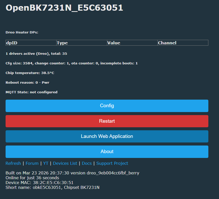

    it'd be the BK7231N rbl file when you get a working OpenBK7231N running.
    think I need to enable it for Beken first.
    but this still the case. so here's a build with it enabled for Beken: https://github.com/divadiow/OpenBK7231T_App/actions/runs/23458842900
    Screenshot of OpenBK7231N web dashboard with a DP table and buttons for Config, Restart, and About

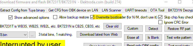

    try overwriting bootloader?
    Screenshot of BK7231N flashing tool with “Overwrite bootloader” checked and “Interrupted by user” message

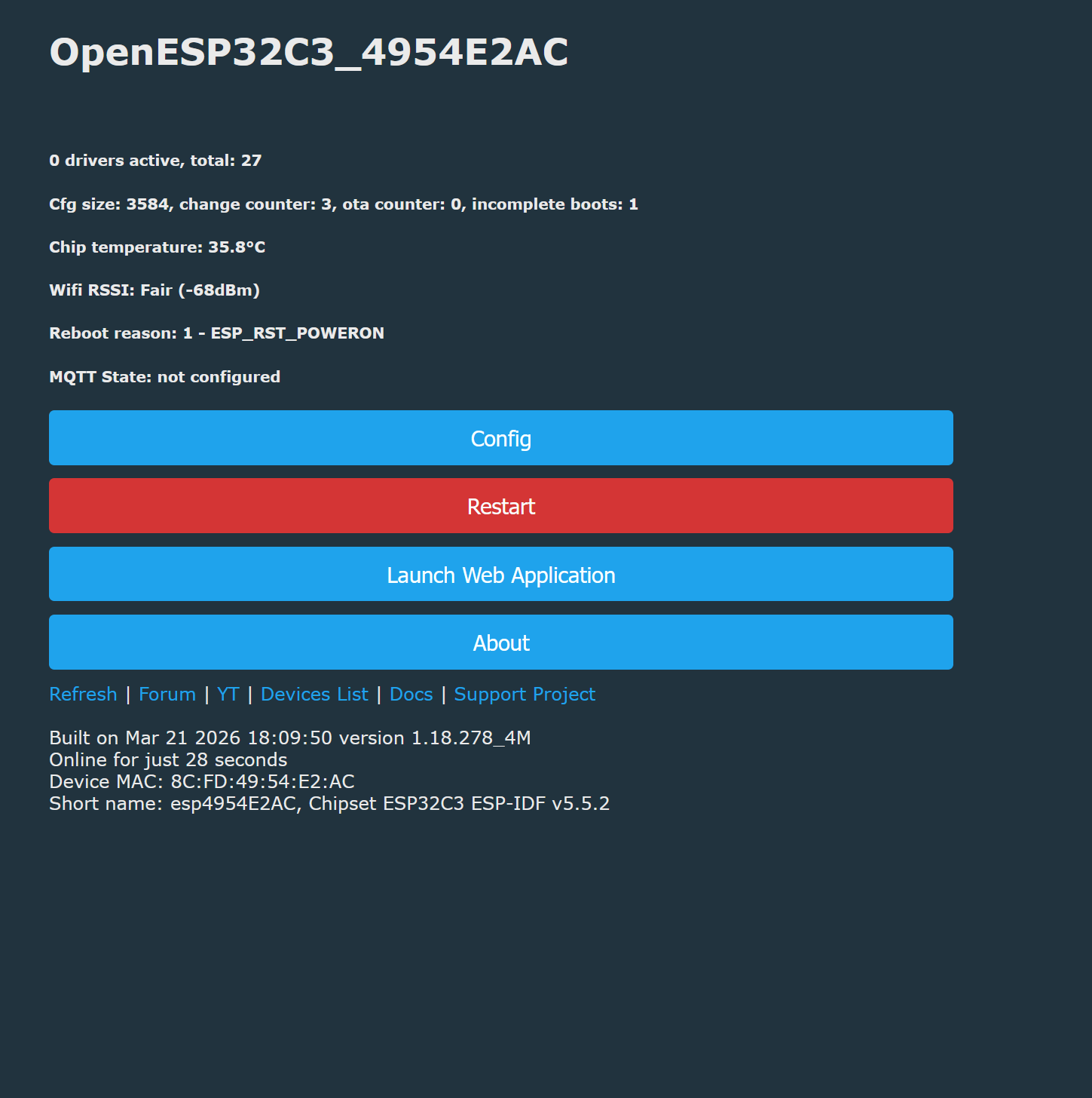

    #76 21869065
    markusdd
    Posts: 74
    >>21869064
    mmh.
    I do not see an AP being opened, but actually I also flashed a OBK config with my network.
    Added after 47 [minutes]:
    mmh. stuck here, cannot get an AP or preconfigure the wifi. also in your pipeline the build fails for ESP, it looks a bit as if the driver is not getting compiled as it cannot find the functions in link stage.
    Need assistance here.
    Added after 3 [hours] 31 [minutes]:
    OK: That was stupid difficult but I have a running OpenBeken on the ESP now and it is in the housing.
    So once we have a build for ESP32_C3 we can test.

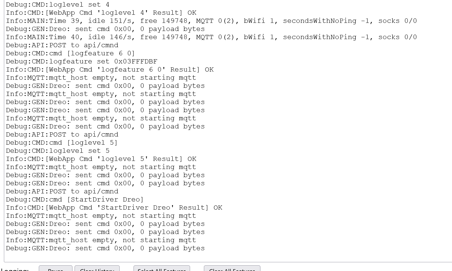

    #79 21869239
    markusdd
    Posts: 74
    ok @p.kaczmarek2 and @divadiow I now have the ESP32 C3 running after the original module decided to die on me.
    Screenshot of a debug log showing “StartDriver Dreo” and repeated “sent cmd 0x00, 0 payload bytes” lines
    I put "StartDriver Dreo" into autoexec.bat and enabled the flag 26 for secondary UART. I now see 0x00 command messages in log but nothing else happening. I have UART soldered up to pins 6/7 which should be correct for C3.

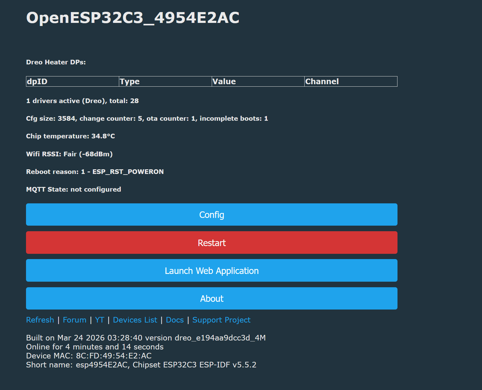

    How to proceed? This is the startpage now:
    Screenshot of OpenESP32C3 web page with Dreo Heater DPs table and buttons: Config, Restart, Launch Web Application.

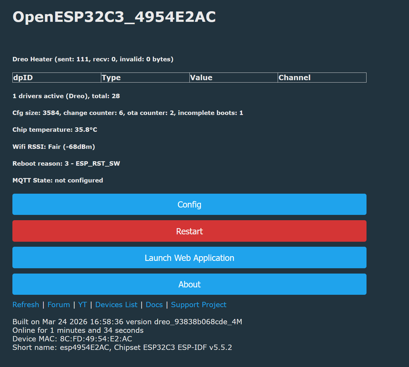

    OTA'd it and this does not look like we're receiving something:
    OpenESP32C3_4954E2AC status page for a Dreo Heater with buttons Config, Restart, and Launch Web Application.
    Any way to check if it really uses the second UART on pin 6/7?

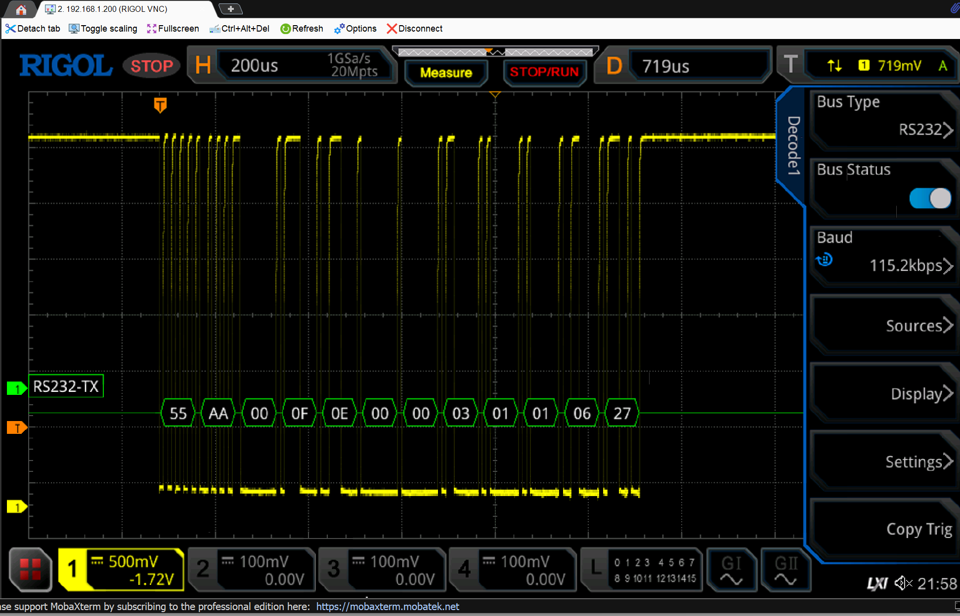

    EDIT:
    On Pin 21, which is UART0, I see activity but the decoder clearly says this is logging:
    Rigol oscilloscope screenshot showing RS232-TX decoding with a visible character string
    So that at least is not where our stuff supposedly comes out.

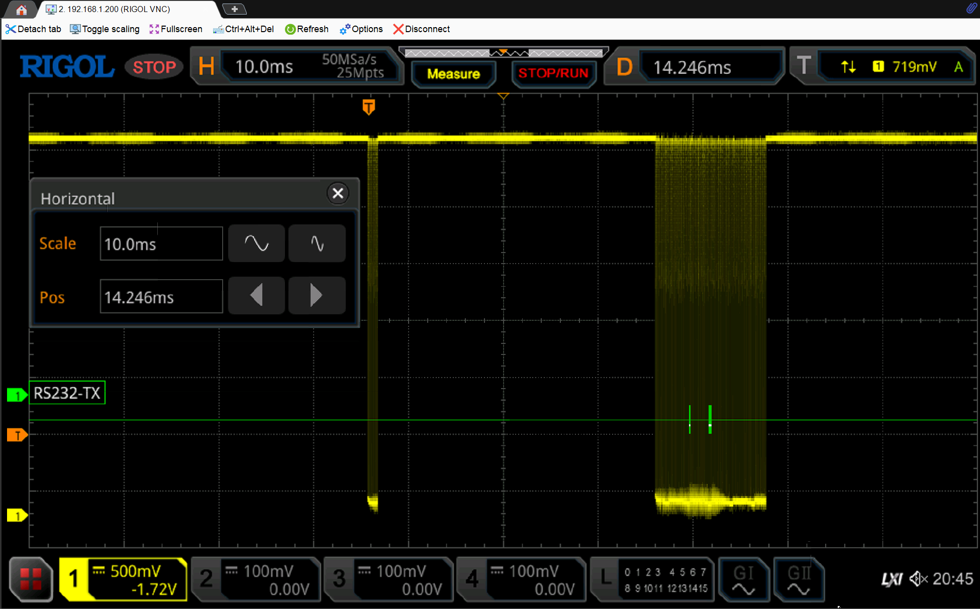

    Added after 28 [minutes]:
    I think the driver is watching the wrong UART.
    When I press the front panel button to turn it on I clearly see that the MCU is sending us something:
    Rigol oscilloscope screenshot showing an RS232-TX waveform and a horizontal timebase settings panel.
    But there is complete radio silence on our TX pin.

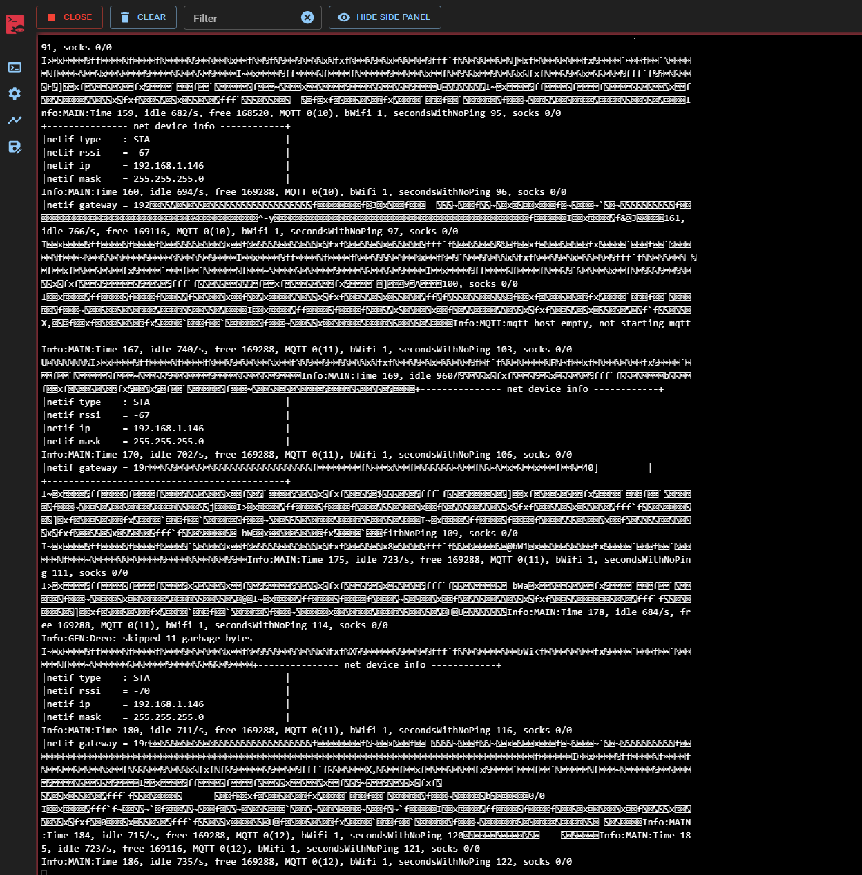

    Ok, so I switched to a normal ESP32 as the C3 kept having wifi issues whenever measurement equipment was connected.
    When I do NOT enable Option 26 the command data very obviously comes out together with the normal logging, and I get send+receive data:
    Screenshot of OpenESP32 status page showing Dreo Heater stats and buttons: Config, Restart, Launch Web Application, About.
    Obviously, this leads to total garbage, because we keep pumping the general log into the MCU:
    Screenshot of a serial monitor showing ESP logs, garbled characters, and network info values
    The problem is when I enable Option 26 I do not see data coming out anywhere, and that is our issue. So how to fix that?
    Added after 48 [minutes]:
    it seems to me that setting the option has the effect of indeed not polluting UART0 anymore, but trying to switch to UART1 or 2 ends up in not exposing it on the pins. It could be that some IDF API call is missing to actually set the pinmux
