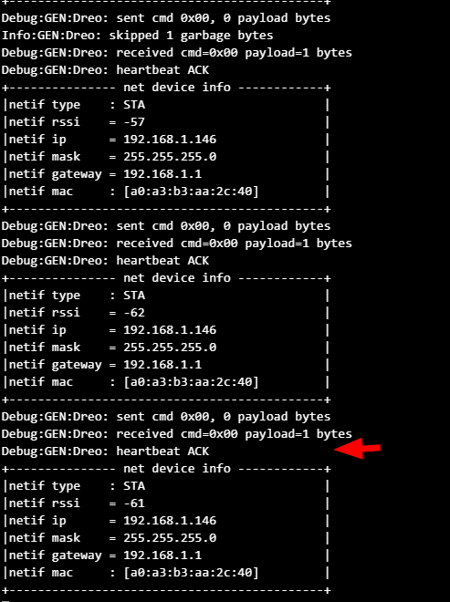

    Added after 32 [minutes]:
    Progress my dudes!
    Screenshot of “Debug:GENreo” logs and a “net device info” table with a red arrow.
    Here you can see what I did so far. I think we're not fully there yet but progress is being made https://github.com/openshwprojects/OpenBK7231T_App/pull/2046

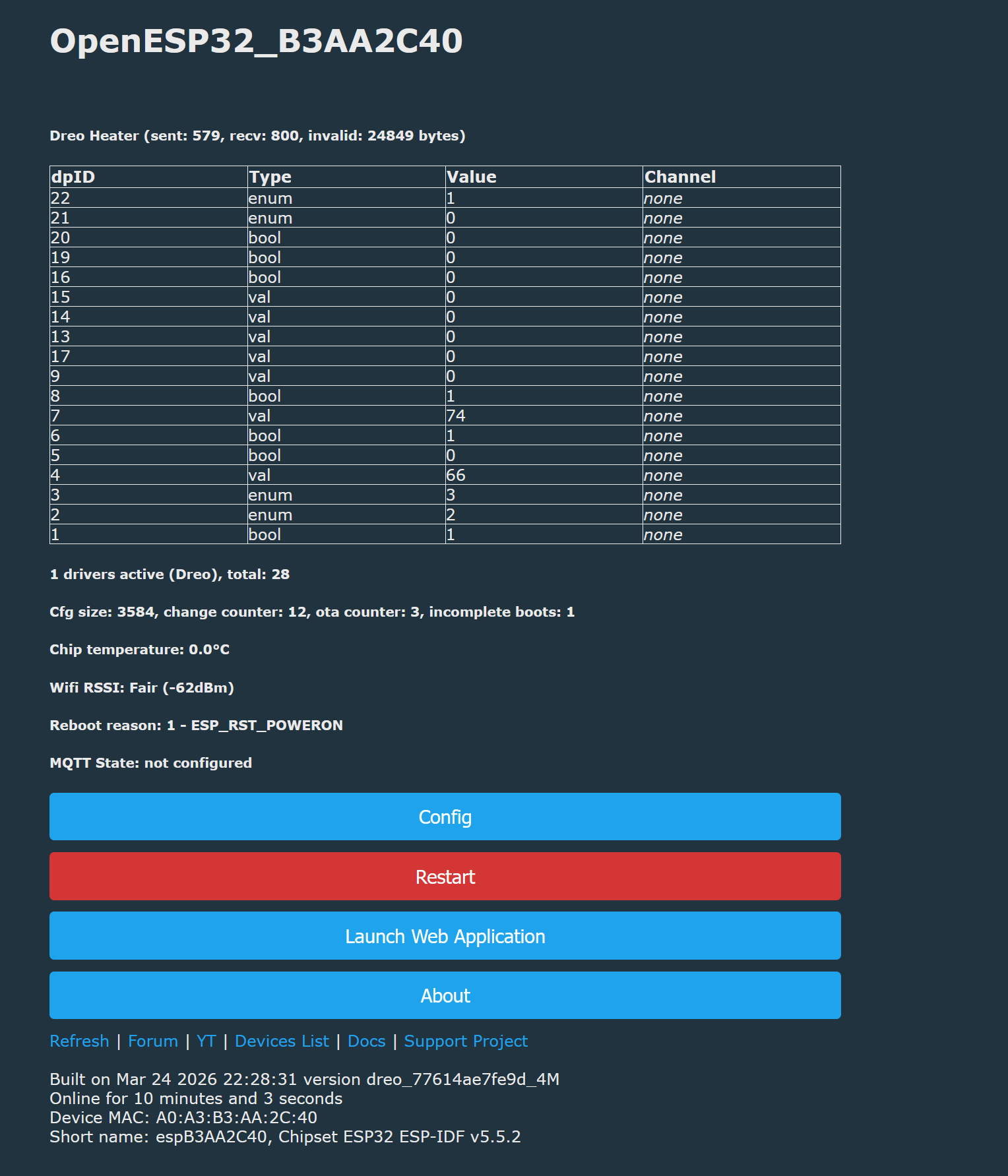

    ok @p.kaczmarek2

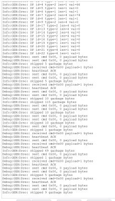

    Screenshot of OpenESP32 panel with datapoint table and buttons: Config, Restart, Launch Web Application
    we seem to be getting something coherent now. the 66 in the table for example is the set temperature in fahrenheit, I know because it is on the device display.
    There is still many garbage byte messages though so I guess this is where we need to start to debug the actual driver.

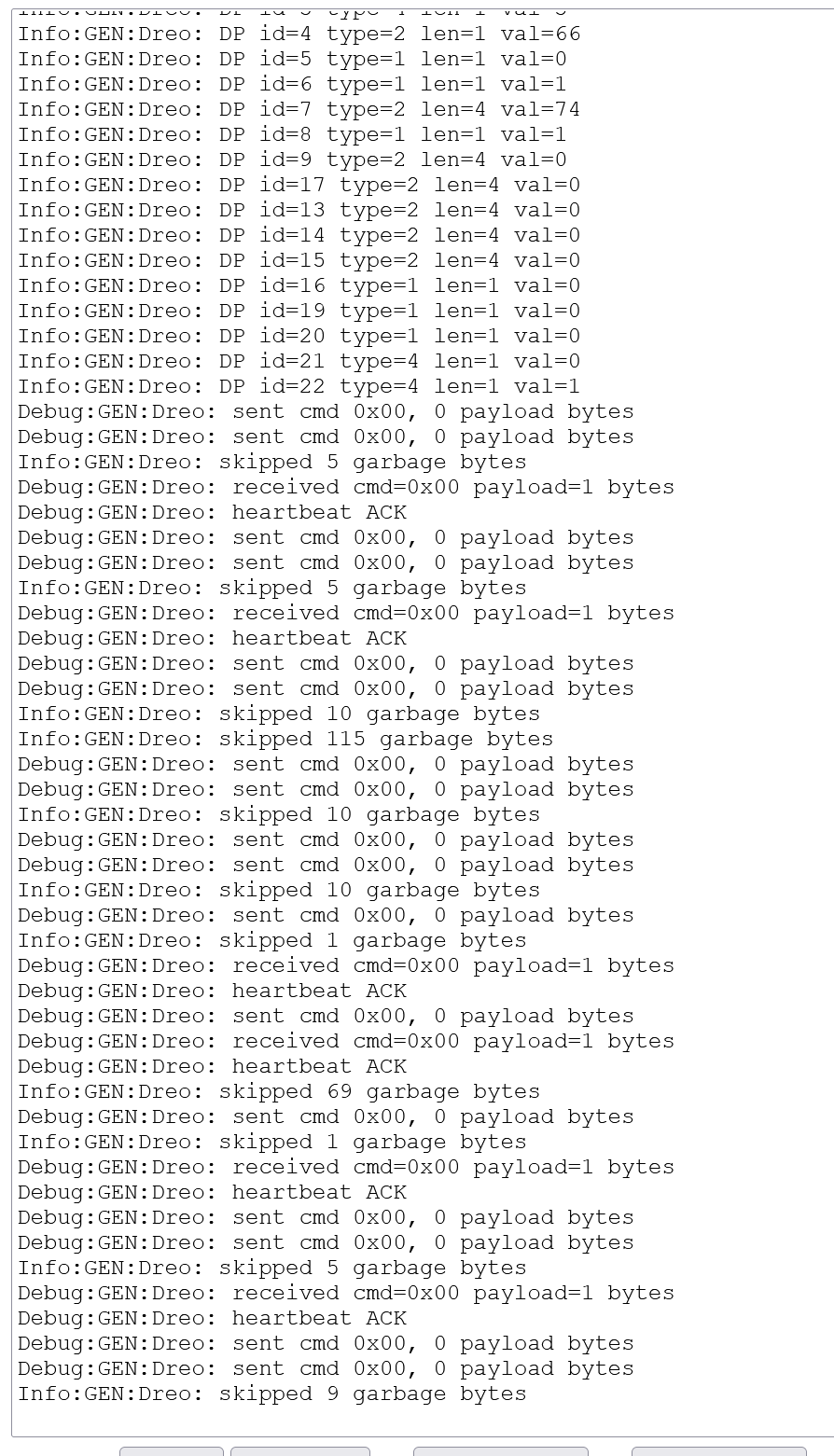

    Console log screenshot showing “GENreo” debug lines with “sent cmd” and “heartbeat ACK”
    The keepalive ping-pong seems to be good as well as the status messages it seems. Where things generate these garbage messages is e.g. when I press the fron panel buttons, then it seems to not like something.
    To be a bit more precise now: serial logging suggests that the driver has issues with status change messages:
    The status change messages lead to garbage byte messages in the log although they are well formed. The keepalive ping-pong works well.
    It is intermittent, so this suggests there is some issue with the UART buffering or so.
    This is a log with me turning the device on and off multiple times. Sometimes we consume the command message and the following state correctly, sometimes not.

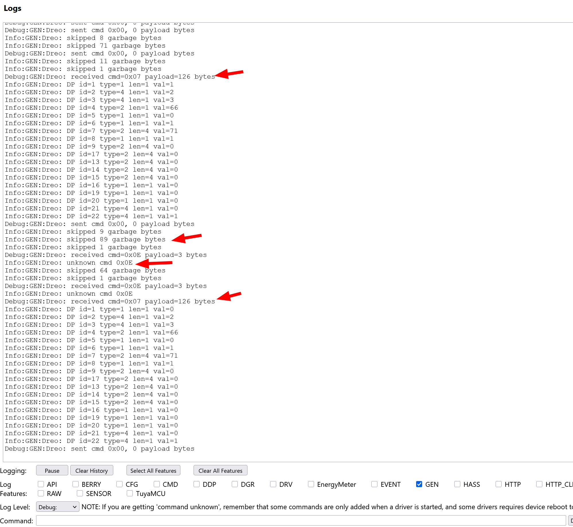

    Screenshot of debug logs with red arrows highlighting “received cmd” lines and “unknown cmd 0x0E”.

    So I could need some guidance from that point, how do we best debug this? insert more logging? more serial traces?

  • UART buffer desync may be causing packet parsing errors
    #96 21871236
    markusdd
    Posts: 74
    >>21871014
    I do not have any other module but based on the serial traces I made observing the bus I have no reason to believe UART has a problem. The only fix required was to actually route the secondary UART pins in the espidf HAL and since then it was working fine.
    The working handshake - and that we sometimes indeed get proper dpID decode with sensible values - also suggest that.
    I think the issue arises because when you press a front panel button, the MCU responds with a cmd packet telling us whatg was pressed, immidiately followed by a huge status update packet.
    I think we fail to seperate and parse back2back packets correctly.

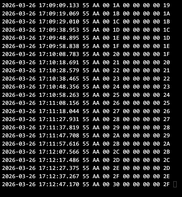

    EDIT: Some serial captures:

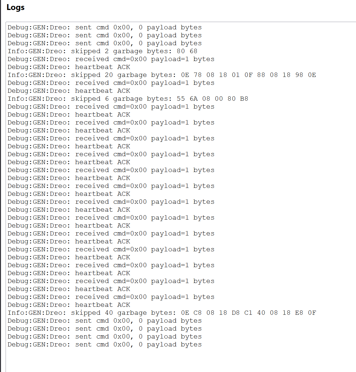

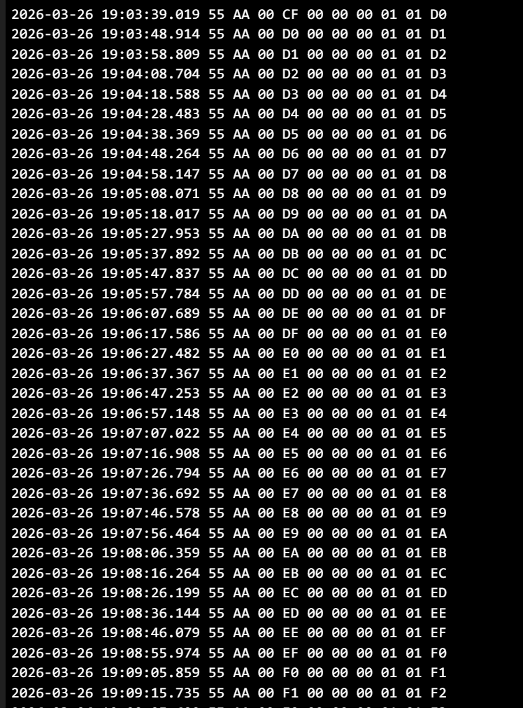

    This is ESP towards MCU, just idle for the heartbeat. This looks perfect.
    Terminal screenshot with timestamped logs and hex byte sequences, including “55 AA 00”.
    This is MCU towards ESP and a log snippet (also just idle):
    Screenshot of “Logs” showing debug lines, repeated heartbeat ACK, and “skipped … garbage bytes” hex sequences
    Terminal log screenshot with timestamps and repeated hex byte frames starting with “55 AA”.
    This somehow suggest that we have issues to always retrieve stuff cleanly, or something else is polluting the buffer sometimes.
    basic functionality is obviously there. Note that logging some of the garbage bytes comes from me, I was debugging with Grok a little yesterday evening.

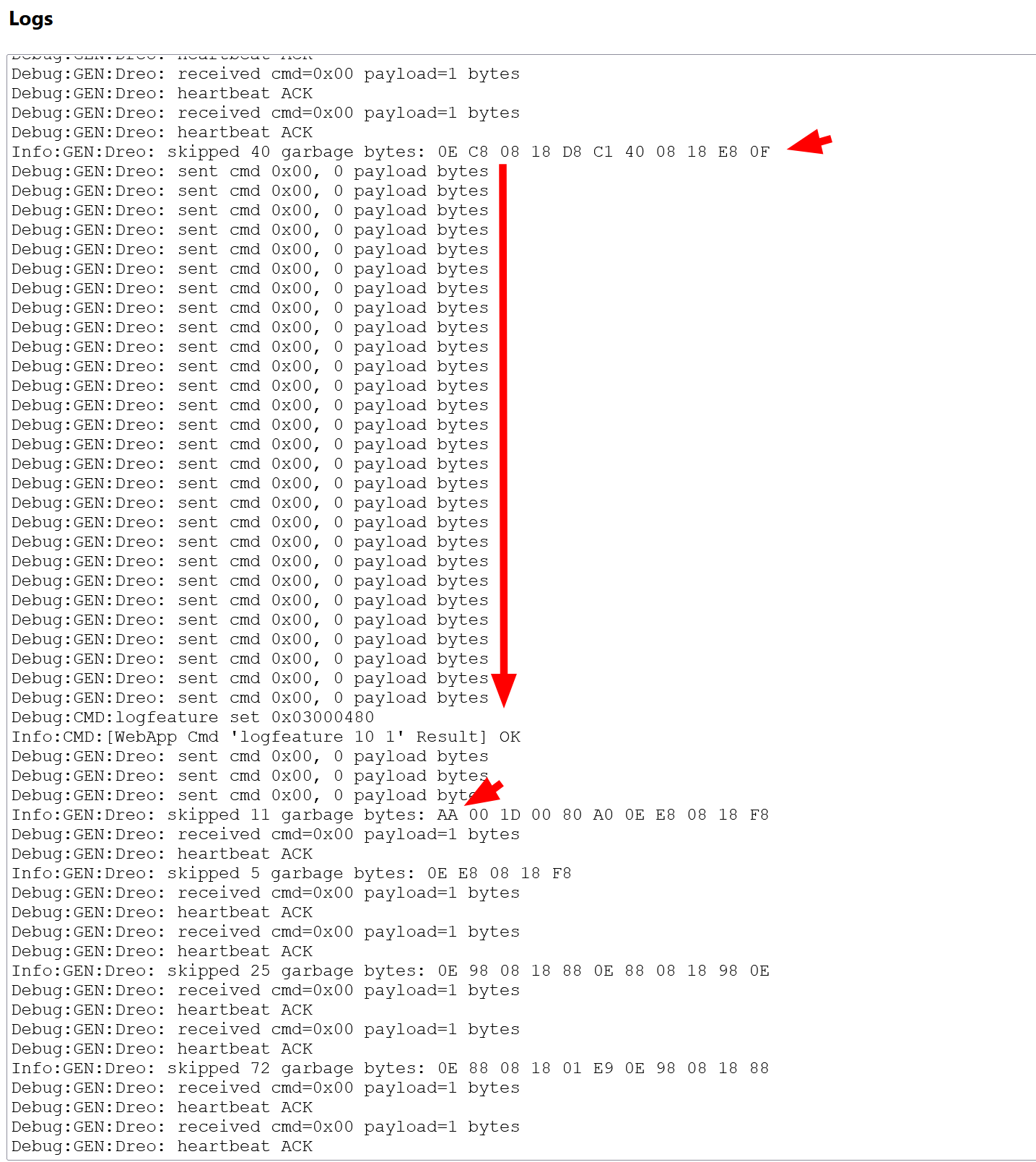

    EDIT: What is really telling is that sometimes we seem to 'desync' from the datastream. We do not process a heartbeat ACK, and suddenly with one following packet we suddenly resync and obviously get all kinds of stuff from the buffer which we do not parse and then have a pool of garbage bytes.
    So it's maybe - if it is not the parser - the UART buffer handling that has a problem. The UART itself is fine when looking at the captures:
    Screenshot of debug logs with red arrows highlighting “garbage bytes” entries
