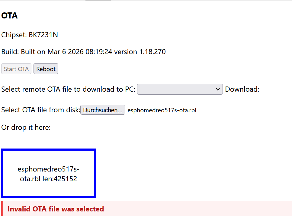

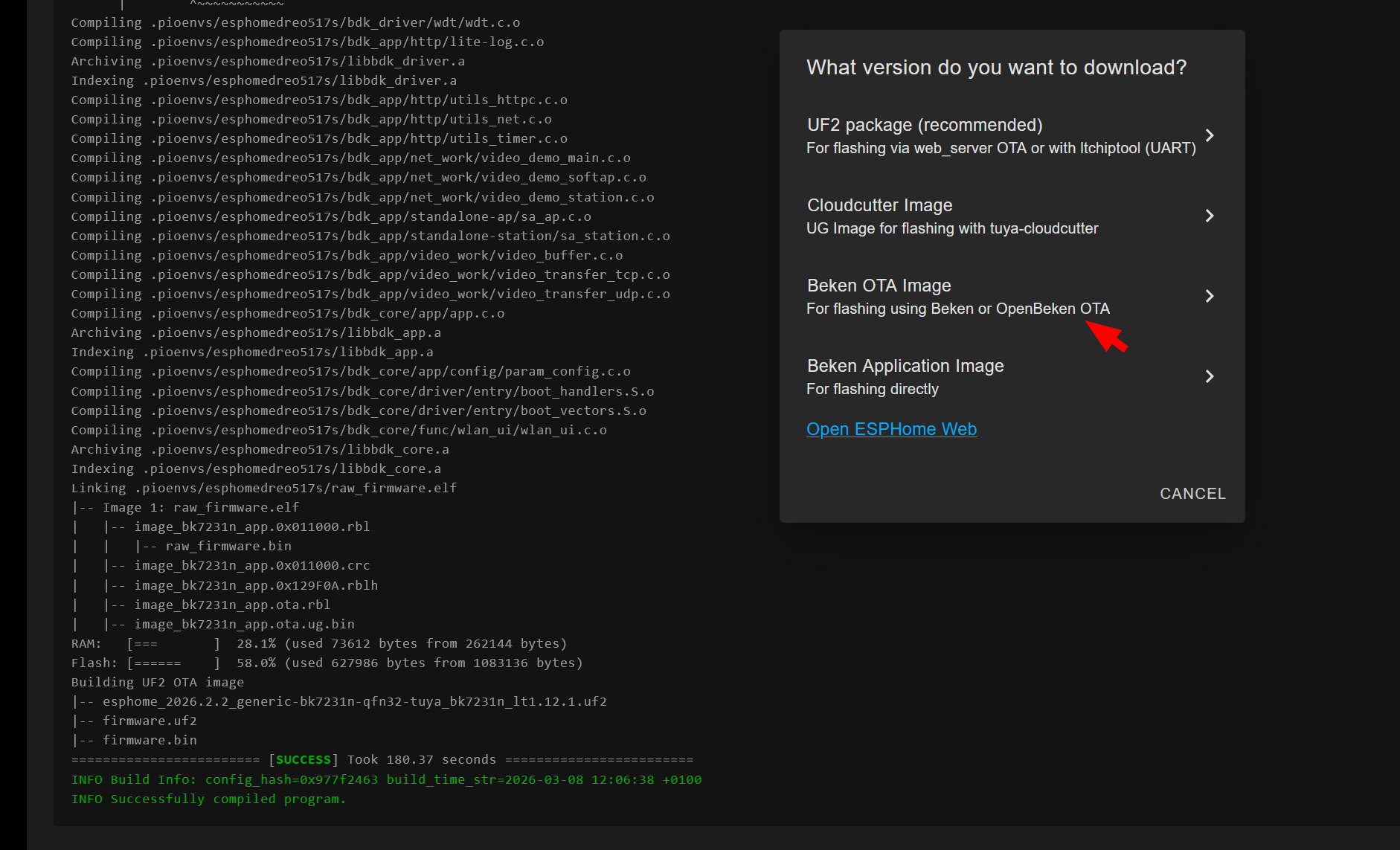

  • ltchiptool uf2 flashing worked after OBK failed
    #42 21857201
    markusdd
    Posts: 74
    nothing to apologize for you guys are doing the god's work here, really.
    I will report back if flashing ESPHome over OBK is a suitable route.
    It would be certainly a good approach as the flasher has all the tooling for backup etc. until OBK can fully support climate entities and the associated slightly different TuyaMCU protocol.
    If this all truly cloud-cuts the Dreos this would be amazing. I'm actually quite impressed with the device itself. Silent, good construction and nice optics.
    EDIT: LOL. They even have it right there haha
    Screenshot of build log and a “What version do you want to download?” dialog with UF2 and Beken options
    EDIT: Welp xD
    Screenshot of an OTA page with file selection and the error “Invalid OTA file was selected”.
    Ok, so i did not get it to work. I finally had to use the .uf2 with ltchiptool, which did work.

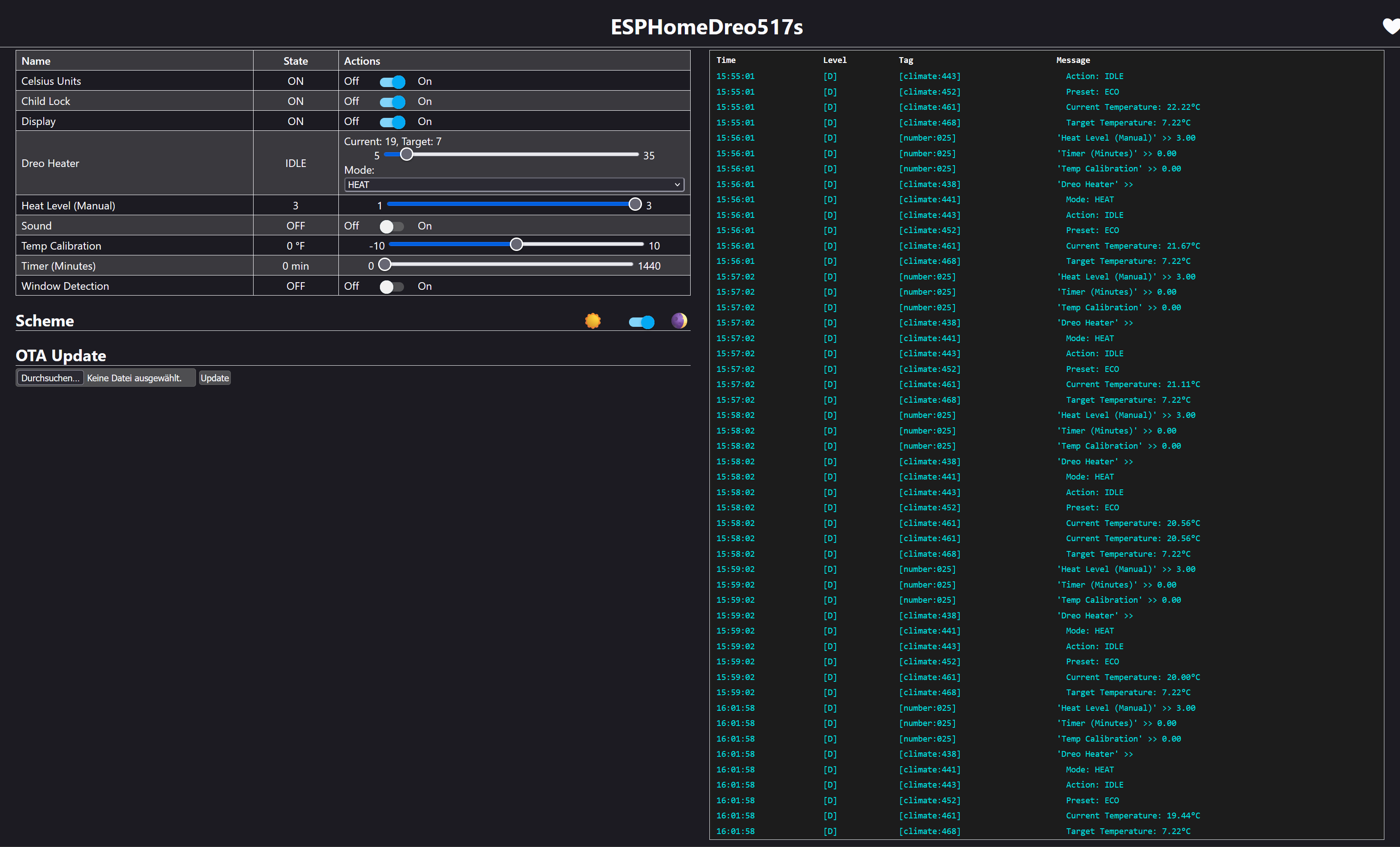

  • ESPHome driver works and can be copied
    #46 21857665
    markusdd
    Posts: 74
    Sure. The only question is if we can OTA OBK back onto it from ESPHome, or if I need to take it apart again.
    Good news is, it indeed does work right now with ESPHome. So this driver is worth copying.
    Screenshot of ESPHomeDreo517s control panel with heater settings and temperature logs on the right
    And I just proved in the Argo thread https://www.elektroda.com/rtvforum/topic4166319-30.html#21857286 we do not even need published climate entities yet natively in OBK, because you can very nicely assemble them in HA directly (and customize).
    So yes, I would absolutely help, after you guys helped me so much.
